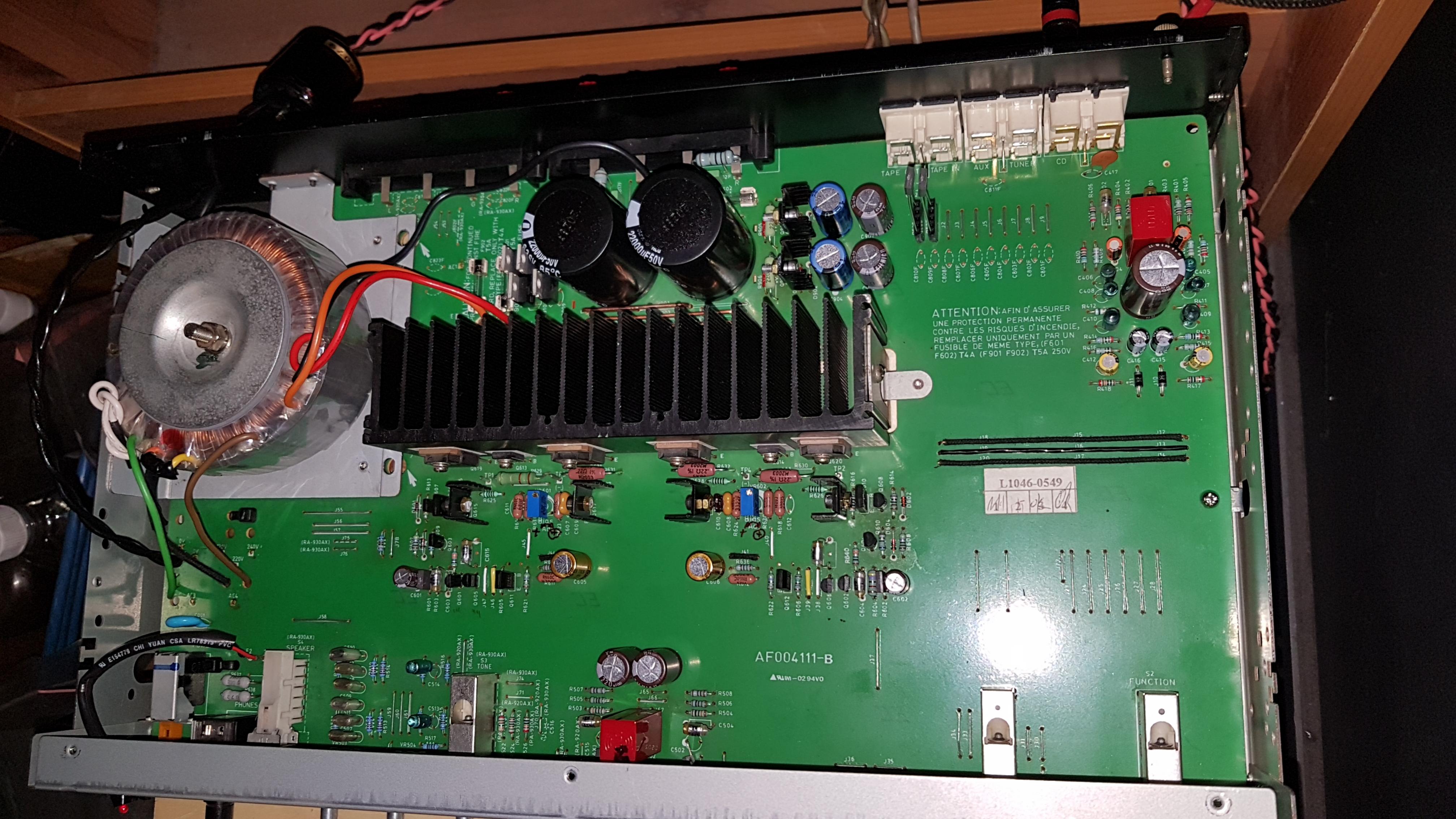

Hi

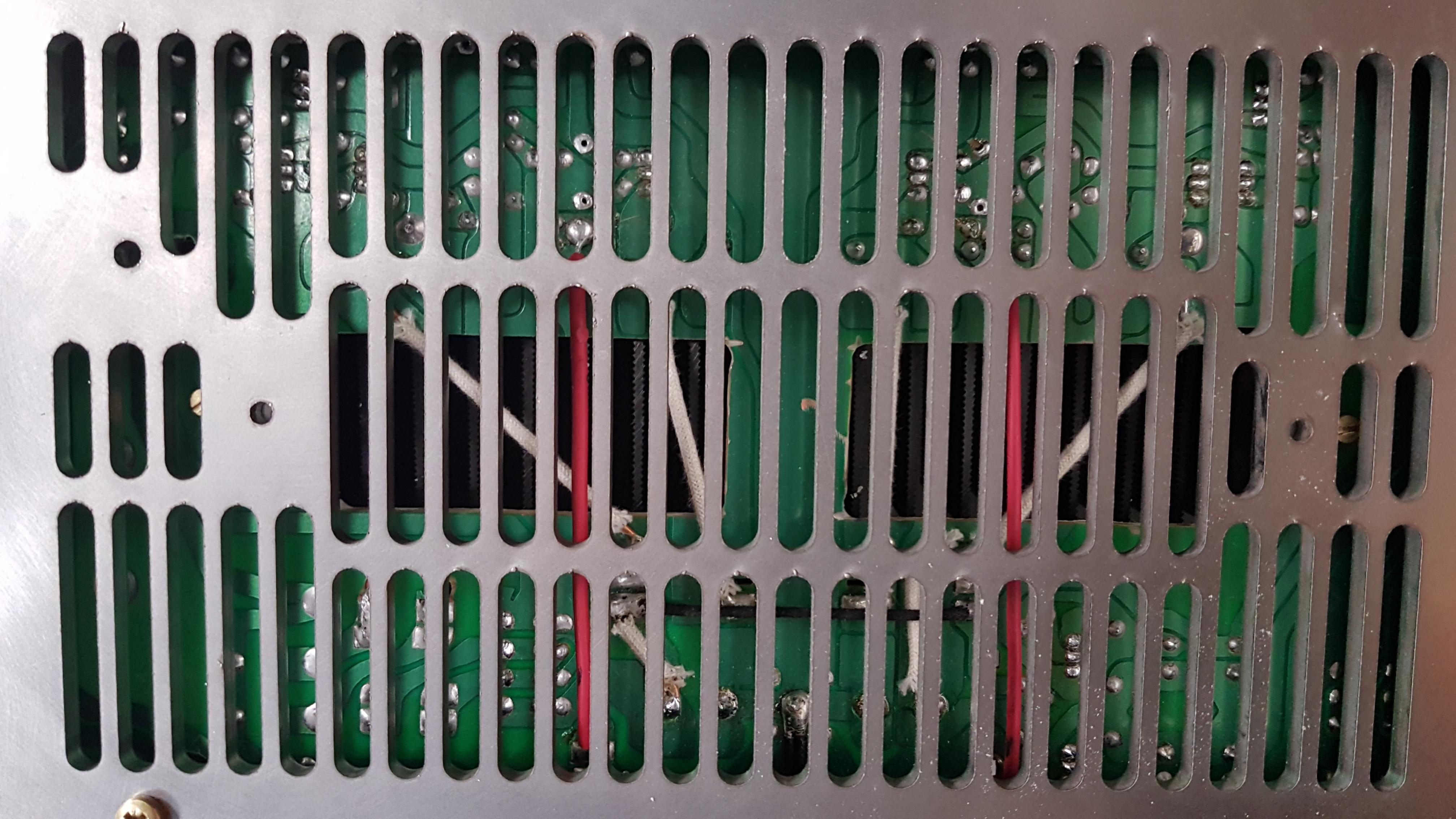

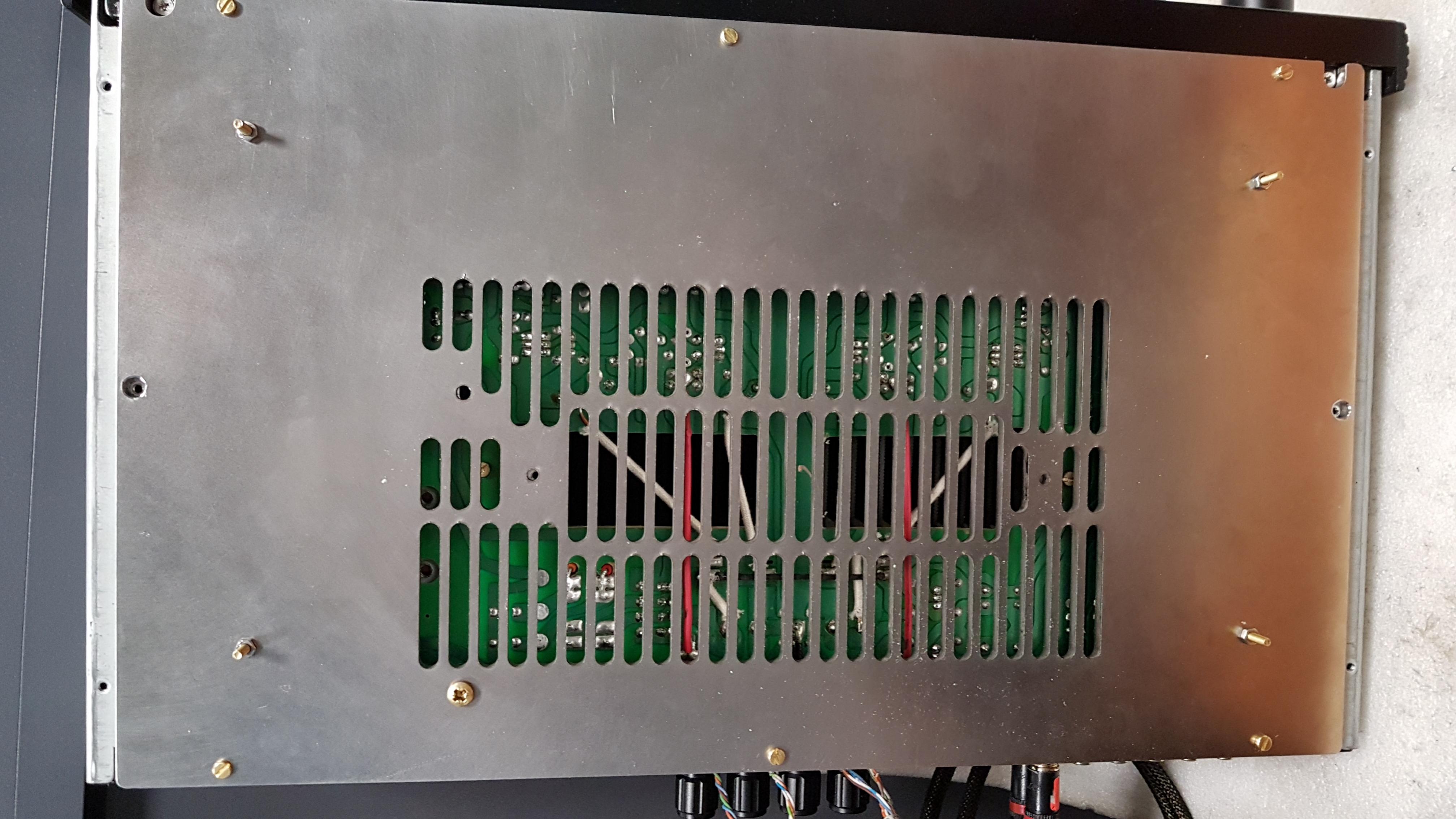

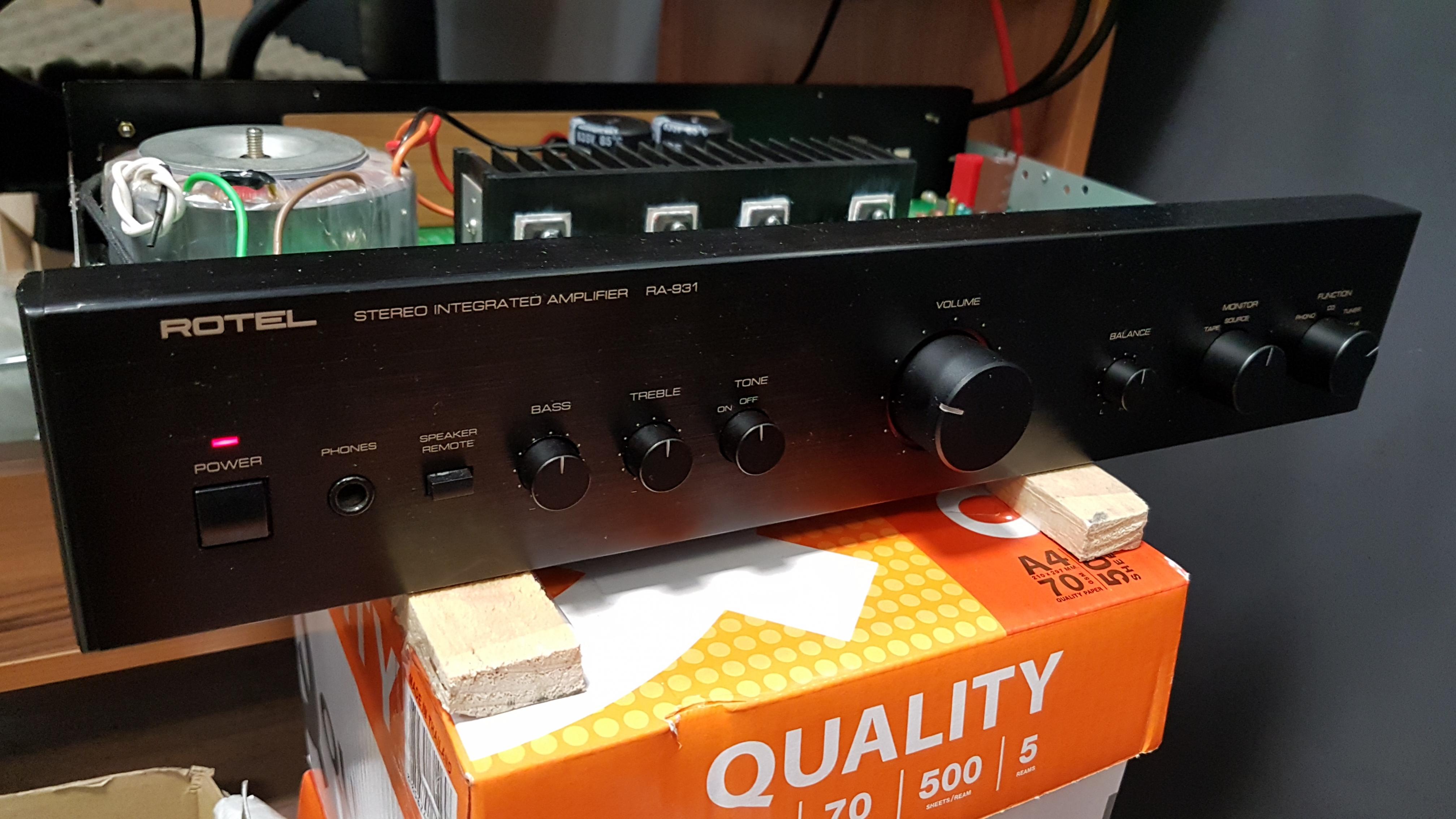

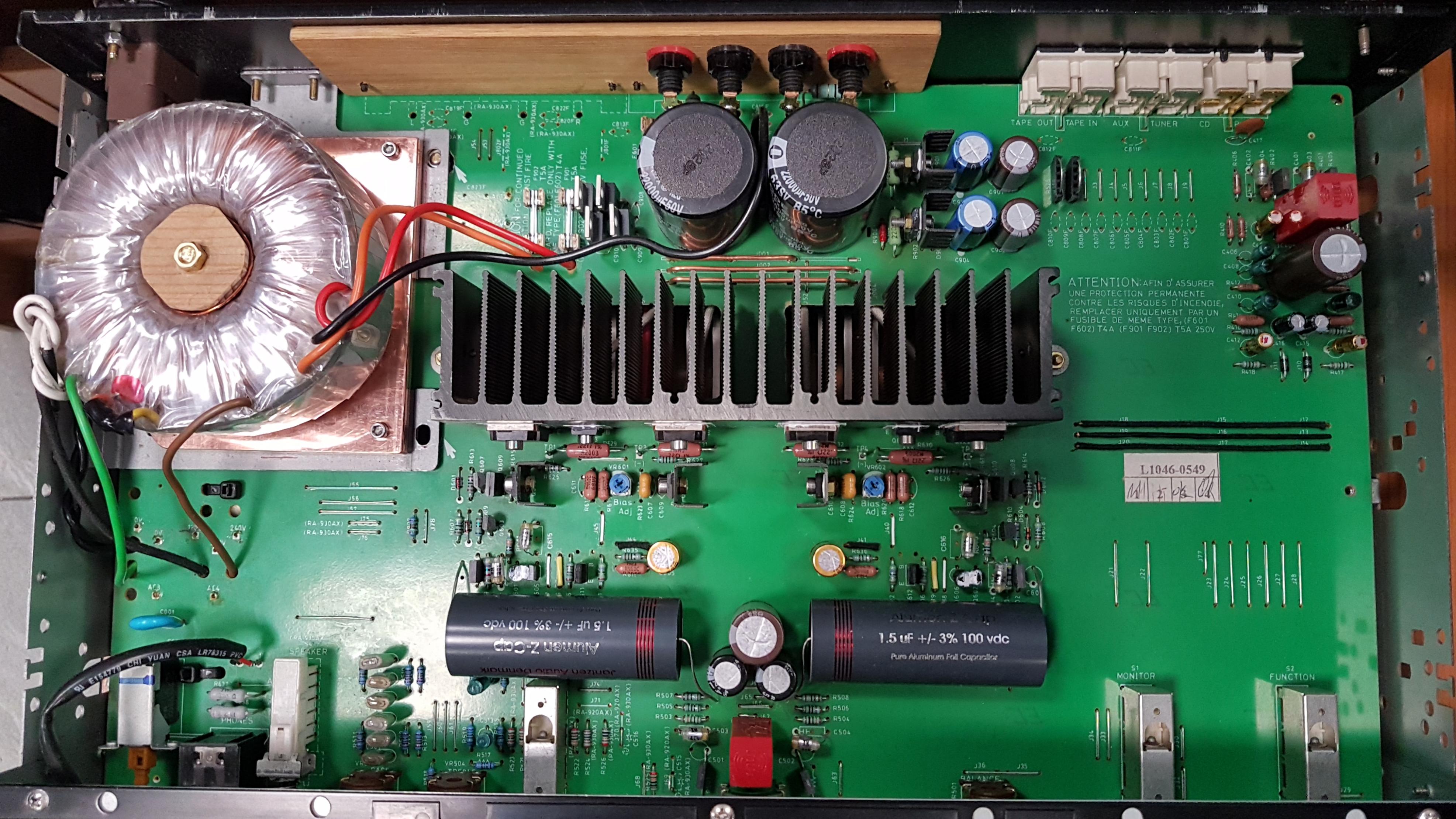

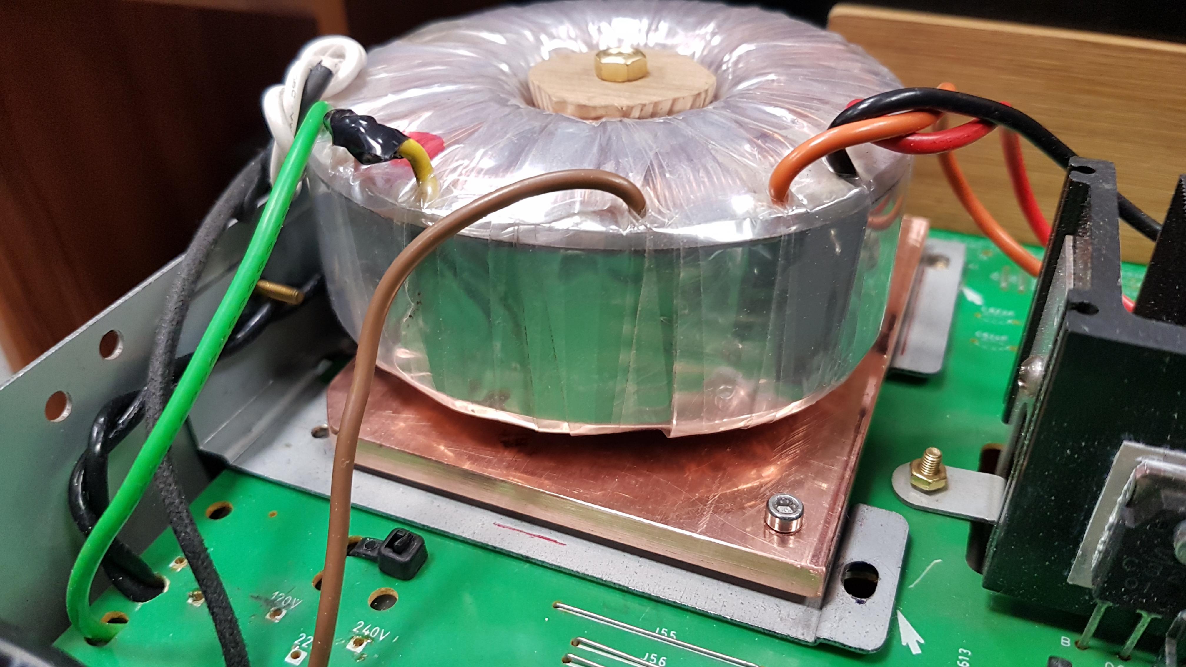

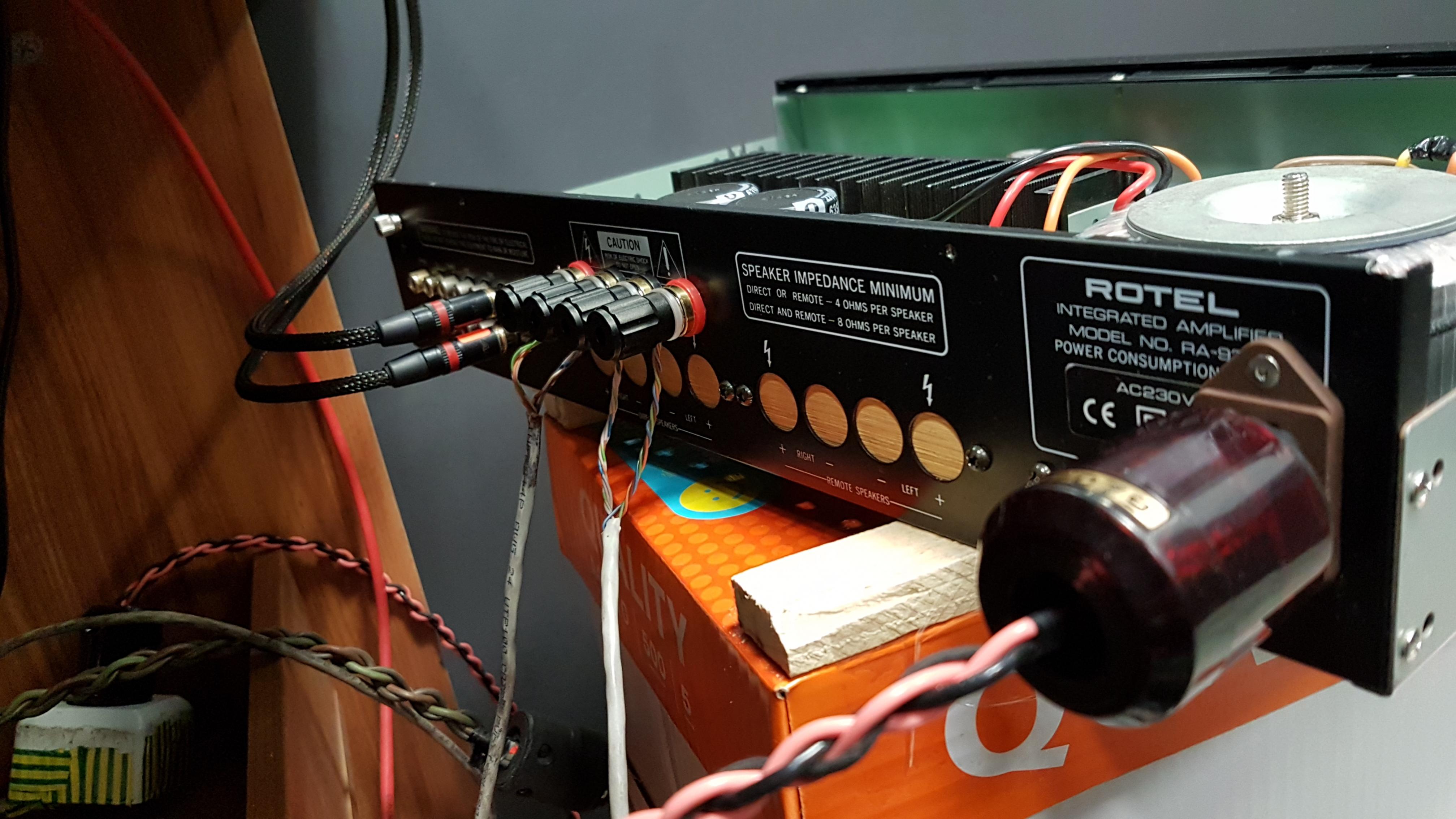

I have a Rotel 931 and I am in the beginning of moding.
For now I have removed all the unnecessary cables and pins, a new rectifier, new electrolytic capacitors everywhere. i also changed all resistors. I replaced the power busbars with hard core cables.
I i measured all 2sa1016 transistors and sorted them by hfe.
R625-628 was 220ohms now they are 100ohms.
The sound is very clean and detailed.
I wonder for low pas RC-filter in input stages or PARAMETRIC STABILIZER on 30-32V.
What do you mean for this idea?
Well done, that is a good looking 931 ! A few questions: Why was only three of the four output emitter power resistors changed? Why did you change the driver emitter resistors from 220 to 100 ohm (it will probably work fine..but is this why you now need heat sink fins on the driver trannies)?
For constructive suggestions, I would dc couple the preamp to the power section (if the new red fancy discrete opamp's offset allows that). Then, I would put in CM1 current mirrors in place of R605/6 and my VAS3 drop-in modules for the 2SC1941 VAS transistors. i would also remove Rotel's heavy lag loading (C607/R623) and increase the NFB capacitor C605 to at least 220uF. The resulting audible improvements are astonishing...
I used to advocate for input stage filters, but found that if you have actually paired the LTP input trannies perfectly (within less than 1 hFE difference), the power stage PSRR shoots up and does the job perfectly, rendering these filters unneccesary.
Hope this helps you.

Hi Per,
thanks for ideas 🙂

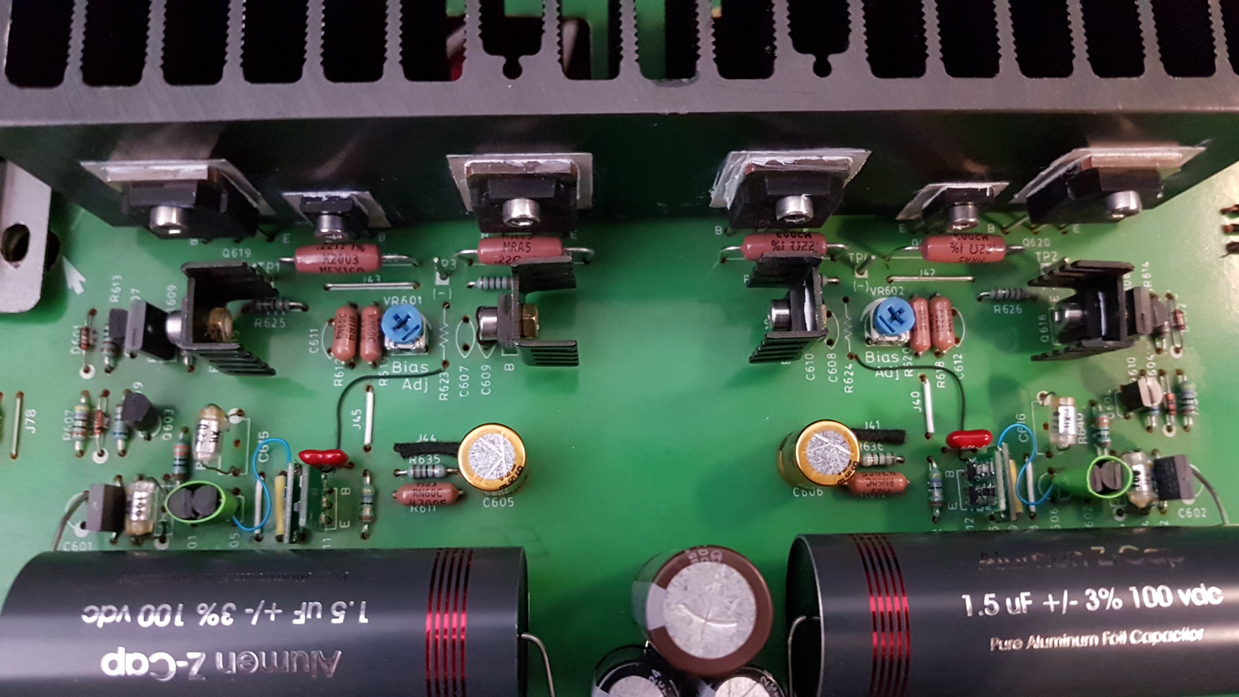

1. "Why was only three of the four output emitter power resistors changed? "
i had changed all 4 resistors, but i had a smoke effect and one of them cracked. 🙁 Now i waiting for delivery of new ones.
2. "Why did you change the driver emitter resistors from 220 to 100 ohm (it will probably work fine..but is this why you now need heat sink fins on the driver trannies)?"
Sound after this mod is more fuller. The transistors are slightly warm, not hot.
3. "For constructive suggestions, I would dc couple the preamp to the power section (if the new red fancy discrete opamp's offset allows that)."
This Burson V5 opamps have ofset 10 and 20mV, that is not adjustable. 🙁
4. "Then, I would put in CM1 current mirrors in place of R605/6 and my VAS3 drop-in modules for the 2SC1941 VAS transistors."
I'm seriously thinking about this upgrade, what are the benefits of it?
5. i would also remove Rotel's heavy lag loading (C607/R623)
today I removed R623-4, but I was worried about oscillations and I haven't removed C607-8 yet. The effect is more sound density and much more bass. It even seems to me that the high have dropped a bit as a level.
I had put a multiturn trimmer Vishay for the bias adjustment, but the dynamics decreased and the sound became thinner. I return original trimmer and sound became more fuller.
6. increase the NFB capacitor C605 to at least 220uF. The resulting audible improvements are astonishing...
now i use bipolar 100uf Audio Note Kaisei
7. I used to advocate for input stage filters, but found that if you have actually paired the LTP input trannies perfectly (within less than 1 hFE difference), the power stage PSRR shoots up and does the job perfectly, rendering these filters unneccesary.
My 8 transistors 2SA1016 have hFE: 291, 296, 298, 305, 308, 308, 313, 375
I think to use dual 2SA1240 without changing the board.
Ihave for replasment 150W Sanken 2SA1294 and 2SC3263 for power transistors.

I don't like the sound of smoke and cracked emitter resistors. The mains secondary fuses should have blown before these power resistors. You need to measure the B-E and B-C diode drops in all the output power trannies, one may be faulty. The Sanken replacements are excellent, but if you haven't already done so please find out what is/was wrong before putting them in.
LTP hFE differences will show up as increased output offset. If you should decide to get the CM1 mirrors from me, I will offer to enclose (attached) pairs of precisely matched KSA992 with them if you wish.

i tested some resistors with long legs and the amplifier oscillates. the two 5a fuses and one diode in the rectifier burned out.
I measured all the transitions and they are the same for both channels.
For now, 6 days, works fine.
I have 44 and 49mV DC offset in output.
can i remove 330pf now before i put your modules VAS3?

Well, any gorgeous resister with long legs used to make me oscillate 😛, unfortunately some of the the diodes in my ageing rectifier has starting to burn out 🙁
Ok, on a serious note, no please do not remove stability caps until you have put in a Miller cap.

Sorry for the amateur question, but what do you mean by Miller capacitor?
OK 330p and 150p stays there
Hi may i ask in which position ? thanksi tested some resistors with long legs and the amplifier oscillates ...
A Miller capacitor is a small (100pF or less) cap placed between the collector and base of the VAS transistor (Q611/12). It creates a dominant pole compensation which starts to take effect at higher frequencies by reducing the open loop gain of the amp, thereby avoiding HF oscillations and ensuring stability. It also reduces distortion and improves linearity, etc.
You will find that Rotel has used these caps on earlier models and in the RA-931 there are actually two drilled holes, pads and tracks on the pcb next to the 2SC1941's for a Miller cap, so it is very easy to pop 100pF / 100V caps in.
Why Rotel (or Stan Curtis) decided to switch to the heavy lag loading (C607 and R623) of the VAS for stability is not clear - except that this creates the smooth / warm Rotel "Sound" which became Rotel's trademark and led to a very high sales success.
I used to like it - until I attended a comparison test with a Class A amp.Then it suddenly got obvious how much openness and detail in the music gets smoothed (or smothered, rather) out by this type of compensation.

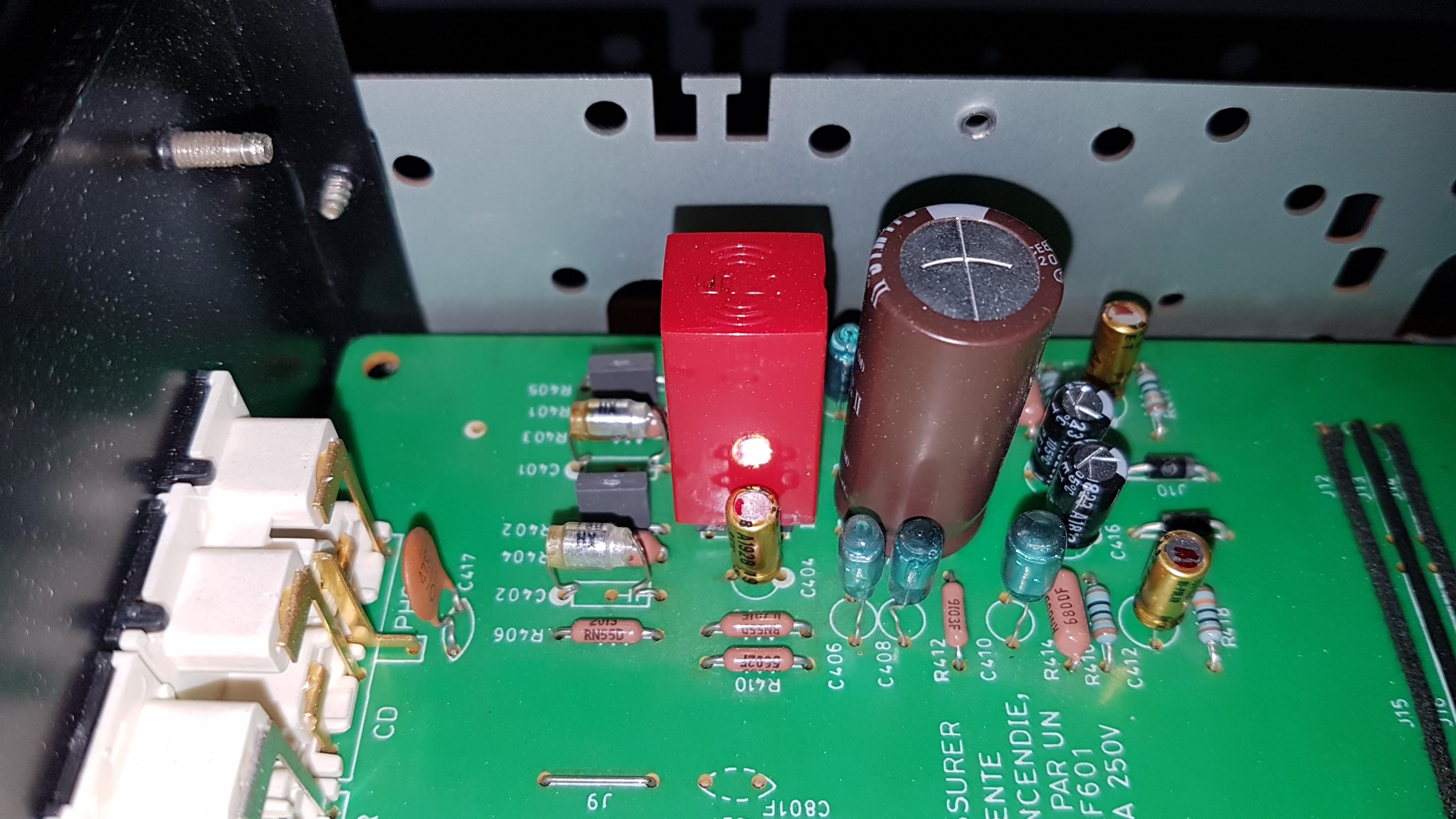

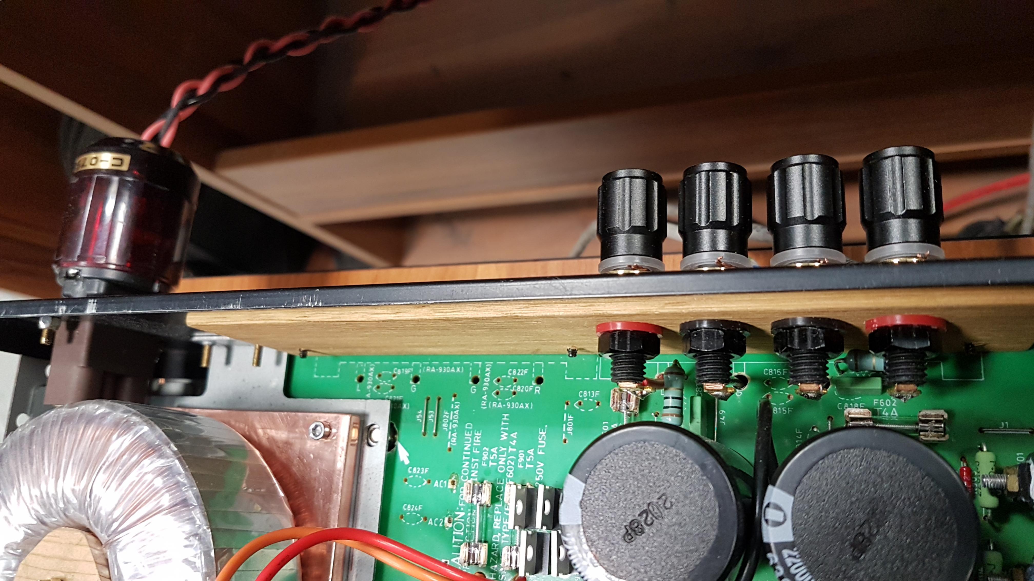

Hello again. Here are some pictures from my Rotel.
I'm not done with the VAS settings yet. Without 330pf the right channel is not stable.

i'm thinking of removing C607-330pf. To replace C609-150pf with 33 or 27pf. I will also put a Miller capacitor 68 or 100pf on VAS.
What do you think are the appropriate values?
I have already removed P623-33k2 with good sound result.
First, I think that you have done an impressive amount of nice work on the 931!
Installing the Miller caps will completely take over the stability of the amp from the 330pF load, decrease distortion and increase linearity, etc.
But it will take away the "nice, round" Rotel sound for a much more analytical, punchy sound (also called HiFi). Some love it, some don't.
In my experience, 68pF PS Millers will do the trick - and if you eventually decide to use my VAS3 modules instead of the 2SC1941's the modules include an integrated additional 33pF Miller which will further ensure stability.
The modules also include a 27pF VAS load so you will eventually be able to remove the 150pF's.
But until then I would leave the 150pF's in place.

I have made many changes and improvements to my Rotel. Unfortunately, he still lacked something to like me enough. I'm glad I left the installation of Per's modules for the end. Now I understand what I lost in the sound picture, In fact, I have not had one so far.
With the new modules, I have a tangible real stage and musical instruments and space.
What more does a person need 🙂
PS: I haven't removed C609 (610) -150pf yet and have Miller 65pF silver mica caps across the C-B of the VAS3.
