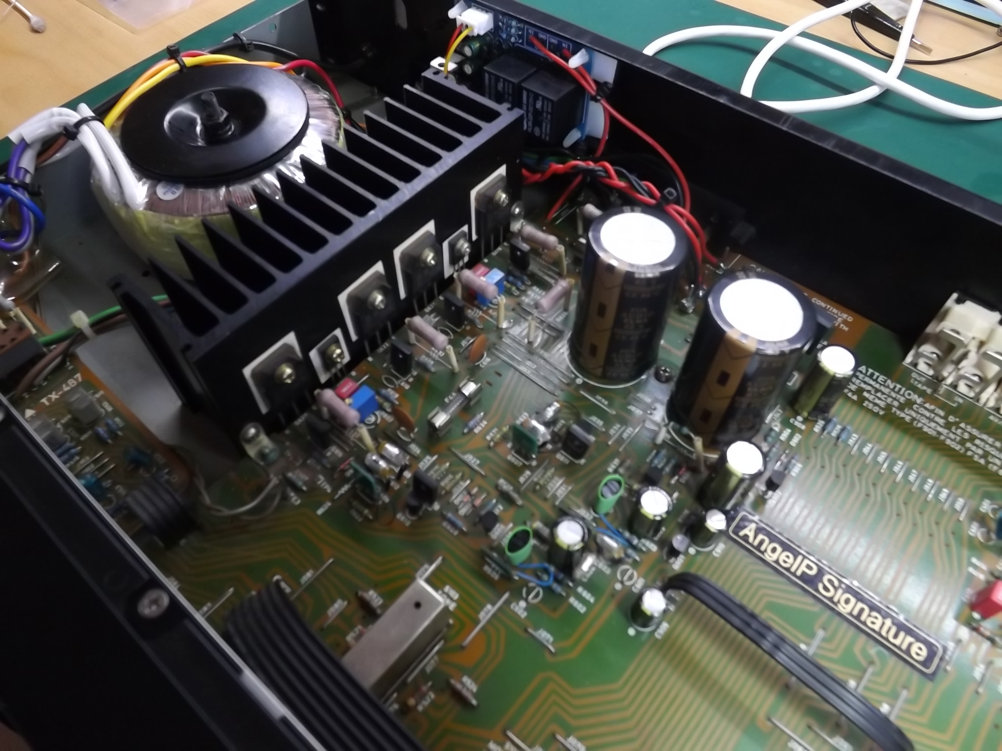

RA-820AX upgrades revisited
Right, I'm back from some needed R&R and have put the finishing touches on the RA-820AX.
I have put a speaker and "on/off thump" protection circuit in - yes, it is an inexpensive Chinese pcb, but it works well and I have modified its original 12V design to be able to directly feed off the 25Vac from the transformer with a minimal relay current of 32mA, thereby not loading the amp's rectified dc voltages.
Then I put in an AngelP emerald green power LED to replace the bland Rotel red at the front, and some AngelP Signature stickers - mainly to strut my feathers, but also to give a would-be future repair technician a chance to email me for advice on what strange things happened to this Rotel amp.
But most importantly - how does it sound?
The short answer is: Heavenly.
The amp has a completely improved soundstage detail and clarity with a commanding control over the speakers.
Punchy bass and ... well ok, I think I will stop the waffling and let alp1961 (Rui) as the amp's owner be the
of these things.
But I could add that I have a setup where I can switch between my trusted Hiraga class-A amp and any second amp on test.
With this 820AX I have repeatedly had to double check which amp was actually playing, this upgraded Rotel is that good.🙂
So, with only a screwdriver and a soldering iron (and a lot of time and patience) - most DIY Rotel owners could do it.

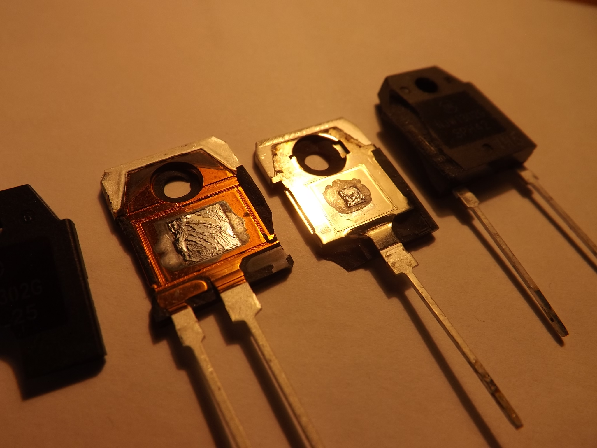

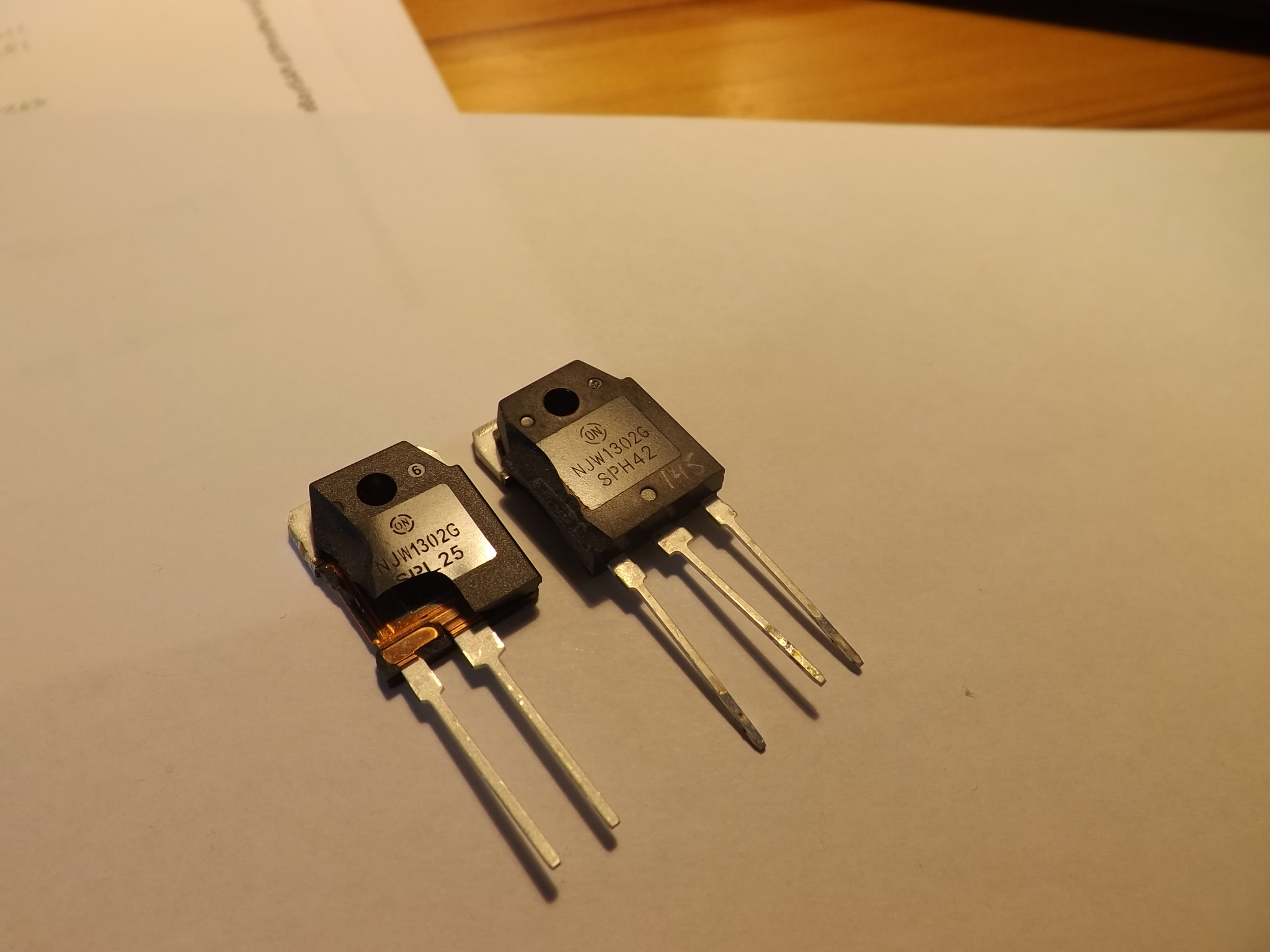

I enclose pictures of a proper NJW1302G power transistor next to one of my "bargain purchase" mistakes. You will see that the counterfeit appearance and markings look next to identical to the real tranny - until you crack them open and find that the chip inside the original ON component is 40 mm2 whereas the fake is a tiny 6.2 mm2 - a fake that will never even get close to the specs.
Same things apply for the ELNA LAO caps and OPA2134's. Go cheap and you will get fake crap - not worth it given the amount of hours you by then will have put into the upgrades.
