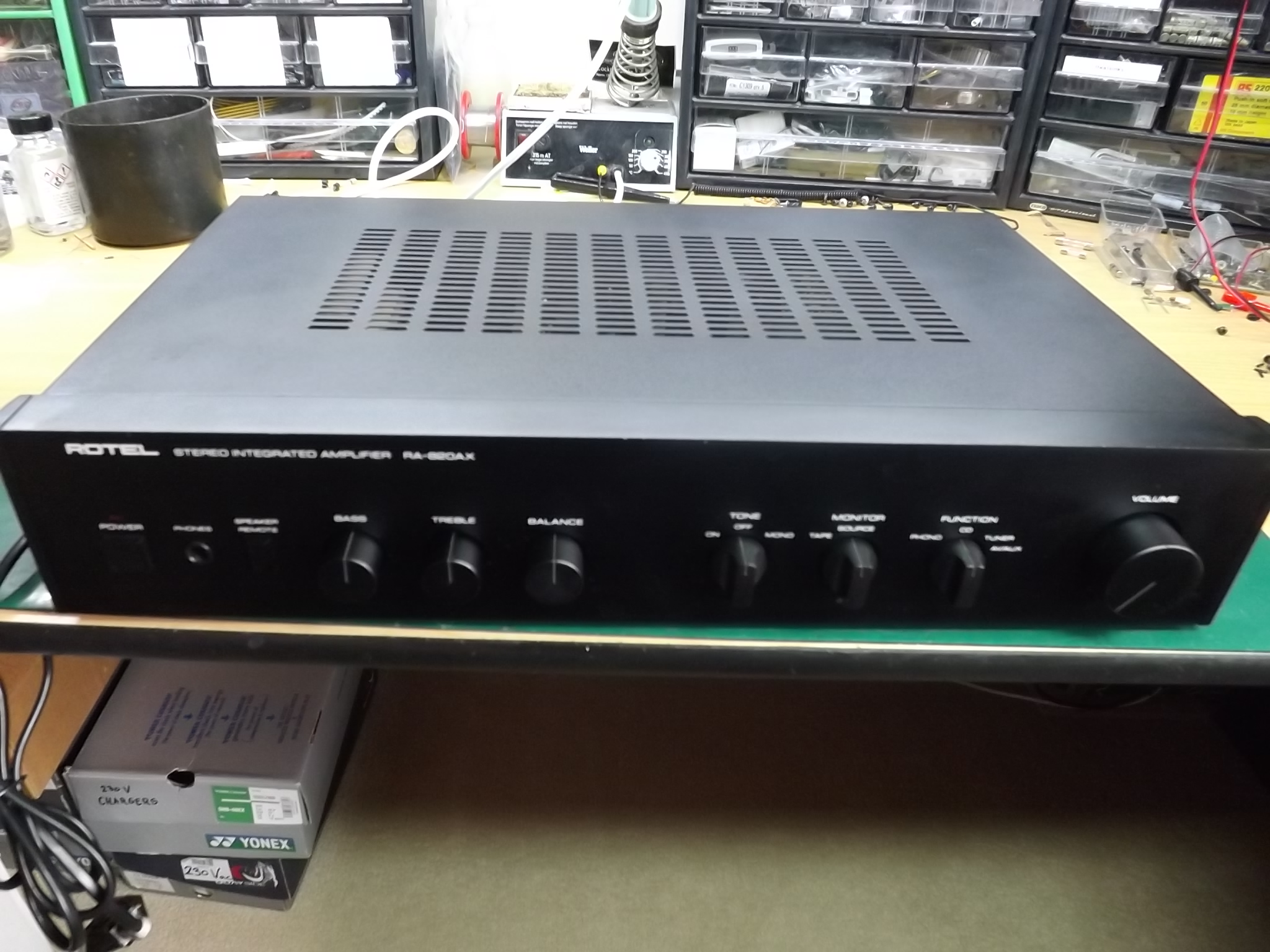

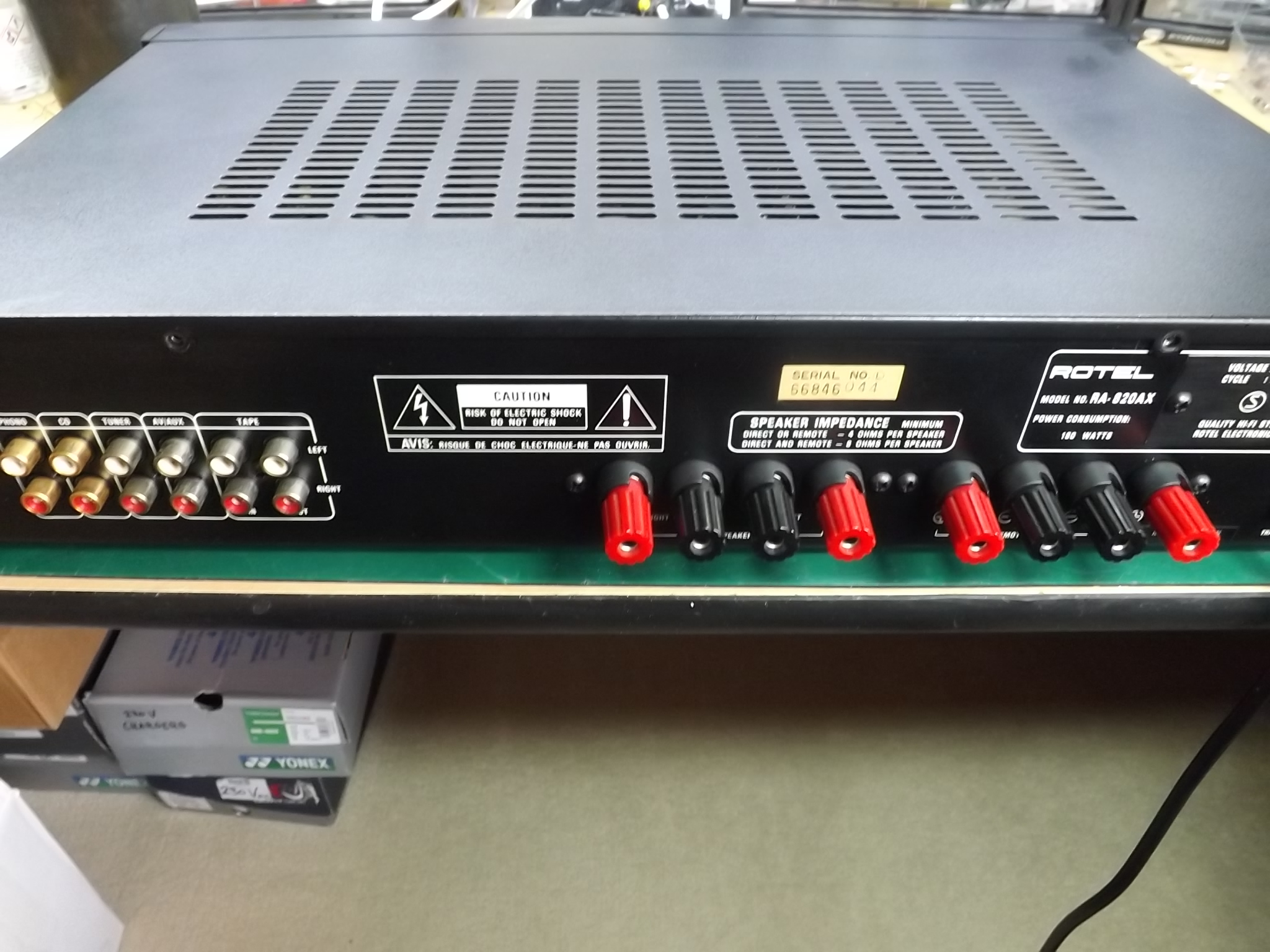

Until now, as alp1961 wanted me to upgrade his RA-820AX and sent it up to me from Portugal. It is really a "beauty of a beast" in really mint cosmetic condition, see pics.
And he agreed that I could stage and post the upgrade steps on the thread.
At least that's the plan - and it would take this thread back on topic. Stay tuned.

Before starting the upgrade:
Off with the top cover (six screws and slides back). Inside it is dusty, but not too bad and could relatively easily cleaned up when the components that need to be replaced are gone.
Power on (with finger ready on the off switch), but no smoke or visible problems. Nothing runs very warm.
First some initial DMM measurement checks (all shown as L/R):
Output offsets at speaker terminals: 78mV / 72mV
Bias setting: 4.2mV / 5.0mV
Supply voltages: +/-39.9V ripple: 48mVac / 34mVac
Regulated supply: +20V / -19.5V ripple less than 0.1mVac
All these measurements are not unusual for an old Rotel.
First listening test:
(Nicked borrowed daughter’s mp3 player) and put on headphones – at least both channels work, but no impressive detail - sound a bit soft and bland even for a mp3.
But anyway, so far so good.

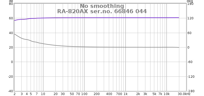

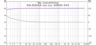

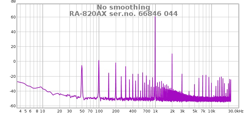

Then on to pre-update linearity (SPL and Phase) and RTA distortion (THD):
Linear from about 5Hz and up (blue trace), but phase already starts to increase below 300Hz (grey trace).
1kHz THD (L/R): 0.058% / 0.31% (!) - mainly 2nd harmonic.
Oops, something is not right. (Spec is <0.03%)
Time for some serious TLC and upgrades for this nice looking RA-820AX!

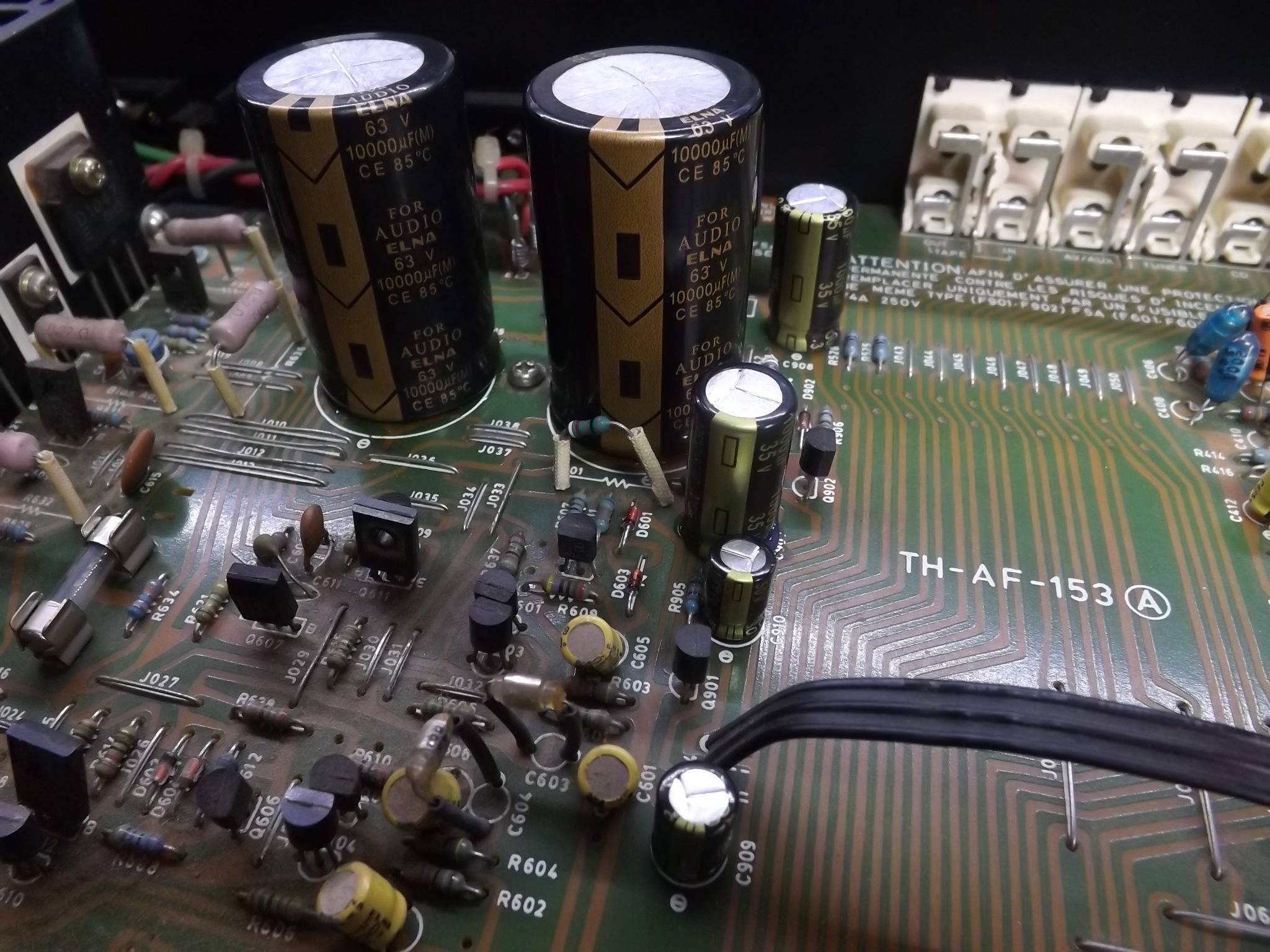

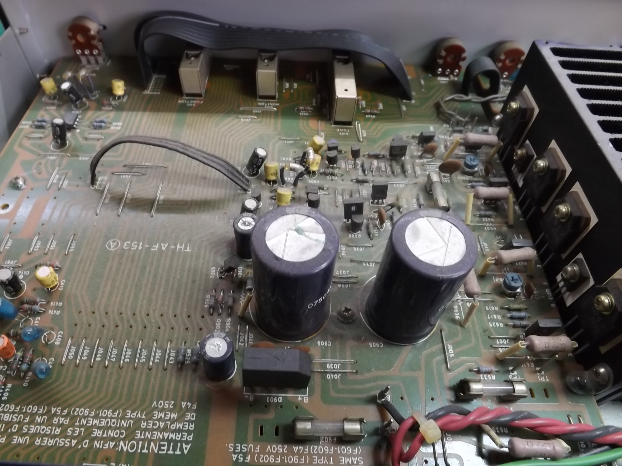

Stage 1: Power supply
The mains transformer will eventually be replaced with a toroidal, but for now I’ll leave the old E-core type in. Actually, replacing the tranny is optional for this upgrade as it involves soldering in the 240Vac mains voltage area. Some may not feel confident with that – for good reasons.
I remove all fuses, check their value and clean them, their holders and the pcb around them and replace. Then remove the bottom panel (8 screws around the edge and two M3 in the middle). It is good practice to keep all screws removed in a small container or plastic bag, they tend to easily roll away and go walkabout.
Then to the two big reservoir capacitors. Unsolder and remove the old, clean up the pcb and replace with new, larger caps. I use ELNA LAO’s 10,000[FONT=FreeSans, sans-serif]µ[/FONT]F 63V – other brands are available, but in my mind there is not much to be gained to go for eg. Mundorf’s at £££ a piece.
Before pushing the caps in secure them with a bead of non-corrosive glue or silicone on the cap bottom perimeter at the pcb interface. I use Dow 3140. Push in and solder the new caps.

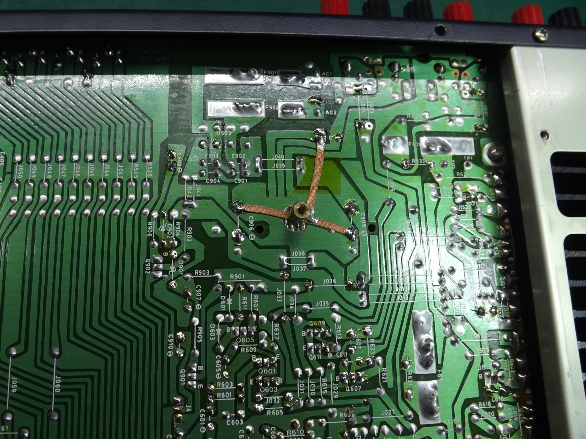

The layout of the 35[FONT=FreeSans, sans-serif]µ[/FONT]m pcb copper ground tracks are not good enough for proper hum rejection because of the very large currents that flow there. I use two broad 2.5mm solder wick copper mesh strips to beef up the conductivity, first extra securing any tracks that are crossed with some Kapton tape. See pic.
This ’milli-Ohmly’ connects the two cap ground pins and the transformer black wire pin to the ground star point.
Now on to the regulator circuit that produces the +/-20Vdc to the preamps. I plan to replace the preamp’s old NE3342s with OPA2134s (or LME49720s) – and they need to keep their supplies well below 18V. Unsolder and pull both zeners and the four capacitors (D901/2, C907/8/9/10). Clean the pcb.
I replace with 17V zeners to get a safe +/-16.5V and Panasonic FM 100[FONT=FreeSans, sans-serif]µ[/FONT]F and 470[FONT=FreeSans, sans-serif]µ[/FONT]F’s (actually 1000[FONT=FreeSans, sans-serif]µ[/FONT]F, as I was out of 470’s). Other ultra low ESR cap types would also do.
That’s it – stage 1 completed. Now turn the amp and DMM on and check that the reg voltages (easiest done on the jumpers leading to the phono preamp) are about +/- 16.5V.
Crack open a beer or have a strong cup of tea to get the heart rate down again before the next stage.:hbeat:
TBC.

Very very interesting. Thank you. Do you intend to perform the measurements also on the unit after the PS mods ?
I am always in conflict ... my heart tells me to just listen to the sound ... my brain instead wants to see the figures ... the THD graphs.
I turly think that noise and distortion are not a good thing to have in a unit designed and built to playback faithfully what is in the recording.
It would be very interesting to see if this first mod can already tame that 50Hz noise peak.
If not would it be possible to insert some kind of passive filtering before or after the big PS caps ? like two L or R ? i am not an expert
Again i will be following this thread with the greatest interest
Thank you so much again 🙂

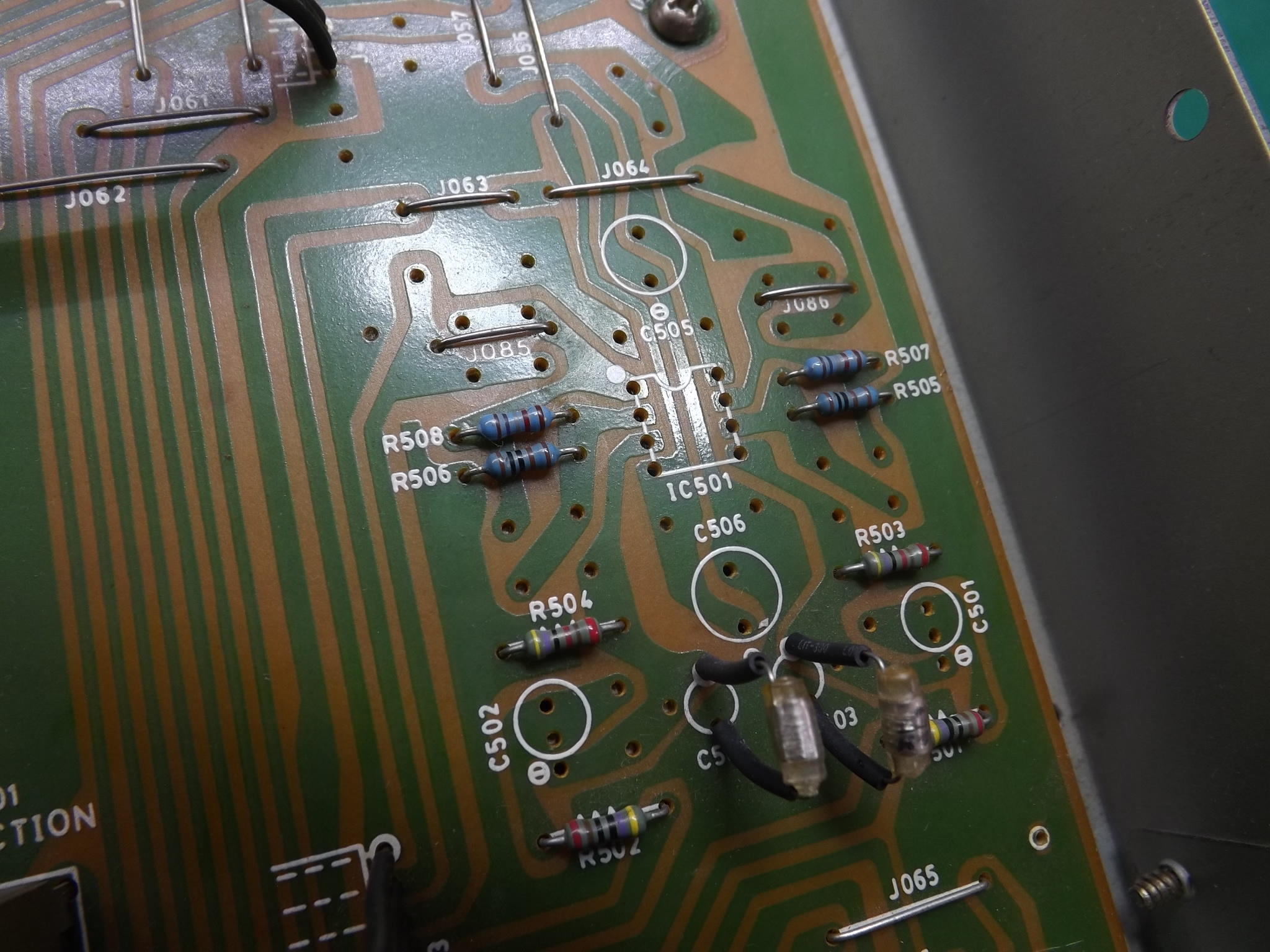

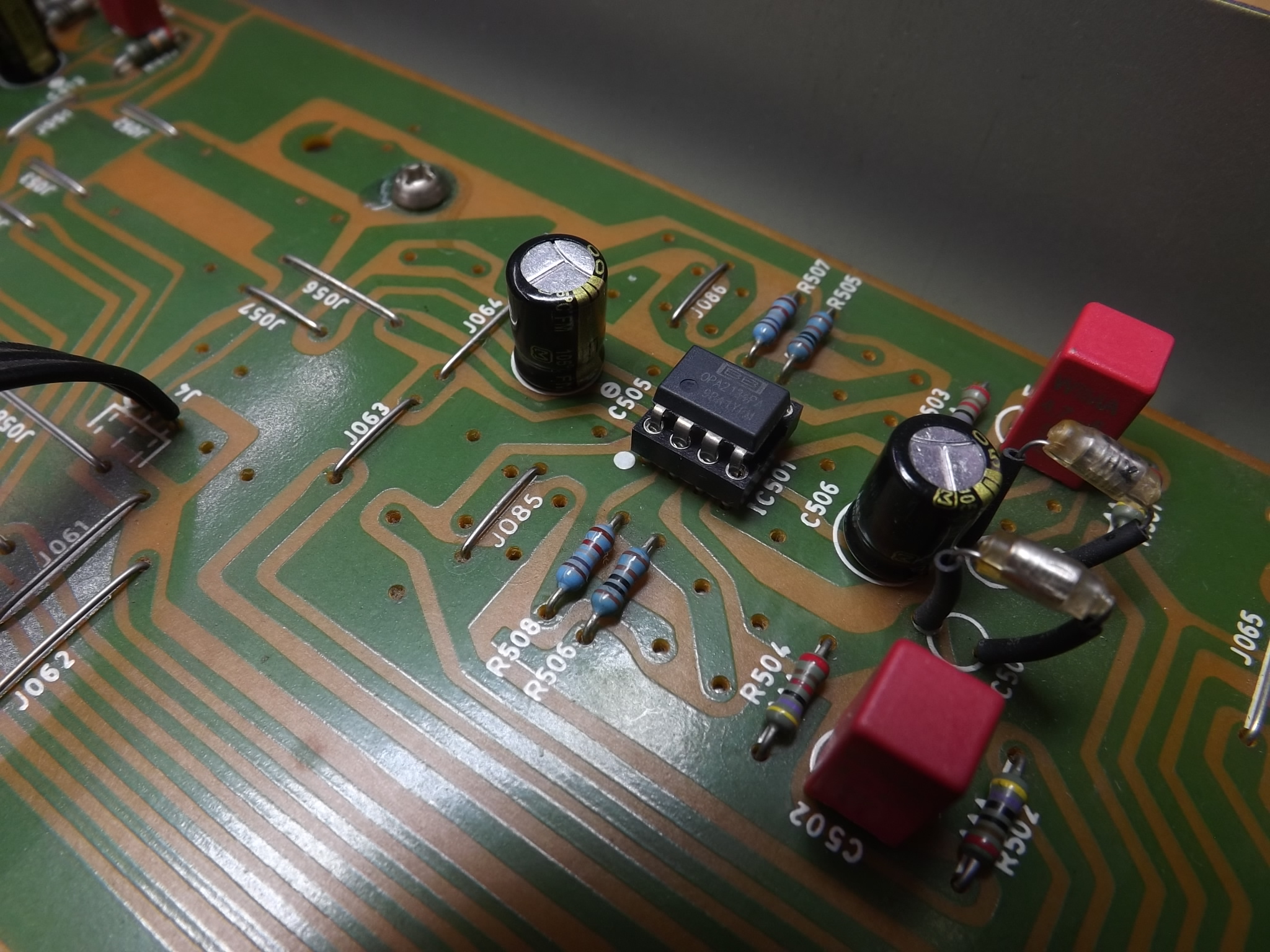

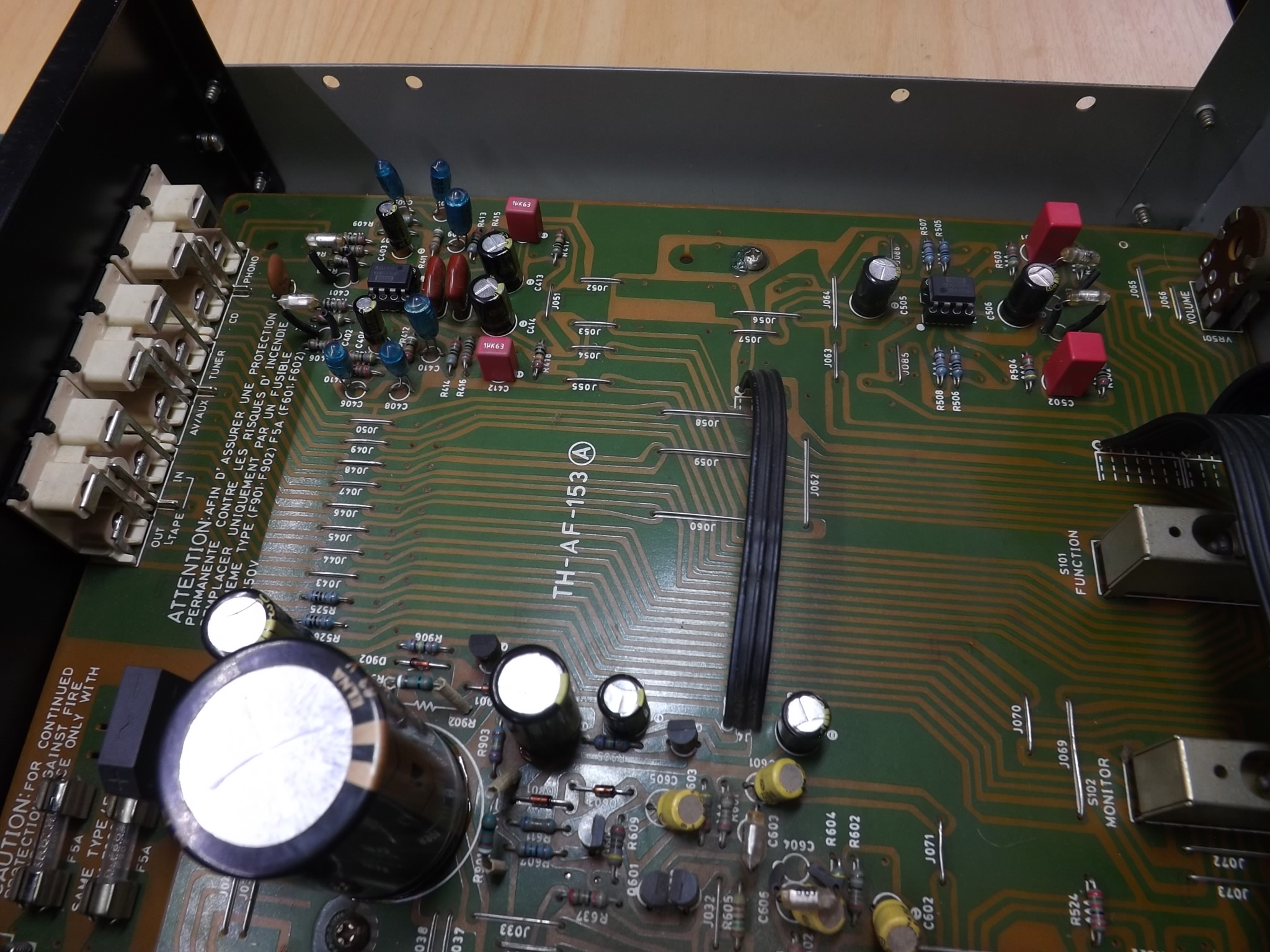

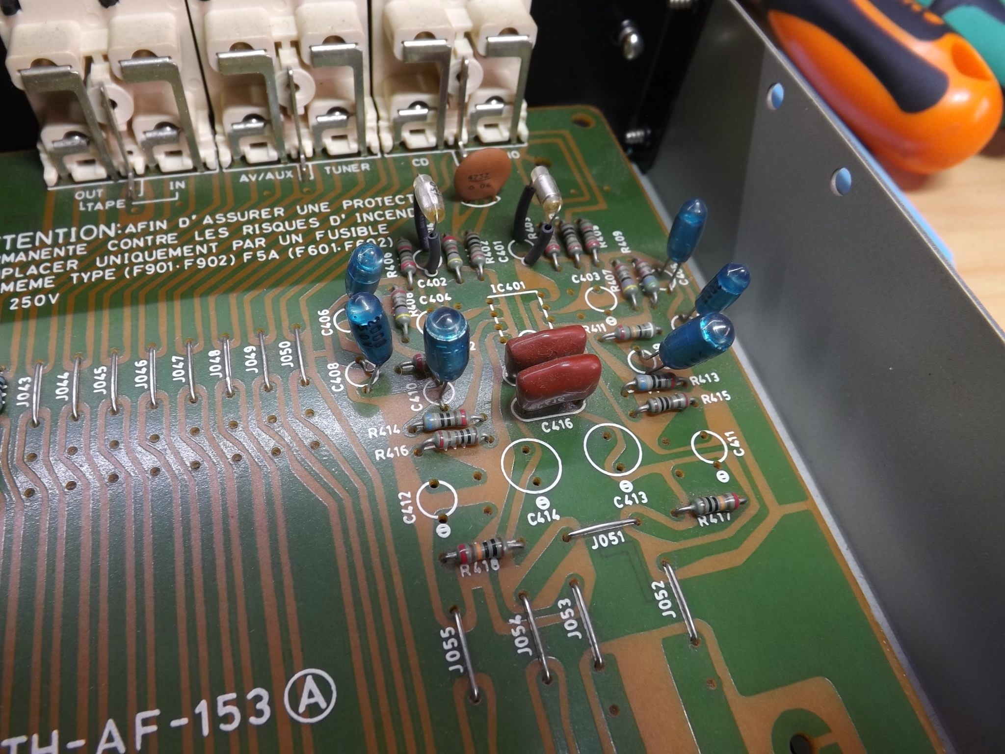

Stage 2: Preamps.
These are probably the easiest stages to upgrade, only 7 components to switch in the phono circuit and 5 in the preamp.
If you are absolutely sure that you will never ever play a vinyl record, you can of course leave the phono stage as is, but I always do the full Monty.
Phono RIAA circuit:
I replace the 100[FONT=FreeSans, sans-serif]µ[/FONT]F’s (C414/15) with FM’s, the 10[FONT=FreeSans, sans-serif]µ[/FONT]F (C403/04) with 22[FONT=FreeSans, sans-serif]µ[/FONT]F FM’s and the 10[FONT=FreeSans, sans-serif]µ[/FONT]F output C411/12 with 1[FONT=FreeSans, sans-serif]µ[/FONT]F WIMA film – moving the low frequency roll-off outside of the RIAA de-emphasis circuit.
Then, (perhaps most controversially) I replace the NE5532 with an OPA2134 or OPA2604.
Some argue that because most vinyl records were recorded through NE5532’s they should be played through the same. I beg to differ. The input bias current in the NE5532 is atrociously high by today’s sandard, and the stage is DC coupled to the pickup stylus, so you will have a standing current through this sub-mV magnetic sensor/generator which is not good.
The FET input OPA’s have pA bias currents, and will merely sit as low noise ”sniffers” on the weak pickup signal. And the sound is better for it IMHO.
But, I always put in a quality IC socket so the user can more easily switch back or to another opamp.

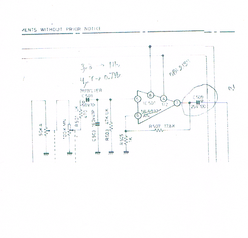

Preamp:
Again I replace the 100[FONT=FreeSans, sans-serif]µ[/FONT]F’s (C505/06) with FM’s as above, the input 10[FONT=FreeSans, sans-serif]µ[/FONT]F’s (C501/02) with 4.7[FONT=FreeSans, sans-serif]µ[/FONT]F WIMA’s and then another OPA2134.
This time I choose it because of that amp’s low offset which will allow us to DC-couple between the preamp and the power stage input, eliminating the two last remaining electrolytic capacitors in the signal path (C601/02). See pics.
(The schematic shows two 100[FONT=FreeSans, sans-serif]µ[/FONT]F (C505/06) at the output of the preamp, but they were not mounted in this amp – nor should they be.)
And that is stage 2 done. Getting more confidence? Good, as you will need it for stage 3.😉

Don't pay too much attention to the 50/100Hz peaks on the chart, it is an artifact within my measurement system - I get it on all amps I test, even the very high end types.
I have tried to put each of my high sensitivity meters and scopes on the signal - and there is nothing of that peak magnitude to be seen. Listening closely through high quality headphones also confirms this. No hum!

Please note that there is (one of the rare) serious error in Rotel’s schematic.
The two 100[FONT=FreeSans, sans-serif]µ[/FONT]F (C505/6) shown as connected to the opamp’s output pin 7 – is on the pcb in fact the decoupling capacitors between V+ (pin 8) and V- (pin 4) and ground, respectively.
DO NOT short these – or there will be smoke and tears!
Per
