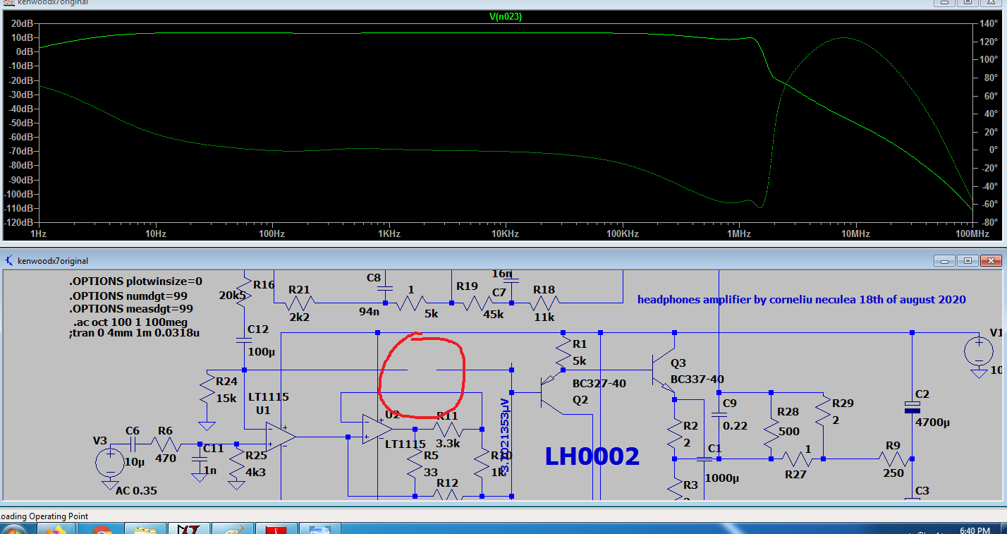

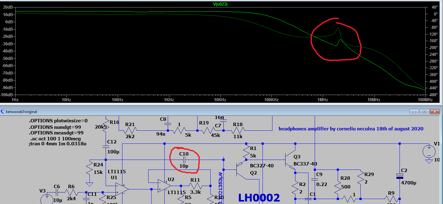

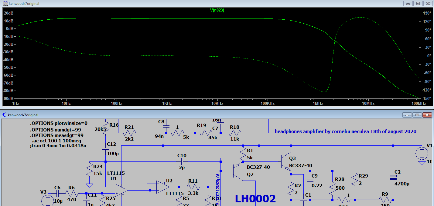

tvrgeek (is that a reference to the great the sportscar I think it is?) did put in an effort to explain things which is much appreciated.
I am not familiar with the term Transient Miller Compensation (TM) - is that akin to the two-pole Miller I tried 5 years ago in post #105 on this thread? Or is it what Douglas Self calls output-inclusive Miller compensation?
Which I had to reverse to a standard feedback Miller after getting oscillations. At the time I concluded that it was due to the hand taped RA-820AX layout and component tolerances. No Spice simulation could have solved this, as tvr also rightly points out.
Then, there are different types of Dominant Pole Compensations (DP). Stan Curtis who designed most, if not all the Rotels always used a DP shunt topology, loading the VAS transistor collector with 33k in parallel with 330pF to ground. (Plenty schematics showing this at the start of this thread)
This heavy handling of the VAS is what produces the round/mellow "Rotel sound". It definitely stabilizes the amp, reducing after-sales service costs - but actually many people just loved it - some still swear by this sound.
I didn't mind it until Chris (post #119) tempted me to go for some 'fun and giggles' - which I did. And I have never looked back, nor has e.g. Paulus in his RB-991 upgrades (see post #394).
dreamth on the other hand suggested (at least I think he did) that doubling the drivers would be great. Yes, that will help the output stage drive, but wouldn't it also double the (non-linear) capacitive and current load on the previous VAS stage? What can/should be done about that - except for adding an extra driver stage? Also, to what level should these paralleled drivers be matched to ensure that one is not doing all the work while its partner is just freewheeling? Does anyone know if there are any integrated dual matched chip driver transistors - as there are internally chip paralleled output power devices (Sankens, etc.)? If so, I would like to try it out.
Hoping that these questions could bring about a respectful, objective and constructive discussion.

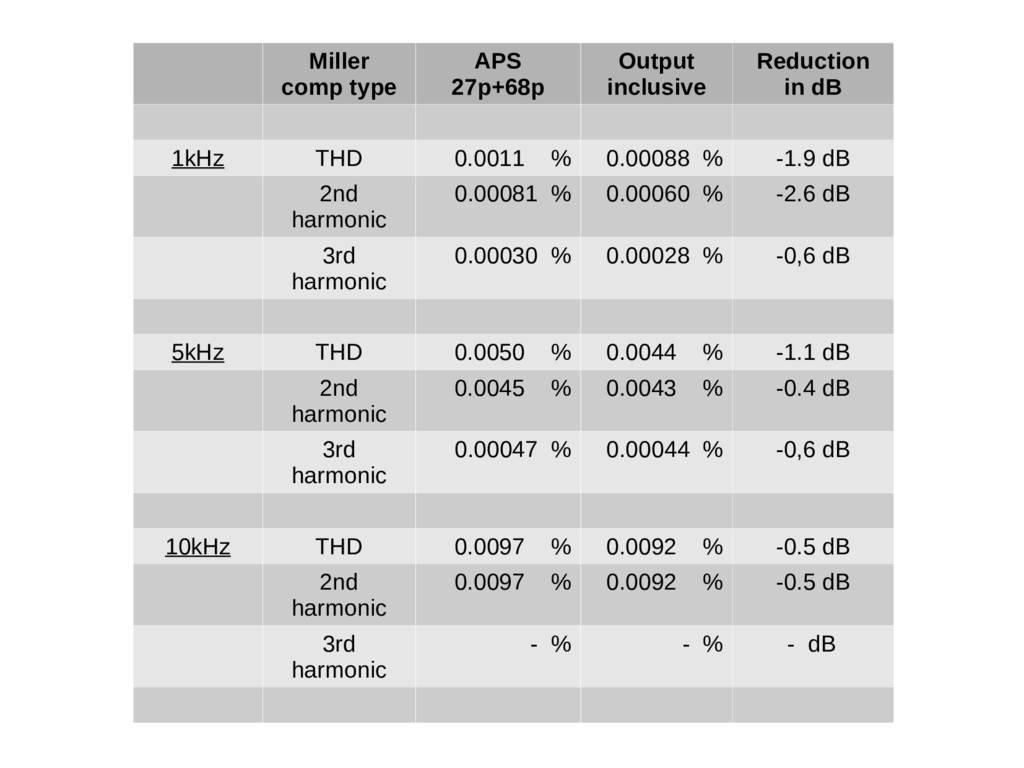

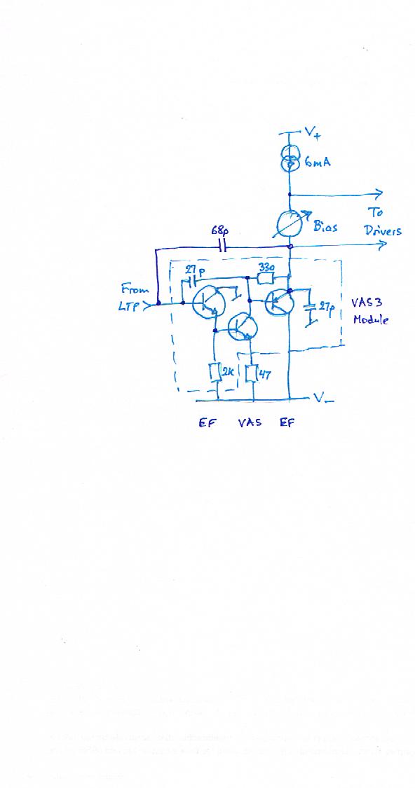

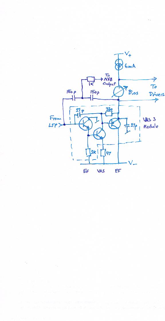

Anyway, back on topic, I decided to revisit the output-inclusive Miller topology to see if it really is superior. This time on a RA-931 which is so much easier to work on than the RA-820AX.
Please note that I had already modified the standard RA-931 VAS by replacing it with a ”EF-VAS-EF” SMT module (see post #318) and removing the Rotel’s DP shunt components as part of upgrading it to ”AngelP Signature” (APS) level.
The VAS3 module now has an internal 27pF NPO feedback Miller capacitor from the VAS output to the first EF base. And with only that compensation the amp is perfectly stable – at least in my setups. However, as there is no way of predicting what speakers or load someone may connect, I now always add a 68pF PS around the entire module, quite easily done because Rotel already had prepared a pcb placement spot for such a Miller capacitor. See pic.1
I have measured THD at 1, 5 and 10kHz, both before and after adding the 68pF across the module. No measurable or audible difference.
Ok, then after a bit of drilling, track cutting and soldering, I managed to replace the 68pF with two 150pF PS in series with a 1k resistor from their midst to the negative feedback track from output. See pic.2
And measured before and after. Comparison results in pic.3 Things to note are:
- The APS Rotel 1kHz distortion is already a very respectable -100dB (now an almost 30dB improvement!) and most residual is 2nd harmonic. Odd harmonics have vanished into the noise floor.
- Distortion figures do rise with increasing frequencies, but I have not found much difference between the two Miller topologies. No oscillations whatsoever.
- Yes, the "output-inclusive" VAS Miller typology is better overall, but at best only by a few dB.
