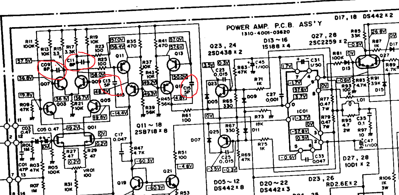

Before doubling any transistor you may try splitting the emitter resistors and connect them to output as both simulations and some good authors recomend that too for lower distortions:
Firstly, as a general point. I think that ginetto asks some quite reasonable polite questions and he deserves polite, non-condescending answers to these.
Moving on, I think the jury is out on whether or when it is desirable to split the driver emitter resistors. I know that there are different views on this, but AFAIK all Rotel output stages use an emitter follower topology which allows the drivers to actively and quickly cut-off and de-charge the output transistors by reverse biasing them when asked to do so.
If you split the emitter resistors to the output node you will reduce that active ability significantly and actually increase crossover distortion?
But, I haven't tried it out and have no real life measurements to confirm either yes or no.
Doubling the output transistors is an interesting point. I can see some physical problems to do so in the crammed RA-800/900 series with their small heat sinks. I suppose that you could piggyback another set on top of the existing, but I haven't tried that.
The old SANYO 2SD1047 and 2SB817 do seem to get tired with age. Their hFE drops quite a bit, the NPN's more than the PNP's. And they are already long discontinued devices.
So whenever I have an amp with one or more blown Sanyo's I replace all with NJW0302 / NJW0281 which works great.
I have also tried Sanken types (can't think of the type numbers off my head). I believe the Sankens are actually internally paralleled devices on one die (?) which could be an easier and better way of multiplying output transistors.
Any which way, they all sound great with no measurable and very little audible difference between them.

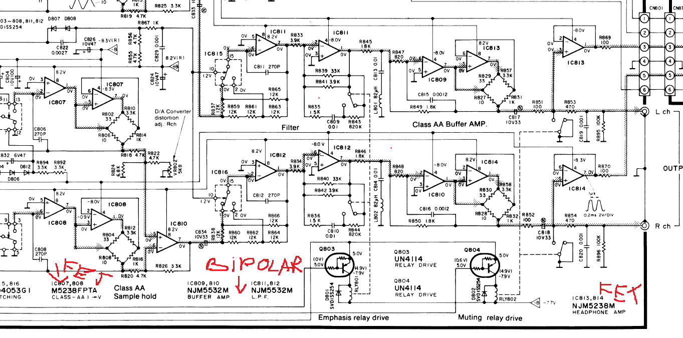

He may change the pots to 10k if he finds suitable ones and go with njm2043 which as low noise as one can expect cheap and very good.
He might study a bit this schematic as to see that inverting configuration with bipolar op-amps isn't necessarily noisy either...as this was one of the best cd player ever made and still outperforms tons of modern digital audio.
As he likes to tinker he might find suitable a 10k log-antilog potentiometer in an op-amp feedback loop and he can lower the input in a smarter way with inverting topology, thus being able to handle high input signals with lower distortions.

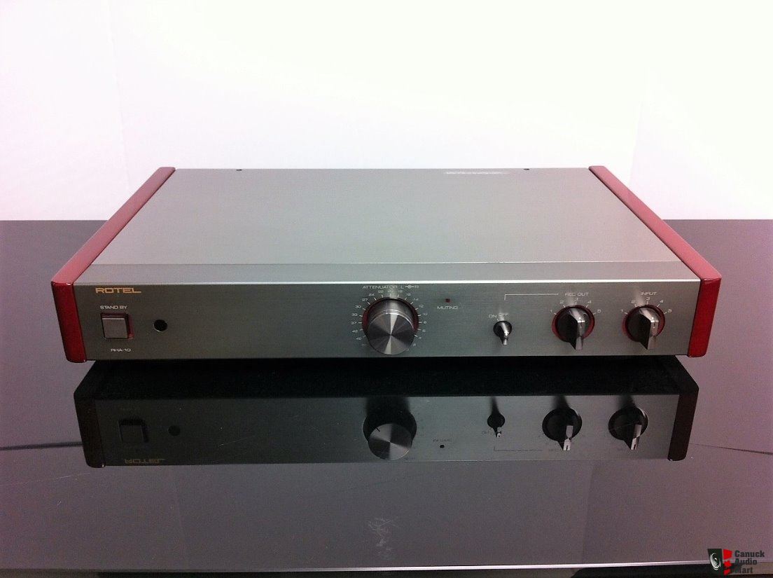

And actually if you look up in the Rotel catalogue (i am attaching a pic of the old TOTL Michi preamp) you will see that they are gone with the wind ...
Why not pruning a little ... the loudness era is ended.

This is great. I think i have understood. But .... who really plays these days with the balance and even more with the tone controls ? the lunatics ?
Fair point, but not every lunatic lives in a spacious mansion with a perfect listening position. And if you are directed by the Wife Acceptance Factor (WAF) to remove the speakers to the corners of the room, you may be tempted to fiddle with soundstage balance and/or reduce the bass speaker output.
But hey, of course not me, I live in a perfect house with a perfect wife and I will always stand in the perfect listening position whenever she speaks:cheerful:
Anyway, I have indeed been asked to modify Rotels to completely bypass these circuits because all the volume control was done in a remote controlled DAC - and it is very straightforward to do. I can show you how if you want.
