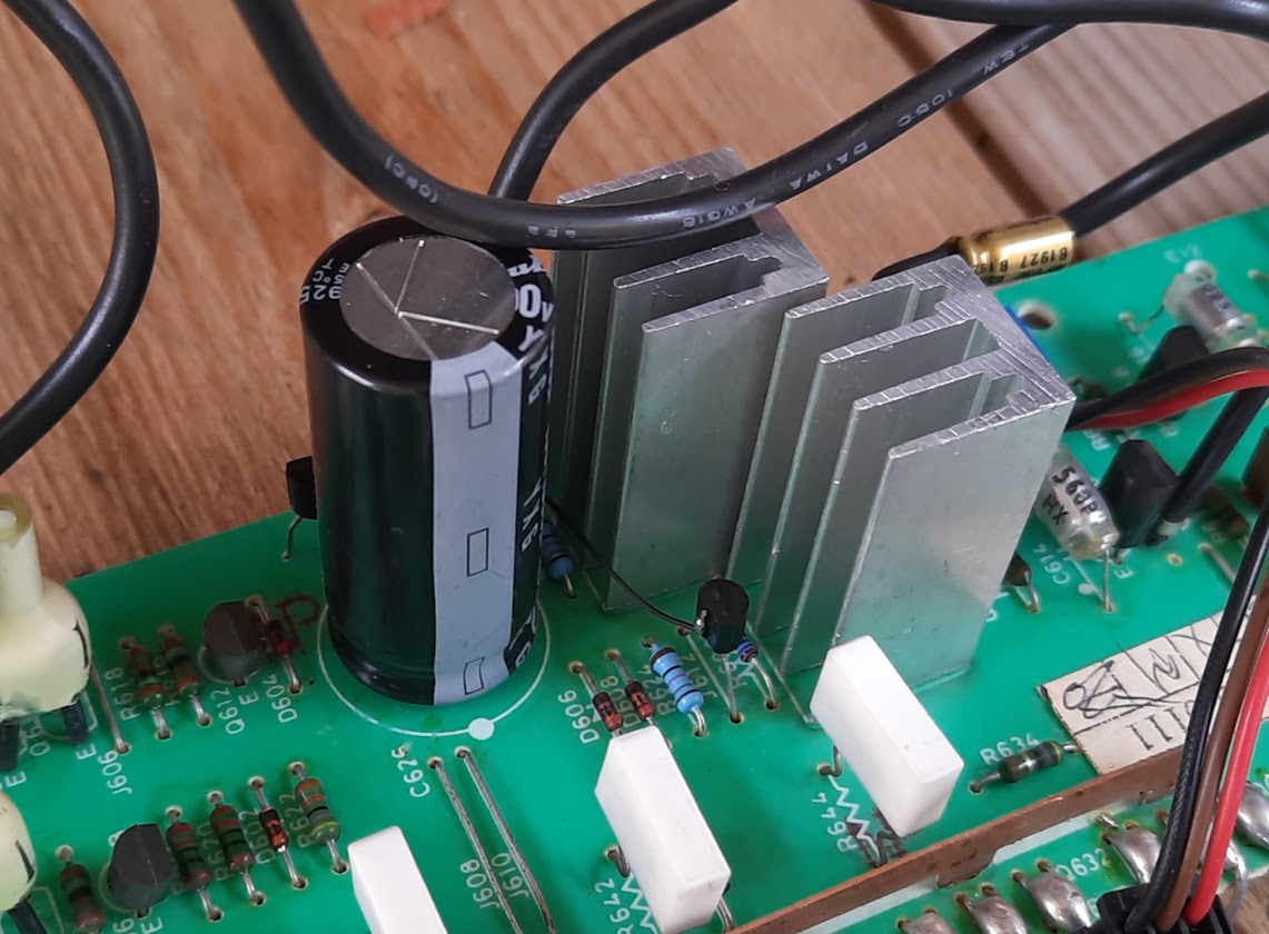

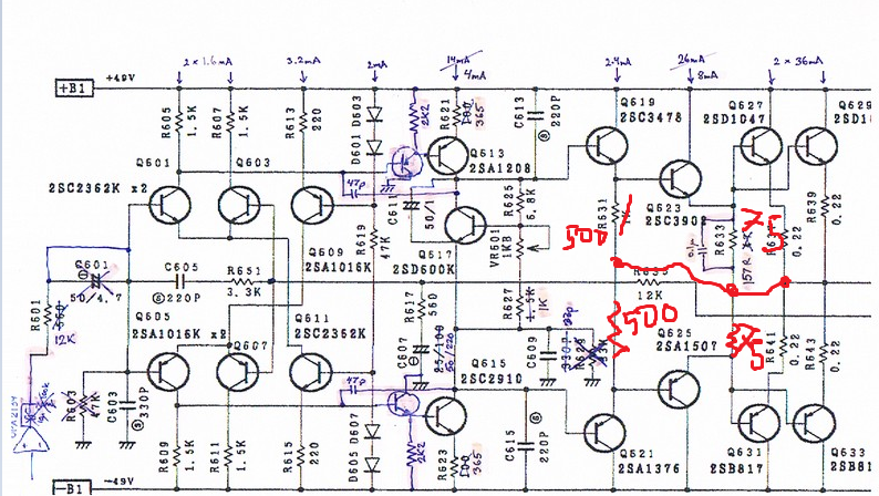

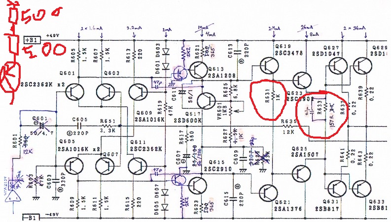

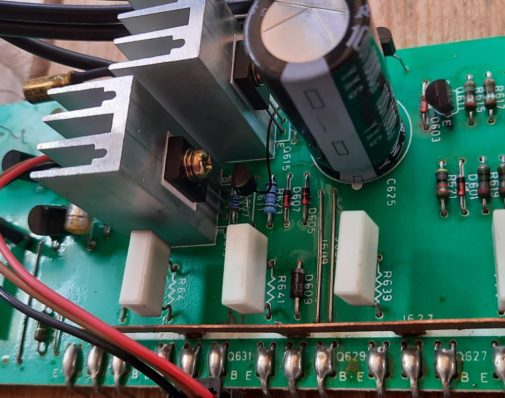

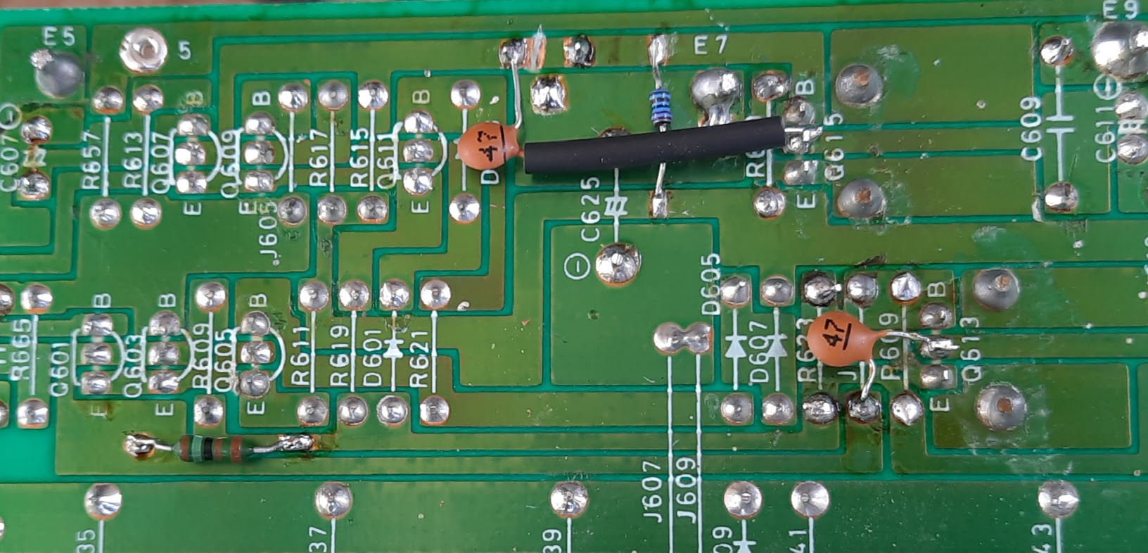

Taming the RB-991
Hi there,
I have reached my goal in overhauling and upgrading my 2 Rotel RB-991's

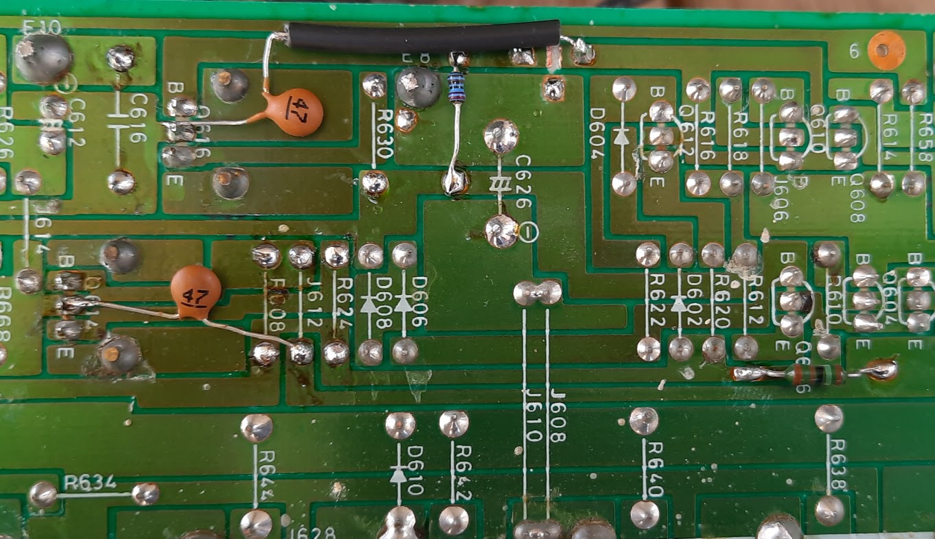

A few days after my last post the mail came through with some small parts Per send me.
The purpose of these parts where to furthermore take of the strain of the VAS.
Per designed this last (?) step by placing an emitter follower at the VAS
This step would require modding like cutting a pcb trace, some drilling to fit transistors and cleaning pcb traces to solder.
Things i never did before but with all of Per's upgrades in mind who worked out beautifully sound wise what would i have to lose.
He gave me some pointers in how to proceed and then it was time to do it all
The only risk was that the amps could become to sound very clinical/cold 😀 Rotel and sounding clinical, 2 words that doesn't go together in one sentence well dont you think 😉

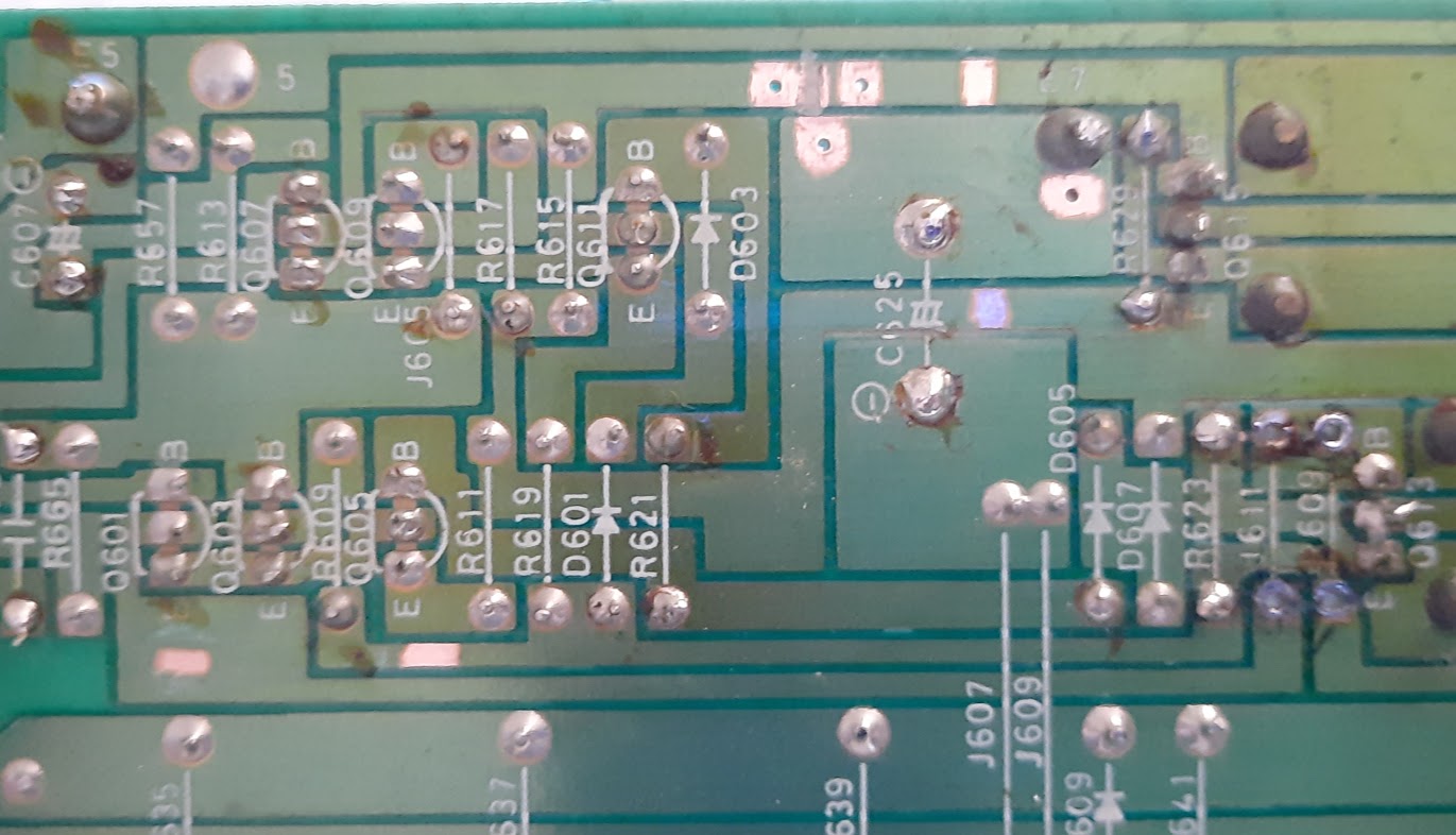

I pulled the amps apart and went one step further then before, i also completely took the heatsinks of the pcb's.
The upgrades before i just bended the pcb a bit from the heatsinks, it gave me just enough space to work with..
The next challenge was to exactly pinpoint where the parts should be assembled because left and right channel are mirrored, Per gave me a hand with a kinda "see through" schematic so i could see the pcb traces under the pcb in relation to the topside. That worked out great!
After all the scraping, careful drilling, disconnecting and reconnecting components i assembled and reconnected everything and started with one channel only to see if this worked, no ac on the output, no bad smells so i switched on the dac, e voila, music came out of the loudspeakers 😀
Happy person indeed!

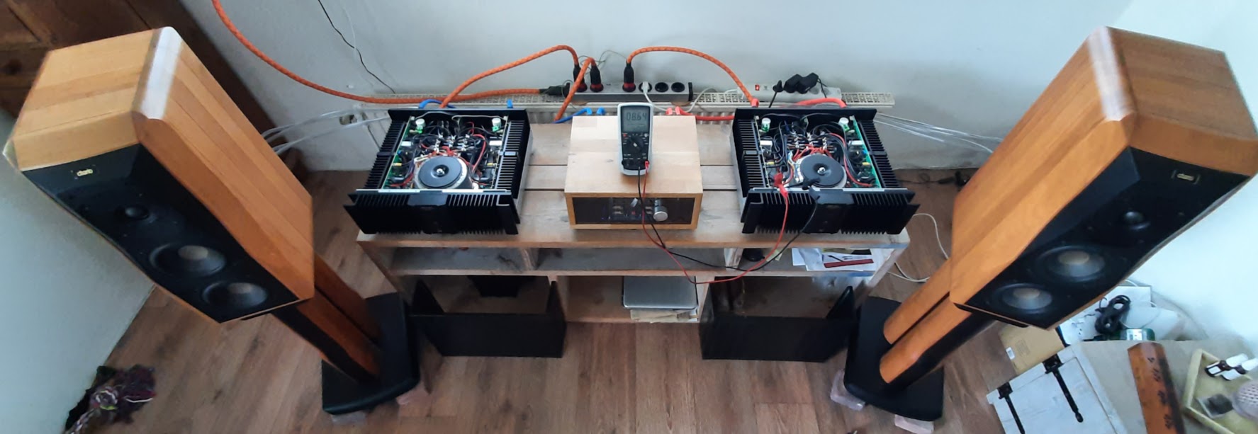

How does it sound?
Well, as i type this post it is a work in progress but the word WOW is appropriate 😱
These amps are now completely different, again, after the last upgrade......which already sounded much better.
Loudspeakers are now completely invisible.
Superb soundstage.
Clean sound without losing emotion
The amps sound if there's a weight lifted of there shoulders, it sounds without any effort at all.
More accurate.
Voices gained presence.
Some mid frequencies are a bit in the face but i think amps need more hours to settle....
Lows are tight and more subtle then before but then i heard Billie Eilish and the wooden floor vibrated ��
I know that Rotel is famous about damping factor. (RB-991 >500
These amps already have serious grip on difficult loudspeakers but i think it stepped the grip level up a few notches ��
I turned down the BIAS from 7 to 5mV which does nothing with the sound but decreases temperatures considerable.
Many, many thanks for your guidance and assistance in helping me to do this Per.
My music and my stereo are my sanctum and provide me with moments to clear my very busy mind so this means a lot to me :worship:
Cheers, Paulus
Stay safe and healthy

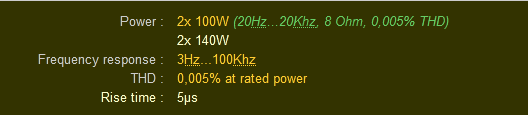

Hi ! first of all thank you so much for this extremely valuable thread.
I have some questions:
is there a way to reduce the 50Hz noise maybe ?
I read about issues related to balance control ... why not bypass it ?
And the tone controls are not likely to worsen the figures when engaged ? so why to keep them ?
Is all the gain in the 1st op-amp really needed ? if i am not wrong the amp stage has already a voltage gain = 18 times.
I am very interested in the 820ax mods having one myself. I see that the discussion on this amp stops earlier in the thread.
I would vote for a specific thread for each amp to be modded unless the schematics are very similar of course. Maybe different models with the same schematic can usefully grouped together.
Thanks a lot again.

Hi ginetto,

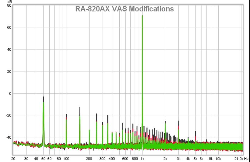

You touch on an issue that has bothered me quite a bit over the years, but I wouldn't (and has decided not to) put too much desperation into the 50Hz peaks you see on these RTA traces.
It is clearly a feature of my XonarU7 external sound card and PC measurement setup rather than a real issue. Some sort of inductive or capacitive hum loop interference or sound card pickup which I have struggled long and hard to eliminate - I am afraid so far without much luck.
By now, I have measured other amplifiers costing >£10,000 on the setup and their RTA traces all show the same peaks - admittedly, at varying levels.
I am not running or employed by a rich business, just striving to make great audio affordable for people, hence I just can't afford a professional Audio Precision RTA box (or even similar) to get proper reading results.
But, if the trace peaks were actually true, you would probably be able to hear a faint hum or buzz either in headphones or speakers - and there are absolutely none - niente, nada.
Sometimes we all tend to put too much trust in nice digital result readouts even with several decimals - without properly scrutinizing the ways and wherefores which may have led to them (and maybe being plainly wrong).
Ok back to earth, you can use the 50Hz and harmonic peaks to see if there is some serious problem and it definitely highlights the hum field differences between toroidal and old e-core mains transformers. And you can see the harmonic peaks going up into the audible range if something else has gone awry.
And yes, I have tried cutting out balance and volume pots, bypassing tone controls etc. - but as they say: good try - but no cigar - at least not on this 50Hz setup issue.
You could leave out all these controls and the opamp pre-amp circuit and then just increase the gain of the power amp stage - that would be like in the Rotel RB power amp range. You'll just need to ensure that all attached signal sources have an option to adjust their output levels.
Higher gain means higher CMMR and PSRR...many manufacturers deliberately increased the gain in order to have a greater imunity...You have an input potentiometer to deal with the excess output most of the time and the SNR being a balance between voltage gain and input current noise its usually good enough.Besides the greater the gain, the greater the stability too...
not really...that is just a hype most of the time.truth is that equalizers are welcome a lot more than we like to believe.By the way...the mastering engineers use them a lot to have a decent recording and while they look at having a balanced outcome, every ear is different...

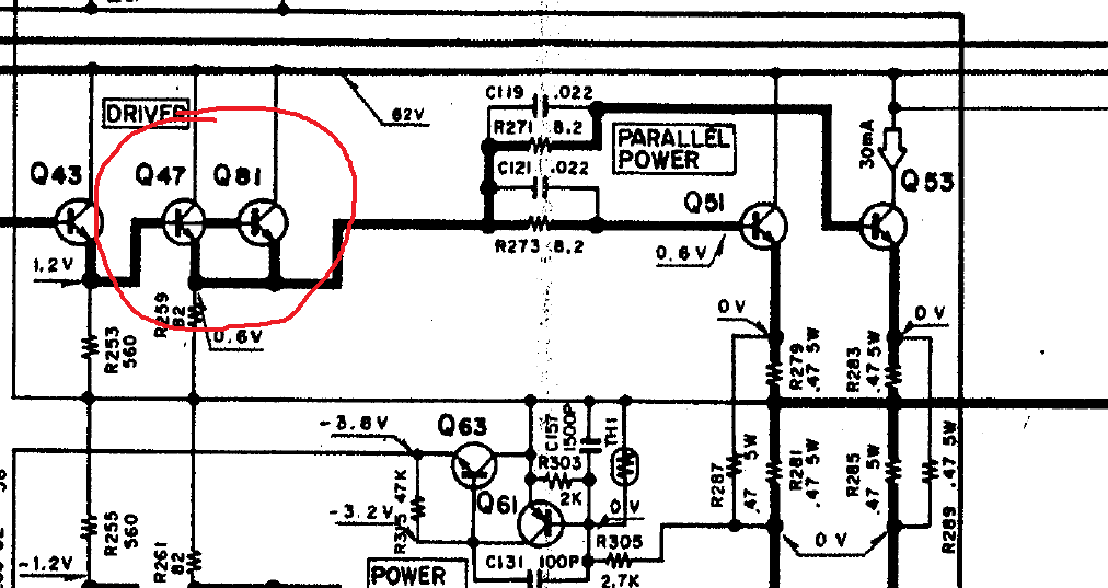

really funny to think of making the VAS better and not looking into who's driving the final stage...
you rotel has one pair of 10w , 120mhz drivers for paralleled 20mhz final transistors.
this one has paralleled 25w, 200mhz ft driving 80mhz paralleled final transistors...

Before doubling any transistor you may try splitting the emitter resistors and connect them to output as both simulations and some good authors recomend that too for lower distortions:
