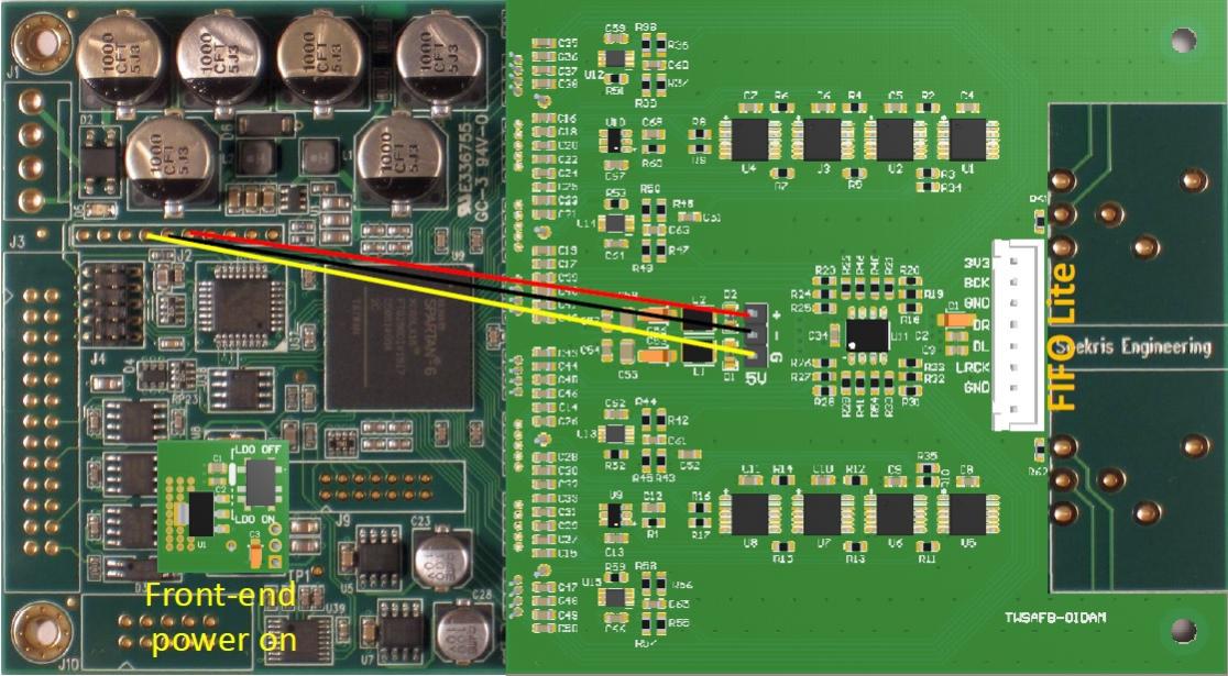

There is an RC filter to feed the VCXO: with some skills you could replace the R with a header..... just a jumper would activate/desactivate the oscillator. But I believe the filter is needed when jou need the oscillator. A tweak is the feed the oscillator from an external supply or with a direct line from the LDO (and not use a feed-line of the FPGA)
The problem is that I need to disconnect even the micro and the FPGA so removing the LDO is the simplest way.
You can always stick some shielding in between, the 'flying connection wires' should be as short as possible.
I believe there will not problem of shielding, however I will measure the RFI/EMI with a sniffer.

The upgrade is definitive as the DAM1021 will also work in the original mode without any need for further hardware changes.
The I/O pins of the SPARTAN6 are high-impedance before and throughout the power-up and configuration processes.
Indeed the SPARTAN6 holds the POR state (Power on Reset) until all the supplies reach their respective thresholds.
Only after these tresholds have been reached the FPGA begins its configuration process.
Therefore a small board replacing the on-board 3V3 LDO is sufficient to switch between the original from the factory and the upgraded DAM1021.
This way when the LDO is disconnected the VCXO, the FPGA and the micro are disabled.
In order activate the upgrade the power supply has to be connected from the DAM1021 to the Interface board (black, red and yellow lines in the picture) and the switch installed on the new little board has to be shifted in "LDO OFF" position.
While to return to the original configuration from the factory the above power supply has to be disconnected and the switch has to be shifted in "LDO ON" position.

I could add a converter from I2S to the custom DAM segmented sign magnitude protocol but I should use a FPGA and the FPGA is already in the FIFO Lite that accepts just I2S and can implement state of the art master clocks.
Moreover if I would provide I2S input in the interface board you should install anyway a FIFO.
I'm pretty sure that for the DACs like the DAM (and all other DACs latching on LRCK) the FIFO Lite will perform much better than any other FIFO buffer available.
