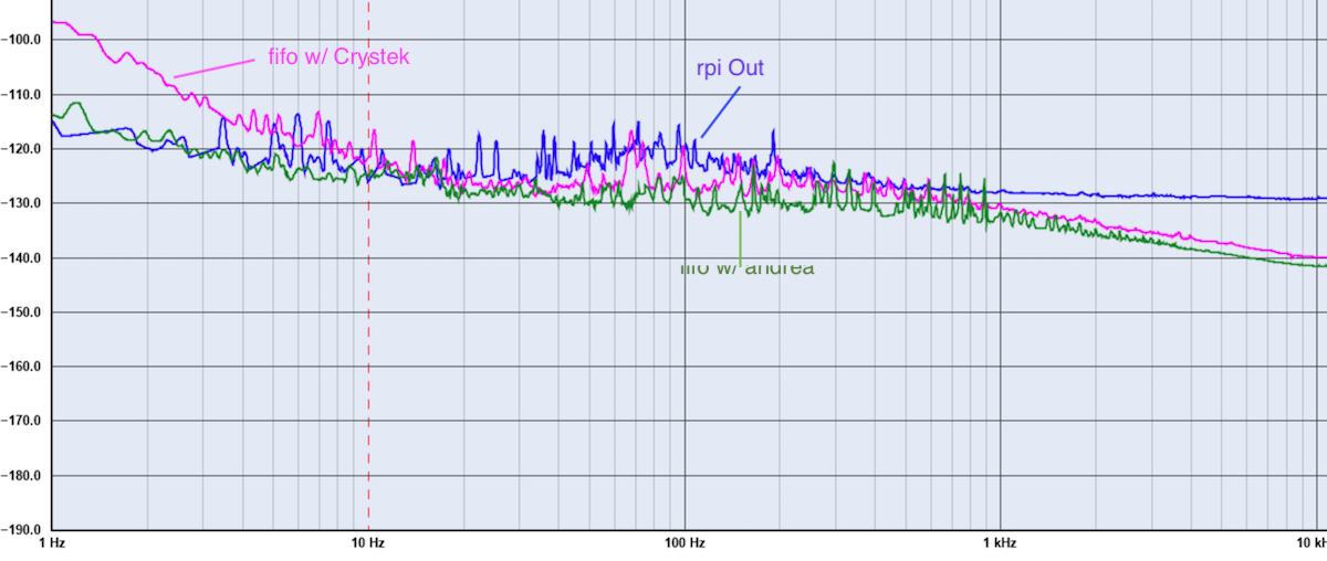

If it is a standard RPI, its close-in pn is remarkable. -115dBc/Hz at 1Hz given that: Raspberry Pi B+ Digital Audio | H i F i D U I N O
Something is fishy here 🙂

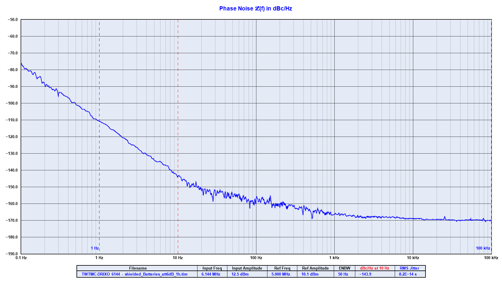

It is better than the andrea Driscoll 6.144 MHz at 1 Hz.

Is it just a coincidence the Rpi out and andrea clocked fifo closely align at low frequencies?
When you say crosstalk, I assume you don't mean between input and output
I think yes, the Driscoll oscillator runs at 22 MHz while the RPI LRCK was measured at 192kHz, there is a huge difference between frequencies.
The RPI LRCK is divided down several times therefore the phase noise decreases.
Below 10 Hz from the carrier the FIFO with Crystek oscillator has worse phase noise, maybe because of the higher phase noise of Crystek.
It's difficult to say because it looks like the phase noise is dominated by the noise floor of the FIFO.

However since the master clock is divided down almost 100 times the phase noise should be better.
Yes, I will measure the LRCK phase noise that's the critical clock for the DAM1021.
Maybe I will also measure the master clock from the SI514.

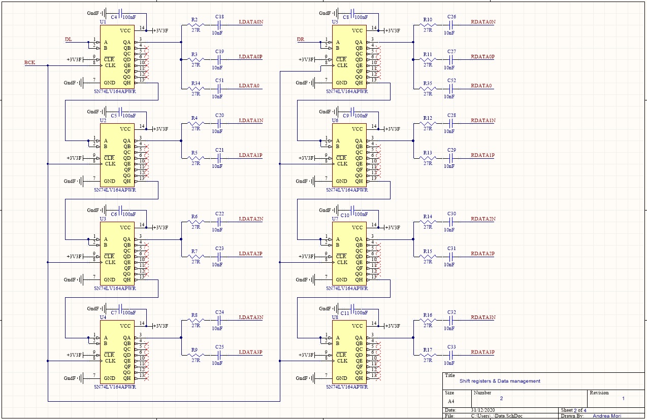

Your findings about the implementation:
>>Indeed every signal coming from the FPGA is decoupled using a capacitor.
LRCK and DATA have also a pair of resistors on the 595 input pins. These resistors set the the input pins of the LVC595 to half VCC, around -2V (one resistor is tied to -4V and the other to ground) for the upper banks and +2V (one resistor is tied to +4V and the other to ground) for the lower banks.<<
>> What was not clear?
did you ever started to implement (providing over / under run states) and measured/detected those states? Also easy to listen using a 10kHz sine 😀
Hp
Well, it's not my design.
However the listening will tell if it did worth.
I believe it will worth because anyway it will run with better timing using real low noise fixed oscillators.
We are still testing the FIFO, I will let you know soon.
Although I'm sure there will be any of the issues you have pointed out because "the math is not an opinion".
Finally the FIFO balancing will work similar to Ian's FIFO and Allo Kali and no users have reported such that issue using these devices.
