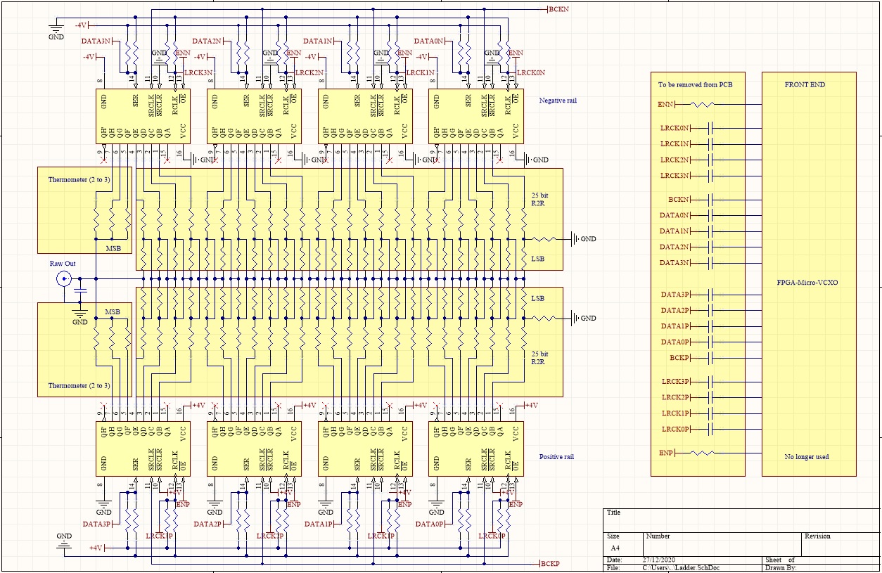

Both options are natively supported in their hardware: PCM and DSD
Well, in ring DAC hardware configuration (DSD PWM) the error in the ladder can be cured a little averaging the tolerance of the resistors.
In PCM DAC hardware configuration nothing can be done to cure the error in the ladder, the accuracy depends exclusively on the tolerance of the resistors (and on the casuality of their combination).

The following pictures are:
- DAC schematic (switches and ladder network)
- DAM1021 PCB with the highlighted parts to be desoldered in order to install the interface board (36 capacitors and 4 resistors)
Next posts I will explain the update.

Yes, but the ring DAC works in a different way, it's not a 1 bit DAC, it uses a ladder network and the signal turns around the ladder so the tolerance of the resistors is averaged.
However the DAM1021 is a PCM DAC, so what happens in a PWM DAC does not matter.
