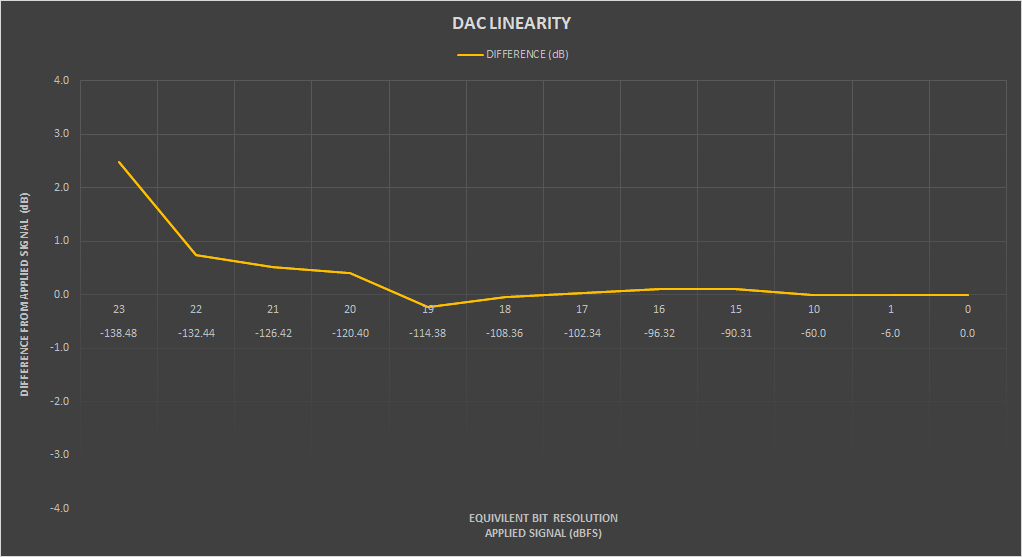

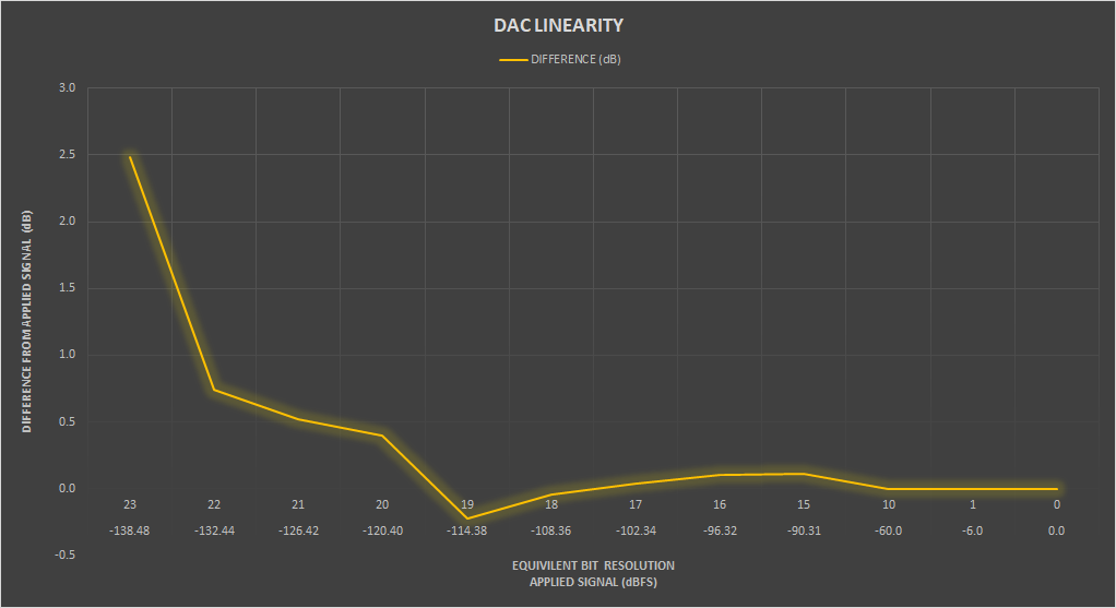

Because ASR says about the DAC1421 re: level linearity:
"The Soekris dac1421 produces near ideal response with variation of just 0.5 dB at -120 dBFS (20 bits). The limit of measurement is about 0.2 dB so this is almost as good as it gets."
Review and Measurements of Soekris dac1421 Multibit DAC | Audio Science Review (ASR) Forum
Ah, Amir and his measurements...

From ASR.
But not by Amir. pp
Soekris DAM1021 R2R DAC Measurements | Page 3 | Audio Science Review (ASR) Forum
Soekris DAM1021 R2R DAC Measurements | Page 6 | Audio Science Review (ASR) Forum
But not by Amir. pp
