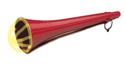

I tried to work this out. Its not a droplet shape (the exterior is) it is a tapering tube. The mouth, biggest bit should be the same size as the driver. I think the one in the link below is only 50mm in diameter though.
I thought about adding marine horn this to mine. If it works well as a horn, surely it must work well in reverse decreasing the rear wave energy?
http://cgi.ebay.co.uk/ws/eBayISAPI.dll?ViewItem&item=180405549611#ht_3400wt_941
What you need to do is now find a hemi-spherical bowl that fits the front. Sort of like the yellow "sqiggles" in my sketch,
dave
