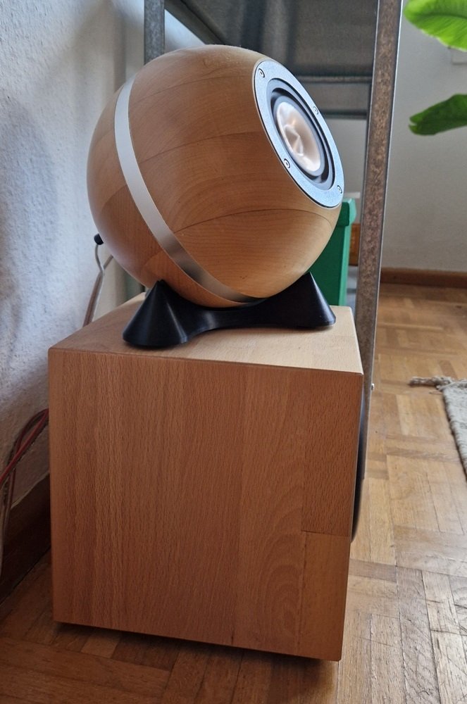

Yes, a sealed box for W6-1139 as sub to go with the sphere.
The point of using a sphere is that it has a well defined Baffle Step response.
That is the natural crossover.
The sphere is driven full range.
The sub has a first order low pass to suit the baffle step.

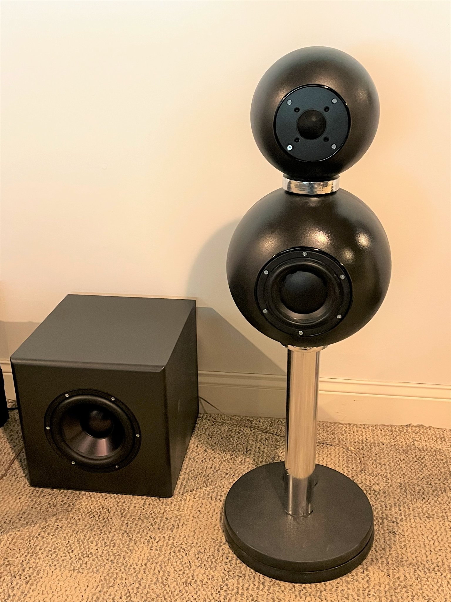

I agree with Patrick's point on the sphere and character. My Project has gone well though i struggled with crossover as it is a dual concentric woofer/tweeter unit, i am happy with the results. I have to add that size does matter and only with the accompanying 12" powered sub is it covering the 35Hz to 19k-Hz.
After 14 years, the final touch is almost ready, waiting for the 3D printer.
Had to try a few before getting the right proportion.
Patrick
