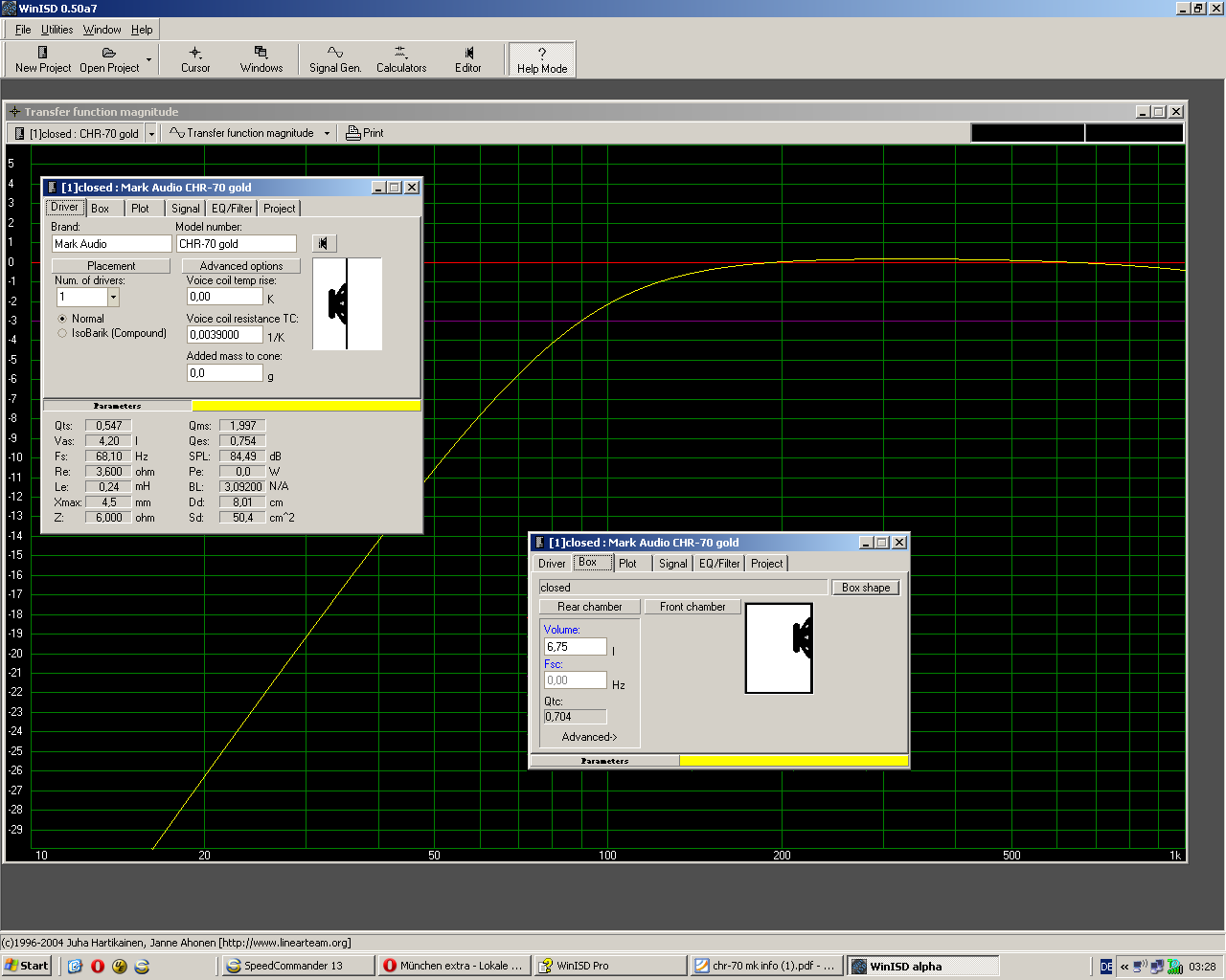

Hello
I would like to build my first Speakers. I am still reading about the laws of Acoustics, therefore I am not quite sure about my project:
I will build spherical loudspeakers by combining the CHR-70 Driver with the Ikea "Blanda Salad Bowls". The CHR-70 seems to me a good choice as that broadband driver got good reviews on this forum, looks really nice and is not that expensive. It is also a versatile driver that fits in a whole range of different boxes. (That may be important just in case I mess something up or the resonances in that sphere are too extreme.)
WinIDS Alpha Pro suggests a capacity for the closed box of 6.75 liter.
The Blanda Salad Bowl (wall thickness ca. 1 cm) comes in two different sizes:
a.) External diameter: 28cm -> Capacity approx. 9 liter
b.) External diameter: 20cm -> Capacity approx. 3 liter
The net capacity of the 28 cm sphere is
9 liter of the untouched spere
- 0,5 liter CHR-70 approx.
- 0,062 liter spherical cap (a slice - regarding the inner diameter - of 1.25cm will be cut off. The capacity of the cap is small, it could in this case probably be ignored)
=8.43 liter
If I do the same math for the smaller sphere (hight of inner cap: 1.51 cm -> 0.061 liter) I get a net capacity of 2.44 liter.
Now my questions about deviations:
1.) According to my calculations the 28cm sphere fits better to the CHR-70. The box should have 6.75 liter, in reality it will have 8.43 liter. Does the difference matter?
2.) If I would fit the driver - ignoring all the calculations - into the smaller box of 2.44 liter, will the result be horrible?
Thanks for your answers.

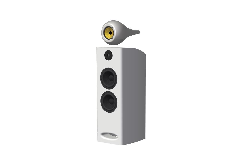

I really like this idea, using Ikea stuff.
What would be great is if i can get my hands on a "water droplet" shape for behind half a bowl.
I love the water droplet shape B&W uses with some of their speakers (Nautilus and 800 series come to mind). Anyone know what can be used to create such a water droplet shape?
They could be turned on a wood lathe. I've been working on a project with a teardrop mid housing. I'm going to turn one to make a molding and then cast them with Jesmonite as used in the Celestion Kingston speaker. Though to get it hollow is quite complex and requires another turned component which has to be able to be taken out the mold once set.
Still needs a little thought.
That would be cool. (Im trying to do one with waveguide tweeters).

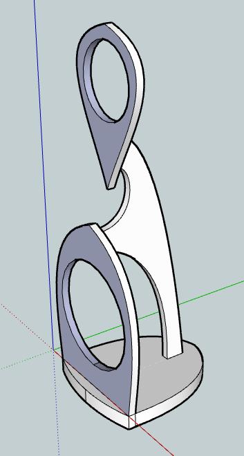

Guys... any shape can be created with the right technique.. sure it takes time to perfect... but anything is possible... I do all this with a Jigsaw and table router and a pancake compressor..
Hey Randy, if you will make me a set of those lovely nude driver stands, I will EnaBL your Lowthers for you and apply tuned Ground Controls.
Bud
Bud
Thanks... and sorry for Hijacking.... but those look like a drop in the bucket to make 😀
Wow, those are beautiful. I had this crazy idea for a dipole design in my head, but this is far beyond my construction skills.
=8.43 liter
Once you get above a certain size, boxes need to get a lot bigger to make a bit of difference. I usually target 5.5-7 litre. If you are worried that it is too large you can fit some blocks to use up volume and break up the internal resonance.

They have the least edge diffraction and the smoothest step-loss diffraction... Except for the tear-drop shape exemplified by the B&Ws...
