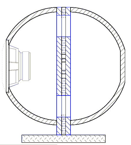

If that isnt enough and you have a bigger box that has meaningful size to actually create a standing wave then just stick a 3" PVC pipe sliced in half to each wall to diflect the sound. No issues.
A well choosen rectangle (no dimension an interger multiple of another -- irrational numbers are your friends) will have 3 different primary standing wave modes, with relative energy spread across all 3. A sphere has 1 with all the energy at the same place.

...put a wall with different hole sizes between the two parts and be done with the discussion.😎
Interestingly enuff, just what i sketched out last nite. The partition is holey and also contains 6 slot ports. The holey braces for the drivers (not drawn) will act as attachment points for the driver screws and further break up the front half
dave
