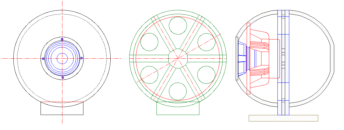

Good one Dave. You'd be looking at 18mm (3/4in) or so for the partition, so 3 layers of 6mm ply would do the job. I would also include plenty of locating pegs around the rim to push the bowls into a more perfectly circular shape.
If you didn't mind the flat spots showing (ear mounts? flashing lights?) you could combine speaker mount, holey brace, port tunnels and partition into one structure in a single plane.
Reports are that final execution depends on the set of bowls you end up with -- they are not very consistent. My middle sandwich is 12+9.5+12mm

The problem is that a much bigger driver won't really fit.

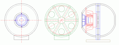

Attached is a snapshot of a sketch of a blandaOnken thot experiment based on the big bowls. The wagon-wheel stuff in the join piece is the venting. I had to push the bowls out 12mm front & back to get the required volume for the CHR70 (blue driver). To use the nominal 6 1/2" Alpair12 (red driver) you have to cut away a lot more of the bowls. Then you end up with about half the volume required for the driver -- and the A12 works in a very small box.
dave
dave
