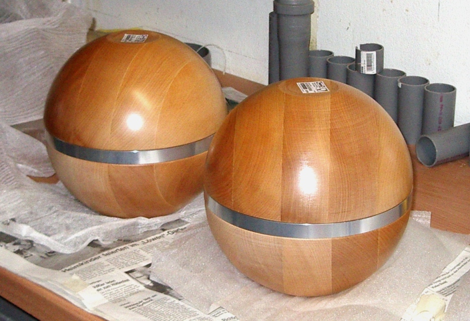

Ikea spherical speakers, first build done.
Similar to Mark's in post #24, and the ring is deliberately thicker than to make perfect sphere, so that I end up with the required volume for critically damped response.
Still some work to do.
Patrick

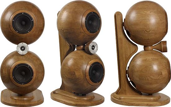

How about something like this
http://www.sound-e-motion.com/en/catalogue.shtml
I was thinking along these lines. For the tweeter section you can use a wood curtain rod support. Wire the woofers in parallel for efficiency. Nice computer speaker system with a nice small SE tube amp.
Patrick, where/how did you source the middle aluminum ring? How will you secure it all together?
