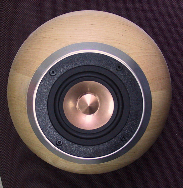

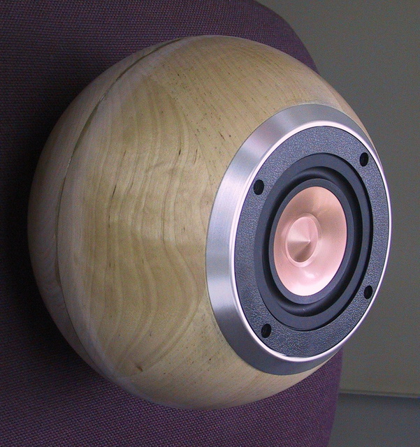

Mind is a Alpair6 sealed, 3 litre. I'm building a 6" subwoofer to go with it.
We have another version with a ring installed at the parting line.

MarkLai, those look excellent. What is the aluminum ring and How do they sound?

I don't hear them yet. I've a Alpair6 base reflex, 7L, from EUVL which I like them very much.
The silver color AL ring is just an adaptor ring glued to the salad bowl. I find that it is too thin to drill screw holes onto the salad bowl, which is 8mm thickness only.
Single subwoofer is good enough for a small room which is typical in Hong Kong. Mark Fanlon knows that.. haha.

Mind is a 200mm outside diameter and approx. 184mm inside. That makes up just good 3 litre inside for the full range Alpair6. I hand sand flat the opening first, glue the bowl on a plywood and machine the bottom on a mill. Remove the "top" plywood and glue the bowl on the bottom. Then lath/mill all the rest. I'm lucky that I've a good machinest to help me.
