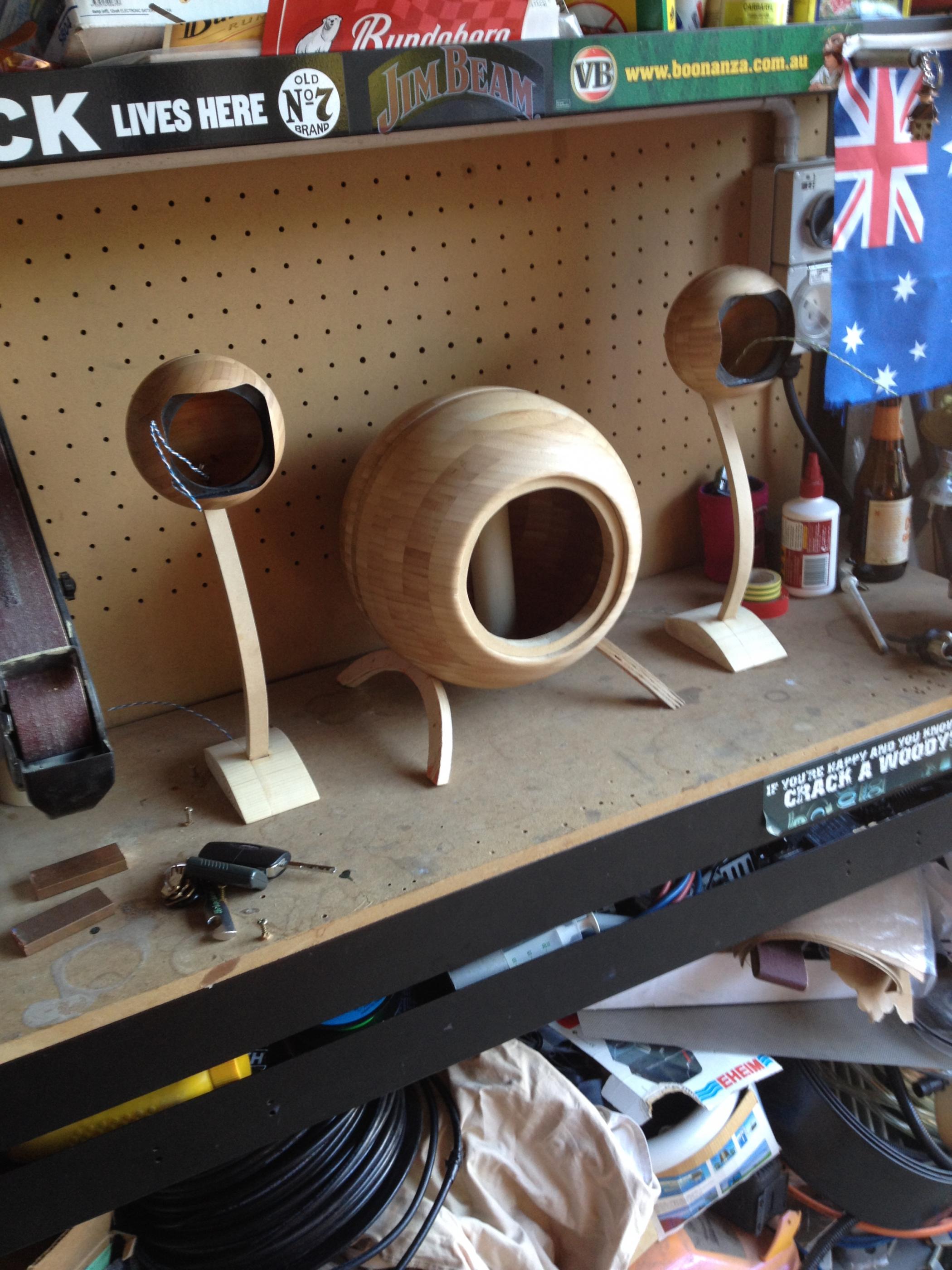

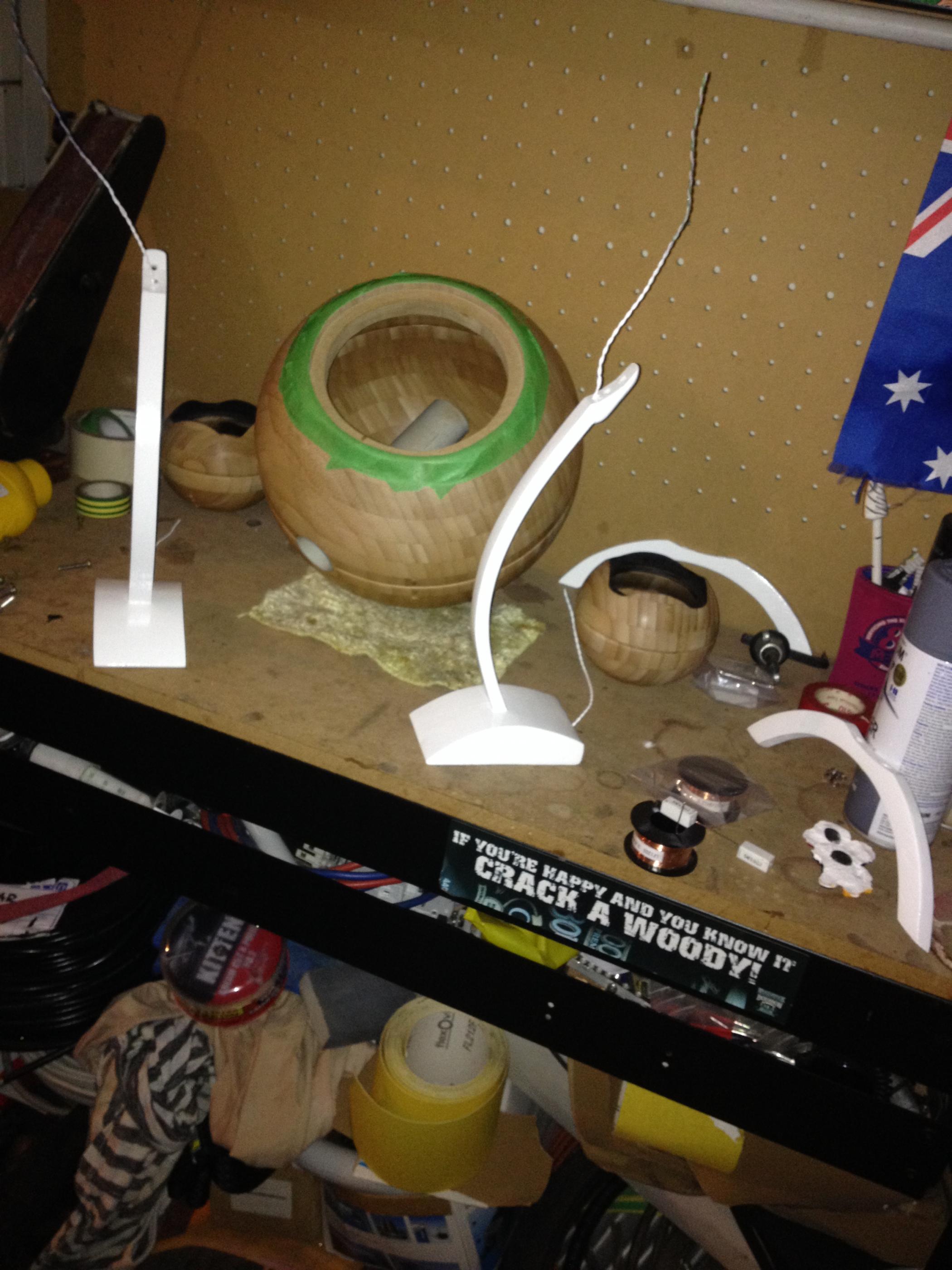

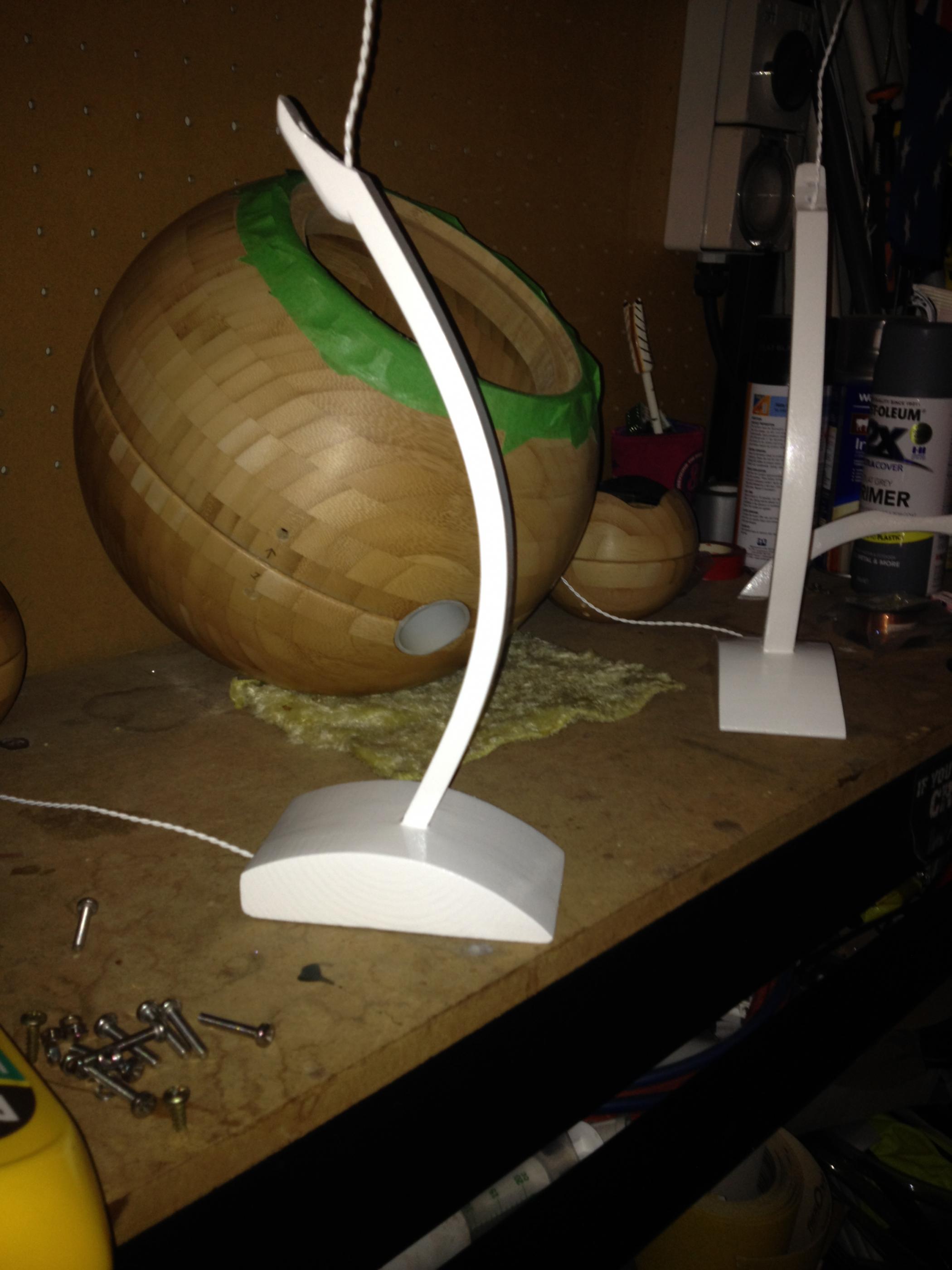

have started painting
im thinking going gloss black on the stands and feet and sand and clear the balls
thoughts

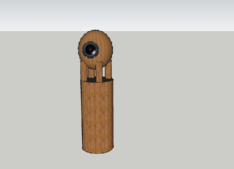

Mounting the ball on pilotis over a cylinder housing a sub driver for 360 bass.
Bass driver would handle up to 100-150ish Hz, fullrange in the ball.
Made a crude model in Sketchup (I used to be fluent with FormZ in the old days, I do not like Sketchup at all!)
