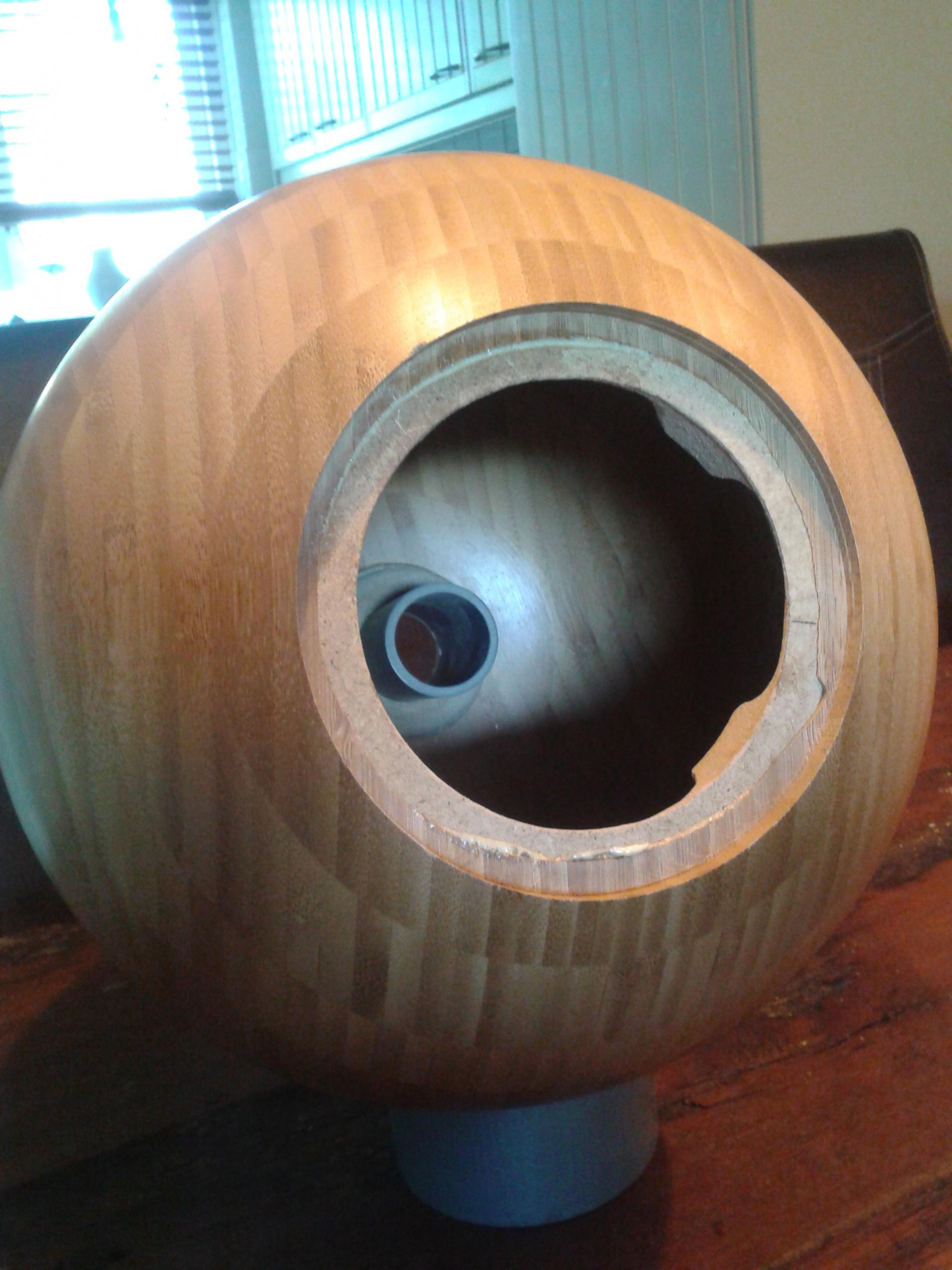

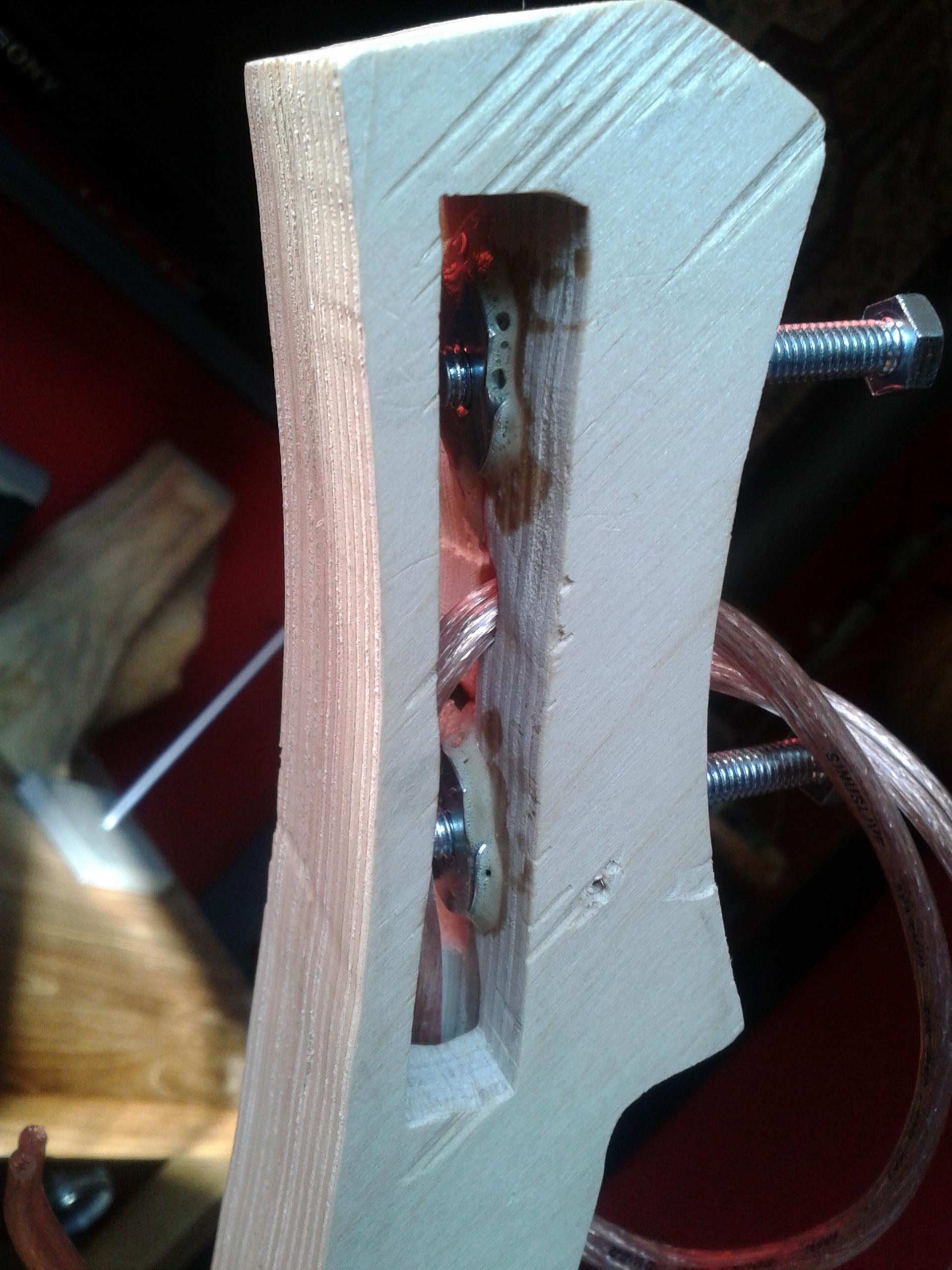

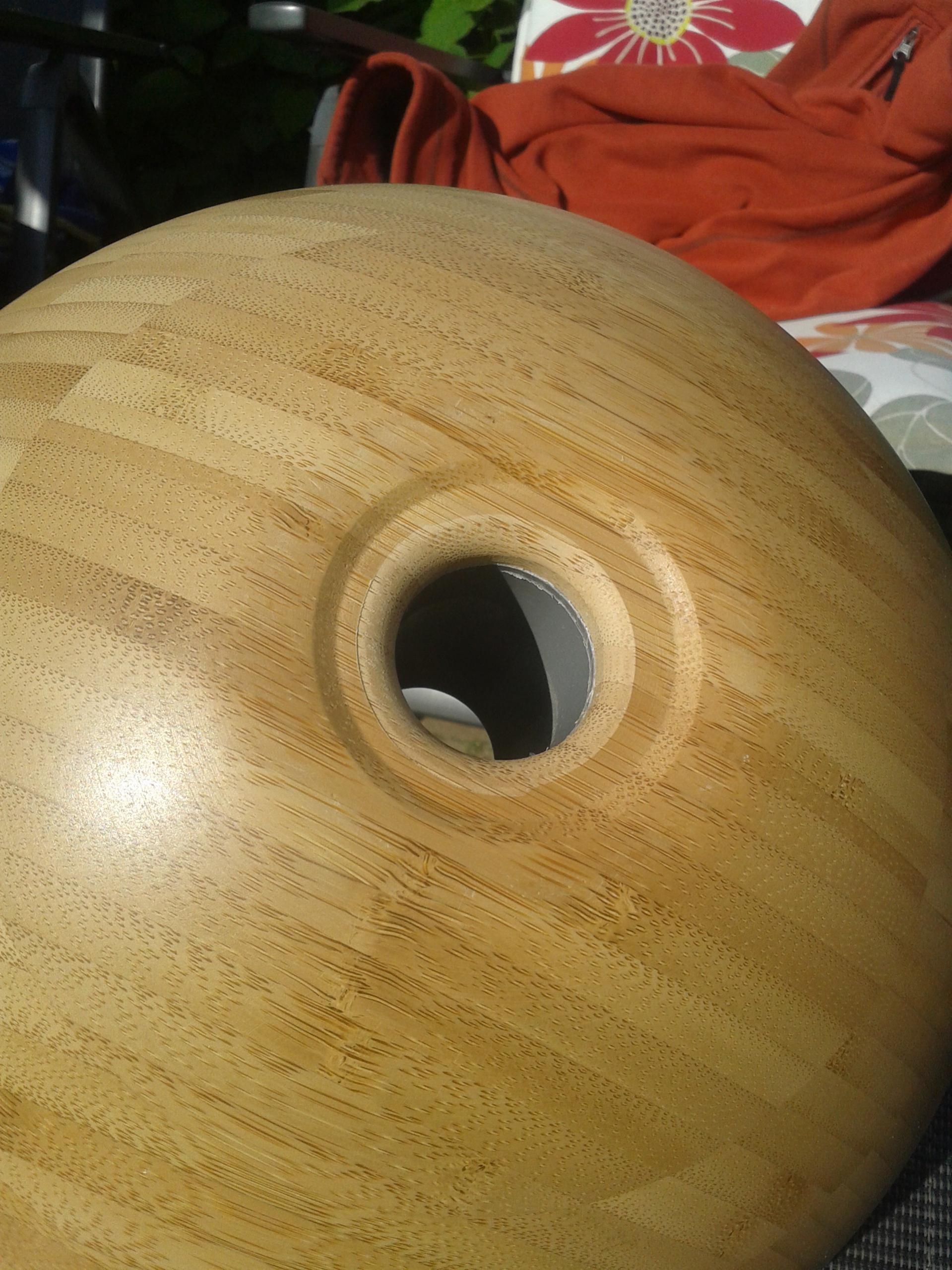

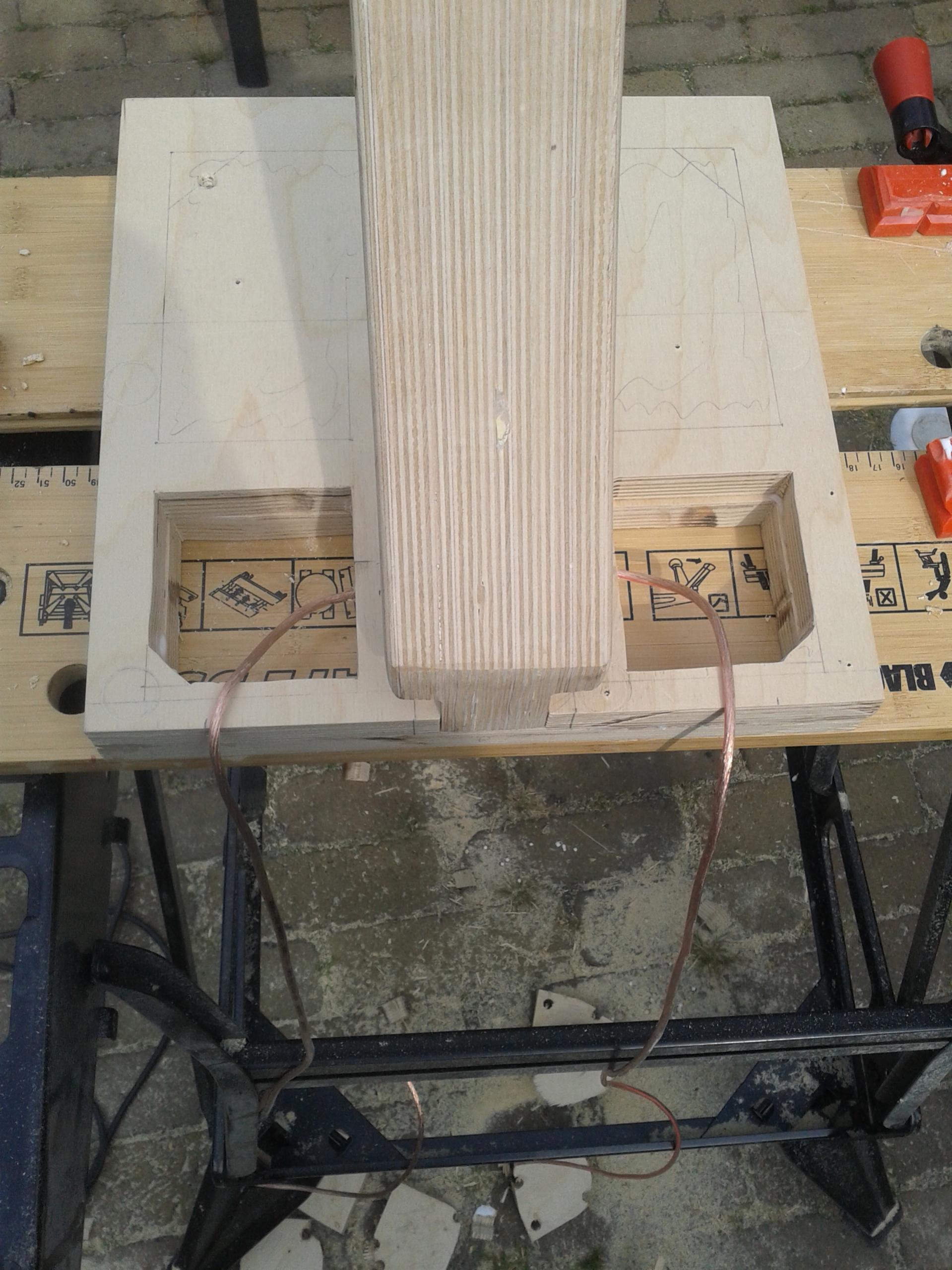

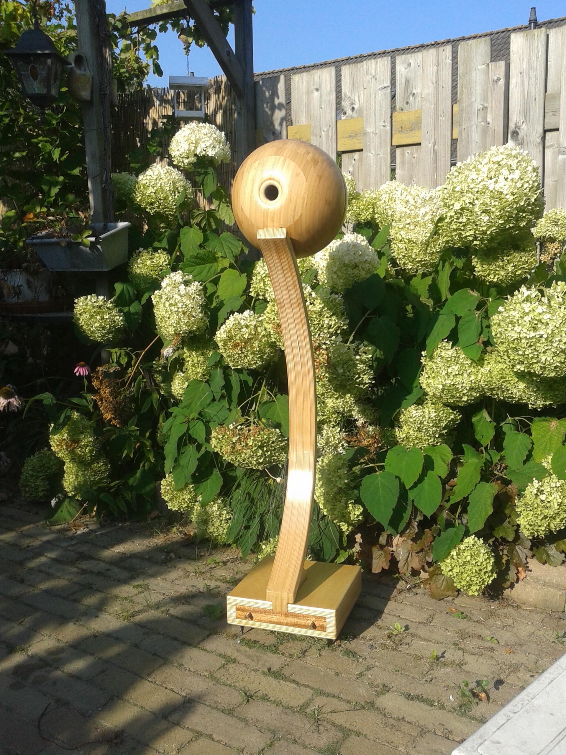

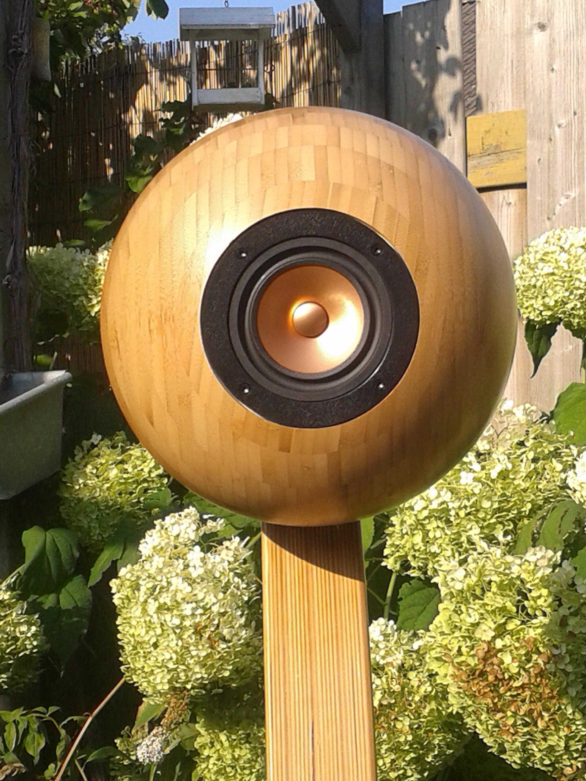

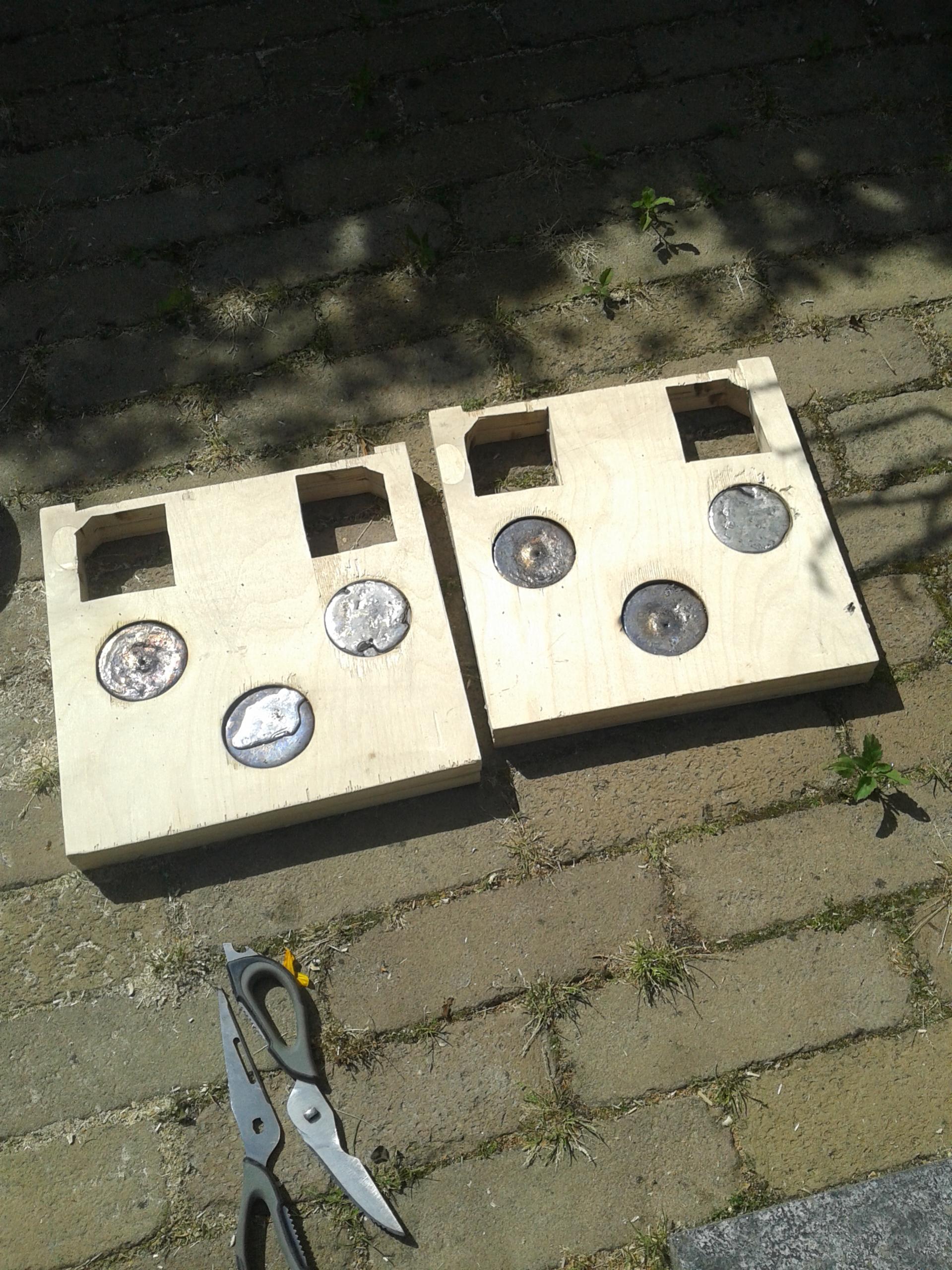

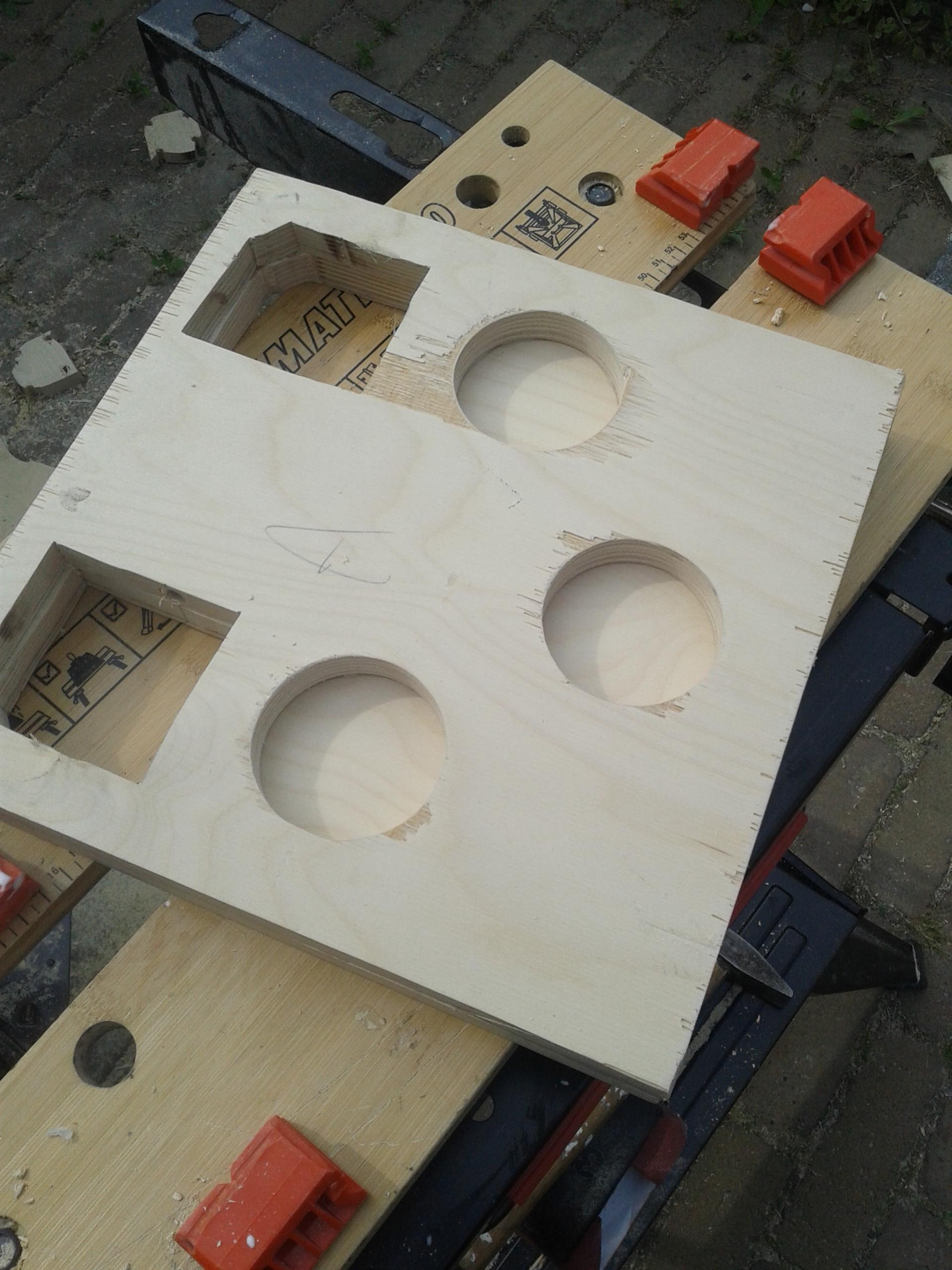

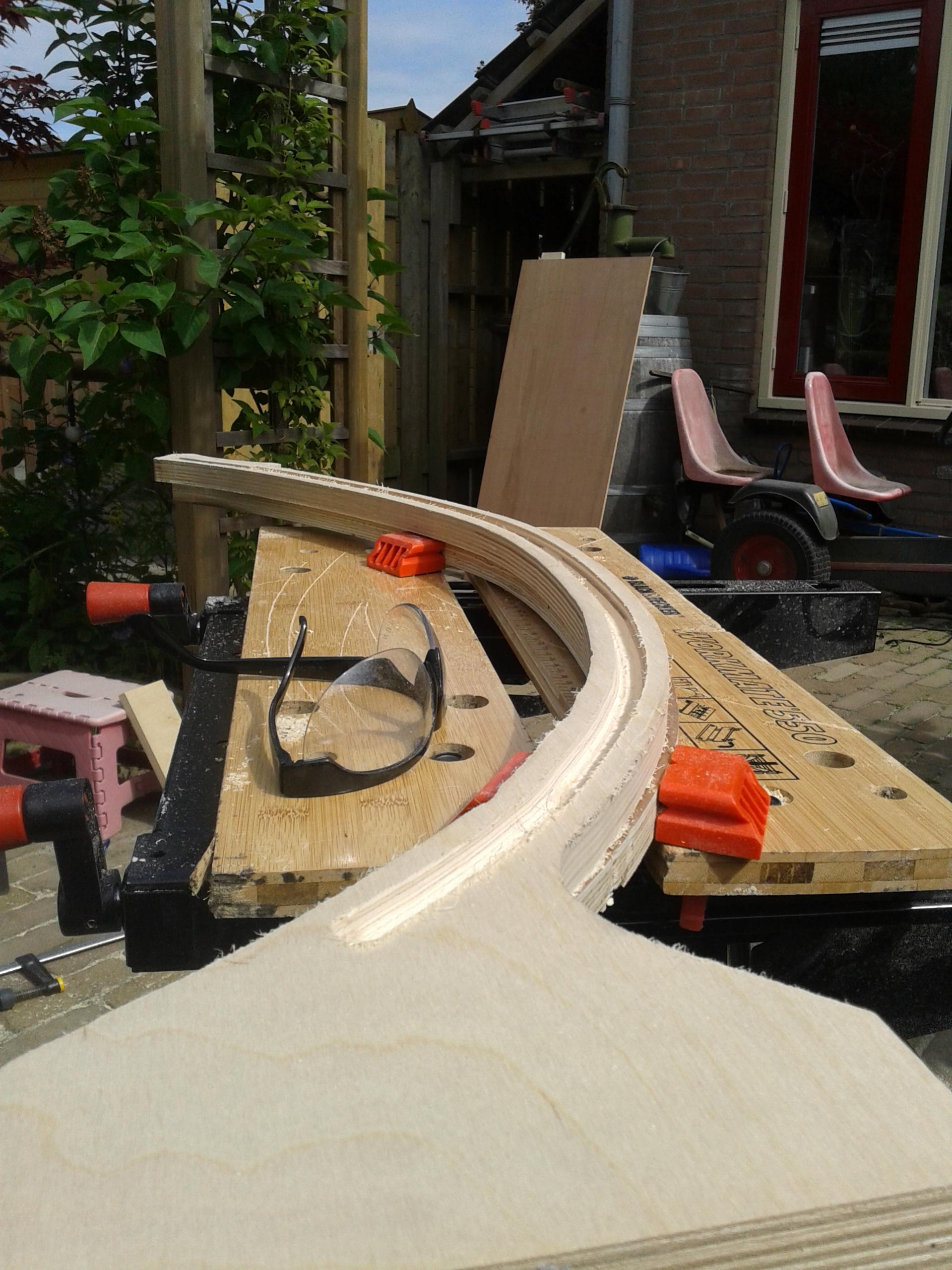

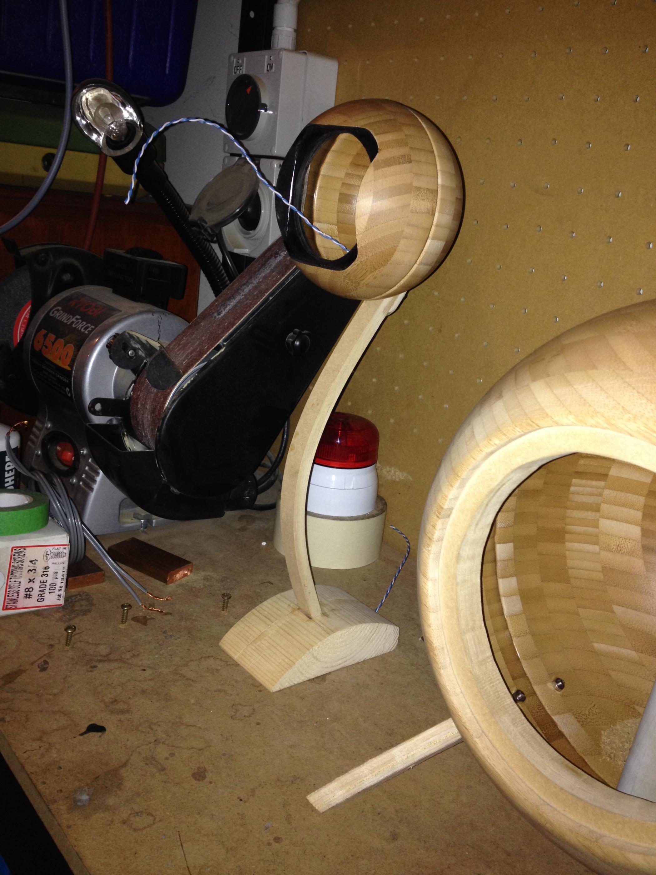

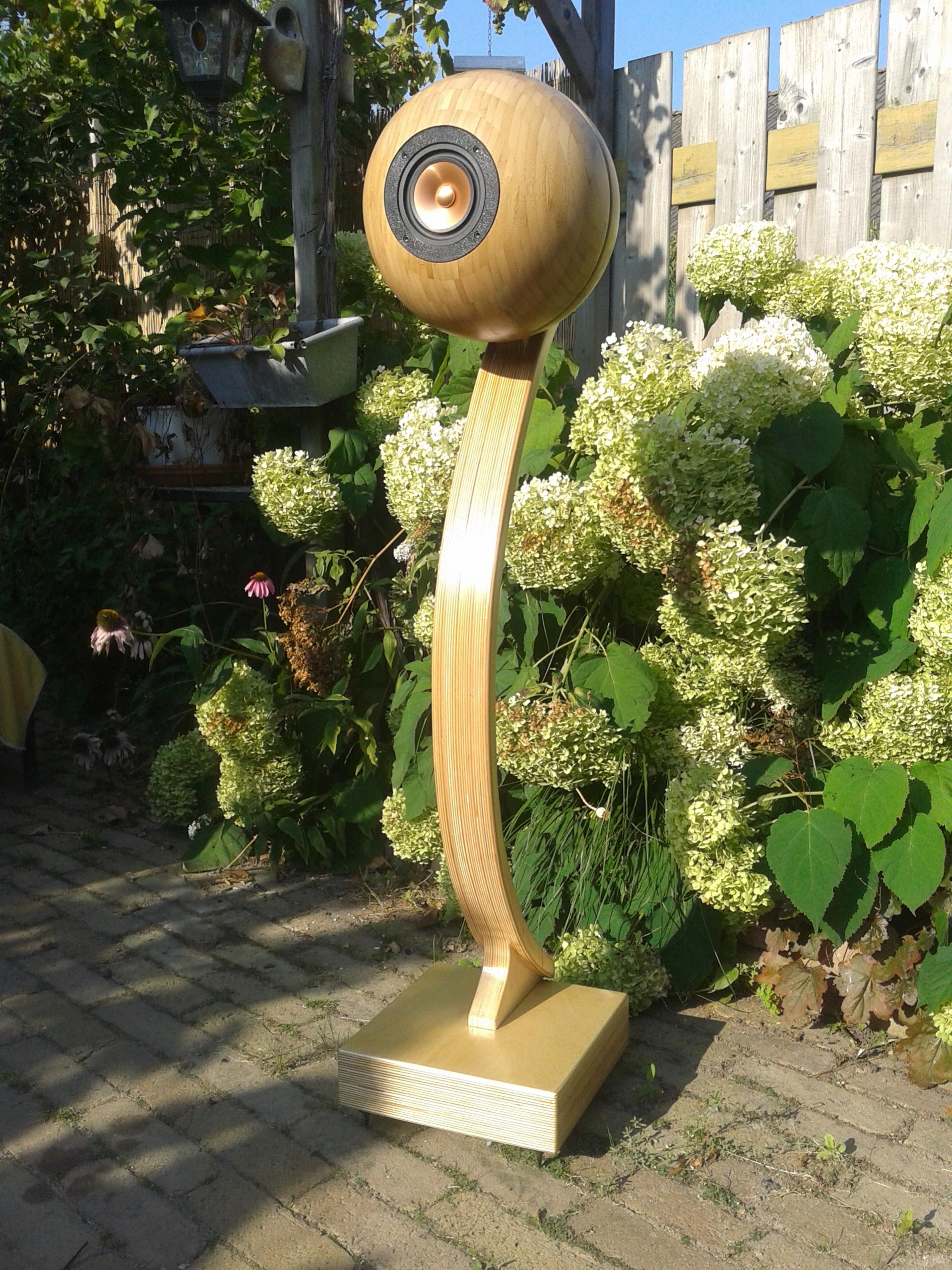

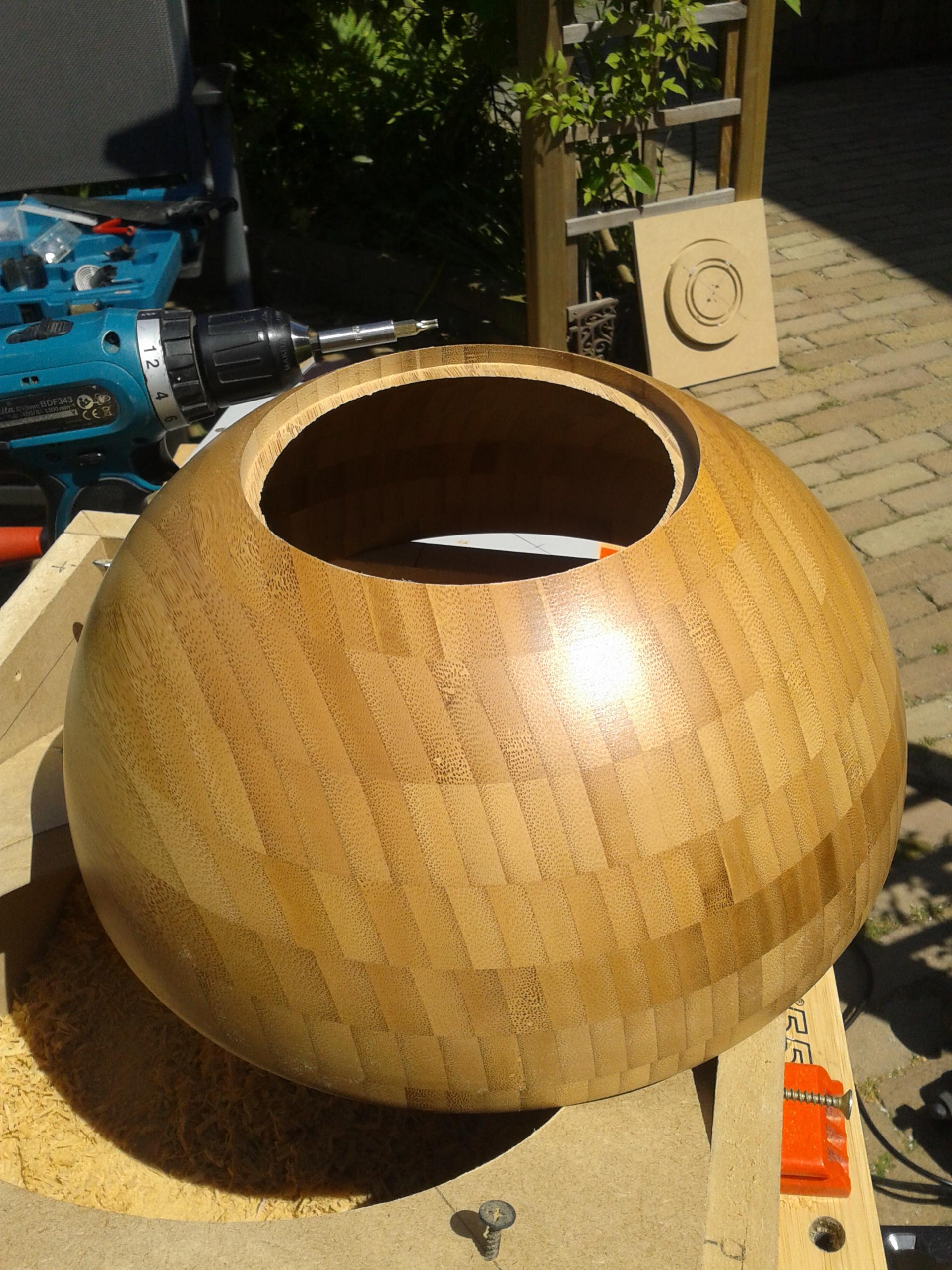

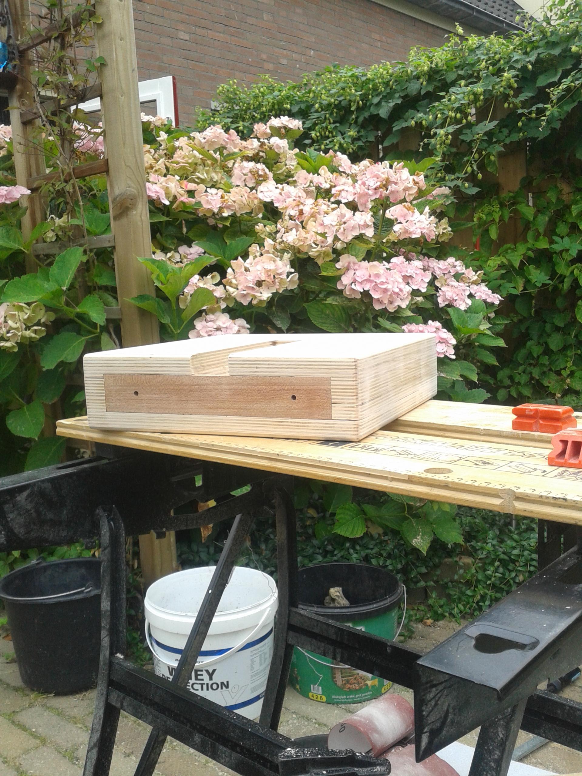

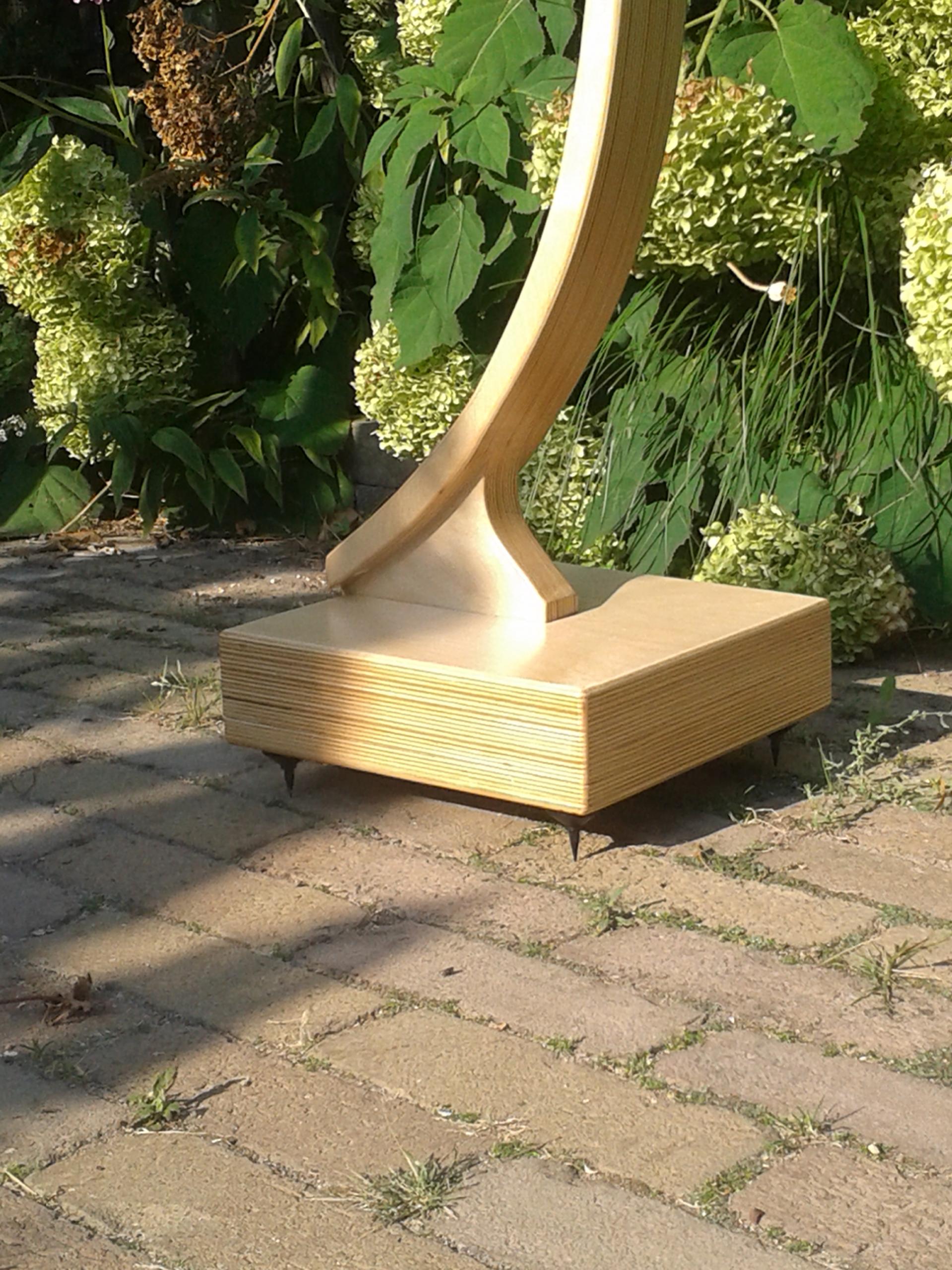

This is my version of an Ikea Blanda speaker build.
It is an Alpair 7.3 in the Blanda Matt 28cm bowl.
The Alpairs are flush mount using the techniek EUVL showed here. http://www.diyaudio.com/forums/multi-way/159151-ikea-spherical-speakers-first-build-done-21.html

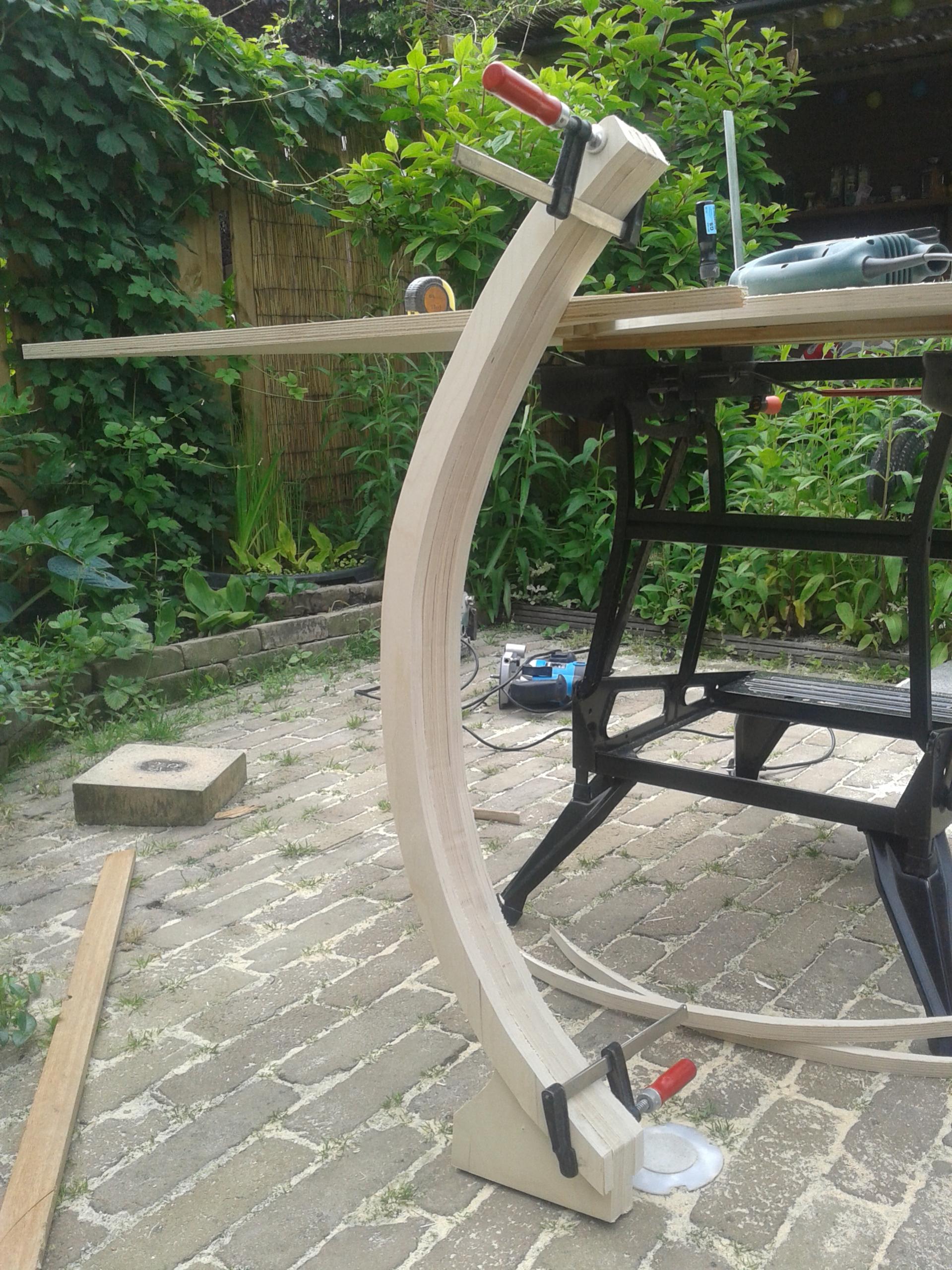

The stands are made of layers of birch 18mm plywood. They have a finish of Osmo Hardwach

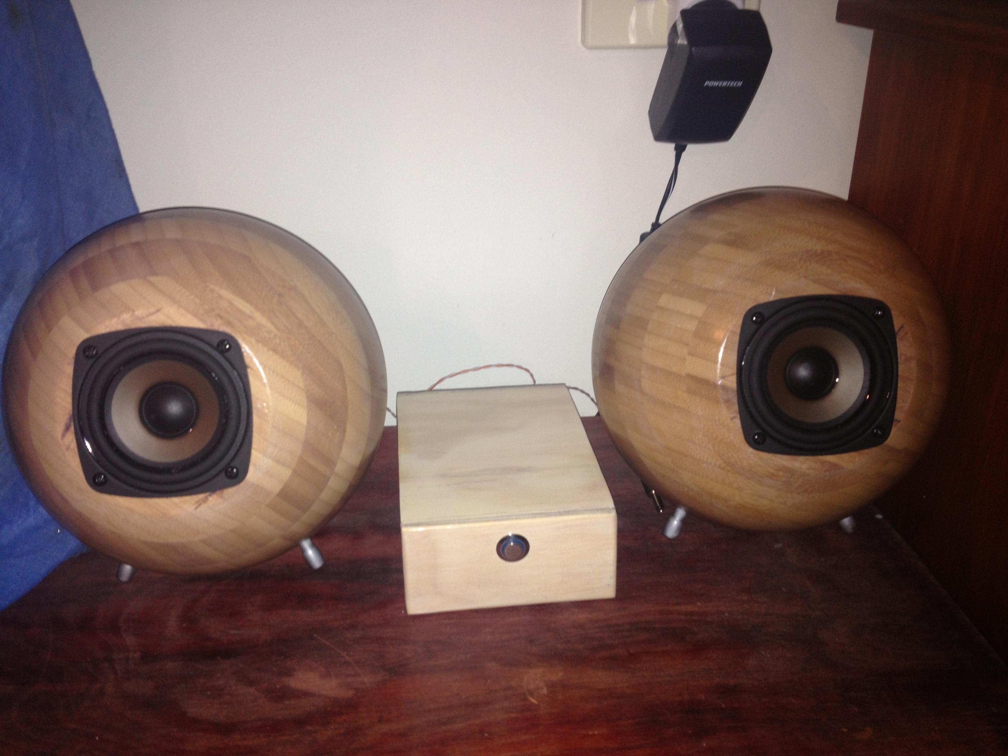

Hi nebosja,
I am finding discribing the sound of a speaker a bit difficult. But i'll try.
The cabinet is a 9 liter BR and is tuned to 53Hz. The Alpair are realy amazing, sometimes it's hard to believe your listening to single drivers the size of a coaster. The sound very detailed without harshness. Voices and string instruments are clear, you can hear every breath en finger setting on the snares. Allthough they are capable of producing low frequenties, they do not have a lot of punch in that respect. So they are not "party speakers". I believe they are very well suited for builting a FAST system. The Alpairs really need about a 100 hours of playing time before they sound really good, in fact the first hour I listened to them they didn't sound very good at all 😱! But even after a few hours of playing the sound quality increased dramaticaly.
All in all I had a lot of fun building the bowls and stands, the next build will probably some subs to match these Blanda speakers.😀
Congrats Erik, beautiful speakers.

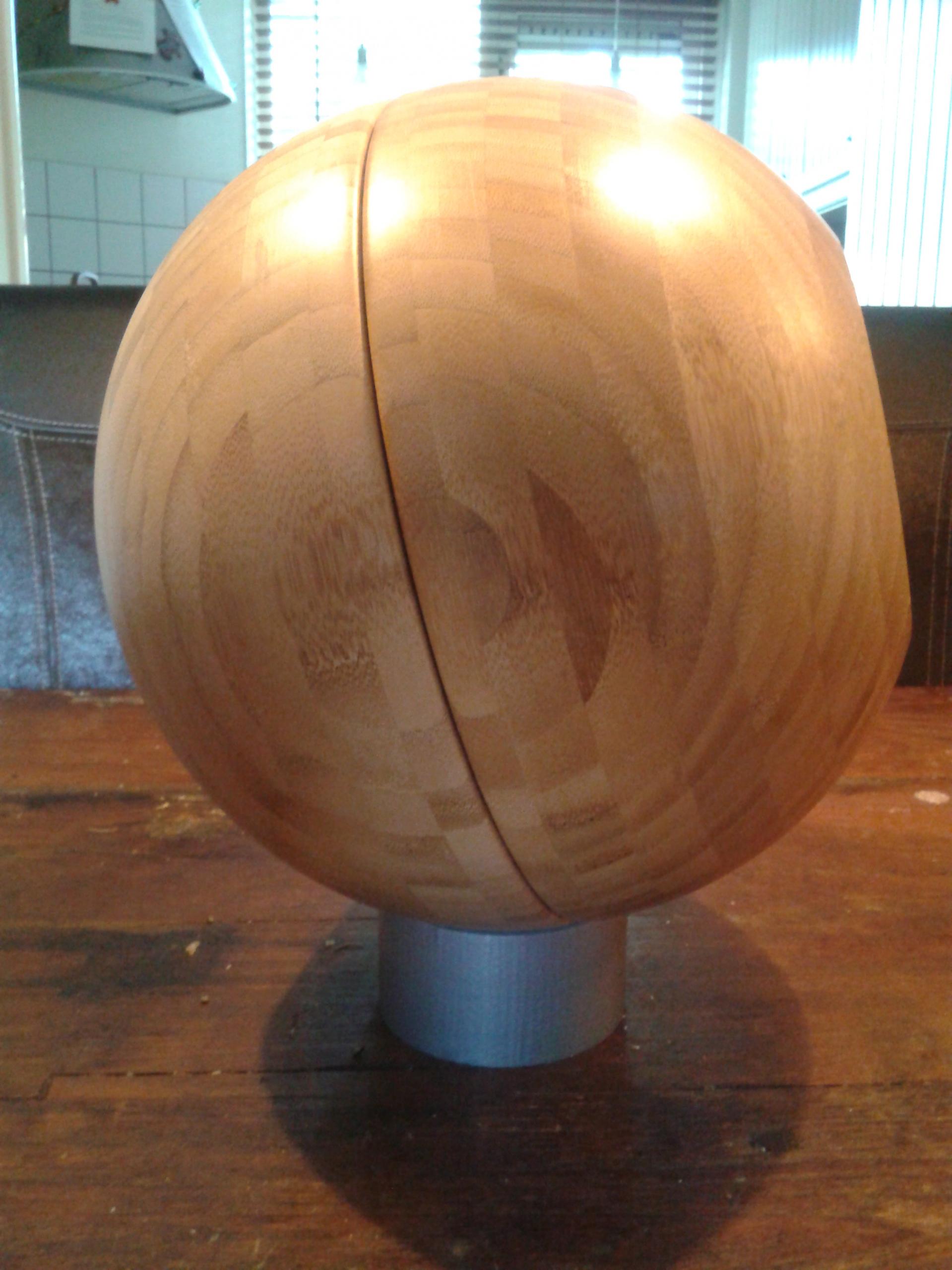

Does these bowls form a perfect sphere without the use of a spacer?

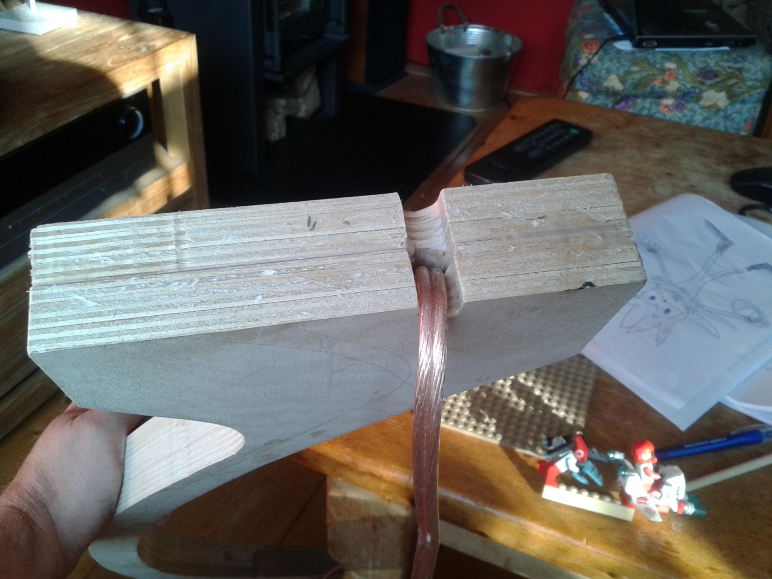

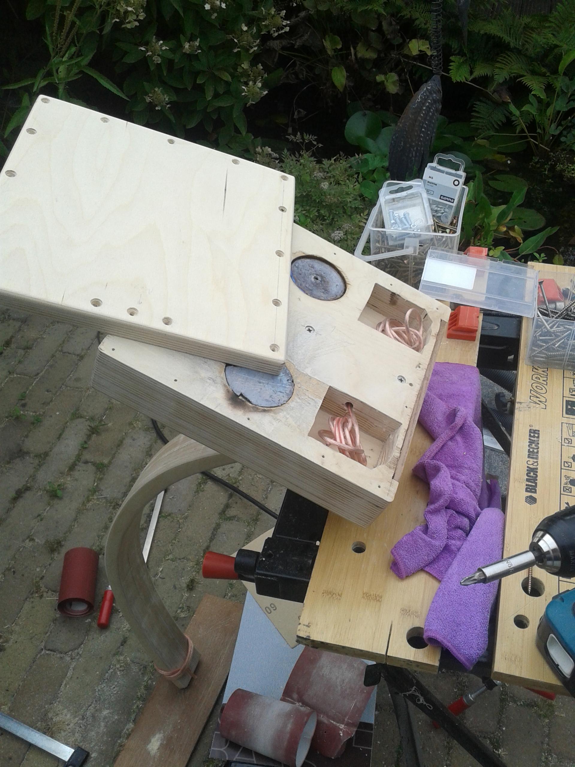

Very nice speakers Eric. Where are you running the wires? I assume you made a channel in the laminate.

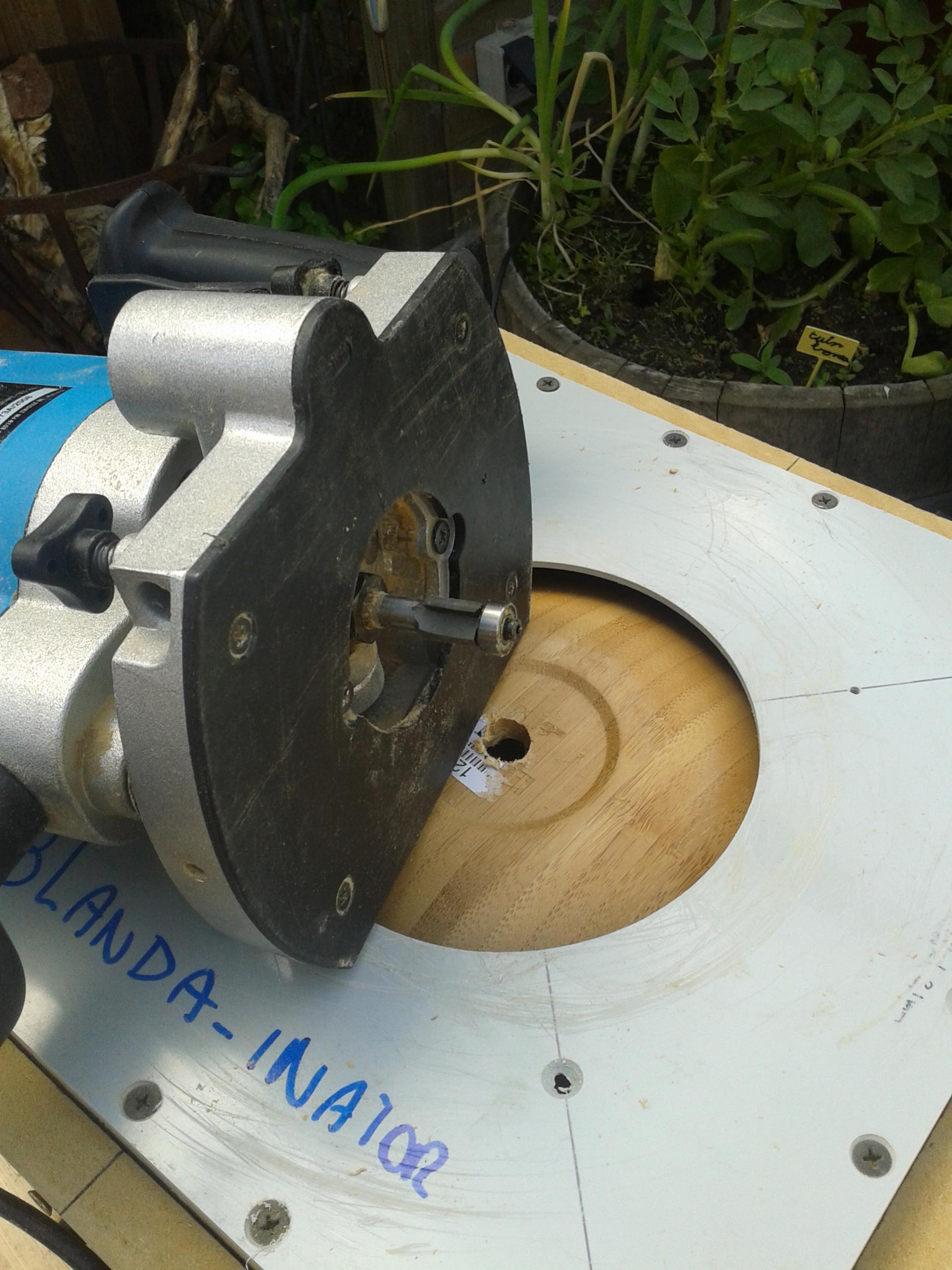

very nice build. I wish i was as skilled with a router. My own blanda build involves just a wood saw or hole saw and an industrial belt sander/linisher...with luck i can cobble together something half respectable 😀
I love the humble ikea speaker
I'm realy enjoying those picks I love that curved wood stand I've made a set with the medium size bowls with Tang Band w3 the $9.90 ones from parts express mine were far from precise just guessed the port used a sure amp and they sound fantastic PS my first build I picked up some more bowls today to try some different drivers I think I'll give your curved wood stand a go like I said you have done a great job with yours

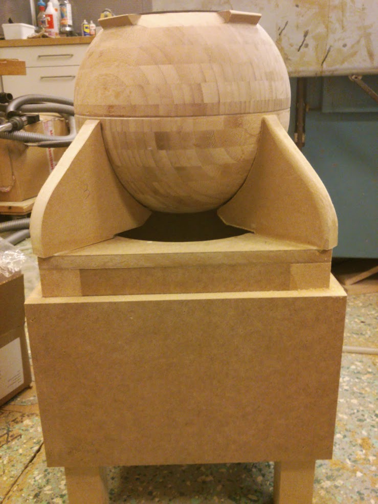

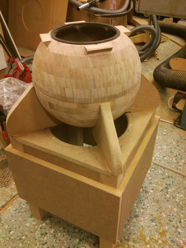

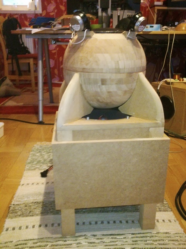

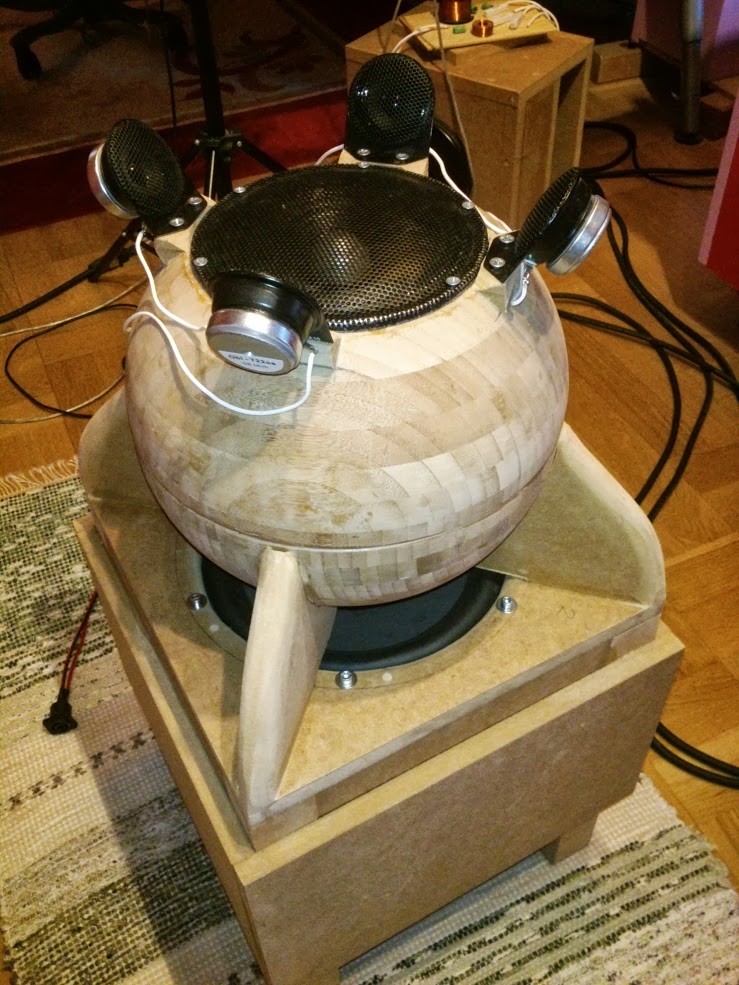

Here is one of my new omnis =)
The bottom part is an U-frame and the sphere is sealaed. The bottom woofer will be mounted from below. On the small platforms on top there will be four tweeters pointing inwards and slightly up to make it an omni all the way.
Cool idea. I thought you could make it a steerable spherical ball joint to aim the mid driver for positioning.

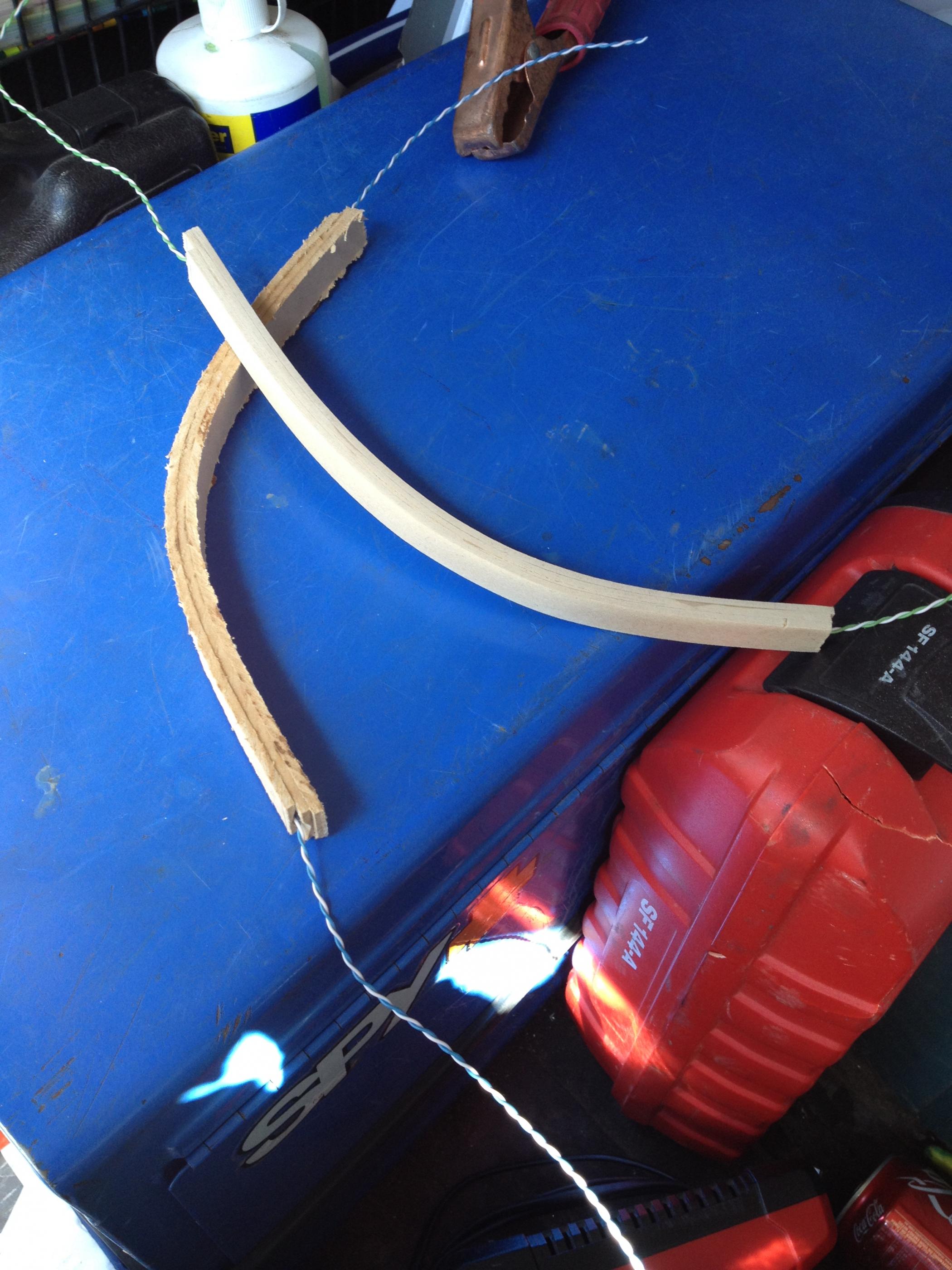

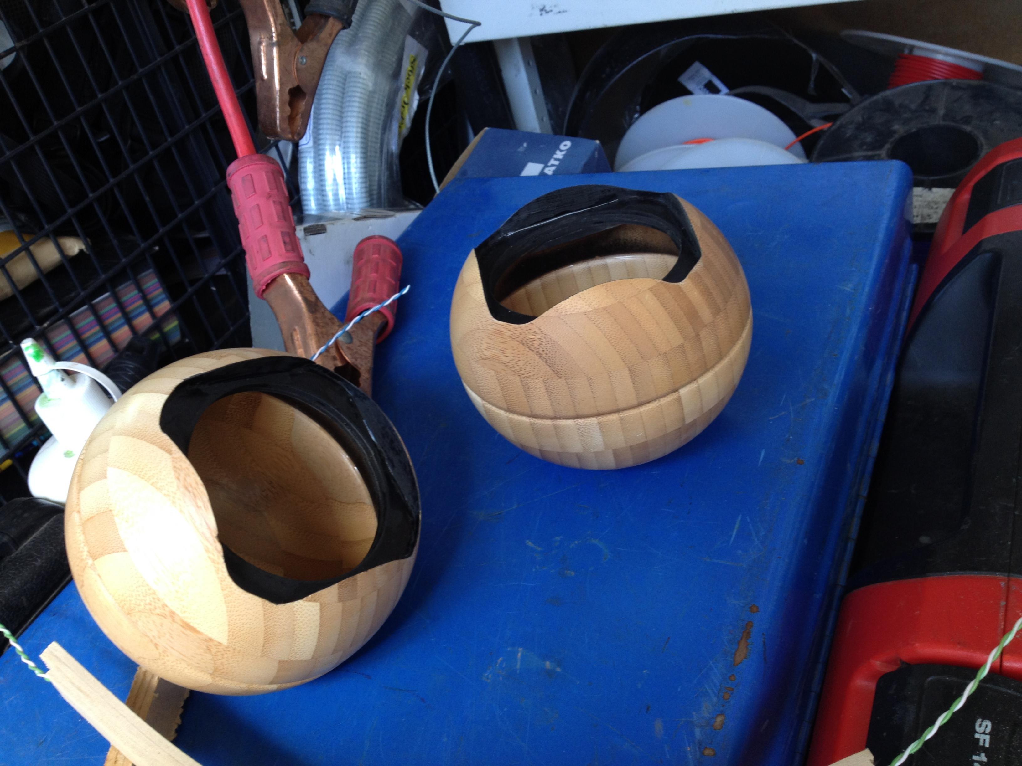

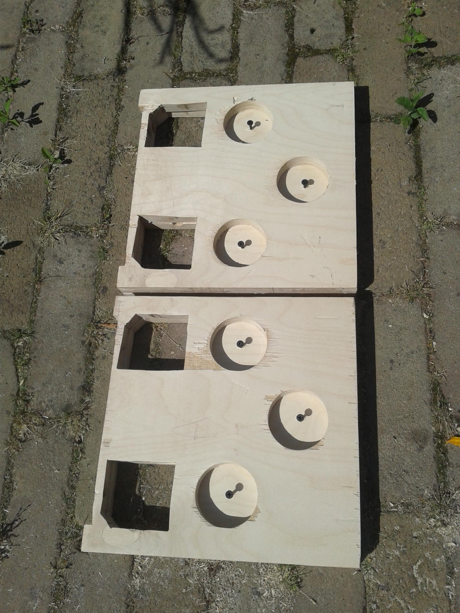

It just takes time and effort to learn to work with tools that's all 😀. If you can create a nice hole with a saw and and belt sander, you will also be able to learn to do it with a router. I spend much more time building the jig to maken the holes with the router then routing the holes it self (takes less then a minute 😛)very nice build. I wish i was as skilled with a router. My own blanda build involves just a wood saw or hole saw and an industrial belt sander/linisher...with luck i can cobble together something half respectable 😀
Hi Goolagger, your Ikea bowls look great, I think it is much more difficult to put in speakers which are not round. I love the fact you can create good sounding speakers without spanding a fortune. In the end this hobby is all about being creative, learning and having fun doing that. Theres no need to spend a lot of money achiefing that 😉. I 'll post some more pictures from teh build.
You could sure, but since it has omni dispersion all the way up to 15 khz it isn't needed =)
