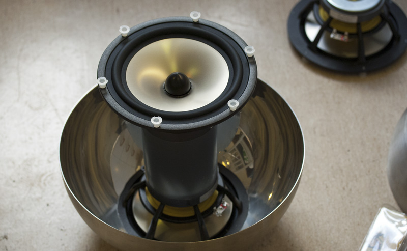

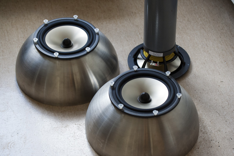

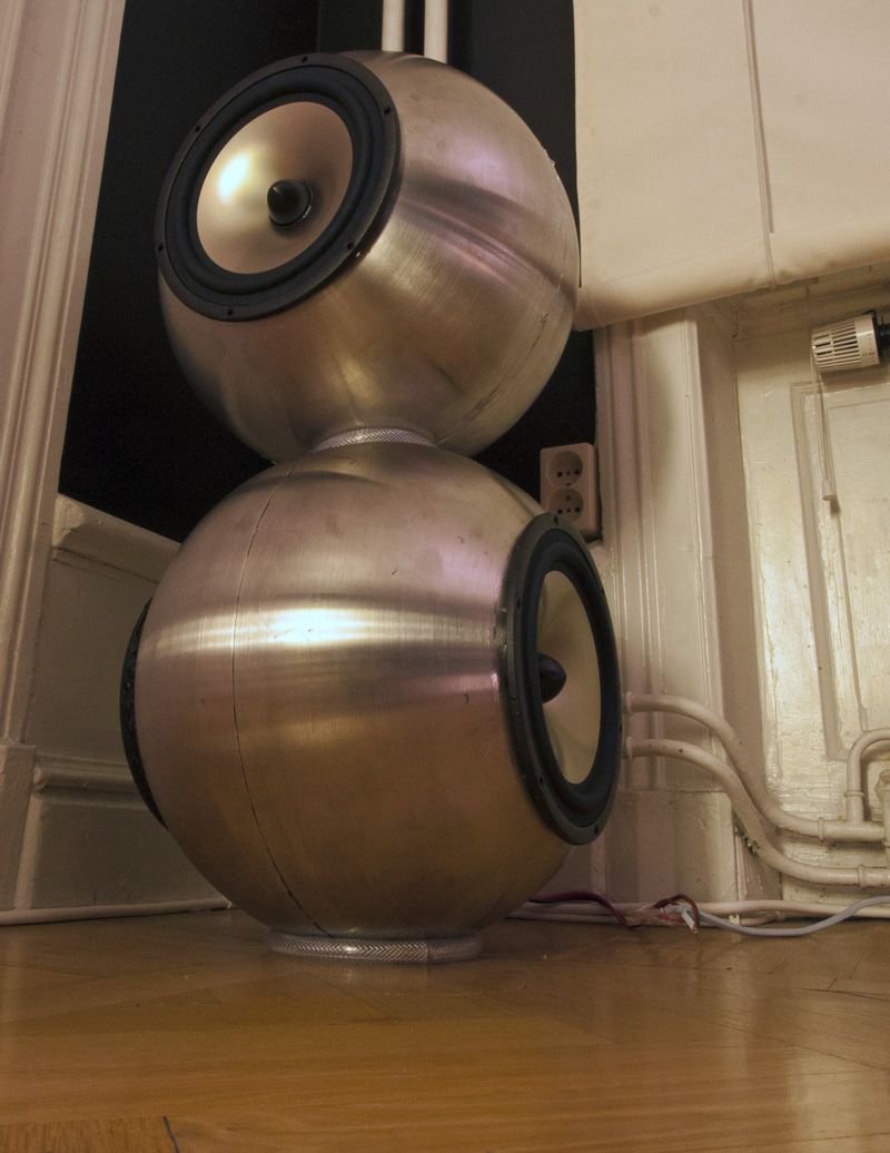

Nice renderings. Nice look. There is a big advantage by mechanically tie them together back to back. Only one of my drivers has mechanical contact with the steel sphere, the other side is glued with silicon i.e. a soft bond.

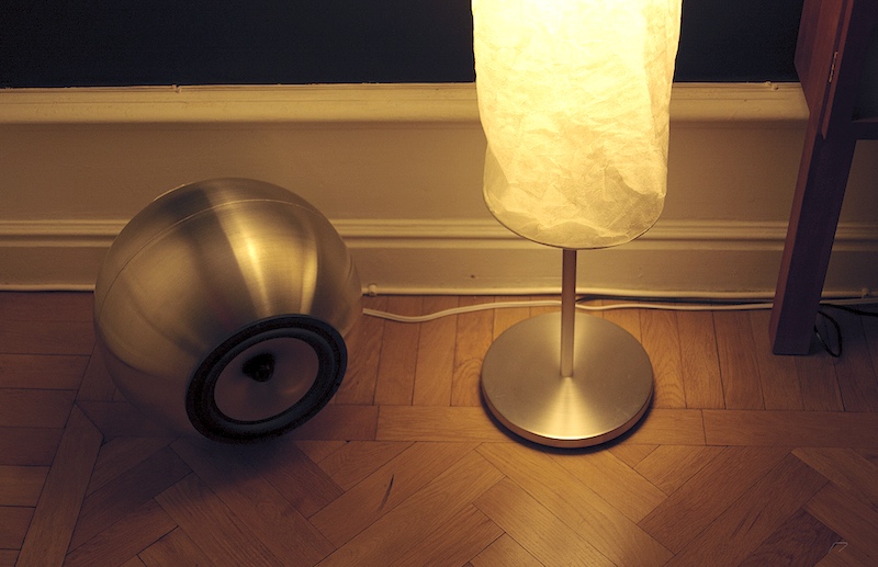

I just did mine from what was available. Not a lot (but some) simulation was done. Then I apply EQ. They are sealed. They play really nice driven by 2x500W icepower. EQ and XO by a minidsp which I only run in the LF branch in the system as it didn't "cut it" (pun intended) for HF. This is a pity as I would like to delay my main speakers to align with the subs which I have in the corners in the room. The mains are about 2 meters in front of the subs. Still they play really good. And at max excursion, one cant feel anything touching the spheres - amazing and I think it is a really desirable property of a speaker cabinet.

It looked good ... well, the choice was made after looking at the overall parameters. Not much simulation was made. I hoped that EQ could fix the end result. Power handling and reasonably linear excursion was of course important. they works very well in a 25m2 living-room for music. Deep and tight but they wont play the paint of the walls. Still they can put out adequate high levels.

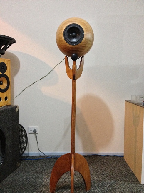

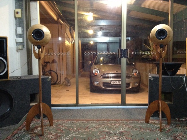

And some more Ikea bowl speakers...
I thought the idea so out there it was cool in an offbeat way. So I decided that these should be pretty offbeat speakers. The spherical shape bade me think of retro sixties stuff, so I went to town on the retro sixties stands.
Results below...
And

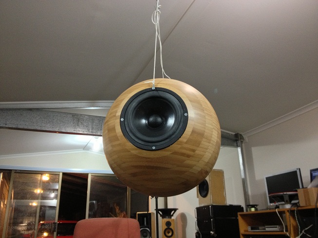

Tested hanging from the roof, looking like a cheap Dr Who special effect...
Results below...
And
- Ikea spherical speakers, first build done.
