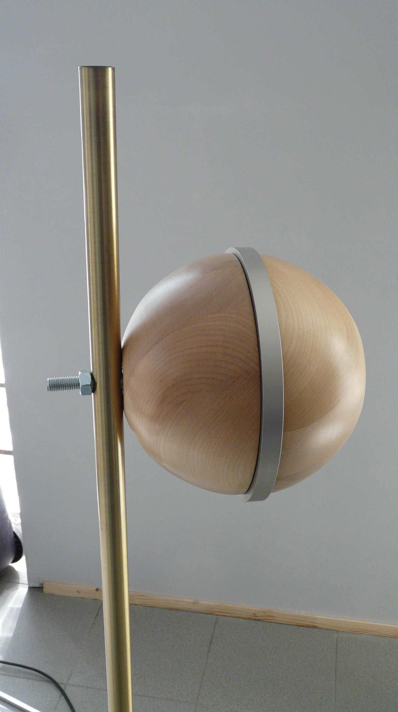

Similar to Mark's in post #24, and the ring is deliberately thicker than to make perfect sphere, so that I end up with the required volume for critically damped response.

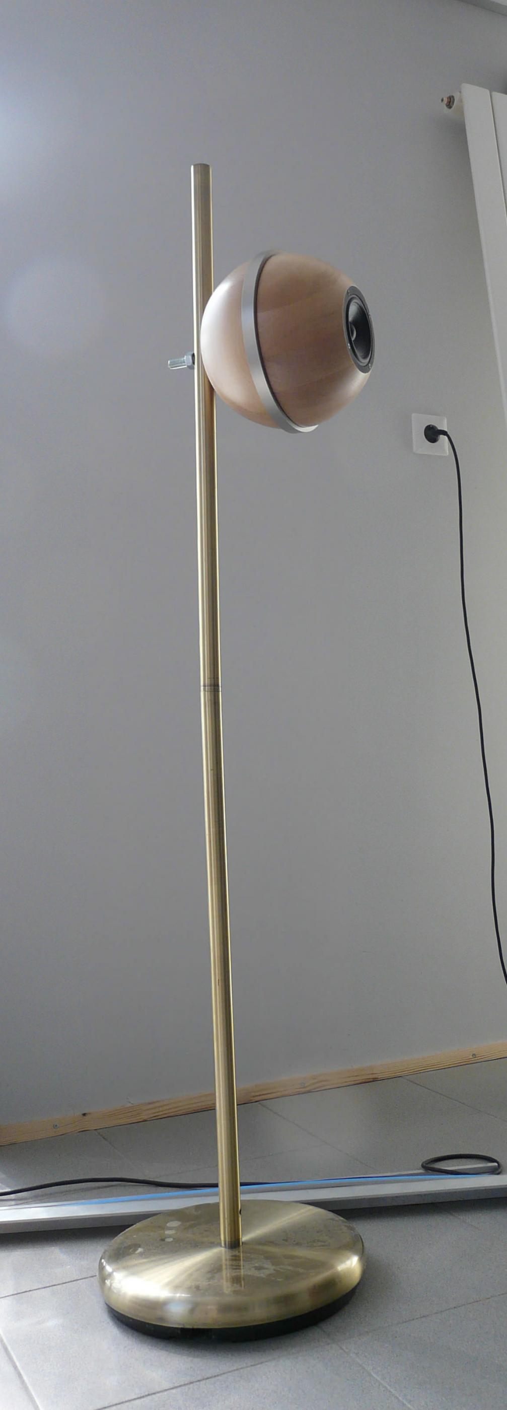

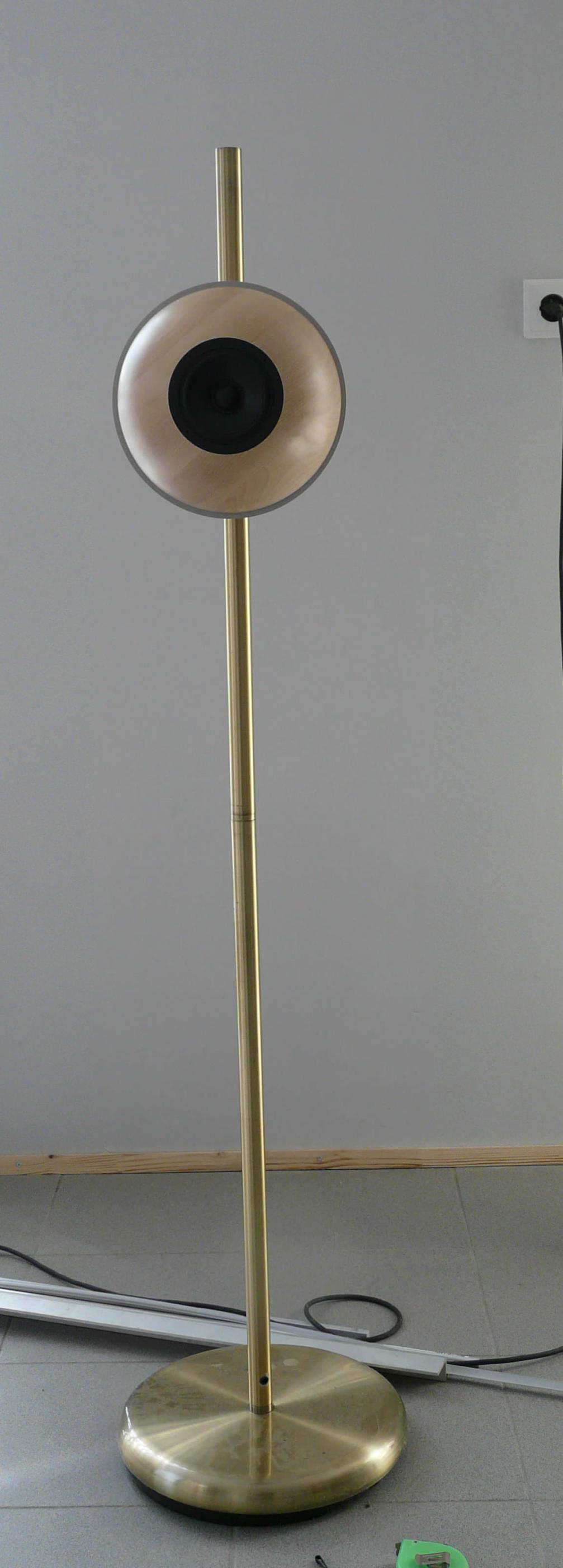

IU'm closing in on an actual sounding speaker 😉
Just a quick trial to see how the weight of the bullet speaker (thanks IKEA) bends a stand.
The connecting ring and some internal parts were designed by EUVL.
So now I'm going to get a real nice looking stand made, and then: listening and measurement!

I saw some table legs over IKEA last Saturday.
You may consider it as the stand pole. Different colors to choose.

Mark, that's a good idea! In fact I've been looking at a zillion lamp stands but not found one that was sturdy enough and that looked great.
Table legs are the next hunt!
jan

Yes, that's it.
I saw red, black and some silver colour.
The only thing you've to check how to modify the "floor" side to mount a flange.
Or you invert the leg. The flange side on the floor. the floor side to mount the speaker.

- Ikea spherical speakers, first build done.
