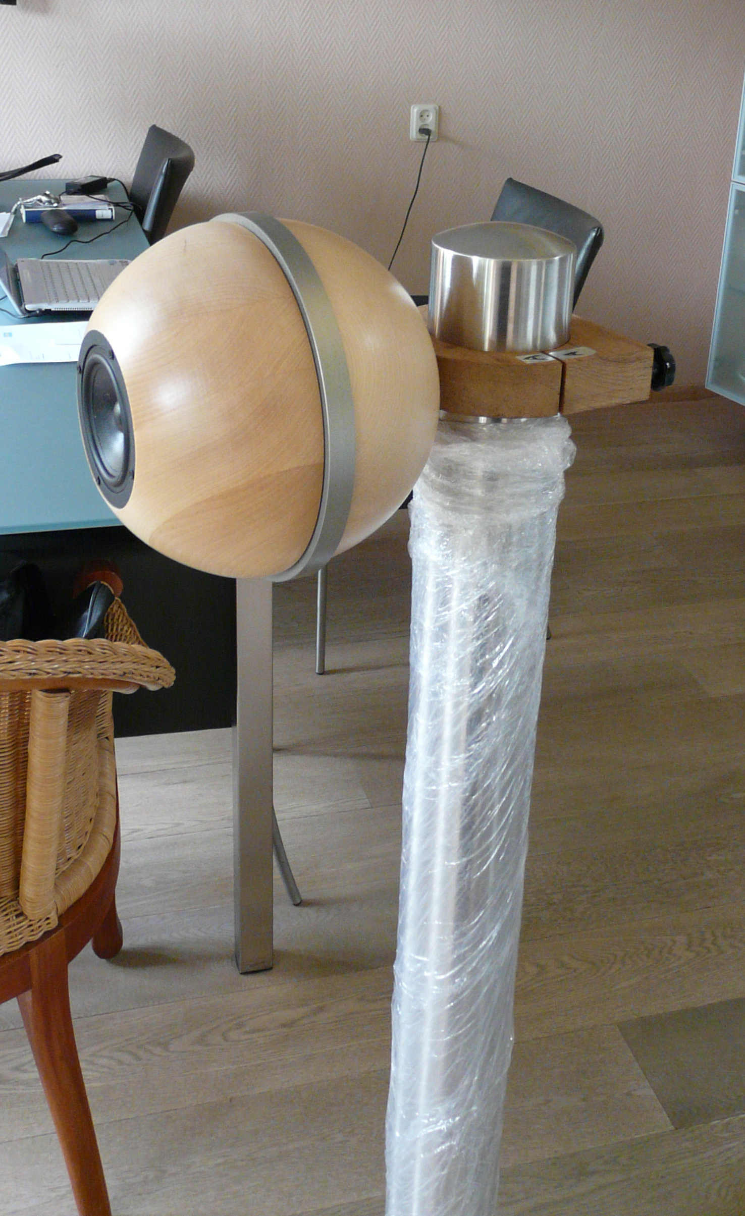

My contribution to spherical speakers.
Tang Band W4, a touch to big to flush mount, the MA CHR70 will flush mount if i remove 1mm from the basket radius.

- Ikea spherical speakers, first build done.
