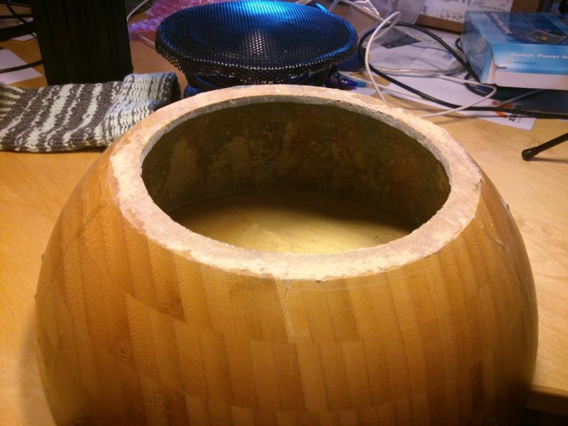

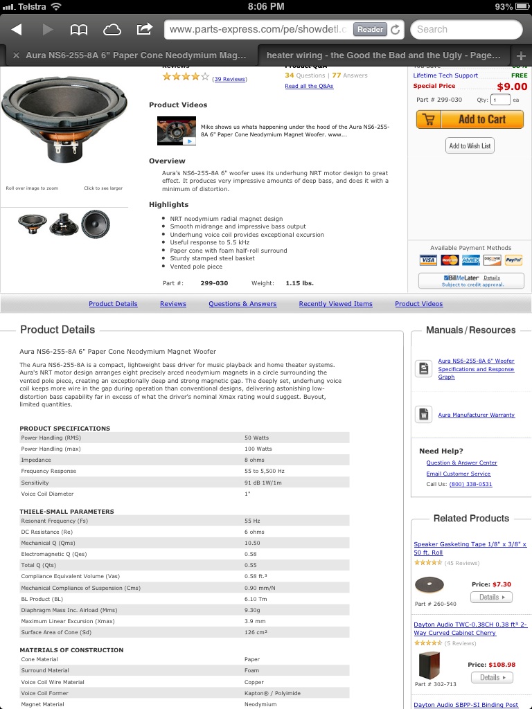

It's going to be an upwards mounted mid and I'm wondering on the best way to strengthen the bowl when mounting the driver since it's a fat 6.5 inch midrange weighing 3.8 kg =)
My current ideas are:
1. Glue a ring on the inside where the driver is mounted. Would it be strong enough though?
2. Make a ring of steel and place on the outside so the driver is mounted in this plate instead.
3. (1) but also design such that the magnet weight is offloaded on internal bracing.
4. (1) but instead of offloading magnet from below add bracing on the sides to strengthen it up.
5. ???

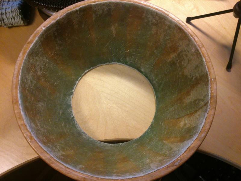

When I was drilling the driver hole and clearing for the flush mount I accidently cracked the bowl : /
Sure the glue holds it OK but then considering my strength fears I thought "screw it! I'll use fiberglass!" and so that's exactly what I did... It's probably borderline indestructible now my fears have been chased away =)

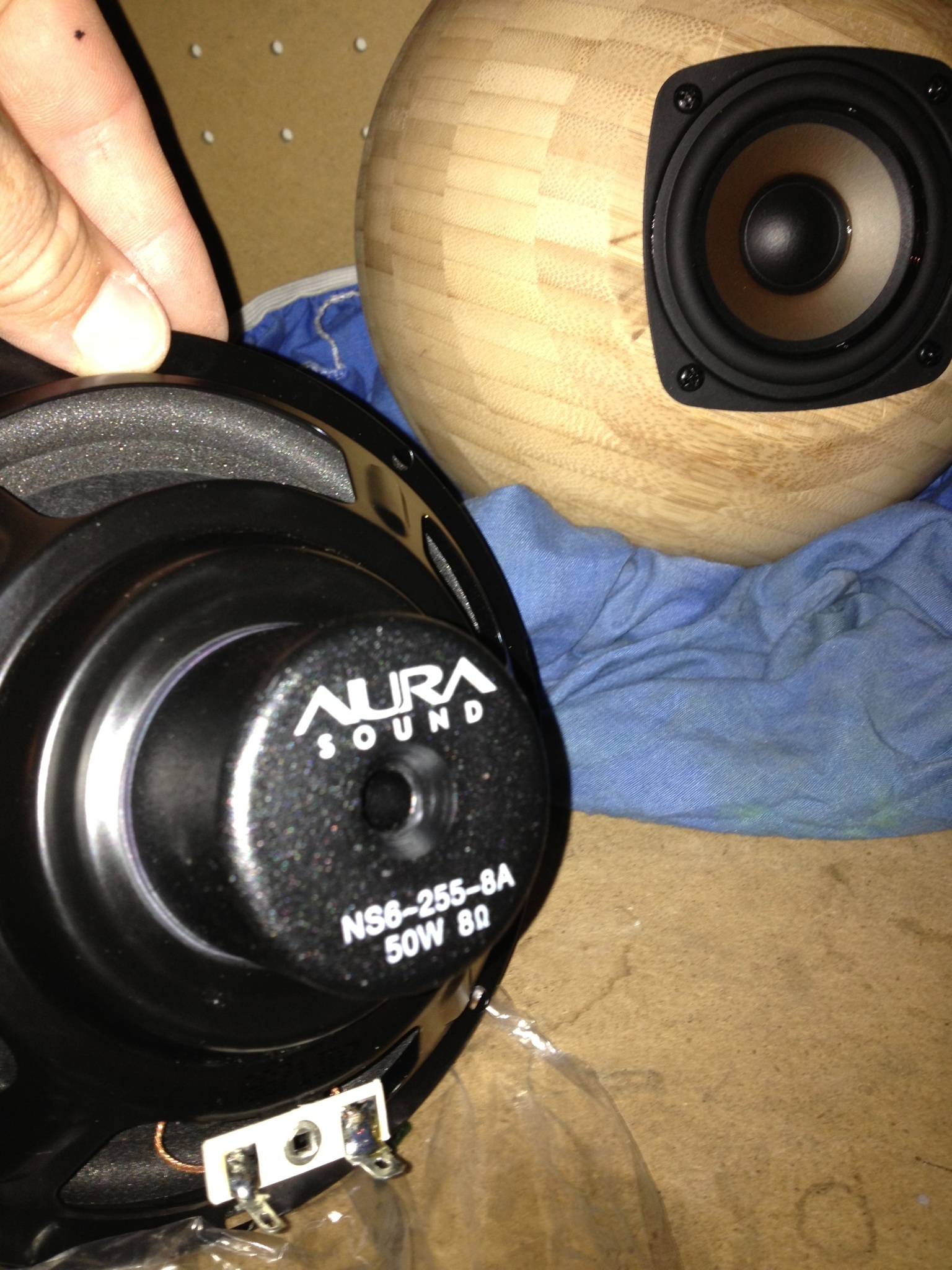

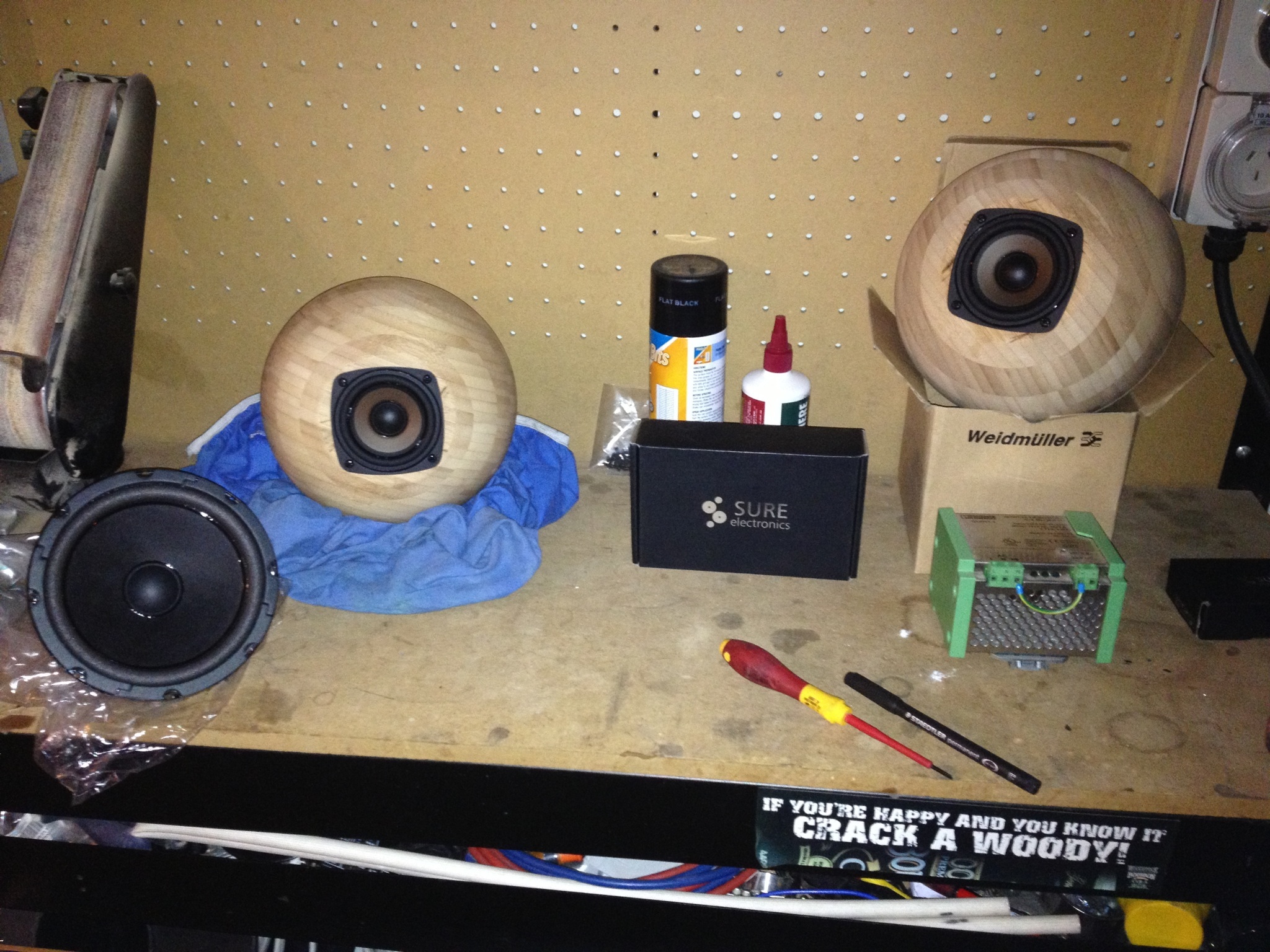

Here's a set I just finished 20 cm with the tang band super cheep w3- 881si 3 inch
Gonna run a sure 25 w x 2 class d
Might go sealed if some one can help me with a simple low pass filter
And any ideas I was hoping to use the 6.5 as a small sub

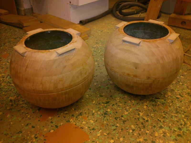

Progress!
The extra bits are mounts for my tweeters which will be in a ring around the midrange. Current plan is to cover the whole inside and outside with wool carpet... but might be overkill so perhaps I'll settle for covering only backs of the tweeters on the outside and around the edge of the midrange.
