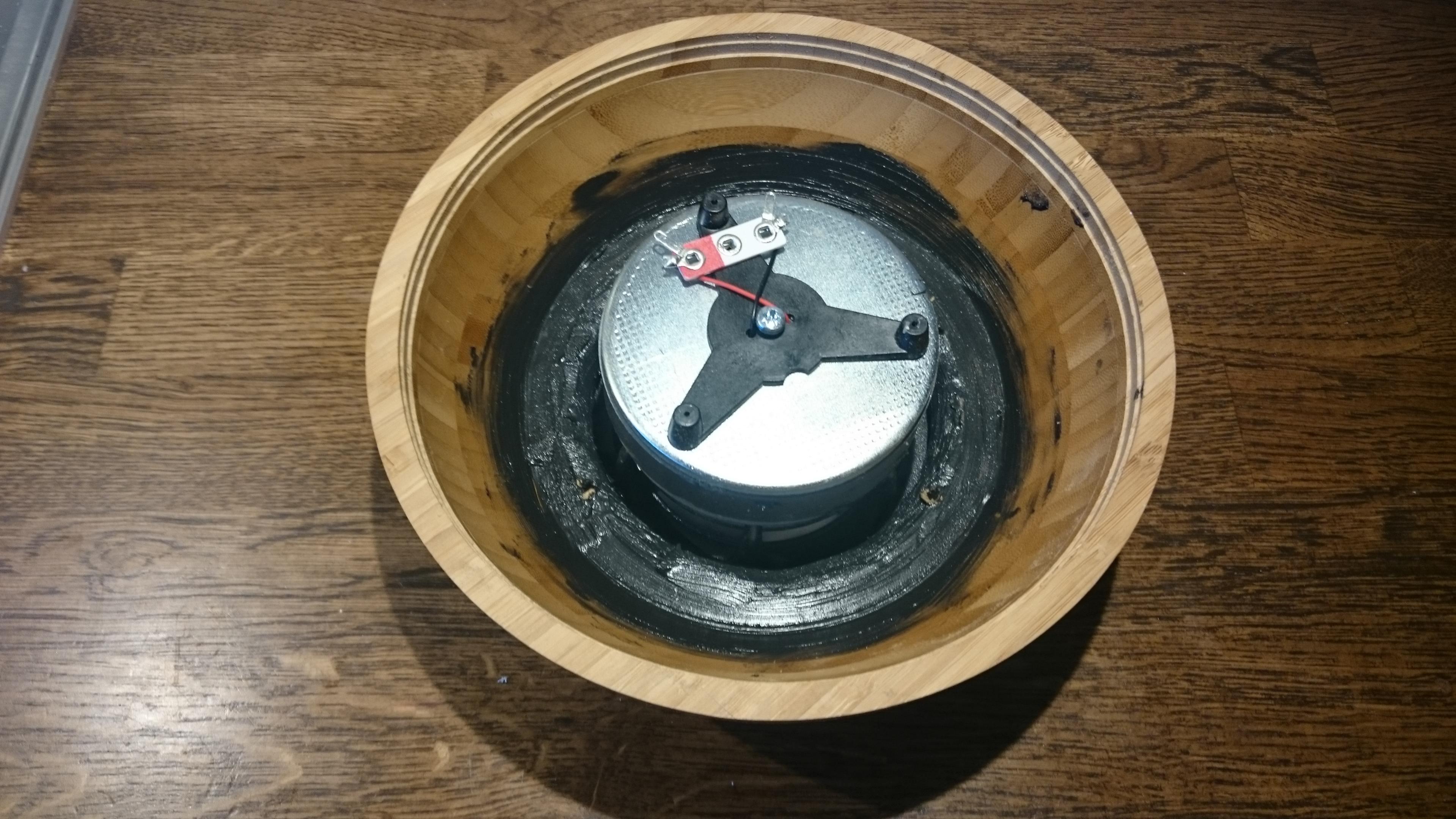

The prototype

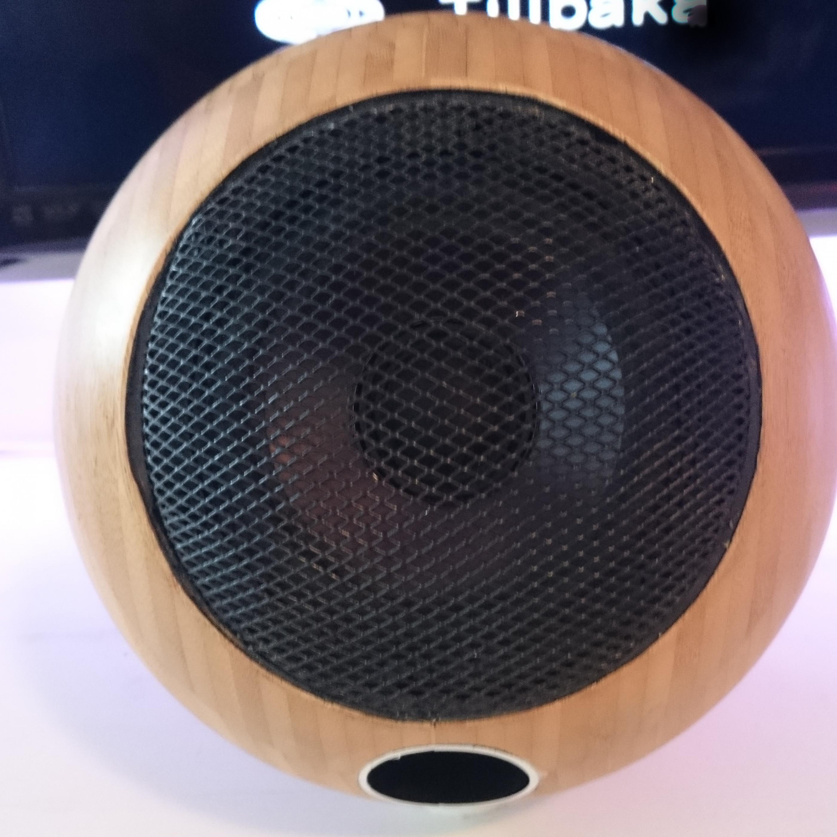

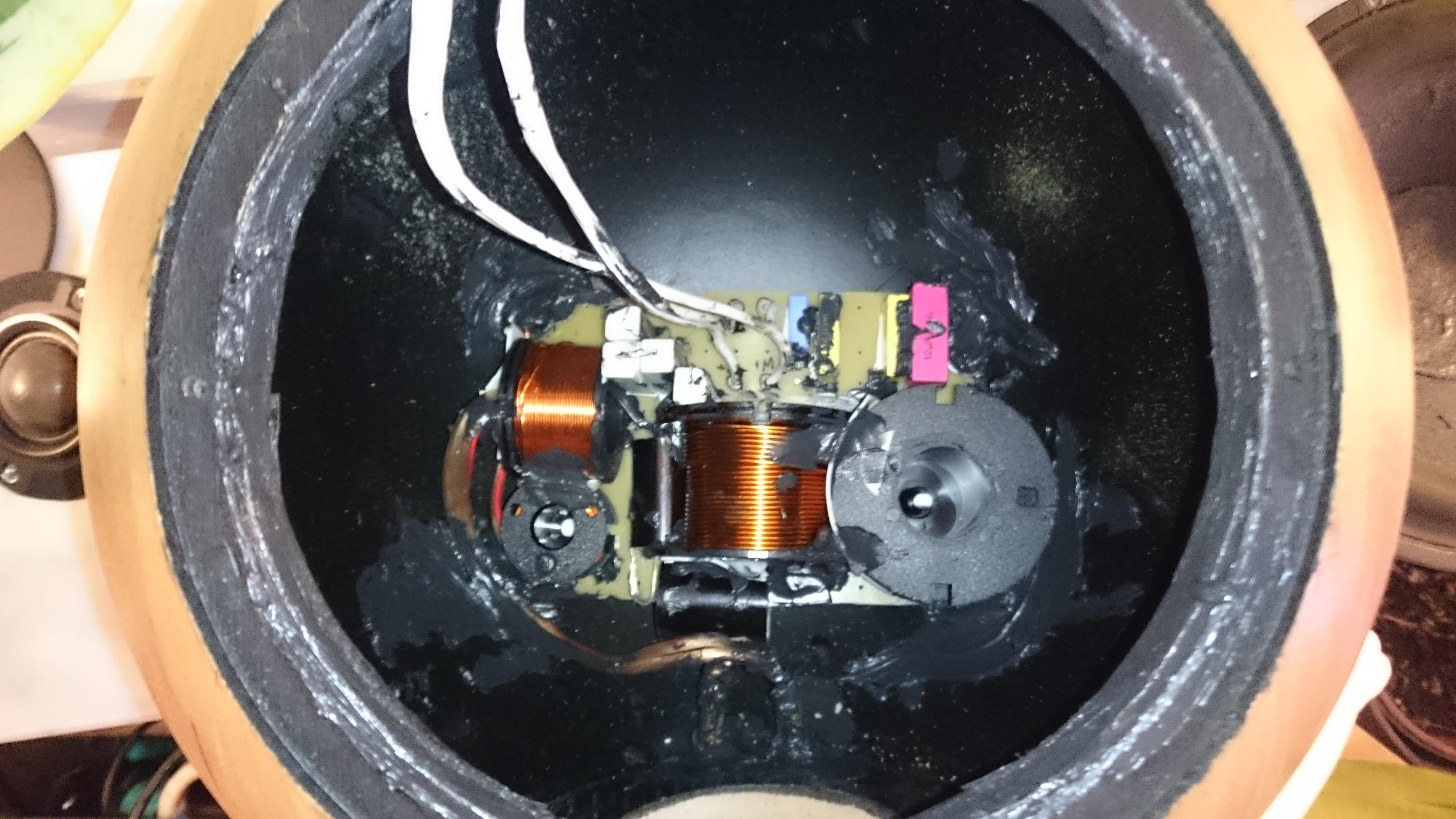

The Seas coax pumps a lot of air
After a lot of tests and meauserments I had to recalculate...
Nothing else to expect in a small enclosure . I had to go for dia. 36 mm and 324 mm long. This affected of course the volume which now is 2,2 liters.
The fB is still set to 63 Hz but the f-3dB went up to 80 Hz. It seems ok when calculating and with the impedance correction it should give a pretty flat curve but measurements are of course needed to verify and trim the filter.
I also had a hearable overtone from the vent at 435 Hz which hopefully may be gone, else some other damping must be used in the enclosure.
I think thes will perfect in combination to a bass module or as surround speakers. To be coninued...

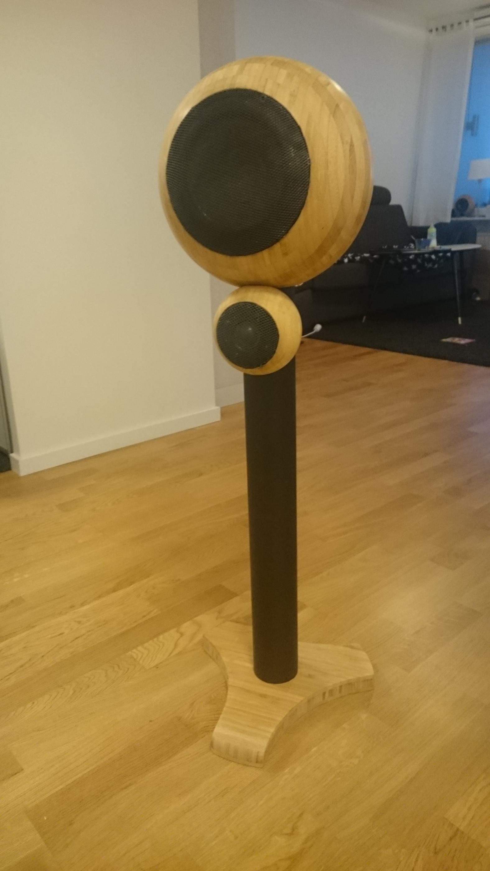

Seas coax result
The changes made an improvement. Still breathes heavily but the air speed is down to accepable levels (no distorsion) and with some filling the speaker is also better controlled. The sound is now better balanced after further damping of the tweeter. There are no sounding/vibrations from the cabinet (thin layer of low density glue/silicon and damping wool inside) nor any hearable overtones. It playes lively and clean with quite low bass (well it's tuned to 63 Hz but for a small cabinet like this...).
I will measure it when I get some time over. If it ends up good, four will be built as surround speakers. This prototype may be changed again to be tested as mid/high speaker combined with a bass module prototype I've just pu together using the old but great Scan-Speak 18W/8545 in a14 litres cylinder shaped enclosure. Will most likely be crossed over somewhere at 120 Hz depending on the result when playable/measurable. Nice combination though since both enclosures have a diameter of 200 mm. See picture.

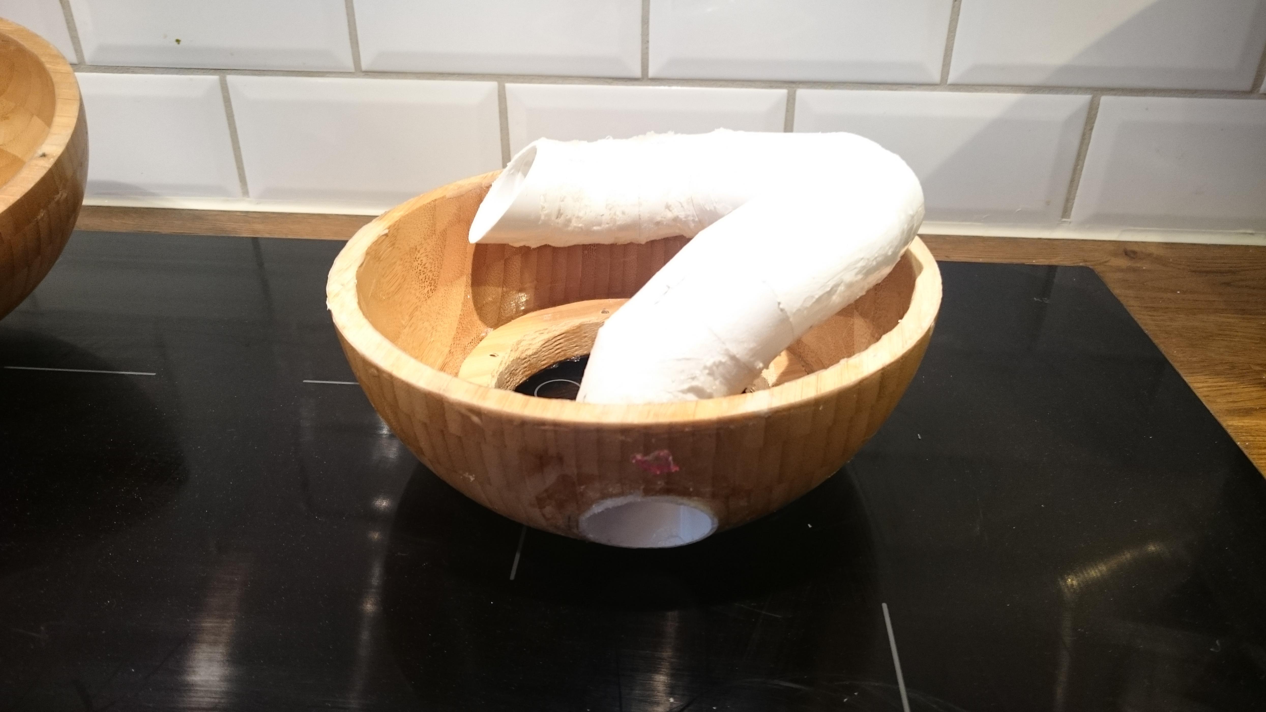

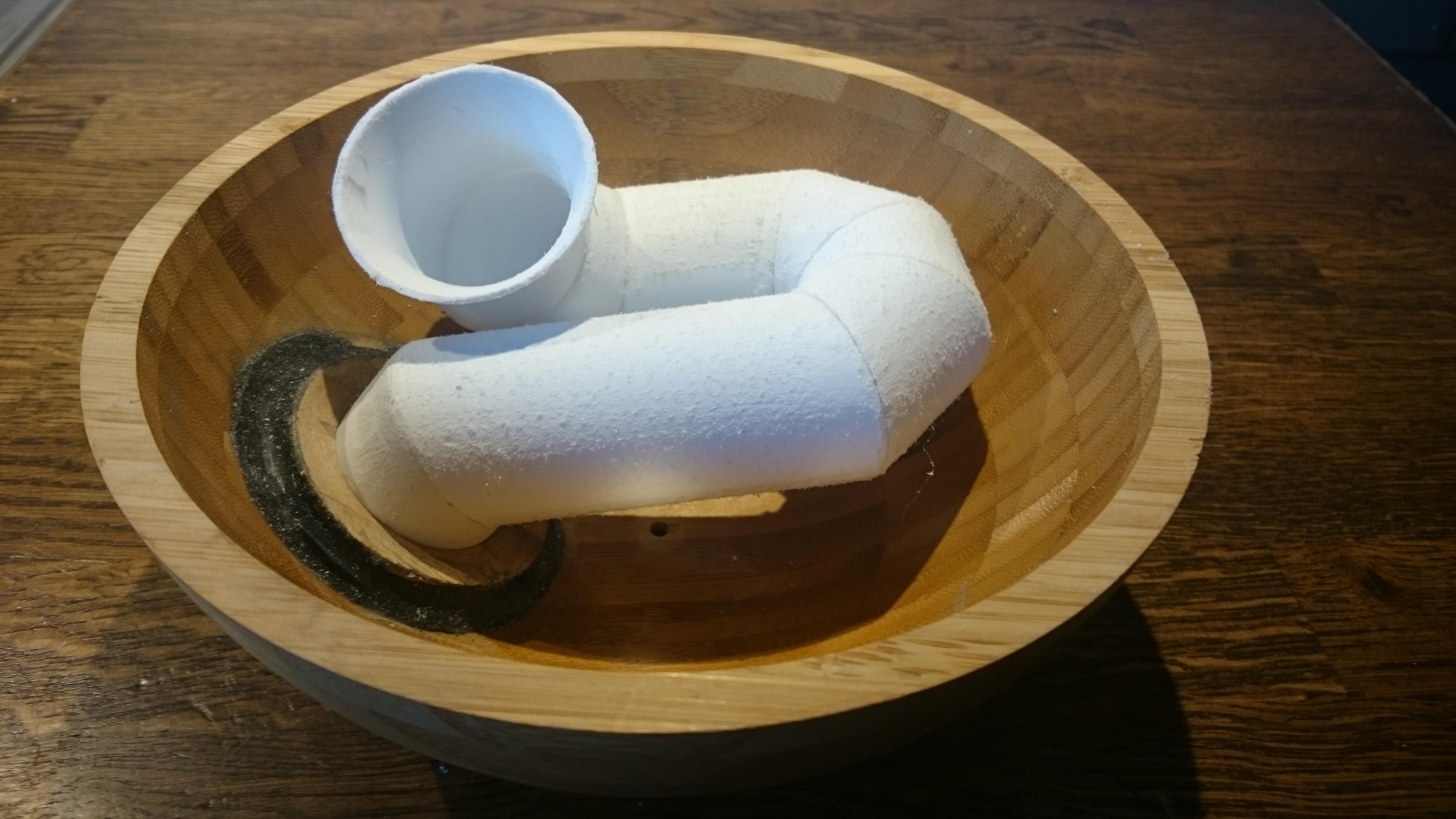

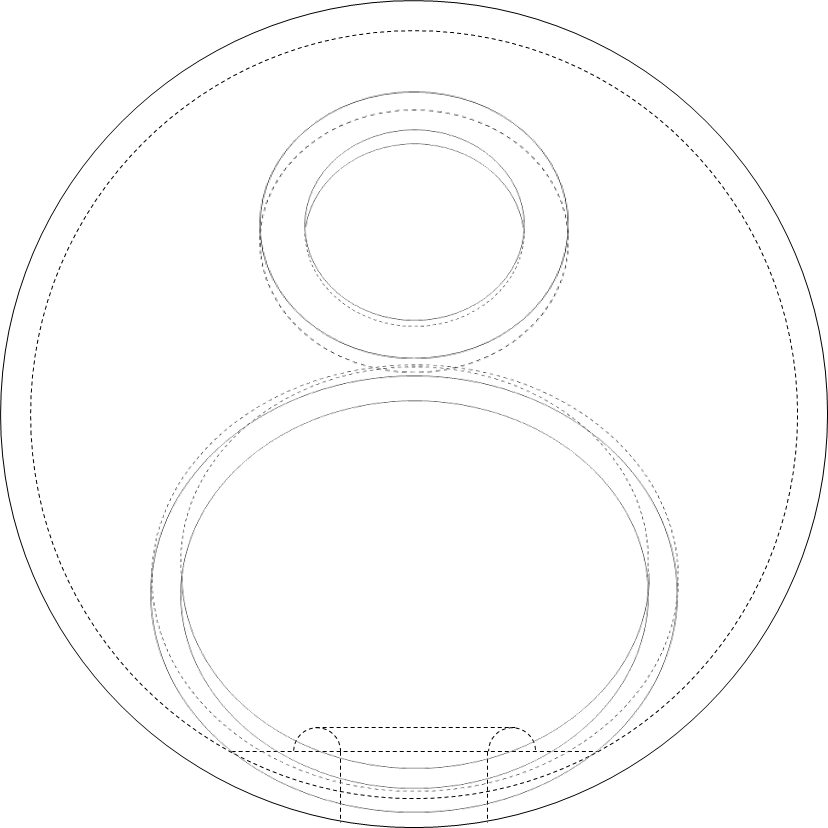

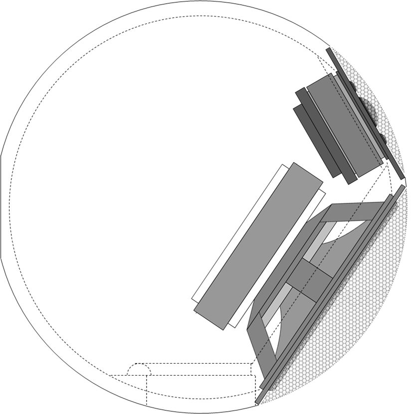

Another bowl idea
Just got an idea since I have a couple of Scan-Speak elements to no use for the moment. I'm going to test the woofer (18W/8545) and the tweeter (D2905/9300000) in a 28 cm IKEA bowl.
With a vent with dia. 6,7 cm and 67 cm long gives fB 45 Hz and f-3 63 Hz (flat response) out of 7,45 litres.
I know it is far from optimal and most likely there will be a need of reconstruct after measuring and probably increase the fB to maybe 55 Hz but it gives far more output than the smaller bowl with the small Seas coax.
It will also be of interest to find out how the angles of the woofer and tweeter affects the sound in the room and in the listening position.
The other solution is of course to increase the volume but I would like to test this. The bass below needs to be complemented with a bass module.
Attached are the idea. I will see when I have some time over, as always.

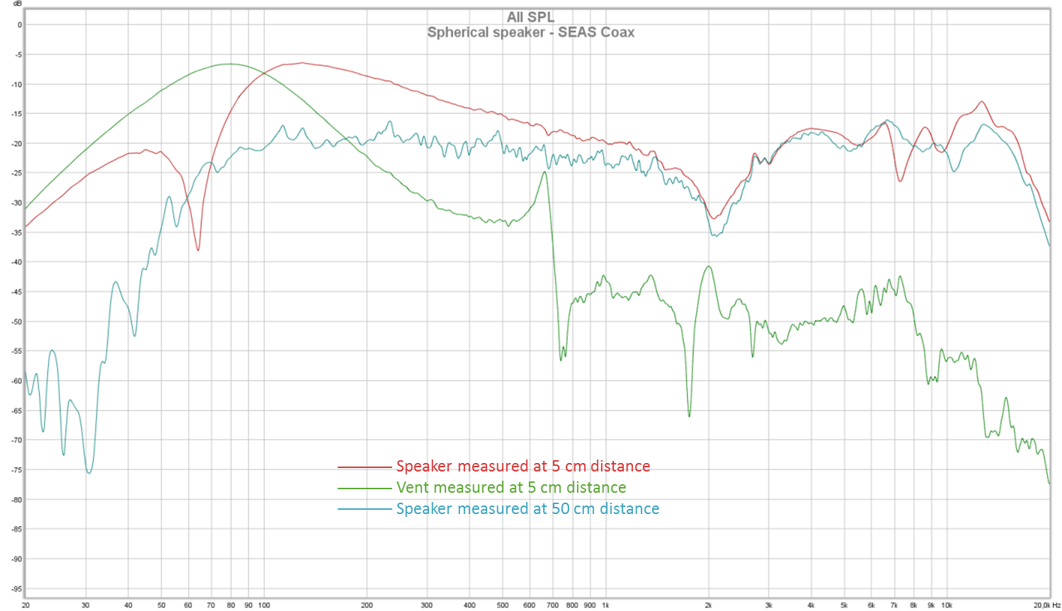

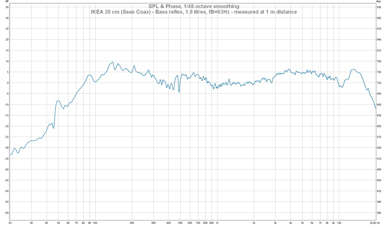

A measured (and hearable) problem
Anyone knows howe to deal with this dilemma. It's hearable 🙁. What if the port is facing down or ends up in the rear or is it just possible with a bigger diameter of the vent if I want to keep the tuning frequency?
Made a quick measurment (using REW) 1m in front of the speaker which shows a problem caused by the port between 600-1000Hz (See pic.).I will measure it when I get some time over.
I have now realixed that the meauserments are made by a bad microphone (same results on four different speakers) and have ordered a new microphone. Hopefully the results turns out to the better 🙂

I have now realized that the meauserments are made by a bad microphone...
What is that mic that you believe it doesn't work right?
It is a Dayton UMM-6. However, I cancelled the order for a new mic since I found out that the calibration file was corrupt. I downloaded a new one for my mic and the result is totally different.What is that mic that you believe it doesn't work right?

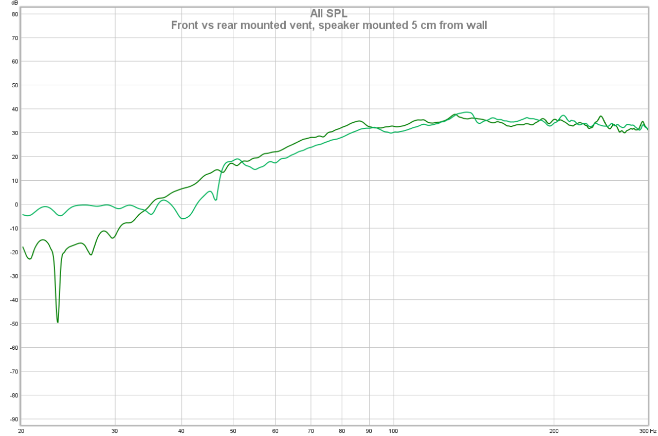

I've mad new measurments where I realized the fB was wrong - 56 Hz instead of calculated 63 Hz. I had to shorten the vent and the result is much better!
Not only the measurments looks better (Attached pic.), it sounds better and the hearable overtone from the vent is gone even though it's still measured as quite big.
Well, it seems that the only thing left is to adjust the filter to remove the dip at crossover (2 kHz) and then build four of these as surround.

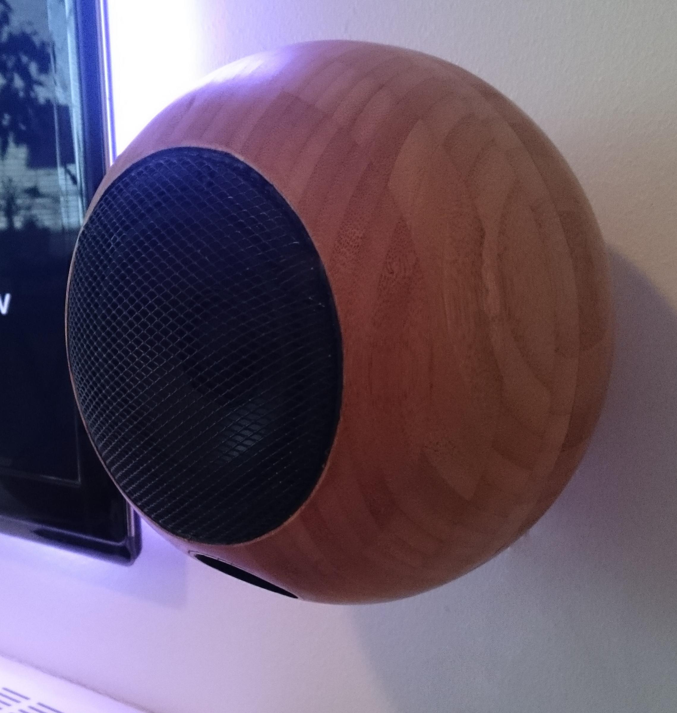

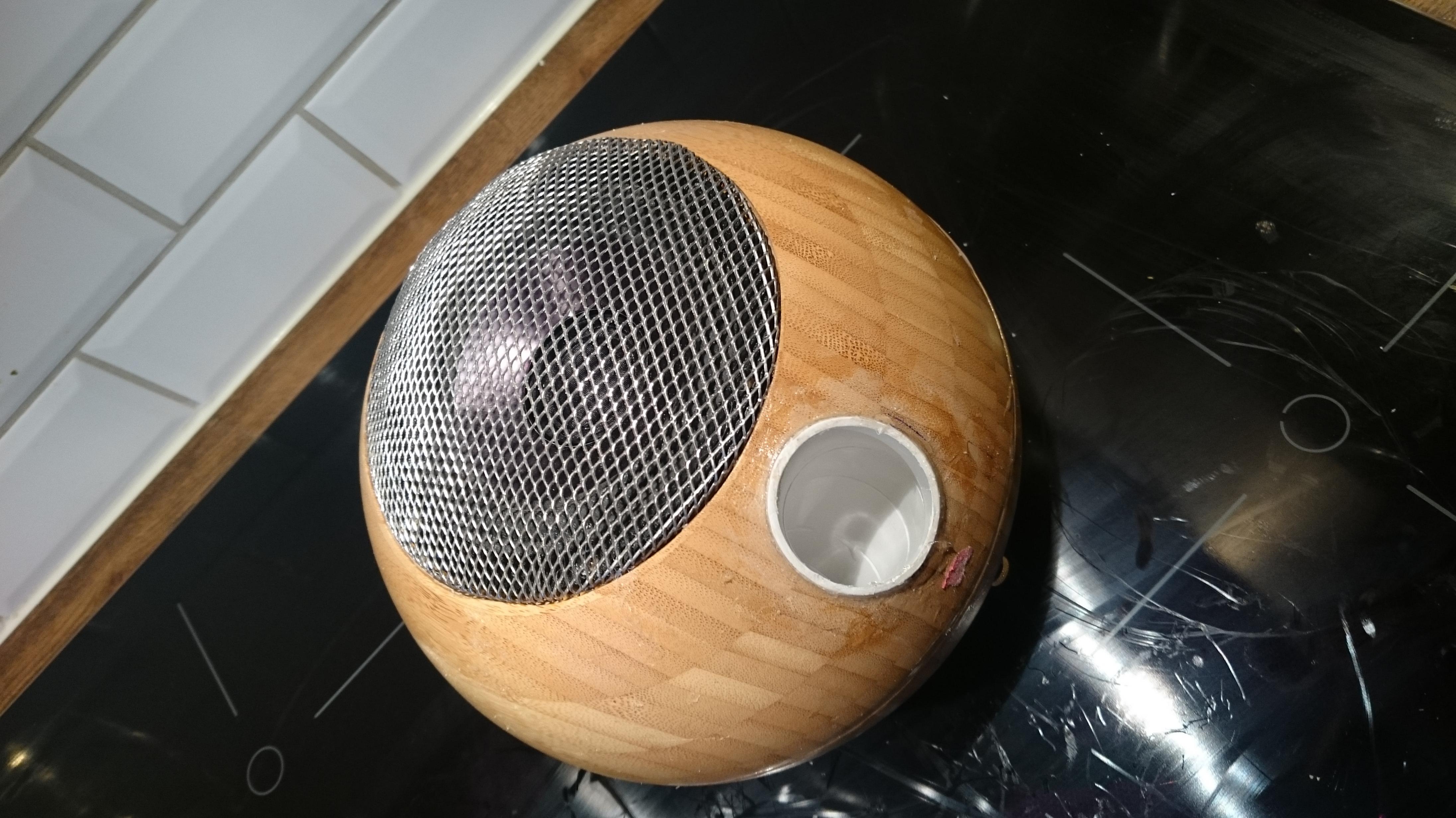

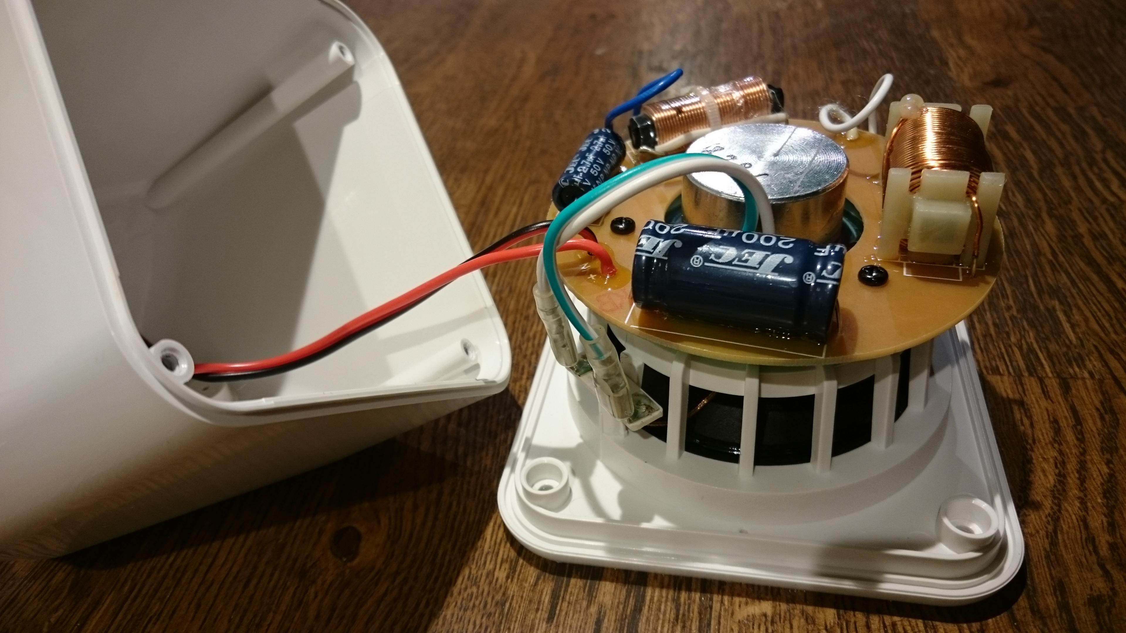

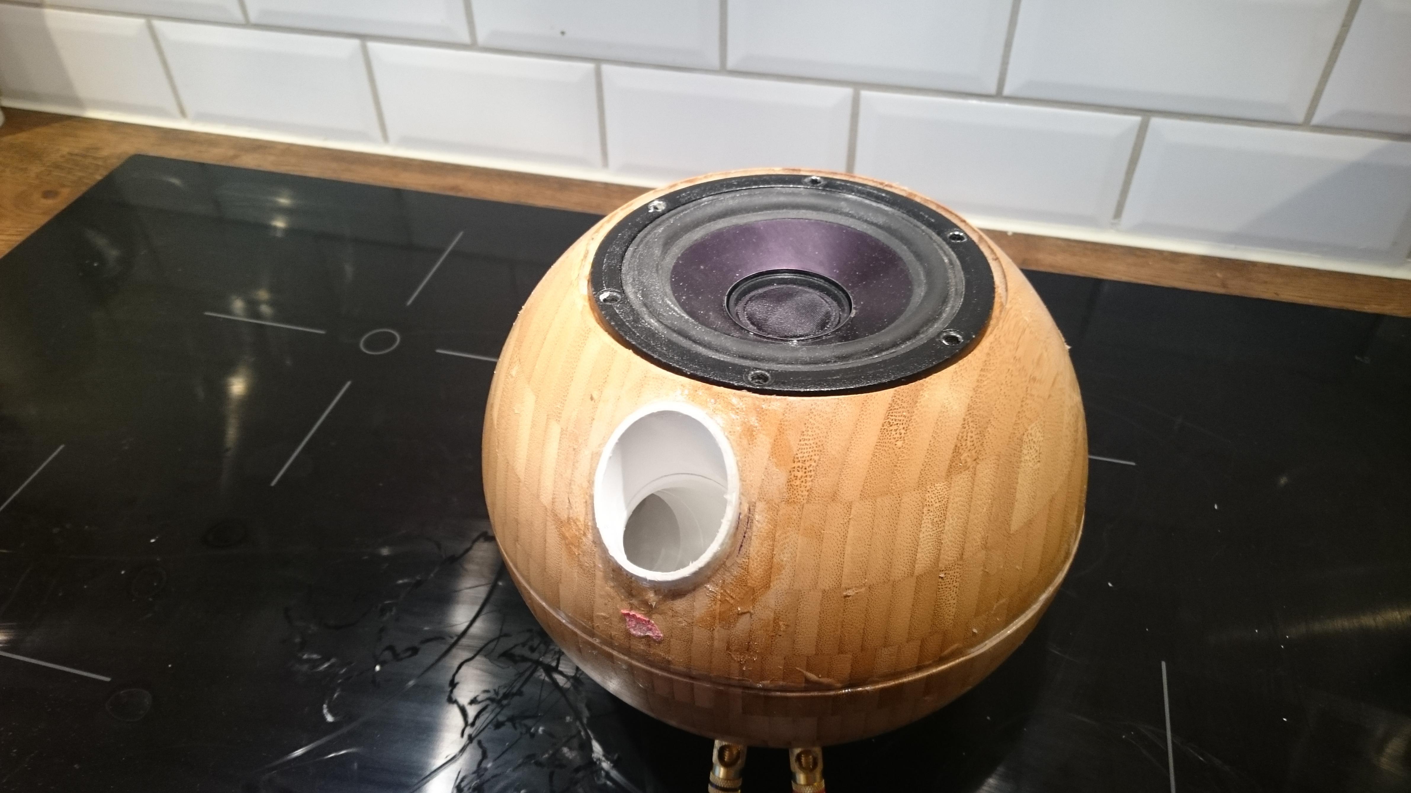

Final version

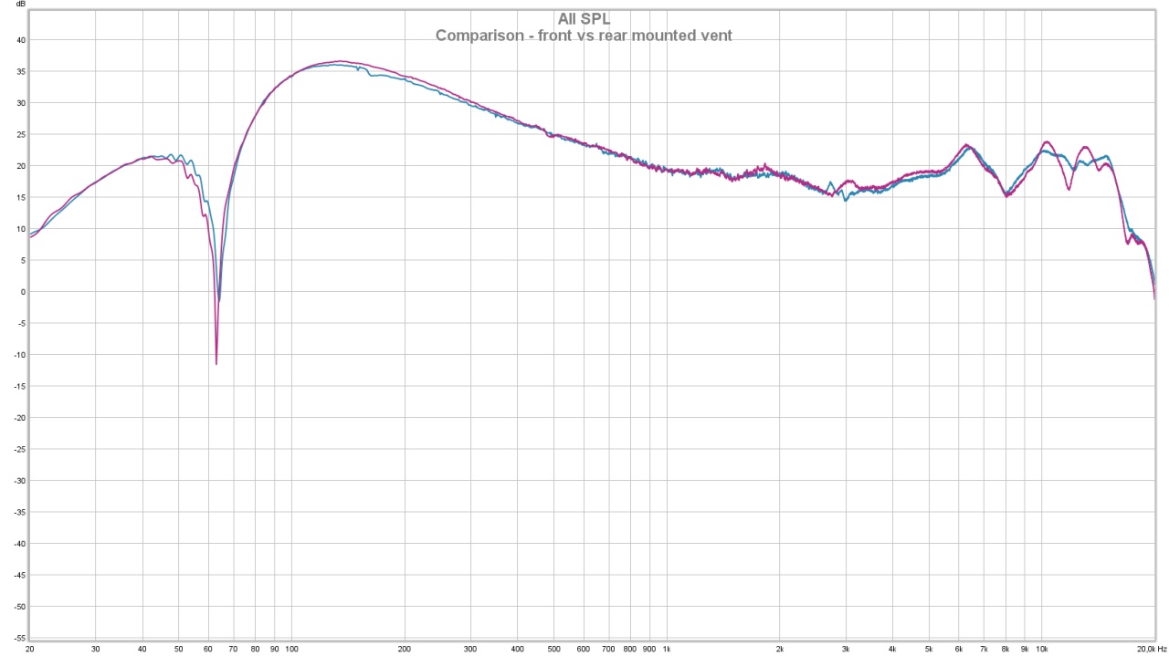

After measuring and listening it was decided that the four spherical surround speakers will have the vent facing the wall, slightly downwards. This will of course help the low end but when meausering it shows this is a less good solution. However, it sounds better with a more balanced bass but also a tighter bass so the decision was easy. I have attached a picture showing the difference between the two vent placements.
Also the dip at crossover (2kHz) that I had earlier is gone after changing polarity of the tweeter.
The filter (not showned in picture) is placed in the enclosure around the vent so the remaining volume is approx. 1,8 liters (tuned to 63 Hz). I'm impressed how deep (relatively), clear and balanced this small speaker sounds. Now I can throw my crappy Boston Soundware S system I used as surround. Well, it does not sounds that bad but not good either and they reach only 150 Hz before failing. The speaker and filter quality was cheaper than I could imagine (see pic).
After I finished these four I will start with the bigger bowls (9 liters left after speakers and filter are installed) tuned to 42 Hz.
Spherical speaker - SEAS Coax - front vs rear mounted vent, speaker mounted 5 cm from wall.png76 KB · Views: 696
Spherical speaker - SEAS Coax - Nearfield measurement - front vs rear mounted vent, speaker moun.jpg138.7 KB · Views: 202

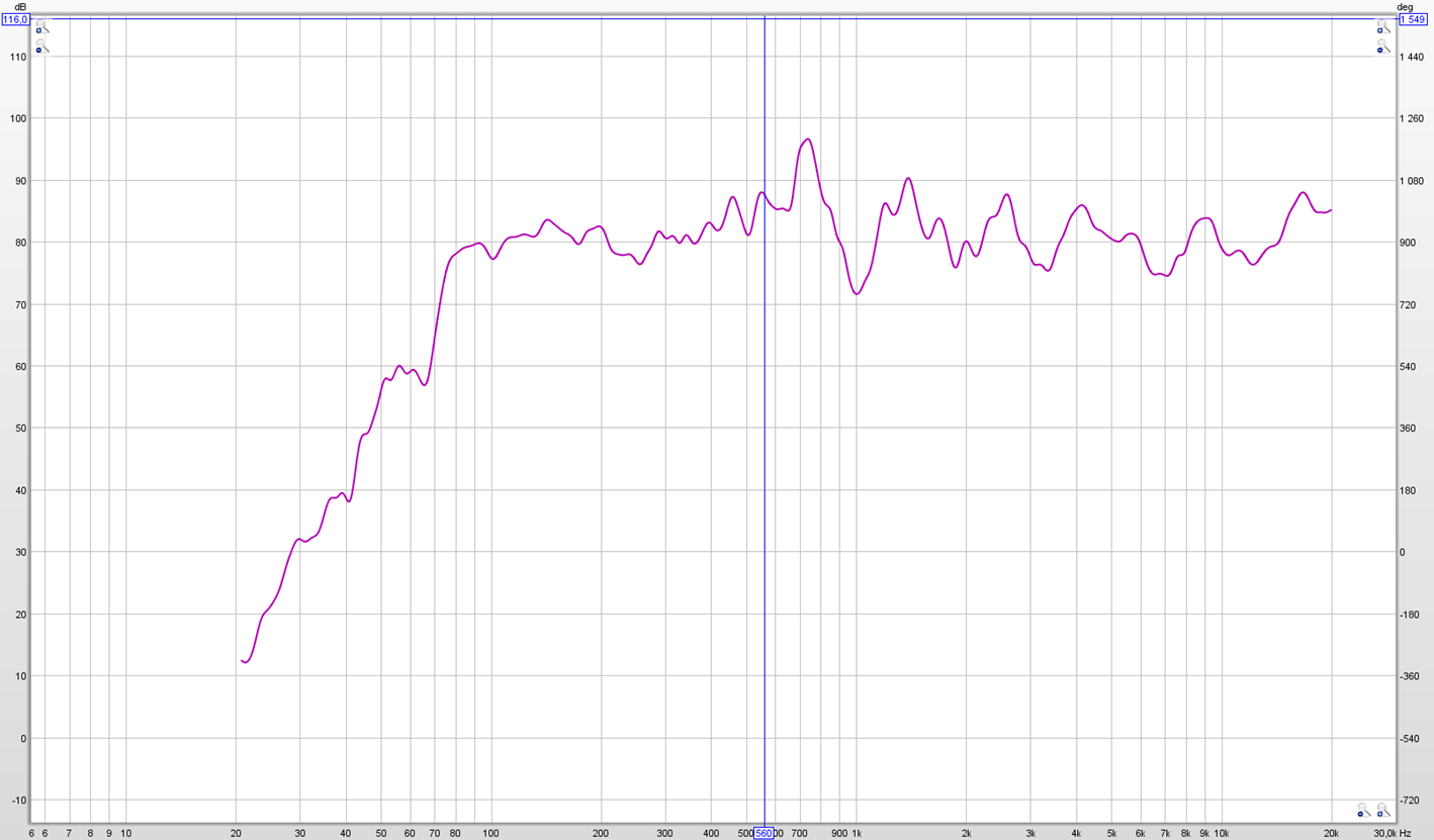

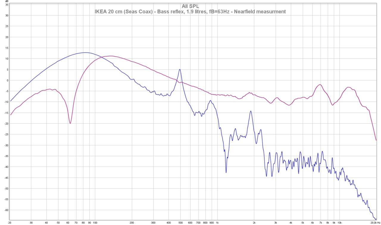

Final adjustments and measurments of the surround speaker - results
So I've made the final adjustments on the surround speaker (20 cm IKEA bowl speaker with Seas coax). Fine adjustments on the vent and on the filter (slightly dampened the tweeter) after several hours of playing. The speaker now sounds as good as it can and the measurements shows the speaker itself is tuned correctly. Next step is of course to measure the room but that will have to wait until all speakers are ready and mounted. It feels good to know it's now ready and just to build the others in parallel (else it will take long time to build one after the other and maybe never finish them 😱).

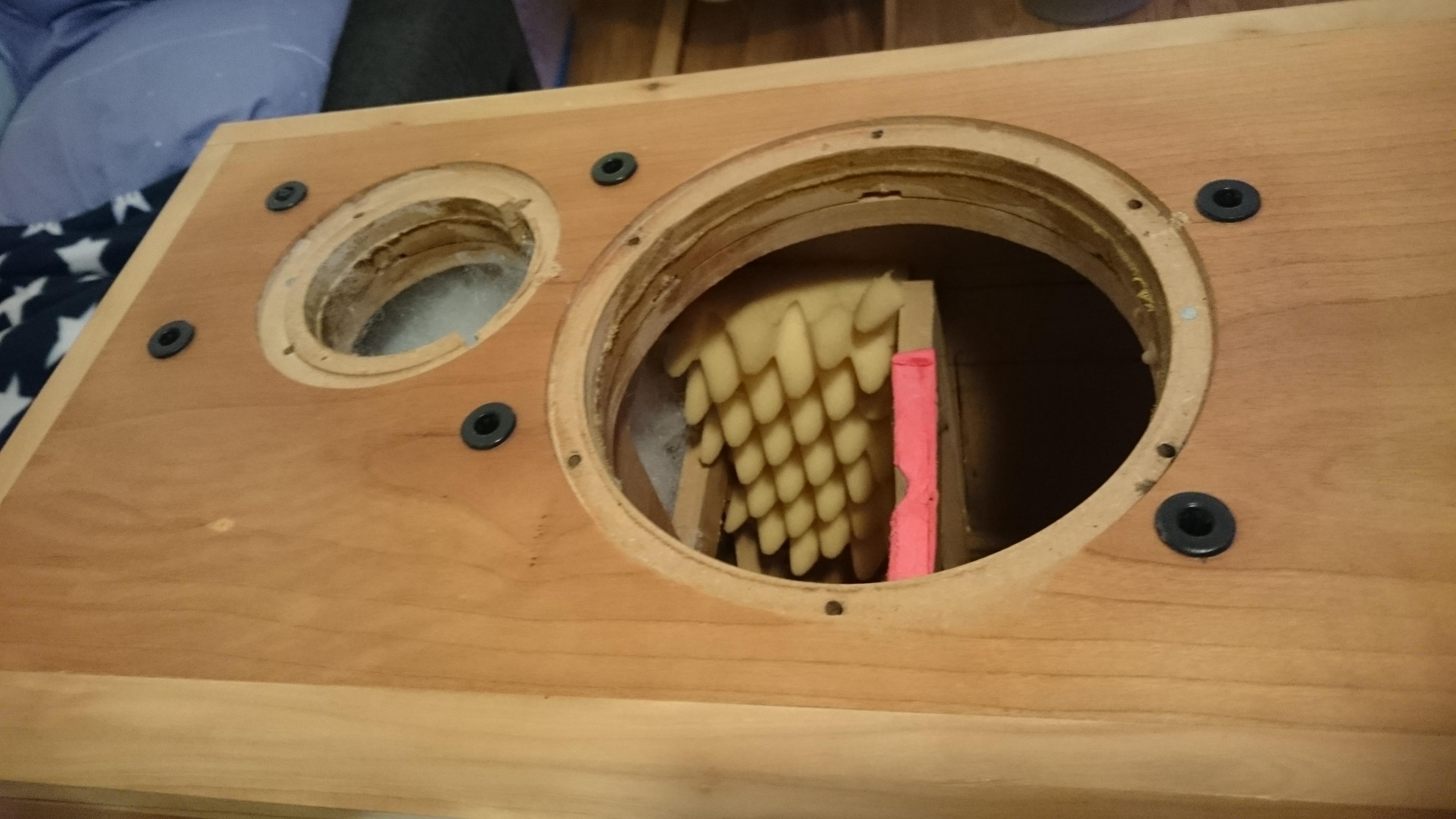

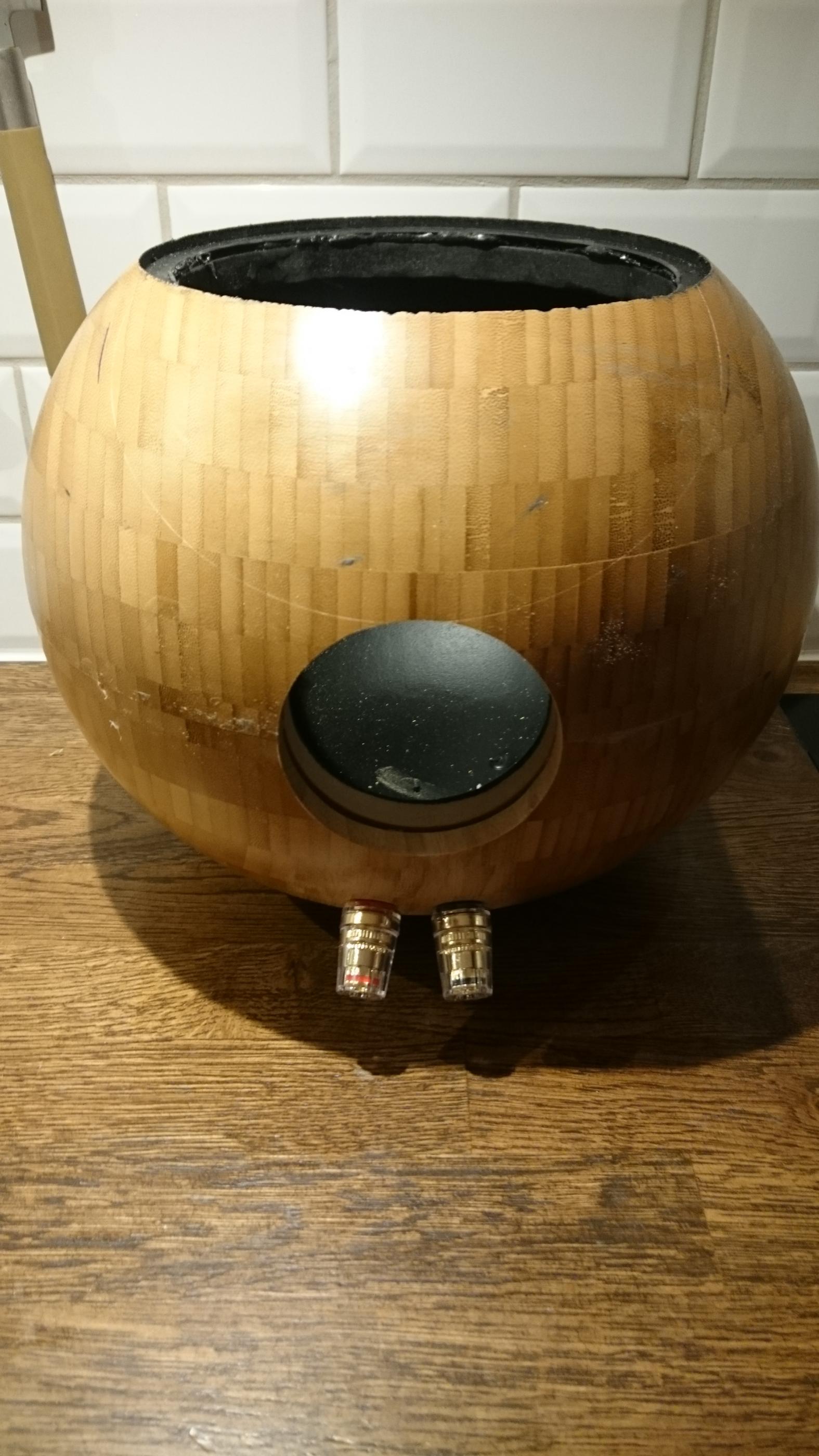

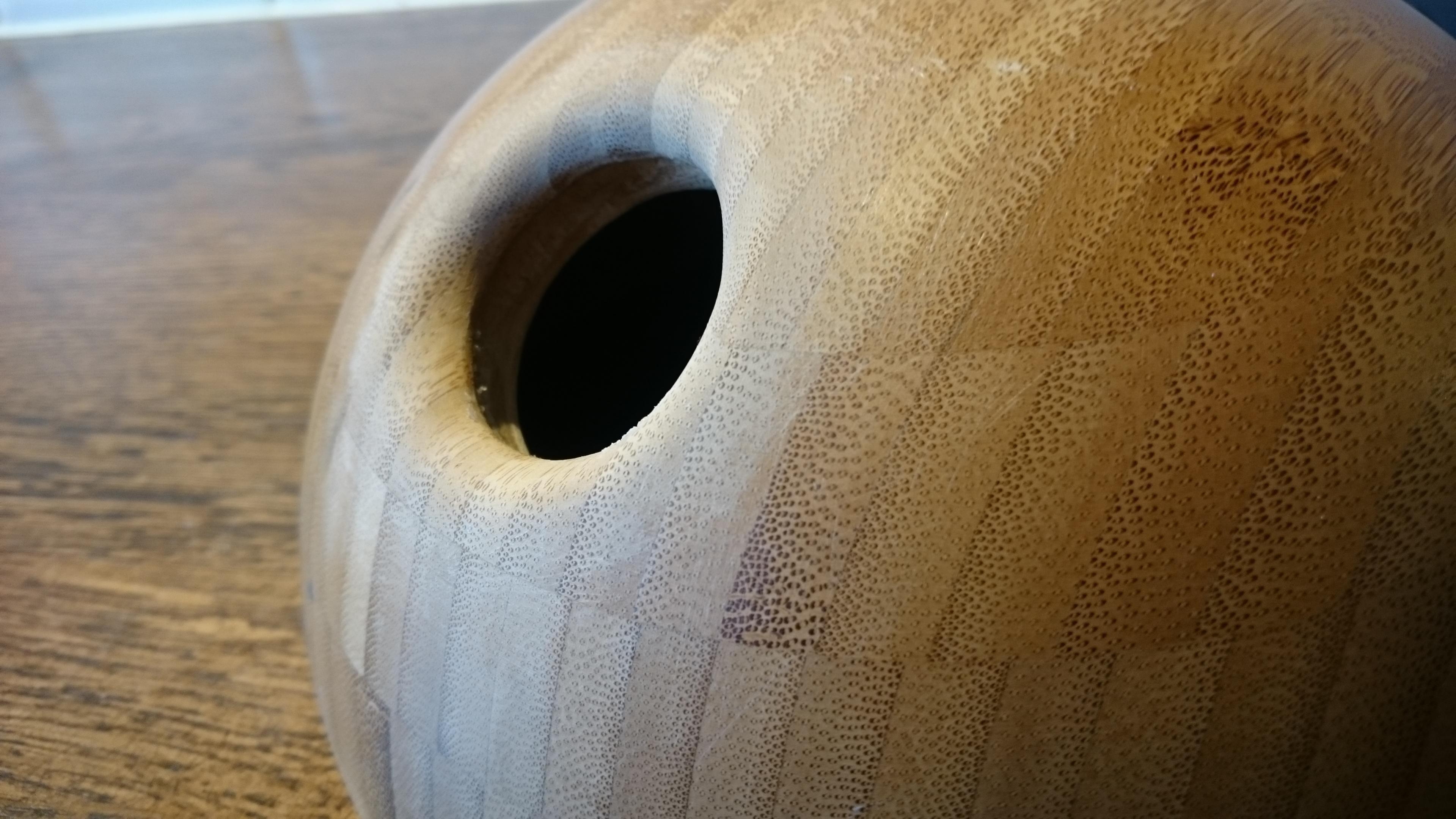

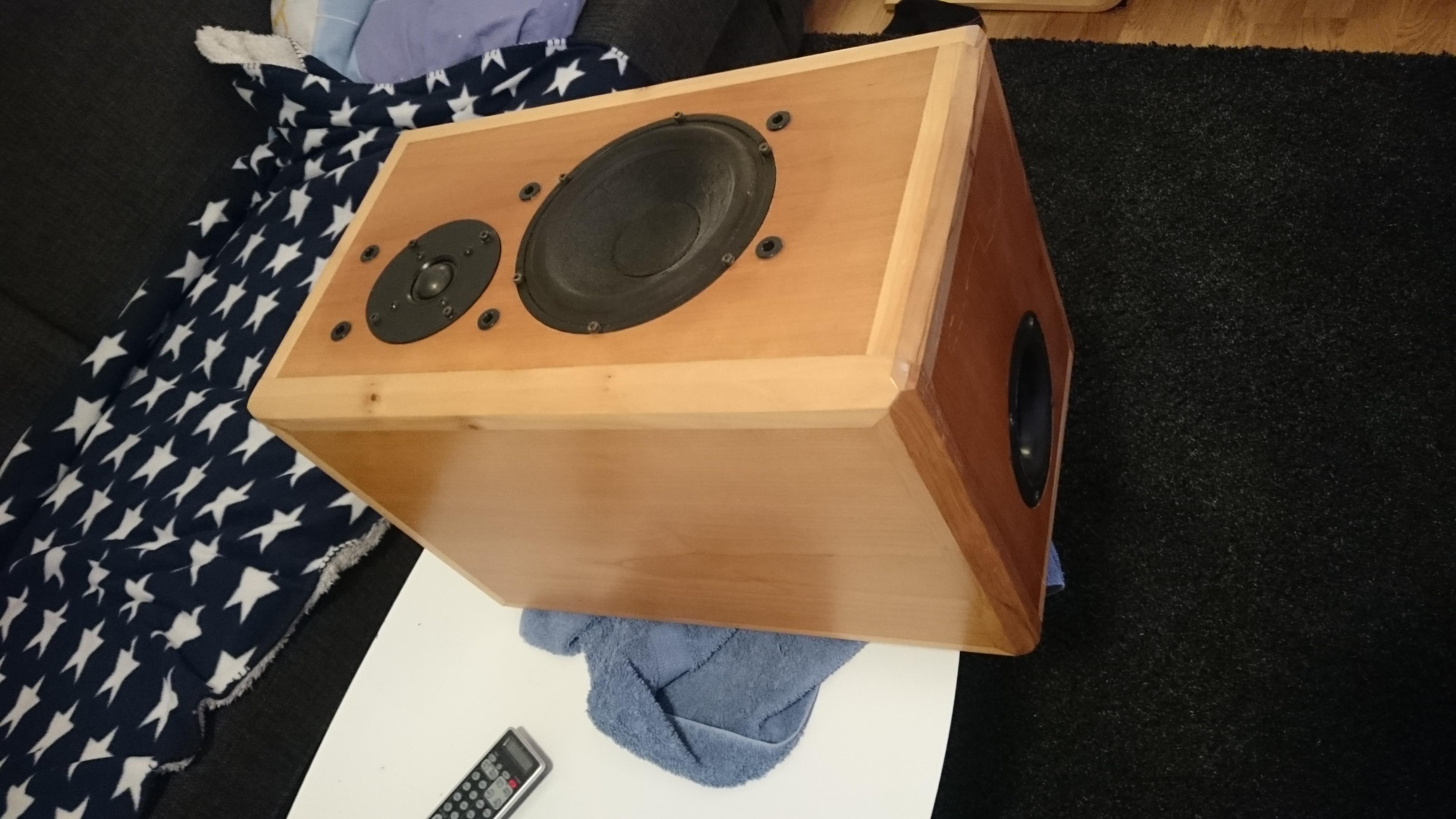

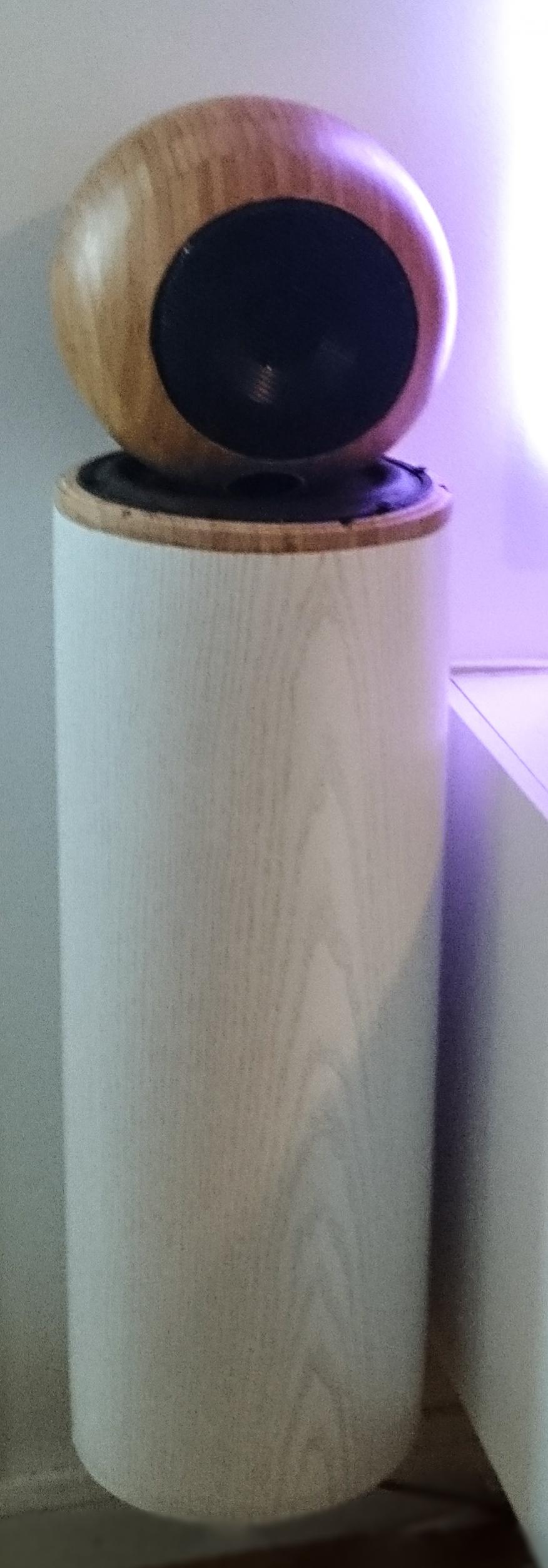

New challenge

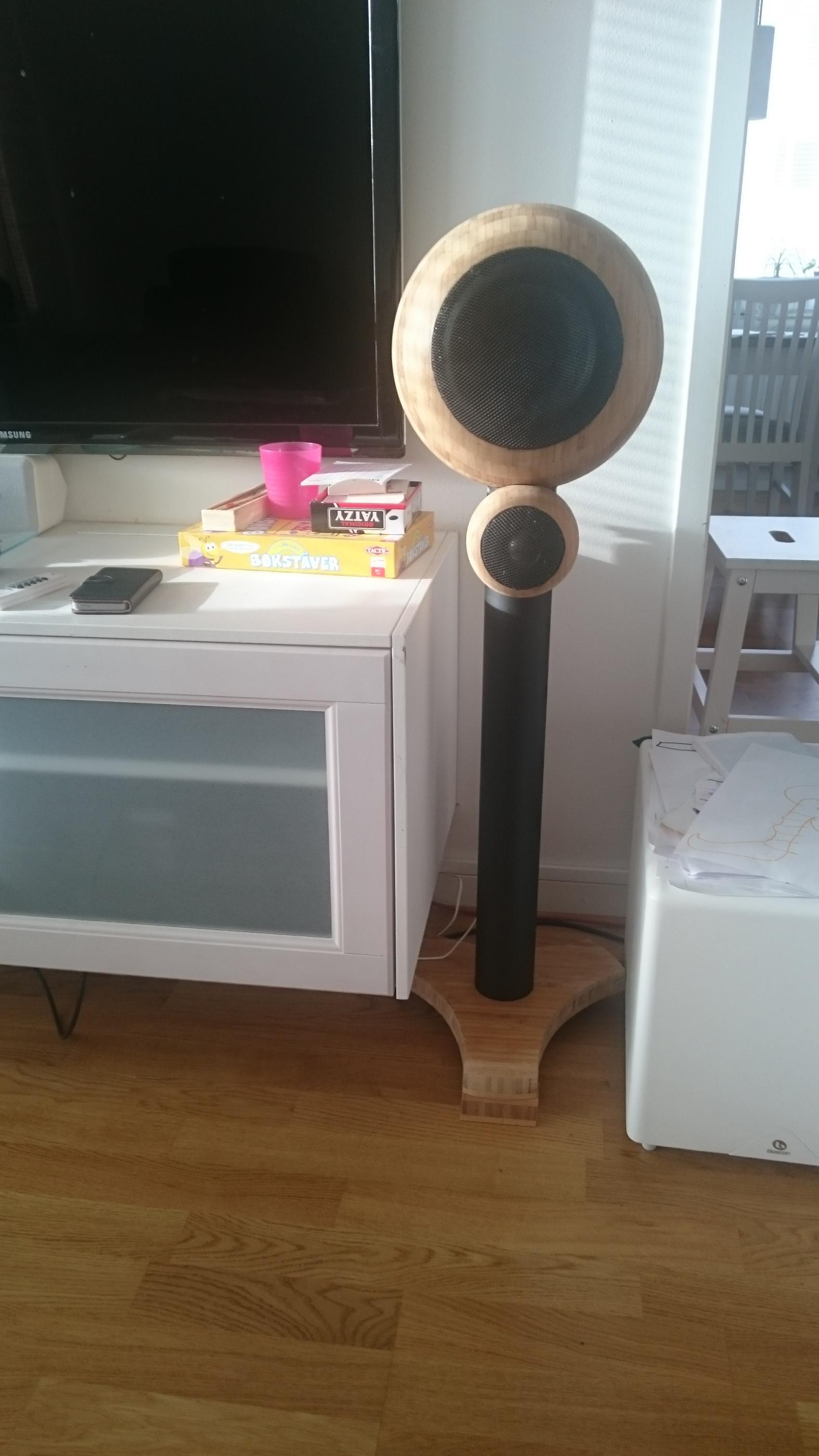

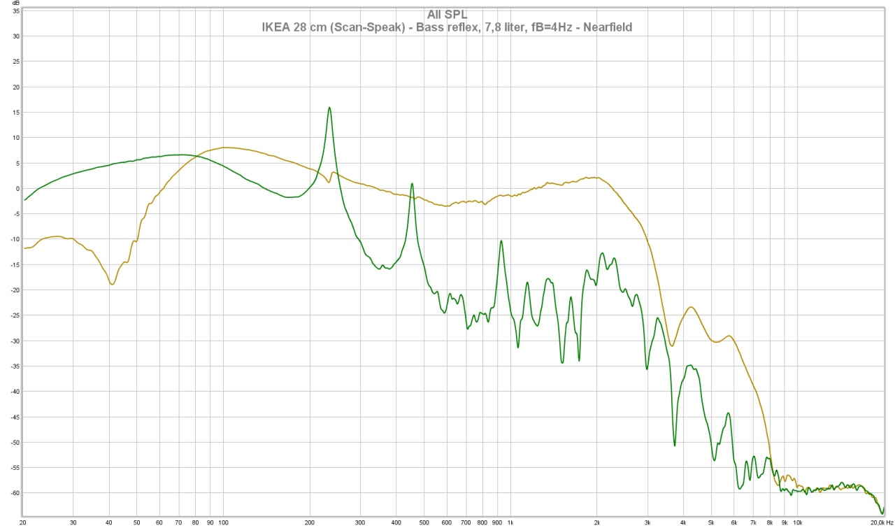

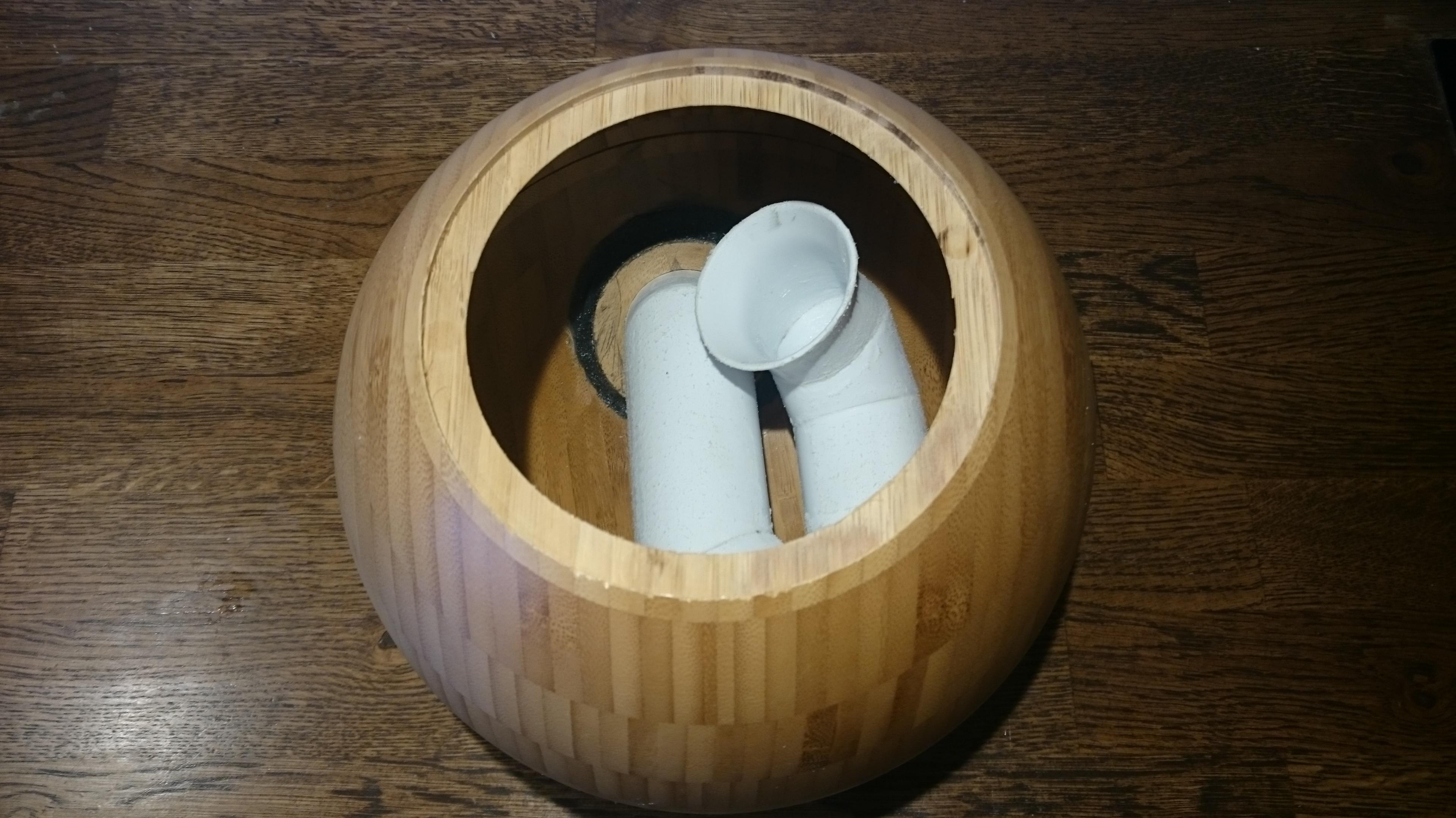

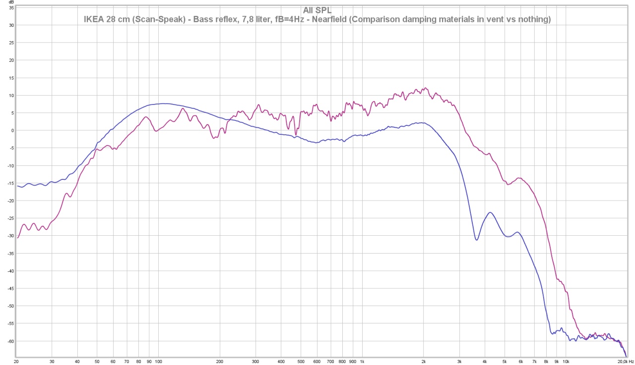

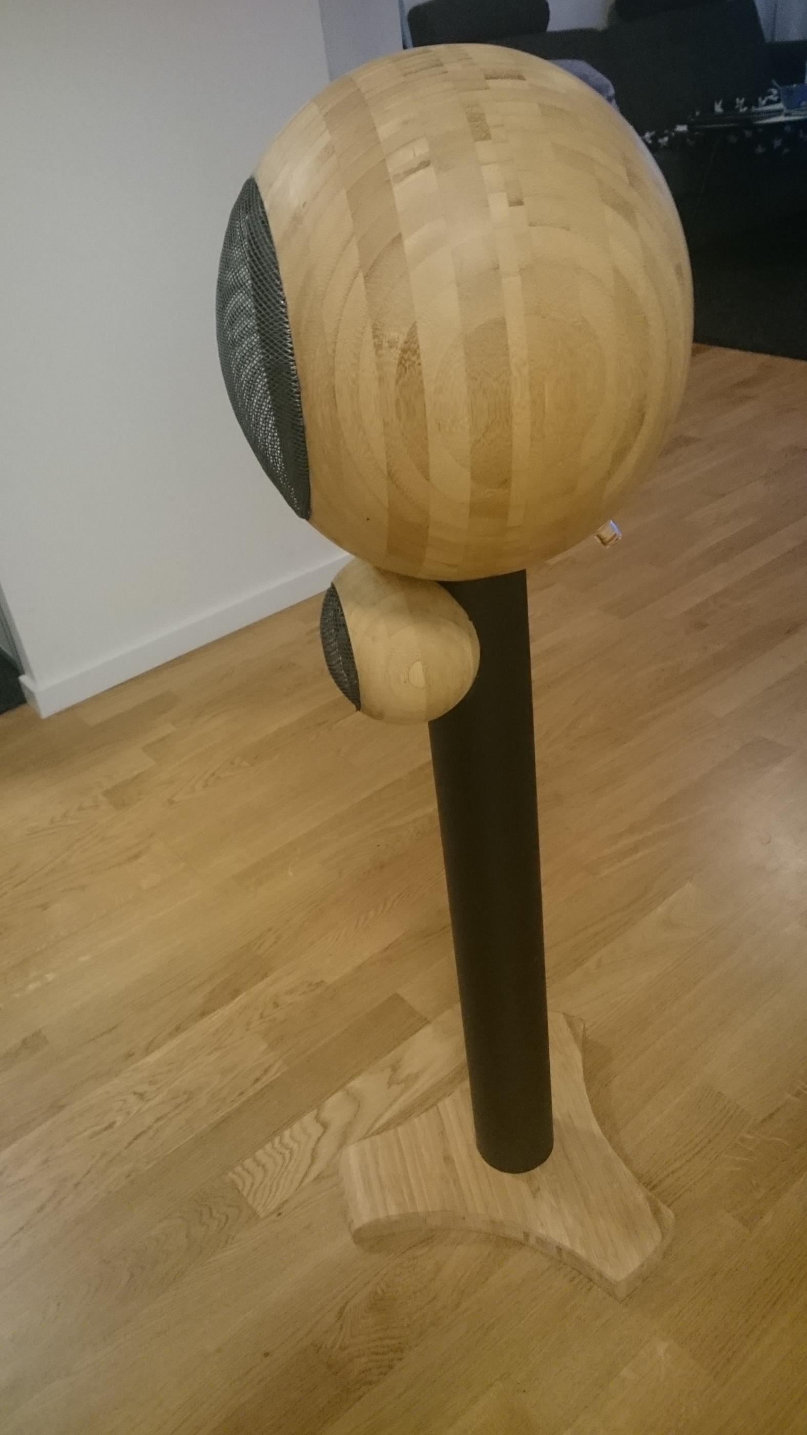

I've started a new build project with the IKEA 28 cm bowls and Scan-Speak 18W/8545 together with the Scan-Speak 2905/9300 that I didn't used for a while. I really thought this wouldn't sound good together but now after completed the first I'm surprised, really. The bowls only offered 7,8 litres after the speaker (flush mounted), filters and damping materials had been installed.
I calculated the fB to 43Hz (to low with only 7,8 litres) on purpose to avoid any peak and still get it as deep as possible. The speaker itself can definately play lower but physics are physics 🙂. However, even though this affects the output it turned out to be a good compromise. The bass is extended without any peak, but of course it's far from perfect.
Since these bowls are made of bambu which is rather hard, which is good in one way but on the other hand doesn't dampen any vibrations either. Therefore the inside is covered with thick layer of rubber (found rubber spray - great stuff!) and the walls are covered with damping materials. I can't feel any vibrations from the cabinett (the spherical form effectively helps to eliminate it and the filter, speaker and some bracings inside transform the spherical inside to...not spherical and by that decreases the standing wave.

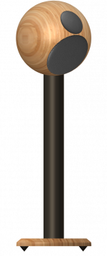

The bass reflex port is mounted on the outside, acting as a stand and enters the floor. I found this to be good because the sound from the vent (not by high air speed, 68 mm in inside diameter) but since it's a large and long pipe (due to small cabinette is needed to keep down the air speed but also because I wanted it to be long enough for a stand to acceptable listening height. The pipe is 68 cm long and the stand makes the woofer to approx 85 cm, the tweeter (mounted under the woofer on the pipe is at 65 cm height. This is not the optimal listening position but I have compensated this by the offset between the woofer and the tweeter to give a slight angle (2-3 degress) to perfect listening position at just over 1 m height, 3 meters away.

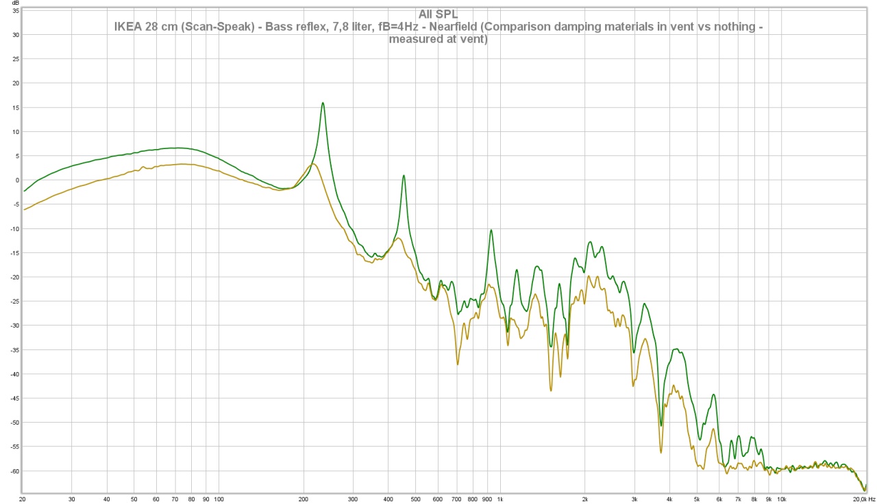

I could hear some tones from the vent that shouldn't be heard so I have tried with different amount of filling materials in the vent with very positive outcome to the sound but again to the cost of effeciency. The surprising measurement results from this is a deeper and a cleaner straighter frequency responce curve, interesting (First measurment picture where blue curve represents with filling int the vent and purple without). The bass sounded also dryer and more controlled. Will definately test this further when both speakers are built.
I attache some pictures and will keep you posted. Ps. the speaker are far from finished but the first listening and measurments looks promising.

IKEA 28 cm (Scan-Speak) - Bass reflex, 7,8 liter, fB=4Hz - Nearfield speaker comparison.jpg157.2 KB · Views: 371
IKEA 28 cm (Scan-Speak) - Bass reflex, 7,8 liter, fB=4Hz - Nearfield vent comparison.jpg166.1 KB · Views: 256
IKEA 28 cm (Scan-Speak) - Bass reflex, 7,8 liter, fB=4Hz - Nearfield.jpg161.7 KB · Views: 234
- Ikea spherical speakers, first build done.
