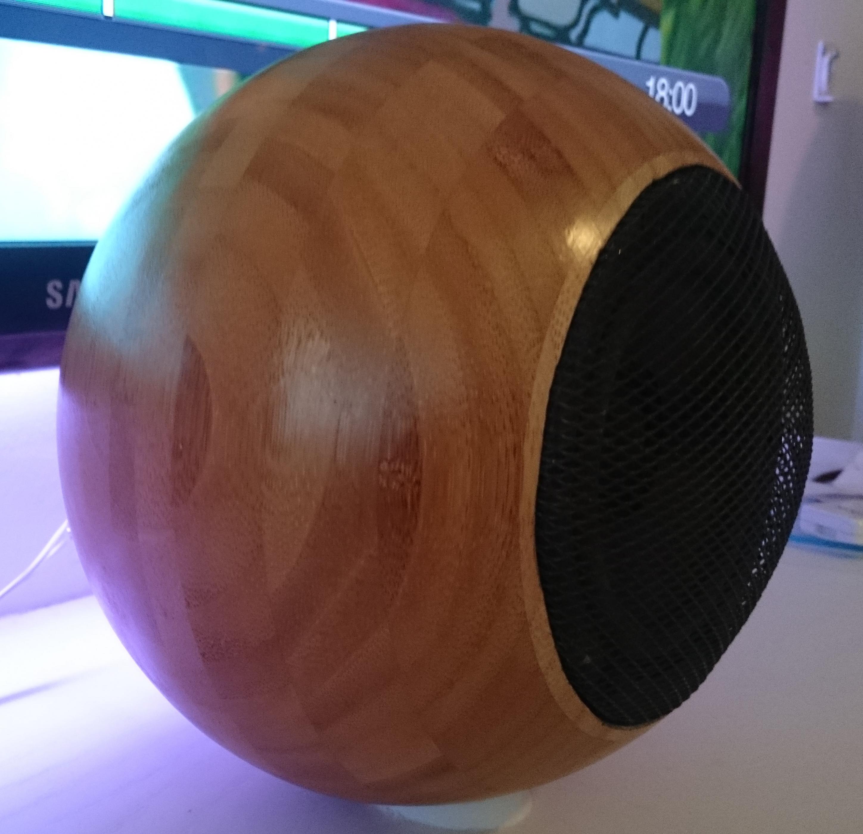

Ikea spherical speakers, first build done.

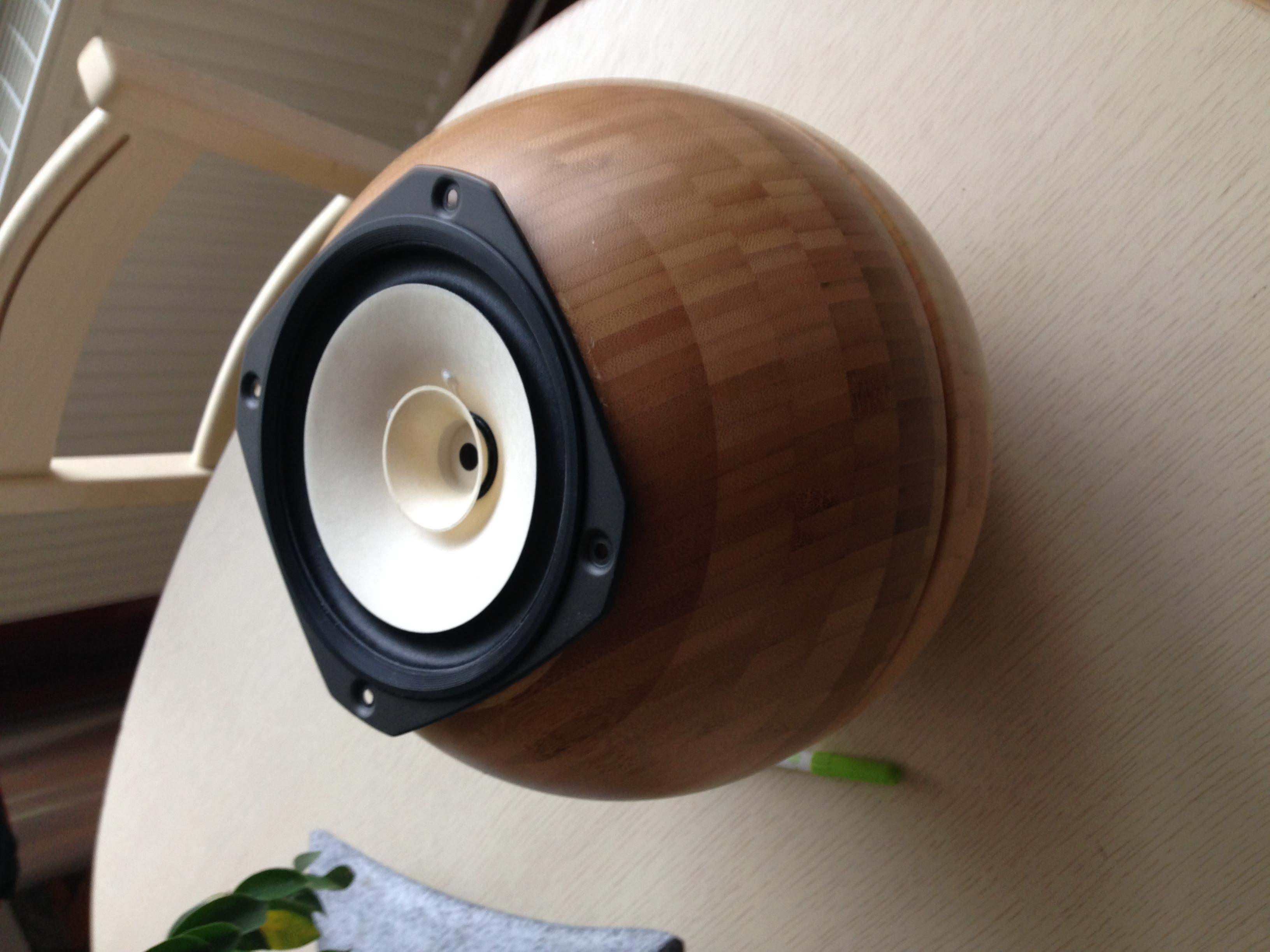

My project is a 2-way (before going 3), with a SBAcoustics SB34 woofer in a curved 136L box (not build yet). The Ikea bowls are used with a Fostex 166En.
For now, I wonder how to improve the bowl damping because my measurements are not sooo good.
I have put some bitume inside & sonofil in different quantities; not changing a lot of things to measurements though.

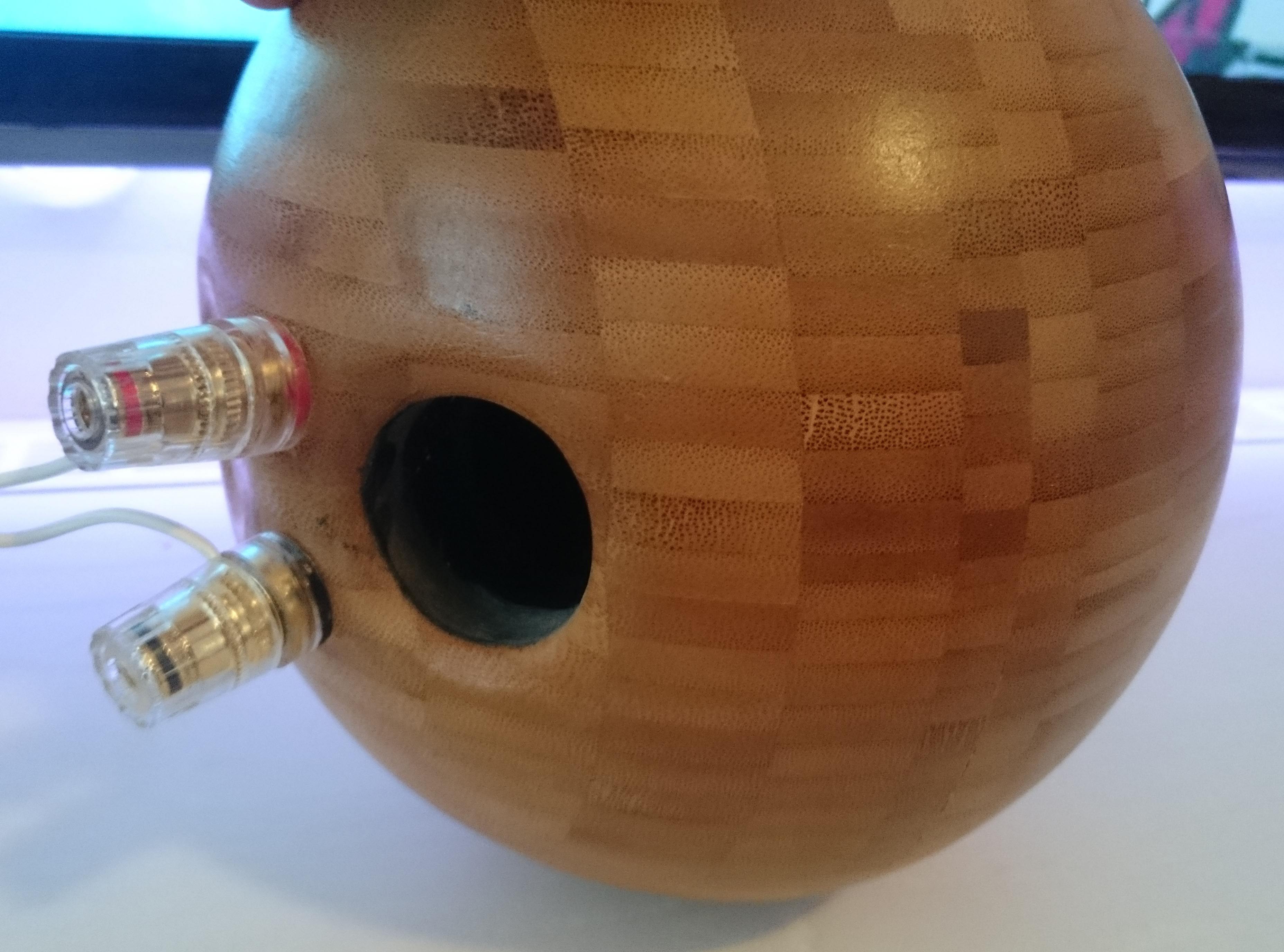

I want to stay with a closed box as much as possible, bass is not a goal here, but this may be where the problem lies. Opening with a tube might reduce inside reflexions ?

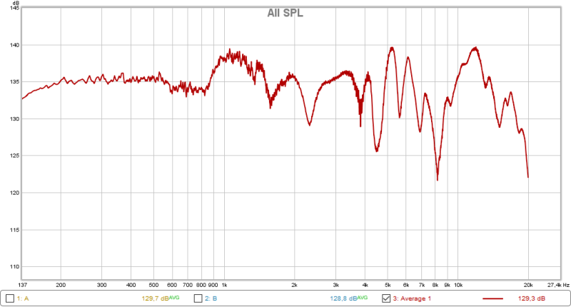

First graph is from a 5cm measure. This is where i am today. No windowing, no smoothing.

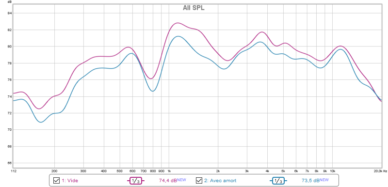

Second one is an older measure comparing between empty bowl (in purple), and stuffing with sonofil (blue).

Actually, that's not a bad measurement.
a) Any driver with a whizzer will measure something like that. They are not 'ideal' pistons.
b) A 'flat' speaker will show many ~5dB anomalies as you move the mic around a typical room.
This one at is balanced overall over the important bits (output 200-6,000Hz is roughly level).

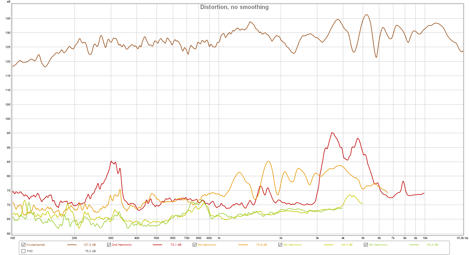

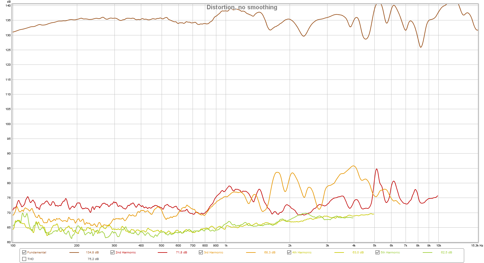

My SB34 are brand new and I tried to measure them last week. I did my measurements with the added mass method in Limp. I give you my results and it should be taken with a grain of salt because the differences made me call into question my setup.
EDIT : attached are graphs of Fostex FE166En (5cm & 50cm away) and a PDF, my pair of SB Acoustics SB34NRX75-6.

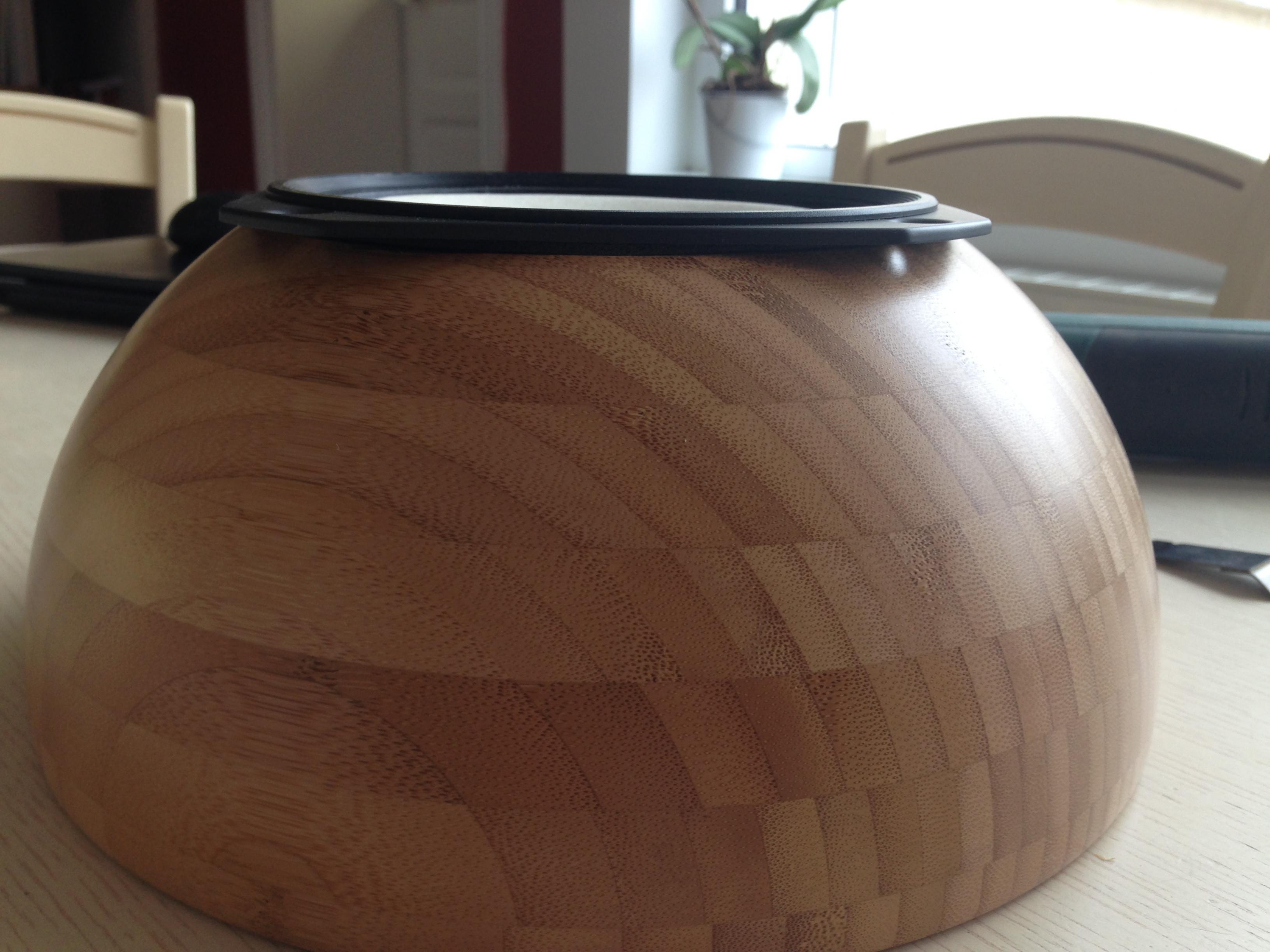

The external measurment is 28 cm, internal is 26. The bottom is a little bit flat so count on 9 liters minus all other internal stuff (speaker, filters, etc.).
For the mid sized IKEA bowl, the measurments are 20/18 cm and the smallest has the measurment 12/10 cm. I have use them all.

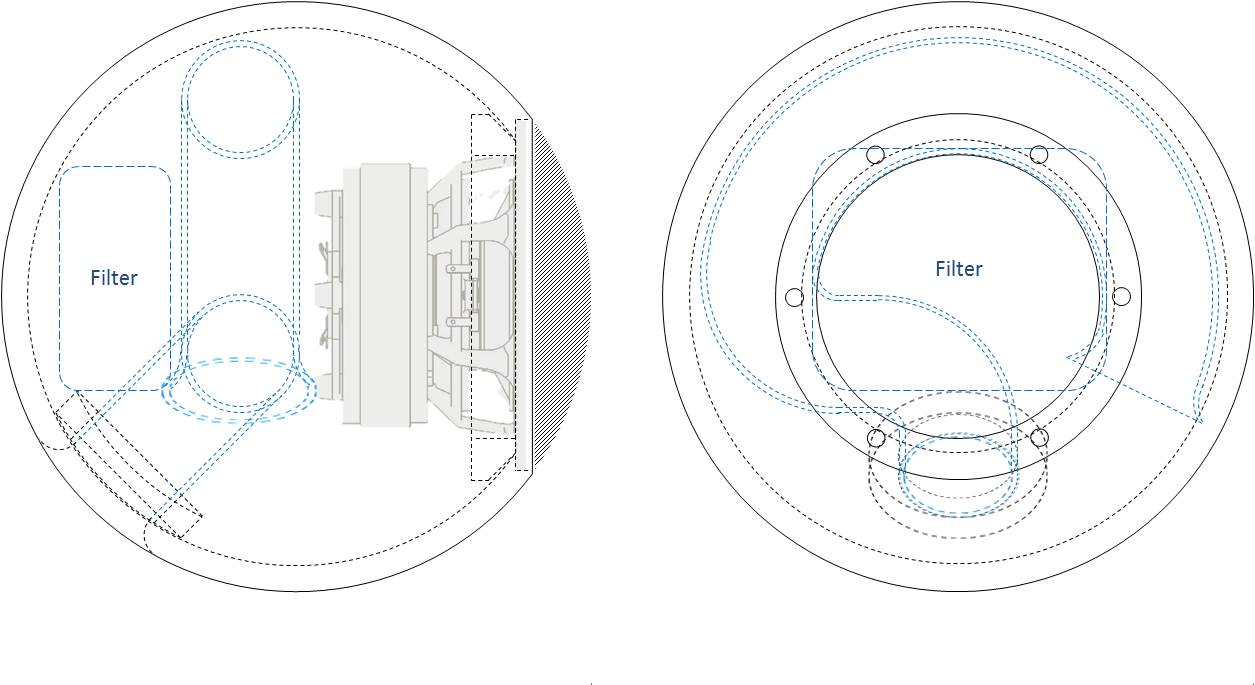

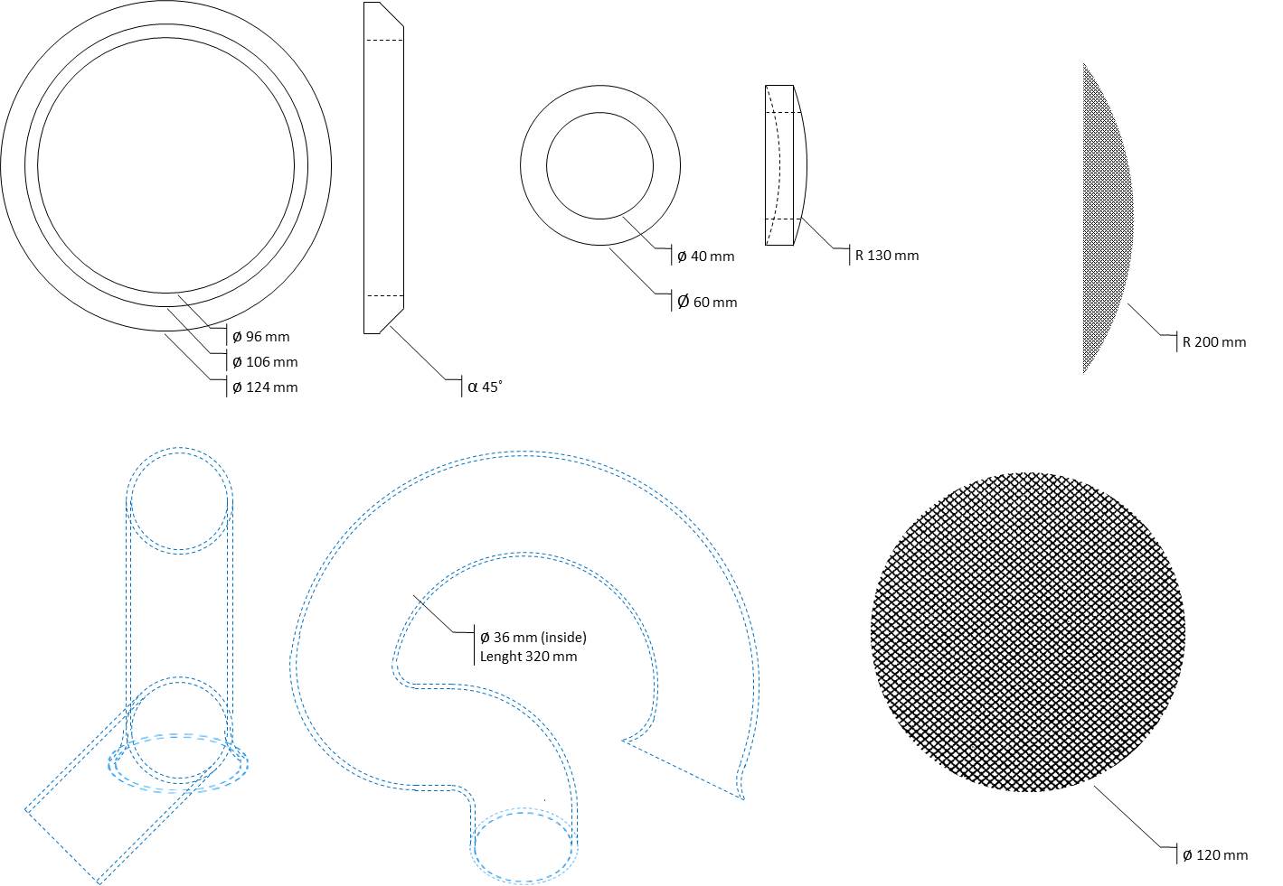

My 20 cm IKEA speaker sketch
The vented speaker doesn't leave much volume left (1,8 liters out of totally 3) but with the Seas speaker it works well but the speaker is also made for a small vented enclosure. The 28 cm bowl is not enough for the the Scan-Speak 8545 I used. The nice thing why I did it anyway is o try the sperical shape and I really enjoy how much better it sounds when the edge reflexes are decreased.
The Tang Band might work well in a vented version, might be worth a try?

I suppose you planning to flush mount the speaker into the bowl to get rid of the sharp edges. That will give you much better measurment (and sound) and that is the idea with a spheric external. I could measure (and hear) the difference on my bowls and it is worth the job.

I don't plan to flush mount the fostex. It's face is a square shape and would ask for skills i don't have. A speaker with a round shape looks way better than the fostex in a bowl. A fact already reported.
