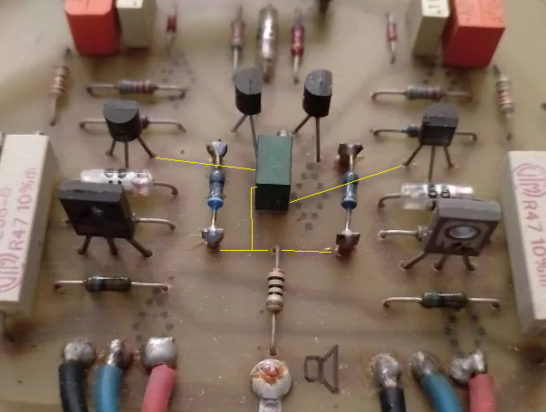

I referred to the circuit in post 67 which gives the value of R18 as 10R In farflungstars pictures this is at the bottom and in the middle of the circuit board with a black lead connected to a solder tag....
Ahhh... the plot thickens. The resistor is indeed 10R, which fits with R18. Yet it's in R17s position. (Note the shadows of the traces on the bottom of the board, highlighted in yellow in the attached image.)
Note also that Soundhappy's middle picture does indeed have both a R17 and a R18.

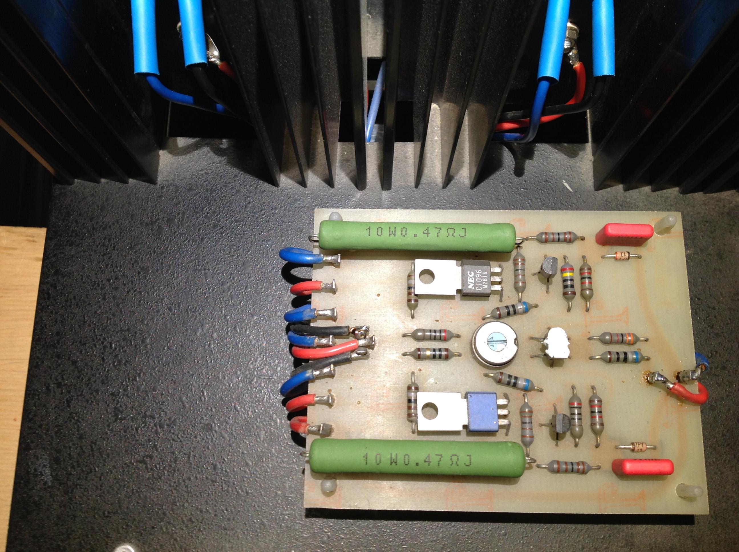

Look great YES !
....well components on the pcb's need air flow
specially source power resistors run very hot inside of very closed chassis box.
After few hours they cook inside....
:redhot:
There are no signs of overheating on the PCBs*. Cooking is good for Class A! :D
Jeff.
* Most of the ageing appears to be from a failure to clean off the flux residue on the solder joints.
Jeff.
I guess this guy don't bias them in class A or was not use this amplifier for long session in the summer season.
Put 4 power resistors with high bias for 7 hours in such "box" chassais and things can go seriously problematic.
I have original Hiraga 20 watts version in my home and yeah 0.47R is going very hot but my have lot of air around so all is safe.
Btw i change for bigger wattage source resistors and they are on the open air side not in close box. Normaly you need all voltage's and current's from the schematic values match your Hiraga amp so all OK at this point.

There are no signs of over heating on the PCBs but the two big resistors between the transformer and PCBs have scorched the the chassis so they must get very hot.
Yes i see braun colour and with all the wood around that is not safe and hard to temperature stabilise that is very important :redhot:
