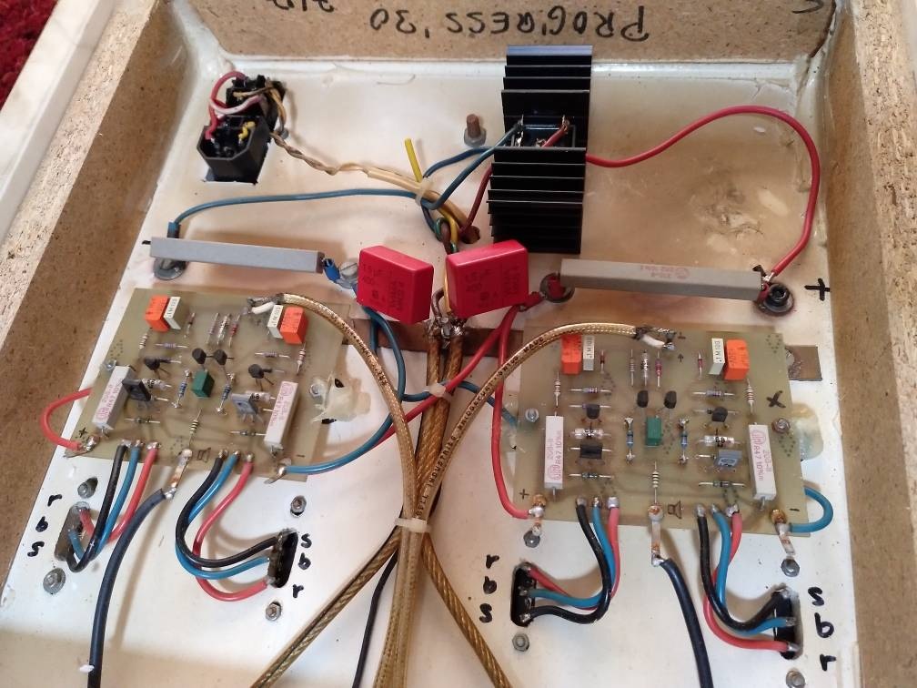

Have the 4 big electrolytics on the top been changed? Depending on amount of use, 30 years of ripple could have them in a pretty sorry state.
That being said, the Wima polyester bypass caps underneath look like current production so I can't imagine them being 30 years old. And it seems like good odds that the 'lytics were changed out at the same time the Wimas were put in....
No, Farflunger. Maybe we can see what he's got in the PSU section. Since you were talking about adding L and may more C to his power supply.Hello,

In general, the fault for poor soundstage, separation, et al is the use of a single power supply for both stereo channels. The fix is either to use two supplies or replace the existing output capacitor(s) with units having much larger values and higher voltage ratings. This can get expensive, bulky and inconvenient, unfortunately. Some example values: 2200/4700uF@60V replace with 10,000uF (or double that!) at the same or higher voltage. The overall philosophy is that caps store energy and a surge (drain) in one channel should not affect the other channel. Higher-voltage caps than the supply mean that the caps are under-stressed. Good Luck!

The caps in the original design were bigger. I mean much bigger than usual in those days.
The caps used in the amp from the original poster are probably 1000000µF 40 volts.
Changing this amp into double mono would imply a new chassis. I would go for choke input like the one i described before.
Now having a 100000µF right after the rectifier is giving the transformer and the rectifier a hard life. I could well imagine adding a 33000µF cap after that a choke and putting the two present caps in parallel would already give a nice improvement.

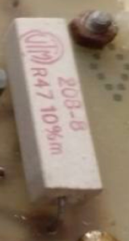

Ugrade modification can be new 0.47R source power resistors.
Big 12 watts Mills MRA12 easy to do
Mills MRA-12 Resistors
With this your sound stage , voices and acoustic instrument timbral content be nice natural.
Non-inductive version of wire wound have less Johnson noise is very quiet and sound transparent 🙂

If You use ll2733 lundahl and you have around 24 volts dc on the first cap you should have 24 divided by 100 mH ( LL2733 inductance with two coils in parallel) = 240mA bleeder current. So you should put a 100 ohm BIG resistor across the first cap that comes after the choke. Sone one in the negative and one in the positive part of the supply.
NOW people will tell you. This a class A amp there will always be a current running no need for the two 100 ohm resistor. But better be safe than sorry i would say.
OF COURSE you will need a transformer with a higher secundairy voltage. So for the same VA rating you will get less current because of the higher voltage.
But the transformer will work better with choke input so no need to worry about that.

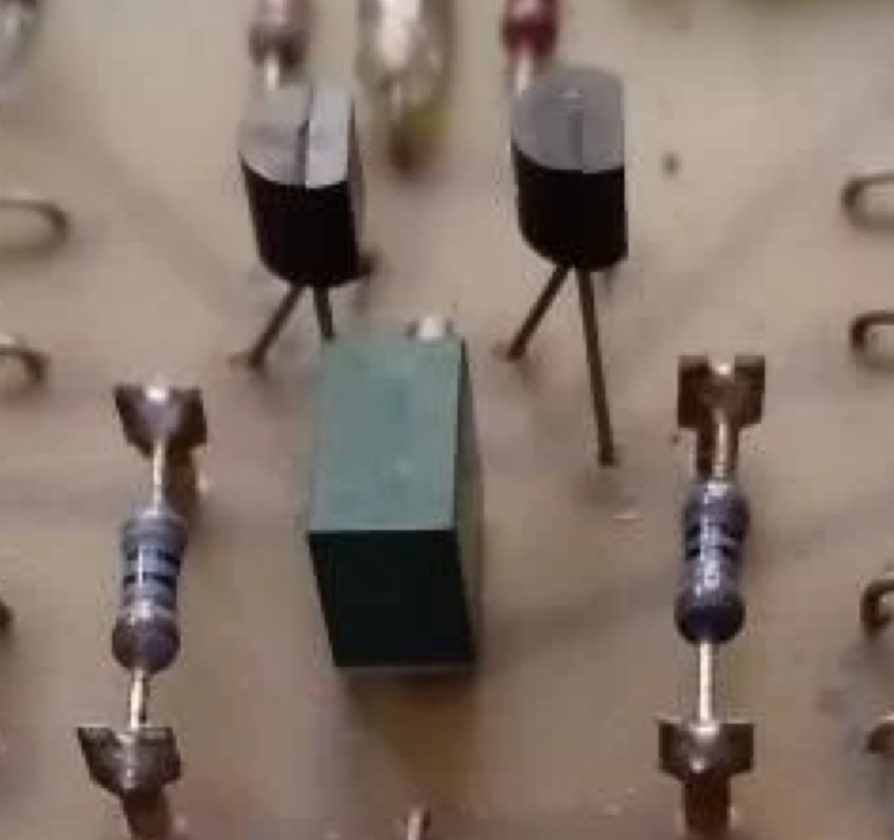

Measure your output dc voltage if its more than 1mV when fully warmed up then having a multi turn pot to adjust dc voltage would improve sound quality. And again improvment but insignificant.
Other than that I'll keep the amp original.
Currently in picture it seems like already multi tun, you can adjust to absolute zero. However becaue its very old 30 years. once you turn it may well mean the pot break down too old and amp may become damage or destructed.
http://www.ti.com/lit/ds/symlink/lm431.pdf
You can replace your orignal zener diode with a lm431. Oridanary zener diodes are very noisy.

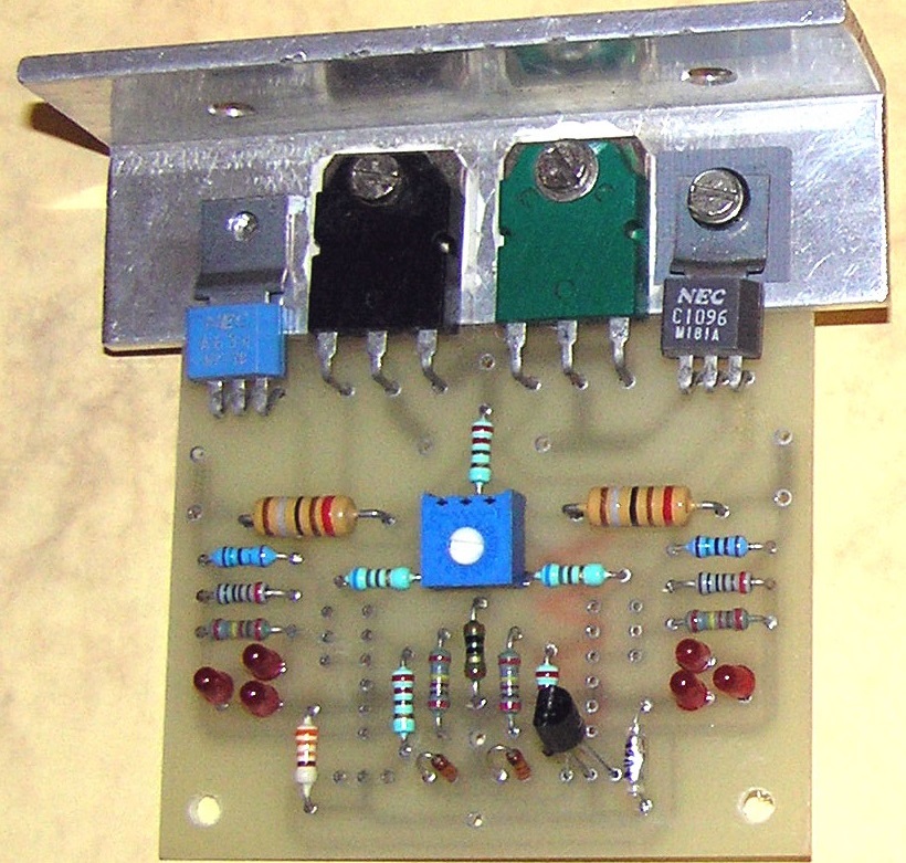

So I have a Hiraga, it's over 30 years old and may well have been an original build by Hiraga or created by another for Expolinear speakers - it's branded Expolinear and i was told was used to demo their speakers back in the day.
It sounds very very good, beating my big Cary valve amps in almost every area except soundstage. To fix this id like to try changing some components but as there are so many different schematics out there I have no idea which applies to my amp. So, if I take some pics could someone point me in the right direction?

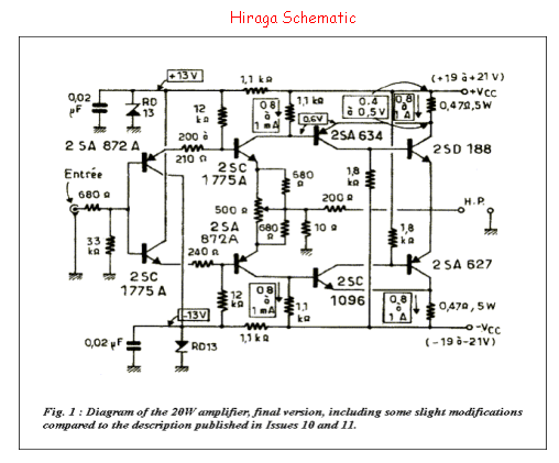

If you don't already have the schematics drawm for you amplifier, I can do it for you if you send 2 close-up pictures of the PCB - top and bottom.
I guess it will be quite close to the original Hiraga schematic like this:

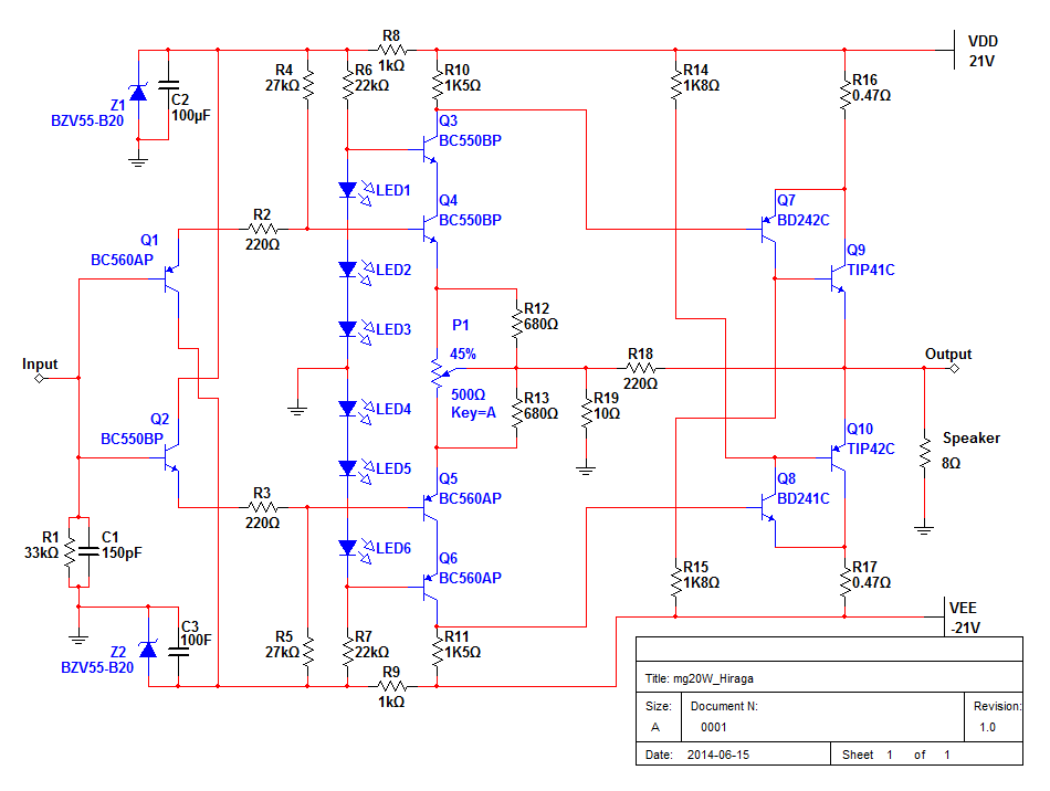

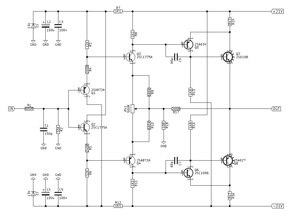

Sorry I didn't know that. Actually I thought Hiragas schematics were "public domain" by now. Since they were published in magazines all over the world...
Anyway, is there any way I can edit my post? I find no <edit> button.
Here is the schematic made for myself, since I have a couple of half finished, modified 20W class A PCBs that were based on this amp. Note that the transistors are not the ones I will use, they were available in the program I used at that time. Now I use KiCAD which is free and quite useful!
Close to the original:
The mod I wanted to try:
Simple simulation:
Layout:
So far:
Any comments?
