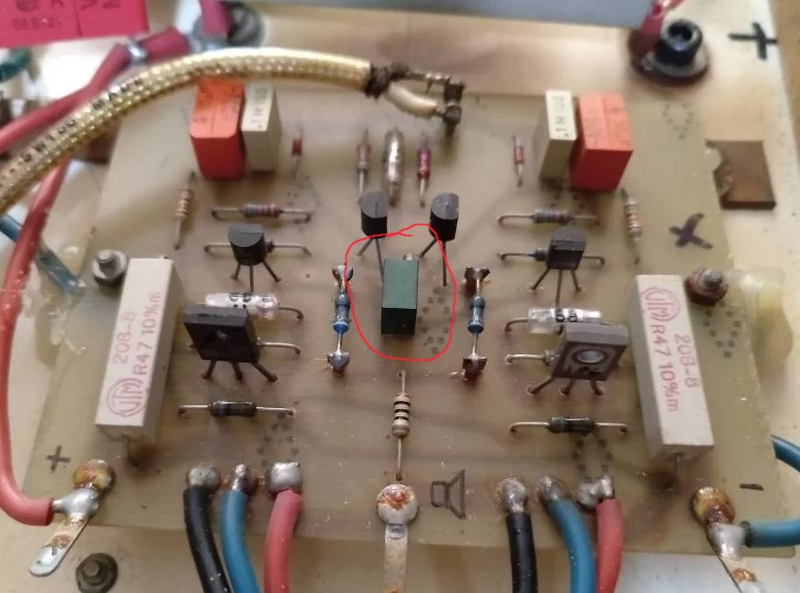

Sorry I've not posted but not had time. I have been listening to the Hiraga with my new Tannoy kensingtons and it sounds great but for some reason decided to check DC at the amps outputs. Set at 200mv I got readings of 190-199mv wth the multimeter then showing 1 so there's more than 200mv at times. Obviously I'm not happy about it. What can be the problem?
Okay I've taken some pics...
To be honest I can't see what could be changed - oh it was built in 1981 - the date is on the inside.![]()
A lot of good work can be undone if the solder joins are not properly made.
I can see a lot of joins where solder has been used to "glue" fairly serious gauge cable - possibly rated at 10 amperes or more to various connection points. You need a more reliable connection than this - if the power transistors can be soldered directly to the board you will be better off.
Next best option would be to use a cable that fits through the small hole of the solder tags which will be easier to solder. The join needs to be mechanically sound.

I've adjusted then to read 40m - but this has meant turning them 3 quarters - that's a lot of drift - sure they weren't so high fur a reason?
There may be other reasons for the offset ... like ageing componets og solder joints. Read mjona's comments.
If the amp doesn't become unreasonably warm and sounds good, I wouldn't worry.
Does the offset drift after warming up? Hopefully closer to zero? If not, try adjusting a little more, like within +/- 10-20 mV
The problem is the pots are so loose (the screw) that just moving it changes values. I had them both at 40mv after ten mins warm (they don't go down with warm up they reach a steady figure). Even a slight over adjustment takes them into a - figure, ex -21 on the multimeter.
I give up - I don't understand. I get them both to around 45mv - switch off the amp, try again - 120mv - there's no consistency. They were actually both running at around 300mv before I started messing. WTF do I do?
Are you turning both pots at the same time? You want to adjust one to take up half the offset, and then adjust the other one (often in the opposite direction) to take up the other half. You may need to go back and forth a couple of times.
Those look to be 25-turn pots, so 3/4 of a turn is very little.

Disregard my adjust-half-way-comment. I just looked at the picture again and realised there's only one pot per channel, not two.
That's some pretty flaky results then. Damage to the pot resistive tracks, perhaps? (Are they both really squirrelly?) It might be instructive to desolder one of them and put it on a multimeter and see if you get smooth resistance changes when rotating the screw.
