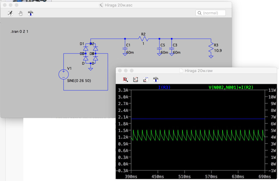

Ooops, I messed up the math slightly in my first post. It's actually two rails, with each of them feeding both channels. Still 2*2*1, but I forgot to double it for two rails.
So total PSU pi filter dissipation is 3 to 8 watts; total under the marble top is about 5 to 11 watts.

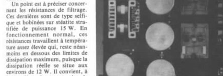

Hiraga write in this article 12 watts for 1R is real dissipation value so we use 15watts higher rated.
It's not my opinions . Dissipation réelle = real dissipation around ~ 12 watts.

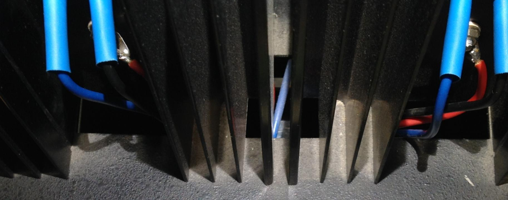

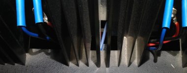

You don't see under the heat sinks are open space so air flow make natural convection of the power transistors stage.
Excellent Hiraga amp construction example.

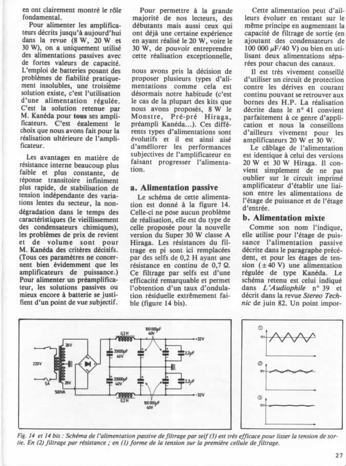

He has been told to replace the resistors in the power supply with a Lundahl LL2733 choke. Two coils in parallel will create a nice 100mH 0,85 ohm choke. That will be a nice return on investment.

Hiraga write in this article 12 watts for 1R is real dissipation value so we use 15watts higher rated....
He does indeed say that*. Not sure where he's getting it from. See attached LTSpice output. (I gave it pretty much the worst case scenario and it came out with about 4 watts per resistor.)

* Link to translated article: The Class-A Amplifier Site - Hiraga 20W Class-A

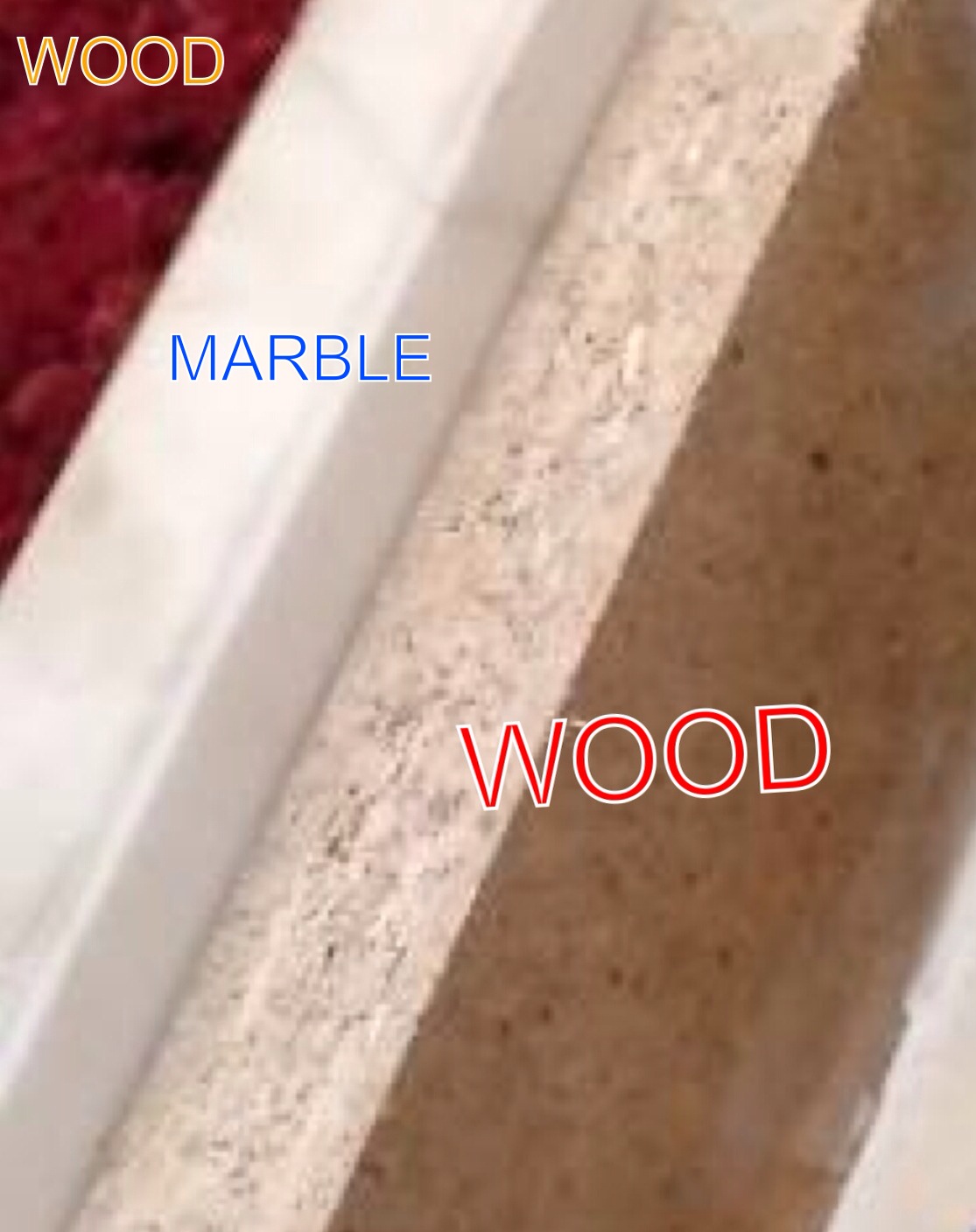

Diy version is made with composite wood, marble and 4 similar to Hiraga amp size heat sink.
Original are all metal, heat sinks get a square opening (see on the photo ) for air flow, huge 15 watt resistors who run hot,
5 watt source resistors who run hot (actually 10W) .
I can put my hand for 5 second but in July is like 3s...
Conclusion :
change or heavy modify chassis to more heavy aluminium version for example.
Wood can be for the MC Step-Up and crossovers.

I think i told him to use a smaller cap for each side + and _ put that one on the inside CLOSE to the rectifier then the choke and then the two final caps in parallel.
The first cap could be something like a Mundorf 33000µF 40 volt which is 35*60 mm. The original Hiraga did use 68000µF for the first cap but the higher this value the more the rectifier/transformer gets stressed and kind of '' radiates '' garbage.

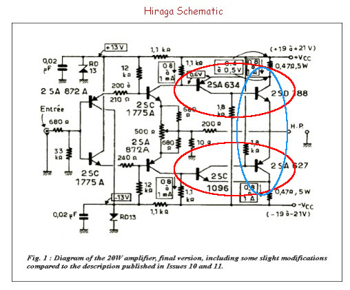

The way I look at this e.g. is if the temperature of 2SA 634 is allowed to increase it will pass more collector current through the 1.8k resistor connected to the negative supply rail. Accordingly the voltage drop across the latter will increase a little - so the base voltage applied to 2SD188 base will become more negative i.e. less positive as needs be since this will be running hot judging by the standing current which needs to be kept in check.
If 2SA 634 is located remotely inside the chassis it will take some time for the heat to get there as it eventually will. I don't see much ventilation to help reduce the build up of heat when it does.
There could be a phase when the 2SD188 is getting too hot for a period during warm up putting extra stress on such as wire-wound resistors in the process.

The dc offset is influenced by the gain characteristic of the complementary stages for each set in series from input to output. I looked at the English translation of the Hiraga article which covers this point and how to solder the Litz wire properly.
If you have a cold solder joint anywhere the fact that the complementary pairs have been matched for gain is no guarantee you will be able to reduce the dc offset to a satisfactory level.
Even if the natural dc offset - due to matching characteristics of the complementary transistors is low - that amount will be amplified by the negative feedback process.
Such an unwanted outcome might have been avoided by including a capacitor in series with the 100R resistor in the feedback decoupling arm to earth.
It appears in your case the dc difficulty has been overcome by removing the earth decoupling arm of the feedback network - if so this turns the circuit into a unity gain buffer.
From the Hiraga article the minimum recommended closed loop gain is about 150/100 plus 1.
This will increase the bandwidth a little without causing stability problems. Converting the amplifier to unity gain is taking that a risky step further.
If the heat -sinks get hotter while you are trying to adjust the dc offset it seems the stability is somewhat marginal - something you should investigate further.
