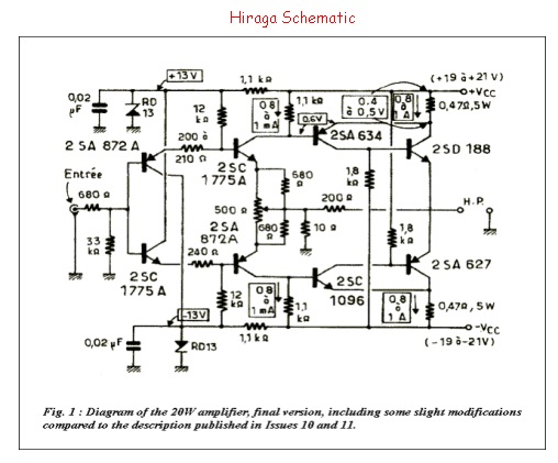

Idiot seeks help with Hiraga
~ 0 mV offset is not possible but no big deal because this is one amp with moderate 15 dB of feedback write Mr Hiraga.
R3/R6 need to bee 12K for correct offset value he say.
On non original schematic is 27K...

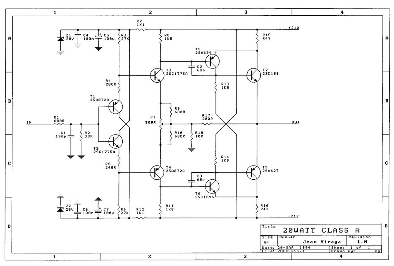

Schematic with 27K - it's original Hiraga's 20W from 1985 (L'Audiophile №34, jan. 1985).
With 12K - from 1980 (L'Audiophile №15, april 1980).
So if I can replace the pots a figure around 40mv should be okay?
Would the amp be better grounded?
40 mA is acceptable.
Always possible buy one cheap Welleman speakers protection kit module if you are very worry about Tannoys.
Make classic star ground connections. Take care about heat dissipation.
Kindest regards :)

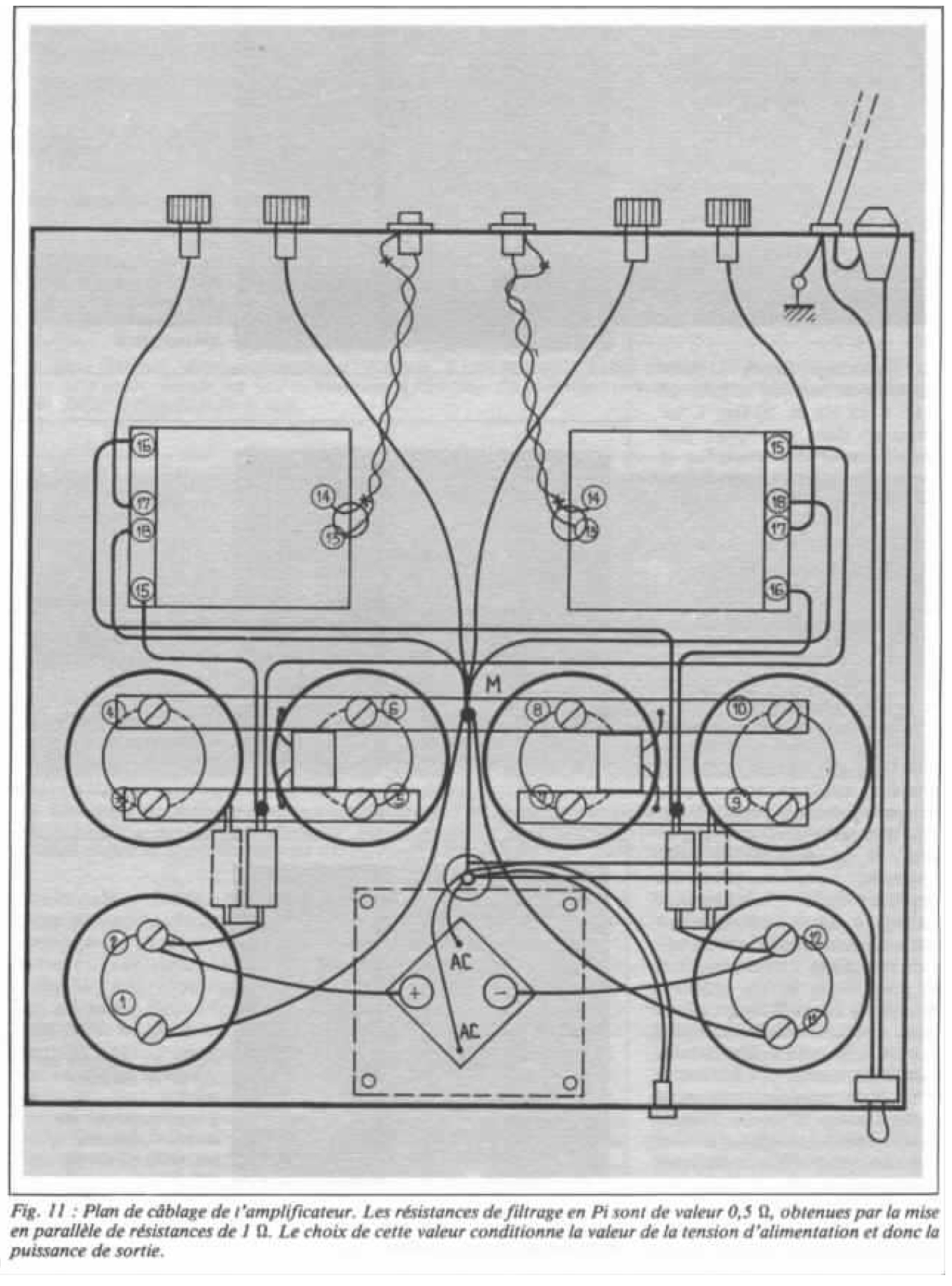

The schematic shows 0.8 to 1.0A over each 0R47 source resistor. That's 0.4 to 0.5 watts each for a total of 1.6 to 2 watts.
The PSU pi filter uses either 0R5 or 1R (according to the article; I can't see farflungstar's well enough to tell what they are). So that's another 2 to 4 watts.
Throw in a bit more for the non-output transistors (the output transistors are outside the case on heatsinks), and we've got, what, 5 to 8 watts?
Sure the resistors will get hot; sure localised heating may discolour the marble. But you couldn't even make toast inside this thing with 5 to 8 watts.

Without air flow in such closed space they can't stabilise easyly they get hotter and hotter with time.
Compare theory to the real amp in action...your amplifier.

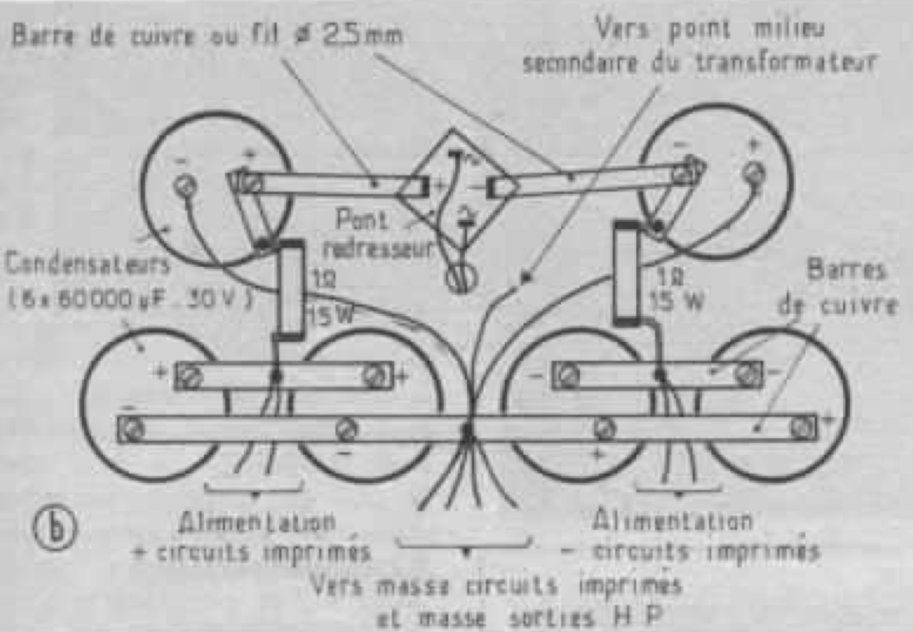

Yeah ? What we read on the psu schematic ?
It's 2x15 = 30 watts for this two resistors only
Take care :)
...your amplifier.
Hey, I like the sound of that. ;)
Take care :)
That's the resistor rating, not what it actually dissipates. Dissipation is R x I^2. (Higher rated resistors than required are sometime used because they have lower flicker noise.)
OK let's counting :)
P=IIR I=1A R=1 omh, two channels, one psu. 2*2*1=4W per res.:cold:
Ooops, I messed up the math slightly in my first post. It's actually two rails, with each of them feeding both channels. Still 2*2*1, but I forgot to double it for two rails.
So total PSU pi filter dissipation is 3 to 8 watts; total under the marble top is about 5 to 11 watts.
But still no toast. ;)
