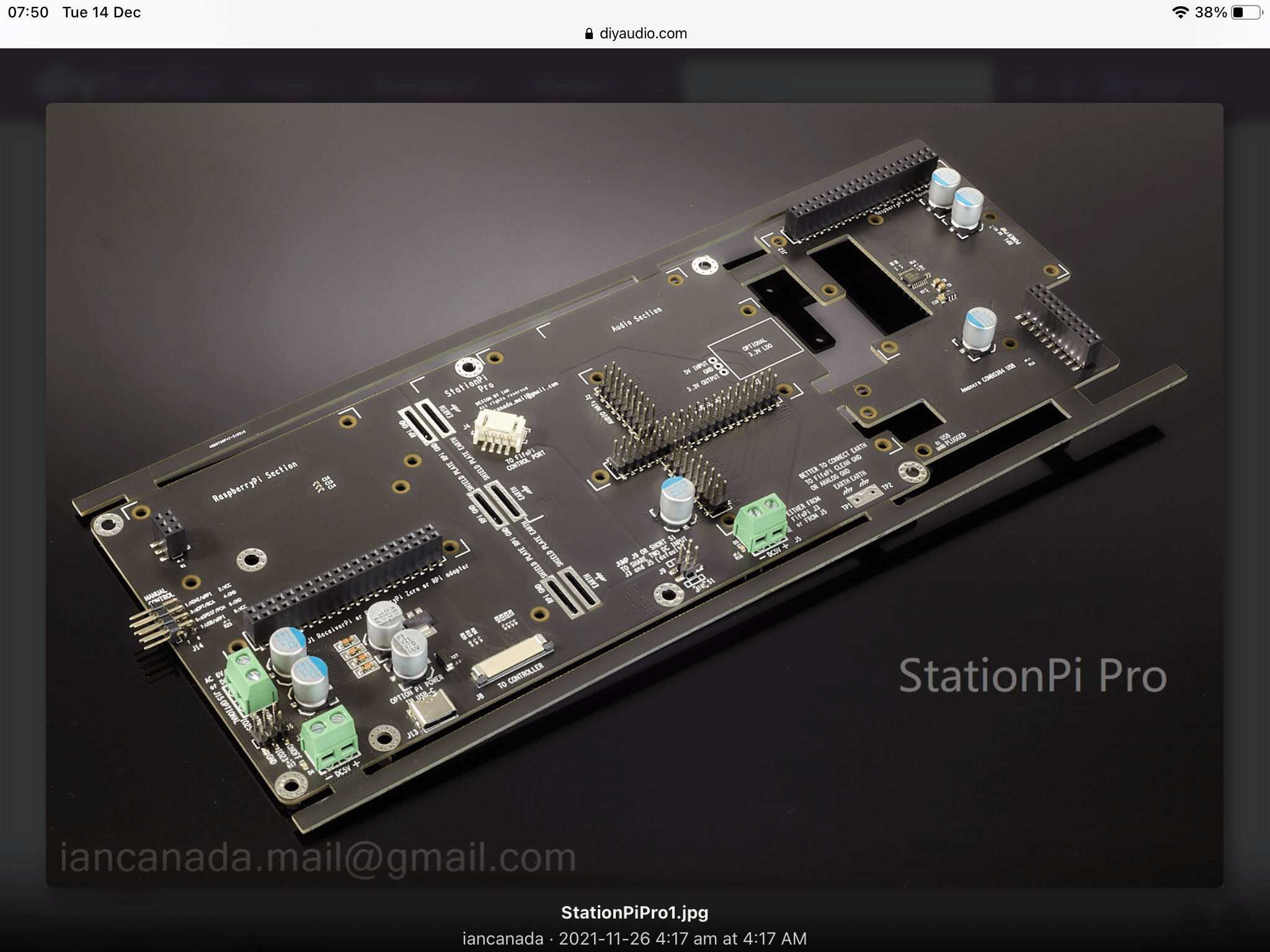

Ian, any update on when the new station pi is going to be released ? any teasing pictures ?
Fifopi has changed my listening experience! Thanks for such a great product.
A picture of stationPi pro from earlier thread. I am also eagerly awaiting release 🙂 maybe Ian will make a group buy with bundle options?

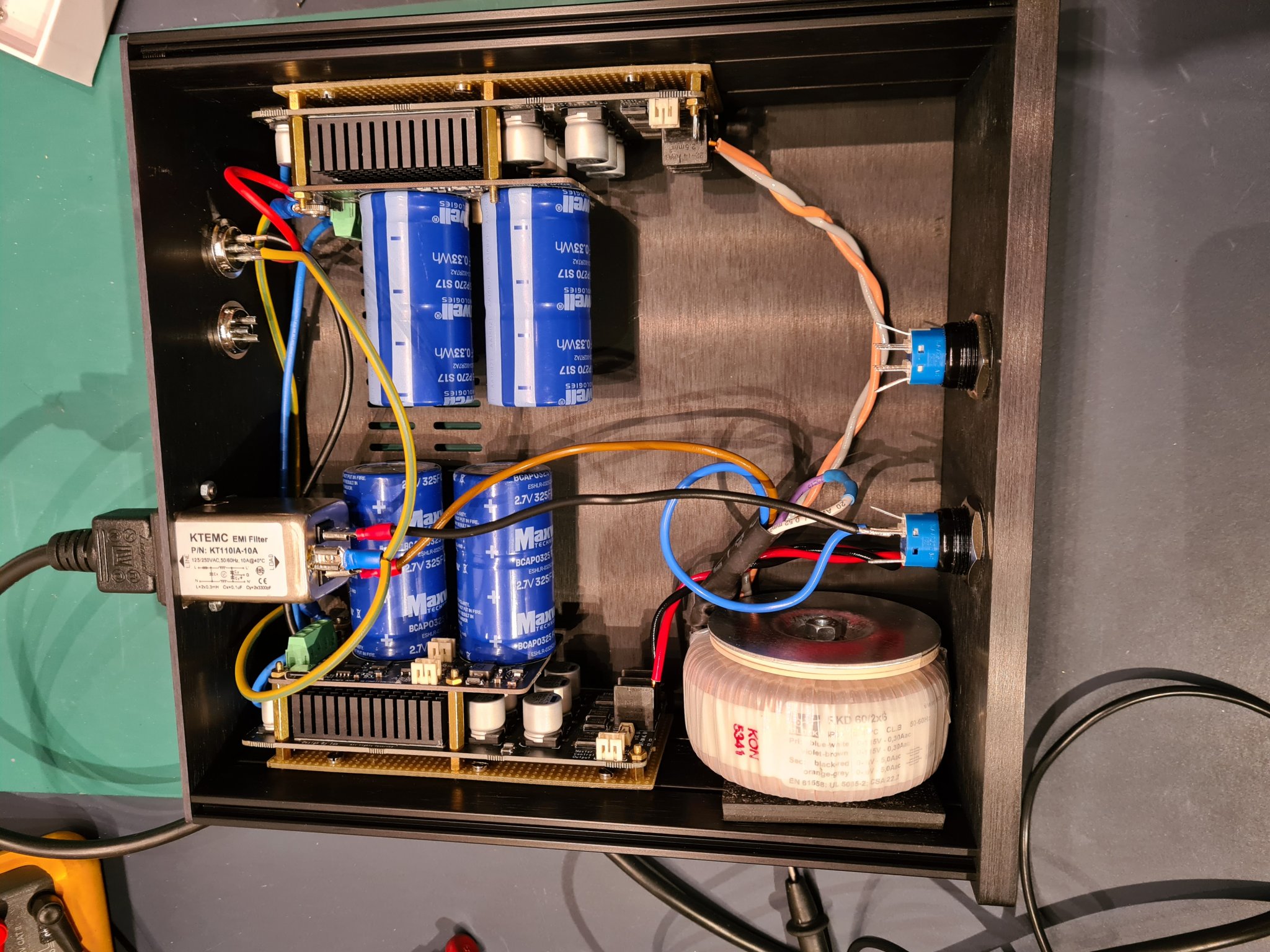

is it possible to connect two 5V UcConditioner in series on the input and the output side? To get 10V at the output and to use only one 10V power supply as a source?
I've found someone using two 5V UcConditioner in series on the output side to get 10V output, but he is using two 5V supplies at the input side. This seems to work fine. But I just want to use one 10V supply on the input side.
Thanks, Michael
Thanks, Michael
I use 2 linearpi’s connected on 2 secondary 6v windings of a transformer, on output side they are in series to put out 10v. Works perfectly.
