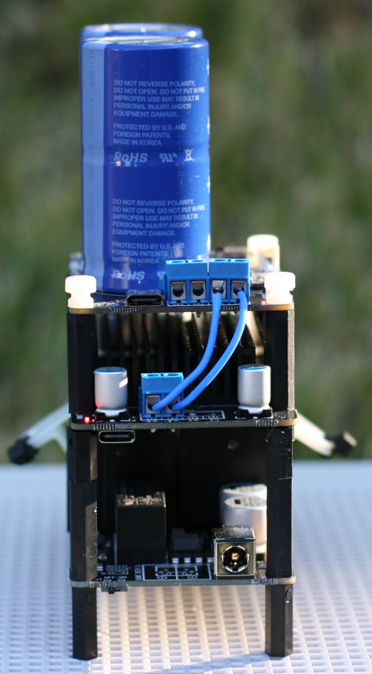

I finally found time to implement the previous + current GB. It sux when the only time to implement these projects is end of the year holidays.

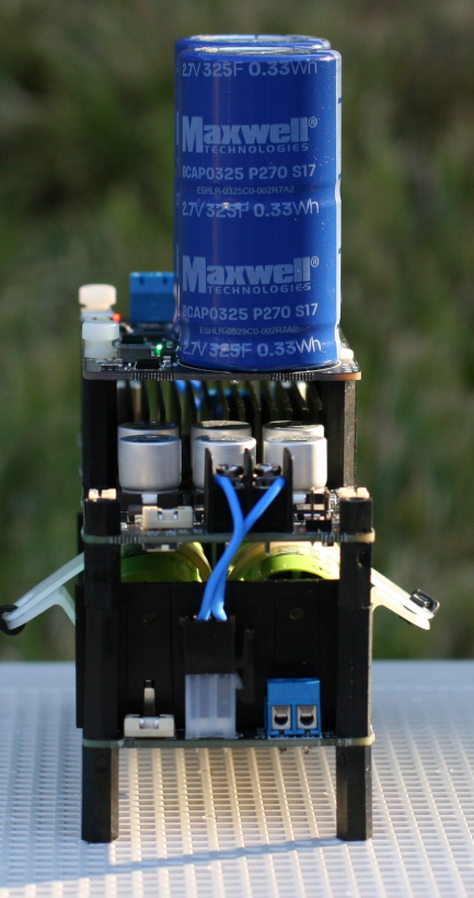

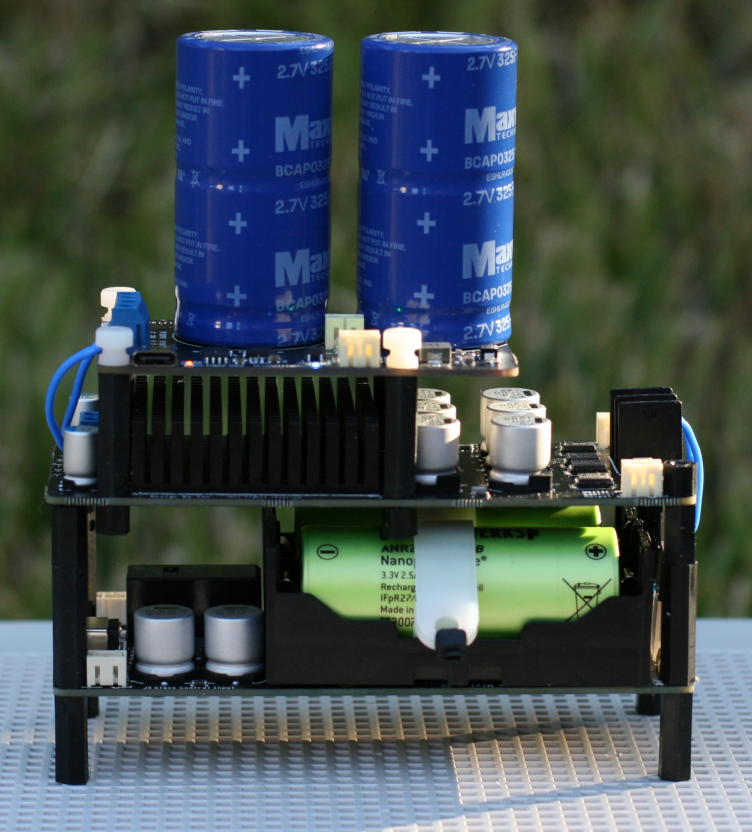

Here's an off the grid Super Cap solution that's an underrated option:
LiFePO₄ Mini 6.6V + LinearPi Solo 5V + UcConditioner 5V
I'm loving it as where else can you find a off the grid 5V Super Cap solution? My appreciation grows for your products on each implement.
In the photo attachments, you may be able to notice the lights are enabled. I didn't know being off the mains was possible and even more amazed now.
My journey has ended on this site, but I'll be back for more power supplies in the future via your gmail. I completely trust your power solutions. It's just the battery / ultra cap / protection board ecosystem I need to heavily research before welcoming into the home.

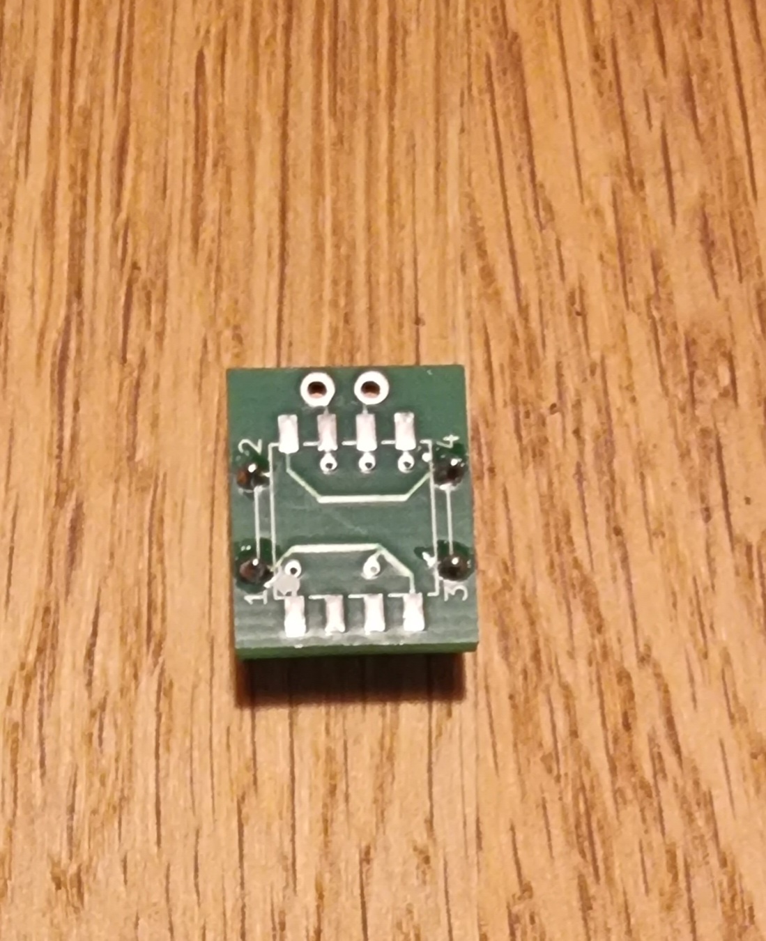

I bought this here HiEnd fever audio digital signal cattle output isolation transformer SC947-02LF | eBay. However, it was much cheaper back then.
I made a small adapter board for it.

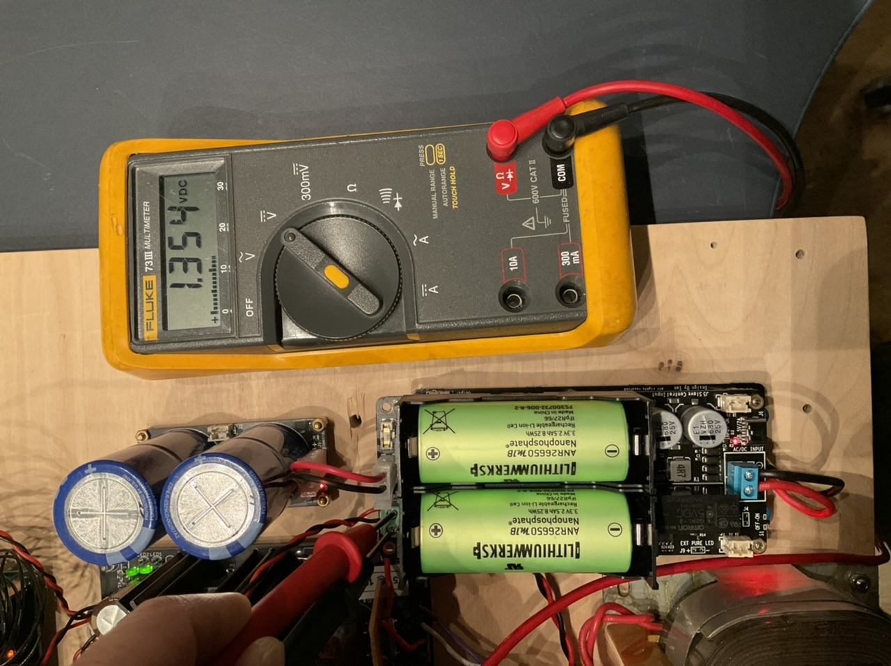

Hi Ian,
I have put 2 of the lifepo4 mini 3.3v into use. They are connected with a uchybrid to j8. It seems that the relais is broken now on both units. When in off position the output j7 still keeps 1.3v of power.
I remember having a similar problem with my battery board, you might also remember this (I still did not get around replacing the relais)
Can it be that the ultracapacitors low impedance causes arcing on the contacts of the relais causing them to malfunction?

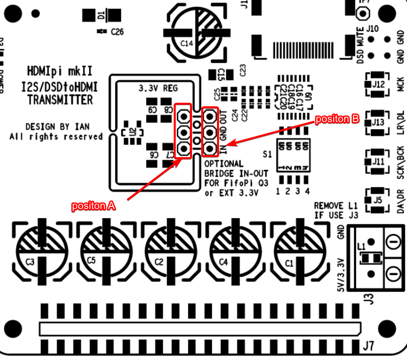

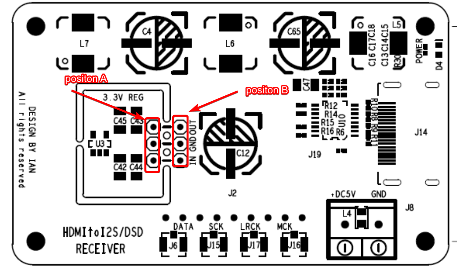

Dear Ian /Folks,
There is an inquiry on option 3.3v DC input for 'HDMiPi Transmitter' and 'HDMIPi Receiver'. Please refer to below for the details.
For the 3.3v direct-connected upgrade option- 'HDMiPi Transmitter':
1a: Which in and out should be bridged together? Since there are 'in /out' pins on the '3.3v regulator board' and ''in /out which nearby C24 position.
1b: once L1 removed and bridged the 'in /out' together. Does the last step is to connect the 3.3v DC input into the J3 terminal block?
1c: Is any conflict when directly connecting the 3.3v input into 'HDMIpi Transmitter' which stack on the 'FifoPi Q3'. In this case, the 'HDMIpi Transmitter' is stacked on the 'FifoPi Q3'.
For the 3.3v direct-connected upgrade option- 'HDMiPi Receiver':
2a: Which in and out should be bridged together? Since there are 'in /out' pins on the '3.3v regulator board' and ''in /out which nearby C12 position.
2b: once L4 removed and bridged the 'in /out' together. Does the last step is to connect the 3.3v DC input into the J8 terminal block?
Thanks.
