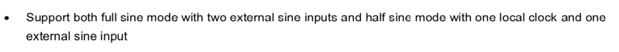

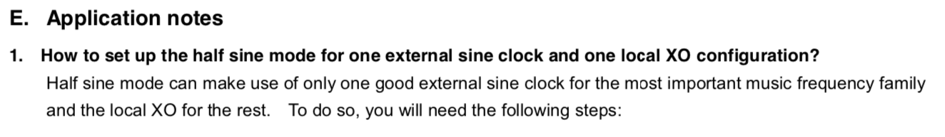

Ian could you please confirm the block signal flow of the sine pi?
Is the relay pre, post squaring circuit or both?
Does the clock active pin 1 from clock position 1 activate the relay? I am hoping to find a way to manually select between two clocks of the same time base just for testing and comparison purposes.
I am temporarily driving a twisted pear chronus which wants the 44.1 k time base in position 1 and the 48 k time base in position 2. Everything working well with just one clock connected but I wanted to verify operation before connecting second time base, also wondering where in the signal path is the resister r2 that is removed to allow one sine and one square clock? Would removing this resister result in the squared sine outputting to one position and the local clock outputting to the second position?
@stephen1212b
Relay is before the squarer. The relay is driven by Pin1 of XO2 socket. So, only one frequency is select at a time.
"Would removing this resister result in the squared sine outputting to one position and the local clock outputting to the second position?"
Yes, In this case, sine output will go to XO2 socket, XO1 socket will be the local XO.
SinePi was designed to work with FifoPi or McDualXO logic, so I can not guarantee it works for other applications.
Ian
