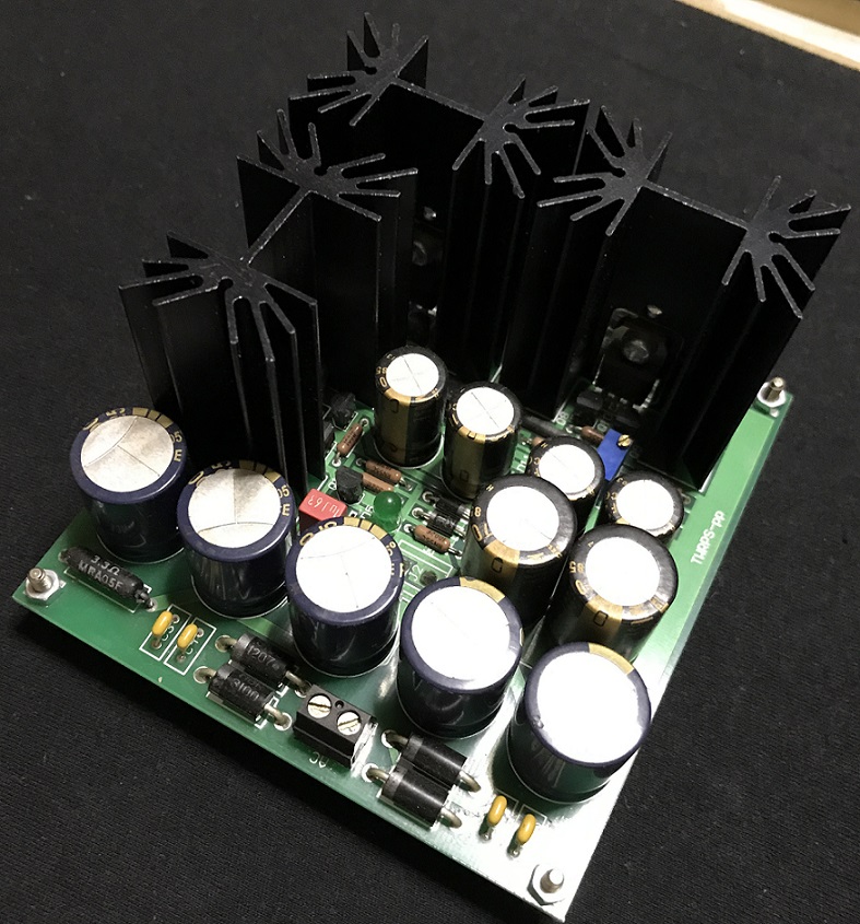

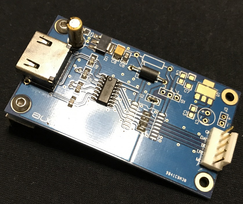

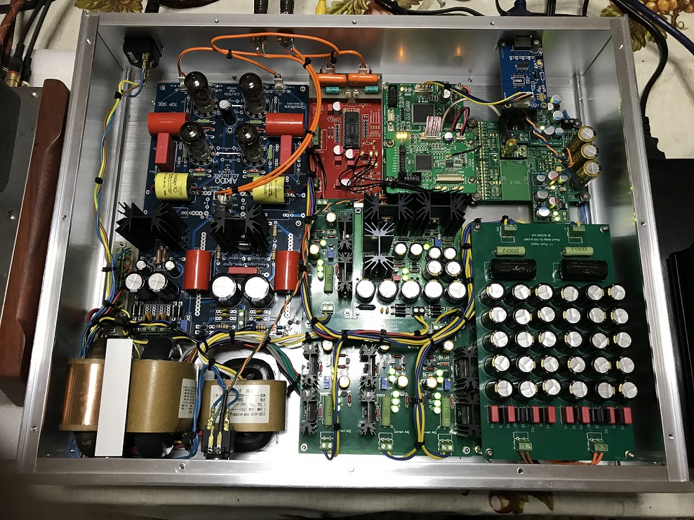

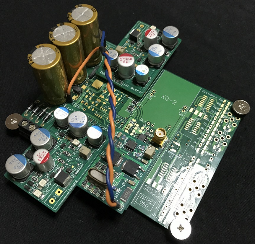

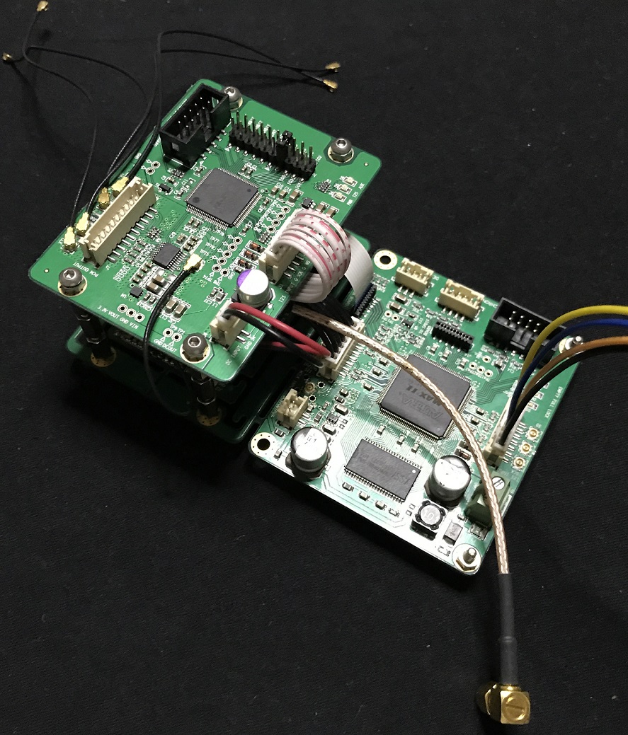

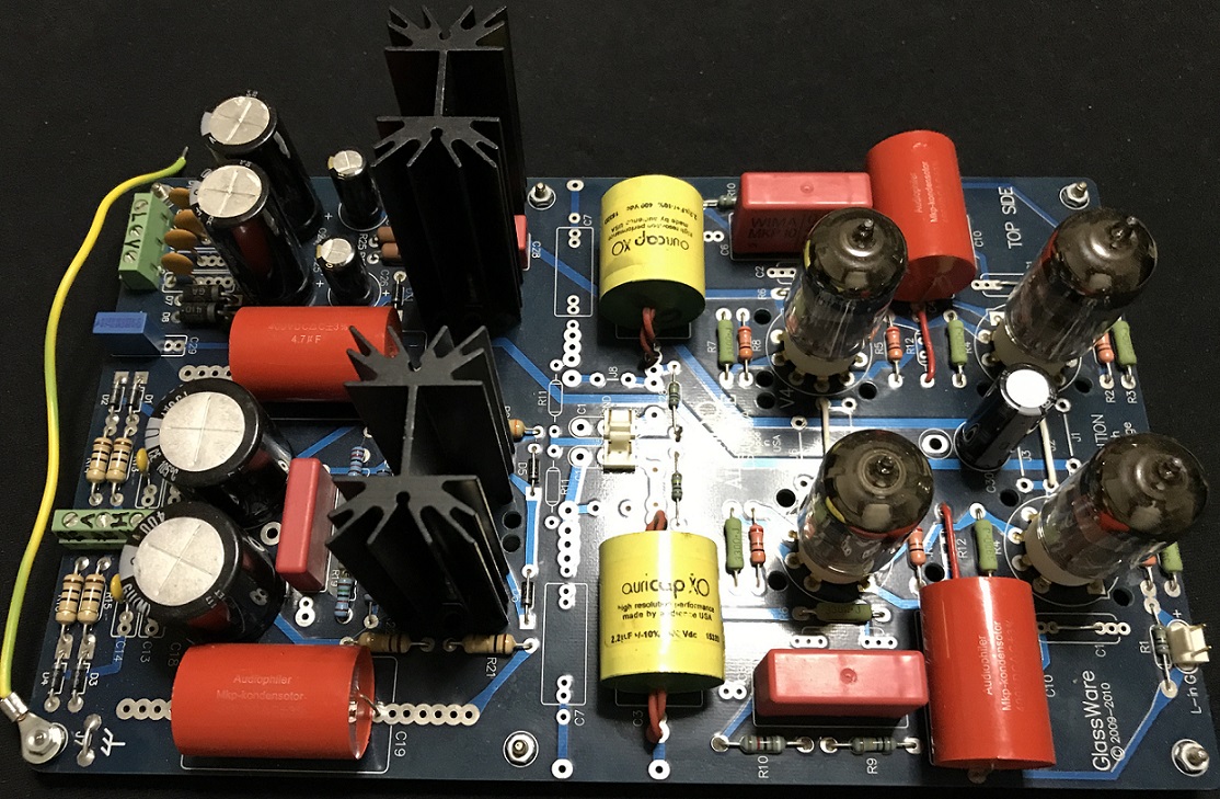

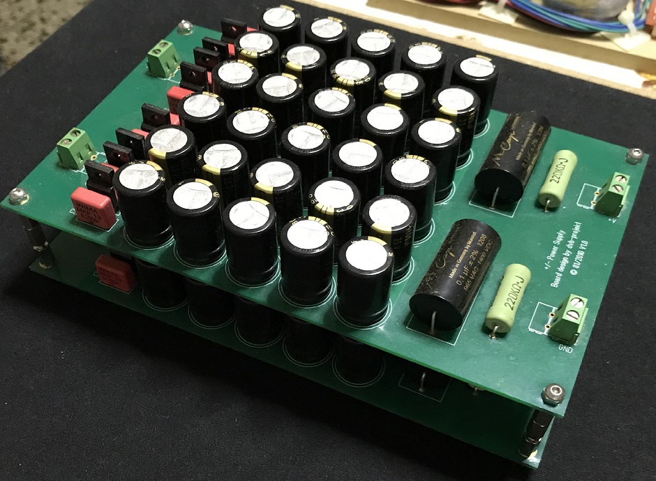

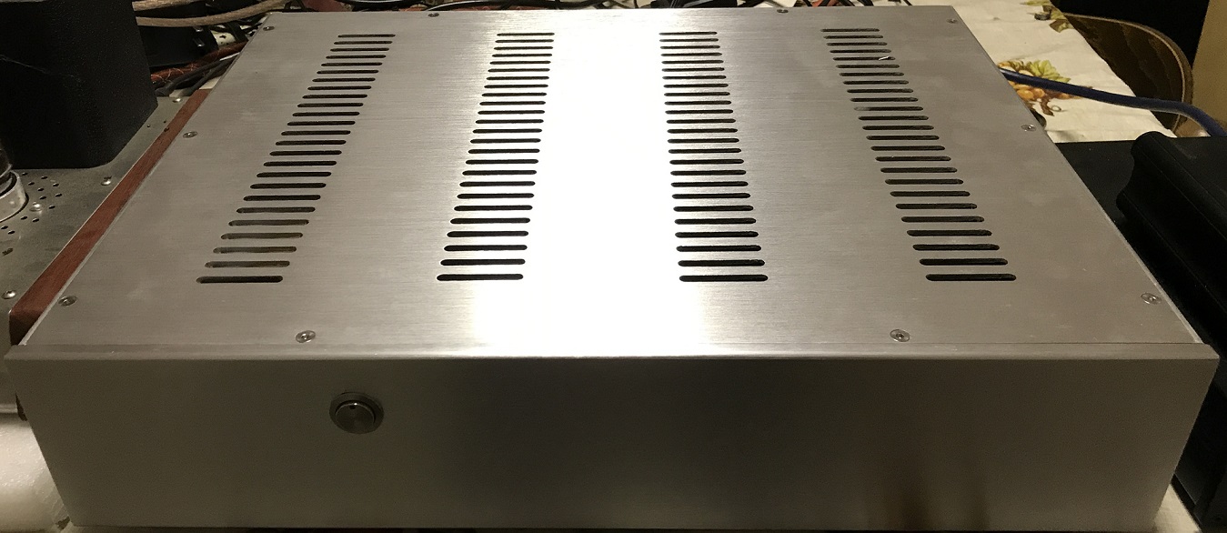

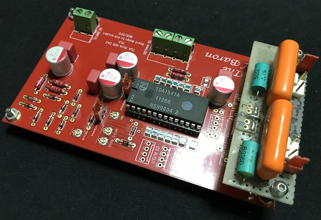

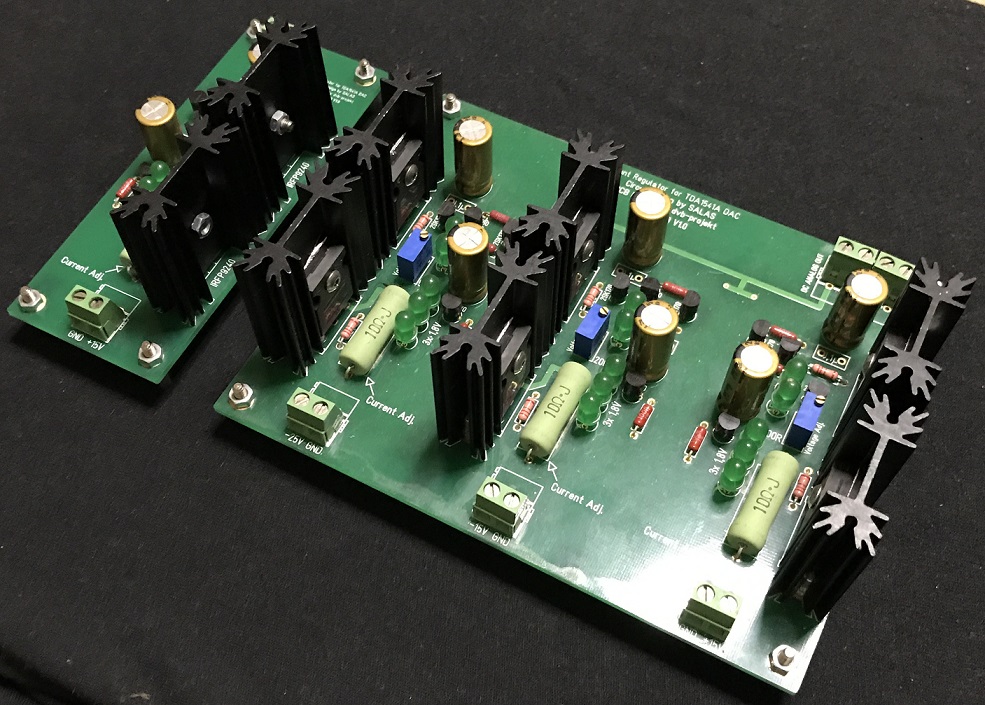

Hi Jorge,
parts and connections:
- I2S receiver to Ian's FIFO (you can also use Teleporter from Twisted Pear)
- Ian's stuff (FIFO buffer + single clock board + I2S to PCM) to Red Baron DAC with Rhopoint IV resistor (you can also use Ryanj board)
- TWRPS-pp regulator as PS for Ian's stuff (The Well Regulated Power Supply)
- Master clock for Ian's FIFO reclock (TWTMC-D, TWTMC-D&D, TWTMC-OVN, Sc-Cut crystal at 11.2896 MHz, TWRPS-pp micro regulators)
The Well Tempered Master Clock - Building a low phase noise/jitter crystal oscillator
- Salas shunt regulators as PS for Red Baron
- Red Baron to Aikido with 4 x 6N23P (you can also use your IV converter)
Hope this helps.
Do not esitate to contact me if you have any questions.
Andrea
