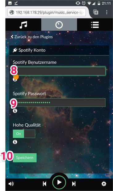

Spotify plusin does not provide settings, only the high quality can be on or off.

I have always failed to installing Spotify before. Now, just click the install button, you can complete the installation. But you have to use Spotify's premium account to login. Otherwise it will not show Spofty's options on Volumio's browse.
