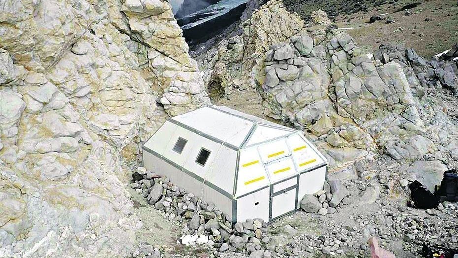

I was thinking maybe a combination of aluminum or metal and other material (like the way they built a refuge in the mountain).
You could use a sort of mesh of the speaker in metal and just fill in the panels.

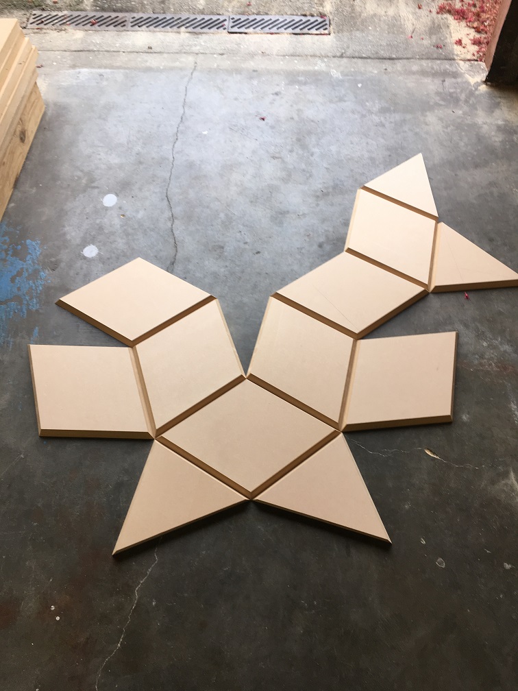

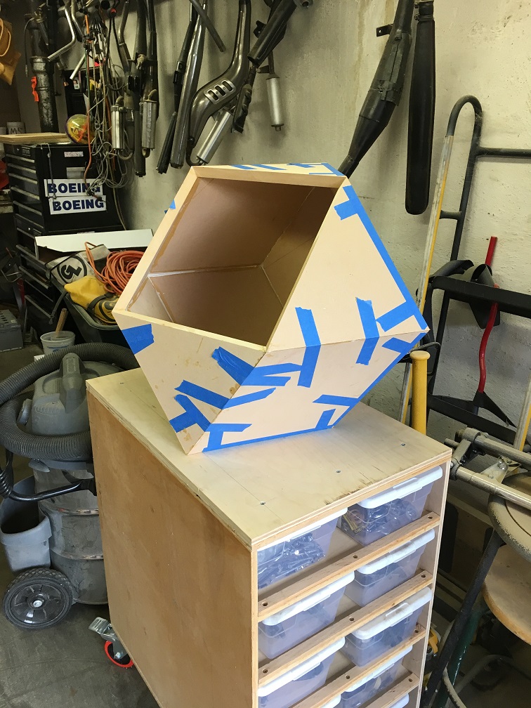

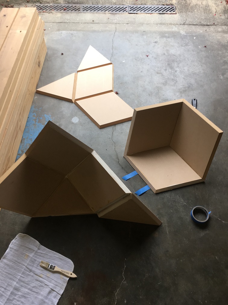

I'm building my second pair of these. The first pair used Mark Audio CHR-70A 4" drivers and we're about 13" tall/wide. This new set will use 8" Tang Band W8-1808 drivers, and be about 19" tall/wide. Calcs show that the f3 should be about 72 for the new ones vs. 84 for the first pair. This should let me use less sub woofer to fill in the lows.
I still like my first set, just wanted to see if I could get a more complete range from these. It's tough with a sealed single driver from what I'm finding.

What material are you using? Thickness? Once I get a couple pieces of the part together its stable and I just keep adding parts with glue and tape. Cant do it all at once with the 3/4 mdf, its too heavy. also I leave off the large square face so I can get in and fill the inside of the joints with more glue and fillet them later. These things have about 1/2 a sheet of mdf in each one. They arent light, but they sure will be stiff an.
