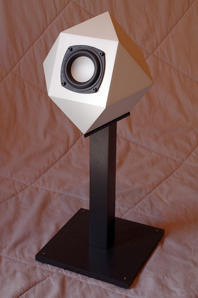

Here's a new speaker using the Aurasound NS3. I'm impressed with the very useable high excursion and nice off-axis sound.

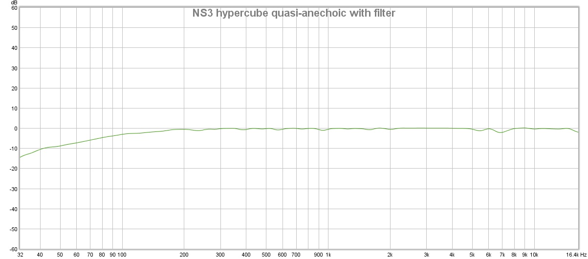

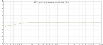

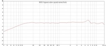

The quasi-anechoic response is derived from the merging of a 3" measurement with a 14" gated measurement at 5.5kHz. I used an EMM-6 mic calibrated by Cross-Spectrum. Mic and DAC responses are compensated for in the unfiltered response graph. The filter was made using DRC with my custom psychoacoustic configuration, as well as REW for some subsequent low-end tuning. Final response is critically damped with an Fs of 65Hz. I did some listening with the addition of baffle step compensation and it sounds very good.
Construction: 1/4" MDF bonded with super glue, inside joints sealed with wood glue, inside/outside surface sealed with oil, 3 coats of acrylic latex paint rolled on. I made gaskets for the drivers from a vinyl damping sheet, and there is a small piece of recycled packing material inside to damp the (fairly benign) high pitched structural resonance.
The stand bases have adjustable set screws for balance/leveling. I was having trouble with threaded inserts splitting the wood since the screws are near the corners, so I just tapped the (1/2") MDF itself (which allows for a tighter grip of the screw anyway). The speakers are resting on polyurethane "pucks" made from pairs of low profile flat-top (cylindrical) bumpers joined together by the adhesive sides. The grip is good enough that if the speakers are pushed from behind, the stand will tilt forward as if attached to the speakers.

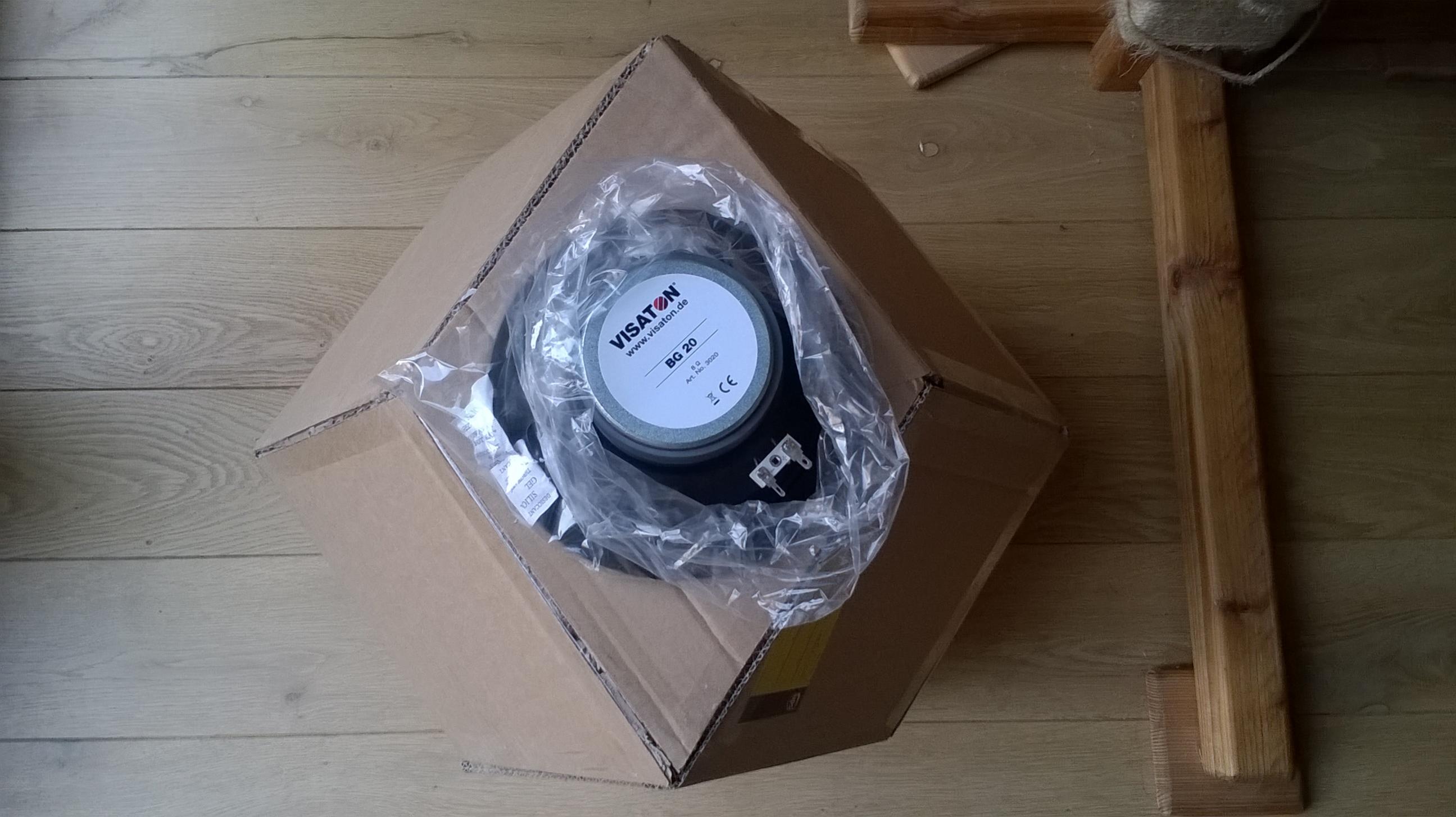

Well, I do have a relatively large rhombus where I could mount the driver against, to be precise, 12 of them. I grant you you might lose a bit of space putting the driver within them, but it is not that critical, or is it?.
I just made a 25 cm by side model in cardboard (which represents the "inner dimensions", I am attaching a picture so you can see it with the driver siting on top of it. I grant you if I were to chop off a vertex to create the square face I would be able to install an even bigger driver, but again I don't see why it is so critical.
I read carefully the explanation in which M. Kennedy explains the failure by using a lot of drivers together, so that there was not enough air-springiness, but would I be experiencing this issue if I were to use a driver that fits just inside one rhombus? As it is my 25 cm (roughly 10 inches) by side dodecaedron seems quite reasonable. By the way, it is a VISATON BG 20, quite a cheapo, and easy to get here in the old world.
