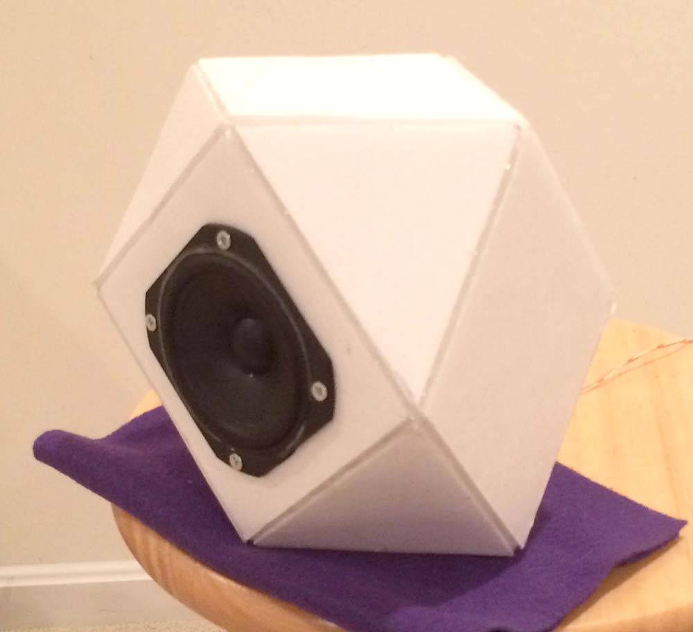

Folks may have forgotten already, but foam core makes a very nice and easy to build hypercube. The geometry is such that it is a very stiff structure despite the panels being so thin and lightweight. It sounds great and measures very well too.

It literally can be made in an hour with 1/3rd a sheet of foam core. I even made one for a 5in driver.
I even made a FAST with two hypercubes:

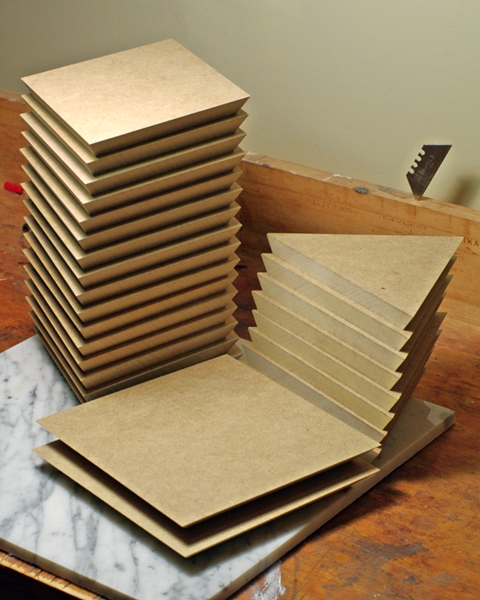

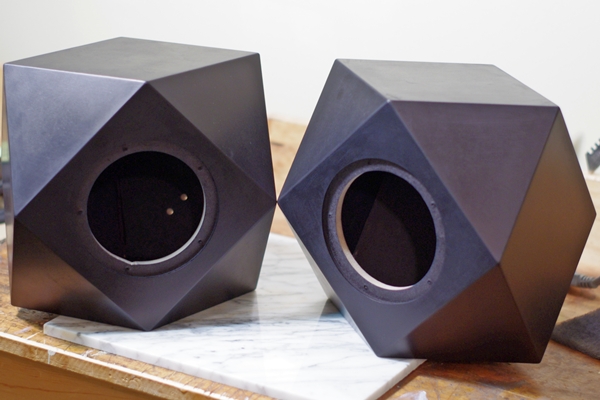

Pic 1 is of a corner of my basement which was until recently taken up by a semi-abandoned oil tank. Sports cars are probably the more usual choice for midlife crises but I already have one of those 😉. Pic 2 is of 1/2" MDF pieces I just cut for a pair of FR135EX hypercubes. After I rout out the driver hole/recess, I will install brass threaded inserts for socket cap machine screws. Pic 3 is showing verification of the accuracy of the miter cuts using a printout of a drawing of the required angles.
Would love to have one of those...
🙂 Well, considering the prices machine shops charge, I felt it was justified.

I only became part of the "because we can" club recently. My first (and currently used) pair was assembled from professionally machined pieces. I was intrigued by the shape and the claims made about the performance, and wanted to decide for myself if there was something to it. Off the top of my head, here are some reasons that these are a worthwhile build for me:
- They seem to have good dispersion characteristics; they "disappear" even when listened to from fairly close range. They also sound good from the sides and rear, although that is probably partly due to what I mention next...
- Although there is a mild structural resonance (determined by the stiffness of the panels), the enclosure tends to resonate fairly evenly over a fairly broad range, and in some ways, they sound and measure better when no stuffing is used.
- Compared to a sealed and stuffed box of identical volume and twice the panel thickness, I have measured a reduction of both harmonic distortion and non-harmonic "noise" (appearing almost as "sidebands" surrounding the fundamental).
- They look really cool 😎
Without a doubt, these are more difficult and time consuming to build than standard boxes. Whether or not the extra effort (or cost) is worthwhile is of course up to each individual.

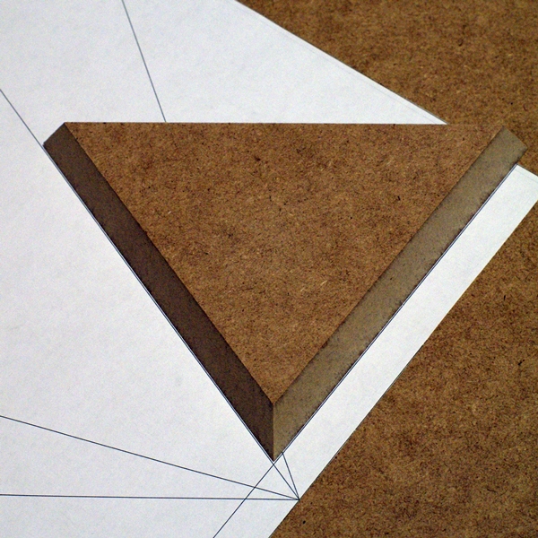

🙂 I haven't tried foamcore myself but here's how I might make the 13 pieces needed for each enclosure:
-choose an edge length (x) for the square baffle plate and cut one of these
-cut 10 rectangles with dimensions (x) X 1.414(x)**
-inscribe a rhombus in each rectangle by drawing lines connecting the midpoints of adjacent sides and cut these out
-cut two of the rhombi in half to create the four triangles
X, perhaps you have a better method. I think the possibility has been mentioned of creating a "net" and using a special v-shaped scoring tool. I guess once the RD is made we could just truncate one of the pyramids...
**alternately, and with less wasted material, you can cut a few rhombi from a strip with a width of .8165(x) by making parallel 70.53 degree cuts spaced apart by .866(x) (the edges of the strip become the edges of the rhombi).

I use similar to latter technique of long strips cut by parallel lines but don't go by angles. Instead edge lengths defined by distances. It was real simple like 1 and 1.41 or something like that.
Right on. We don't need no stinking protractors. Starting from a corner, make marks along one of the edges of the strip spaced apart by .866(x) (the edge length of the rhombus). Do the same thing along the other edge except offset by .289(x). Connecting the dots should make the proper angle.
