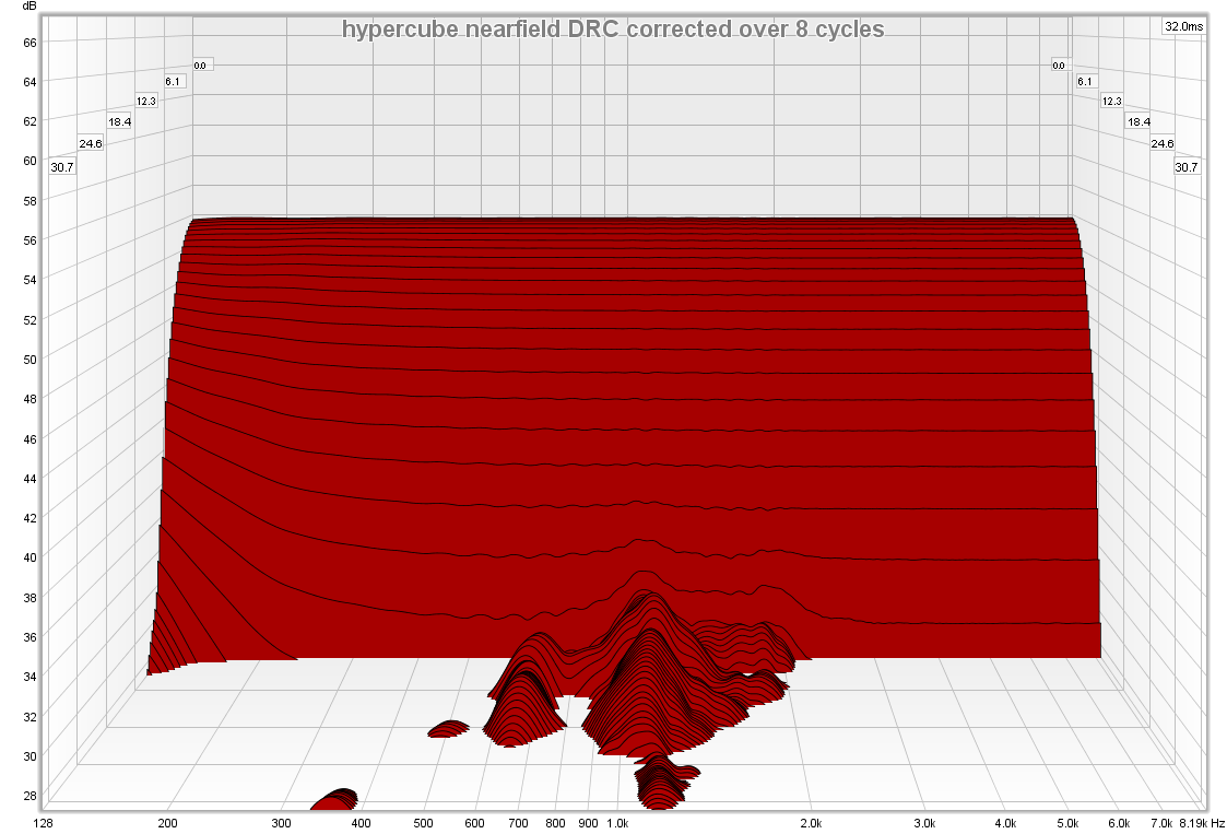

What are your waterfall plot settings? Window, Max time , steps , smoothing, etc. ?
oops, don't miss post 460 on the previous, I think we posted at the same. I think the window and rise time were both about 8ms.
ok X, same 1/3 octave smoothing but now with DRC correction and 6 octave range.
Now, where's that mug? 😉
How do you get it that clean all the way down? Are you living in a desolated area? 🙂
Agree Greg takes DRC to upper limit and think it get close to become art.
Sound clips did sound incredible too cheers and thanks sharing.

This is the stuff of dreams. I don't understand how this is achievable. What does it look like at 1/12 octave?

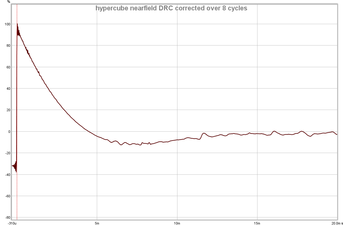

I assume you have a perfect Step Response too?

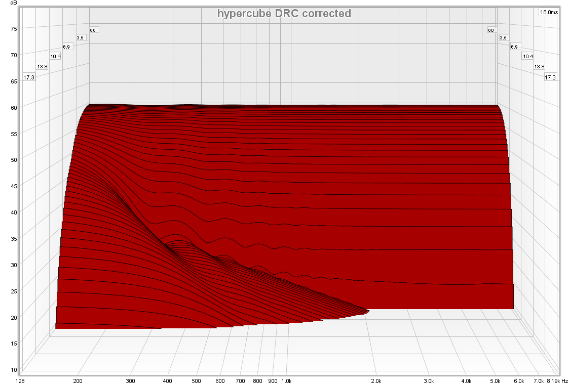

Newer nearfield measurement made with REW
As it turns out, I found a newer hypercube nearfield measurement made with REW that seems to reveal some low level ringing not present in the first measurement (made with the sweep recorder provided with DRC) and I applied DRC correction. Seems more realistic, but still quite good I'd say...
edit: I have since applied adhesive vinyl damping sheets to all interior hypercube surfaces, so I expect the next measurement to be at least slightly better...
Perhaps the noise floor was too high with the older measurements due to using too short of a sweep causing Audacity to remove too much of the "silence"....
Anyway, I think the recently shown sealed/hypercube comparison is valid because the only variable in that case was the enclosure, and the impulse responses were not shortened at all with Audacity.

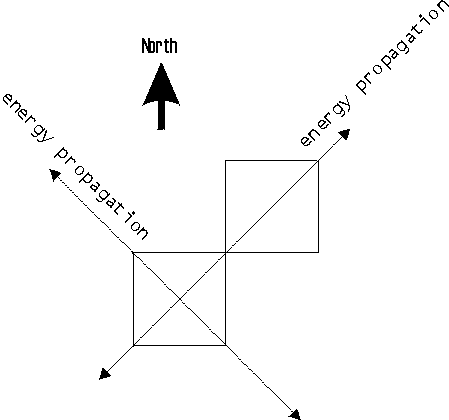

North orientation
I made a sketch showing the directionality of energy propagation according to Göring's book.
As magnetic north is in flux, it's good to use a compass instead of a map. Just make sure there is no metal near as it will deviate the needle.
Make out where the hypercube enclosure most strongly resonates along the "energy transfer lines".
As to sawing: Has anyone tried 3D printing as suggested by Derek? It might be worth trying contact drivers attached to the hypercube structure instead or complementary to speaker drivers in order to excite the energy transfer lines.
Well, this post is the real highlight of the whole nonsense about the "magical" properties of the hypercube loudspeaker enclosure.I would like to point you towards a model of reality that makes it plausible why the hypercube enclosure might work better than other types of enclosure.
