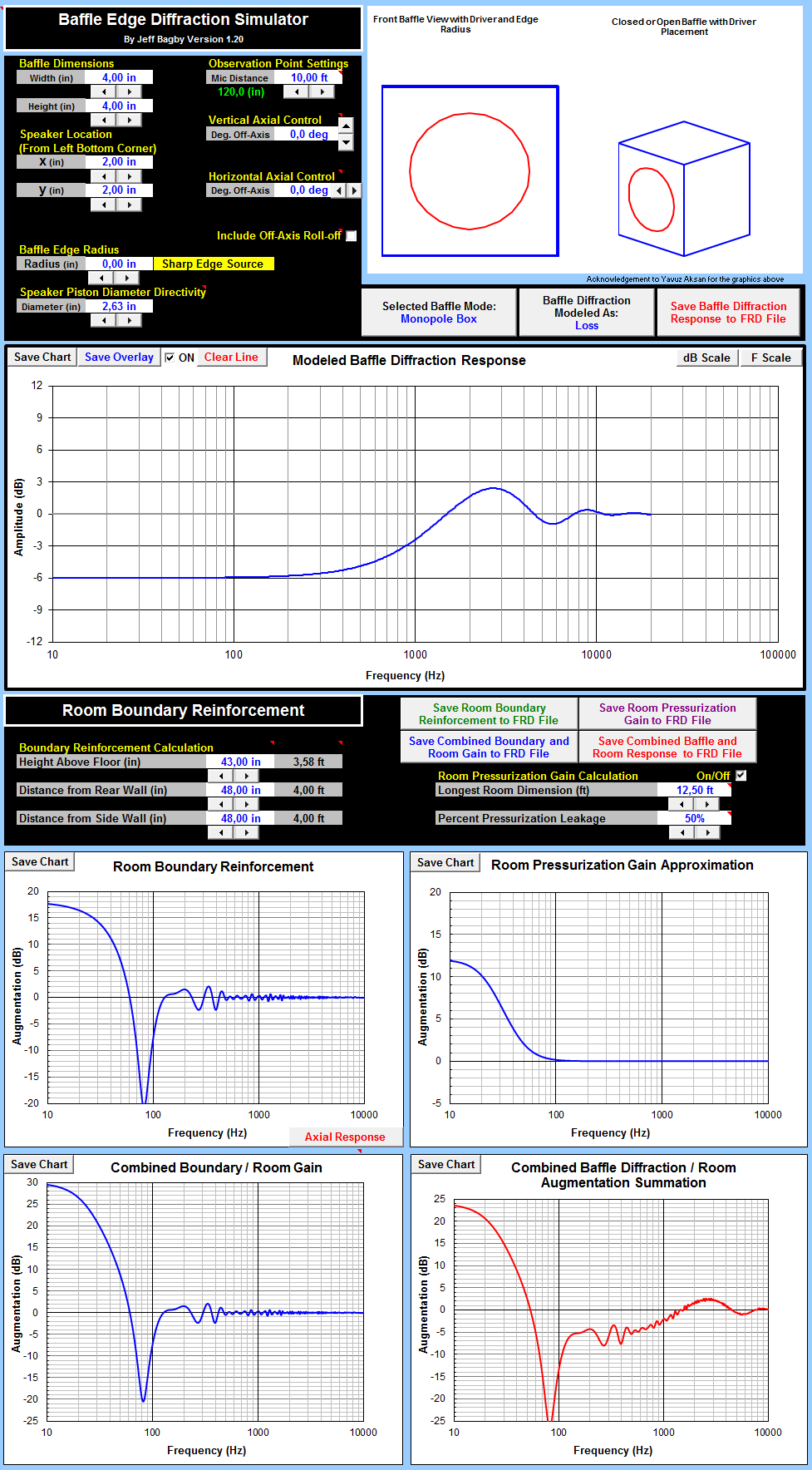

The LF dip talked about could be the three boundary distances bag wall side wall and floor nearly same. Did a plot attached in a J. Bagsby tool with estimated distances and got a suchout spike at -25dB. Tool found here here software.

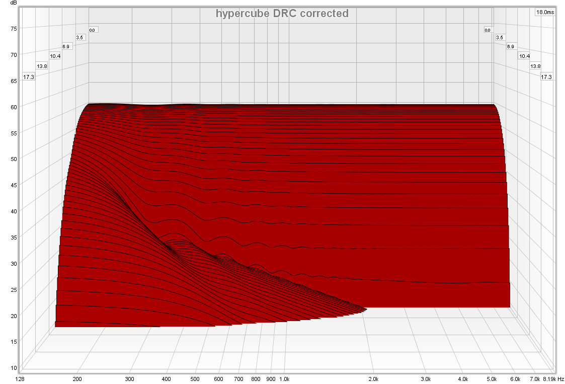

Attached are the results of my attempt to deal with the dip. Why I put so much effort into fixing something that wasn't really bothering me in the first place is probably a question we all ask ourselves from time to time 😉.
In order to (almost) eliminate the dip I needed to tell DRC to correct the signal over a bigger amplitude and frequency range as well as over a longer time period. Then, in order to prevent DRC from making my tiny speakers flat down to 32hz, I applied a Linkwitz transform type eq curve to my measured impulse response (before feeding it to DRC). The results (attached) are pretty good with excellent sound from the sweet-spot, but worse sound from elsewhere in the room. I have since reverted back to correcting over a shorter time period so what I'm listening to now is not quite as good as the attached waterfall, but sounds good all over the room and is an improvement (at least I think so right now) over what I posted previously.

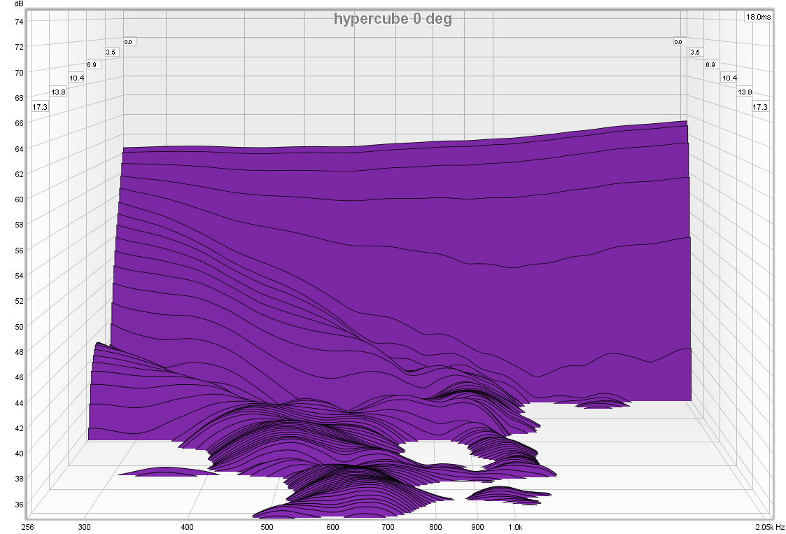

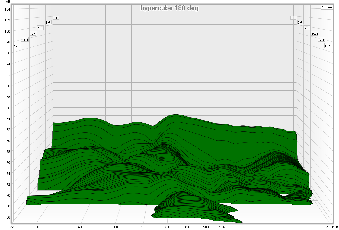

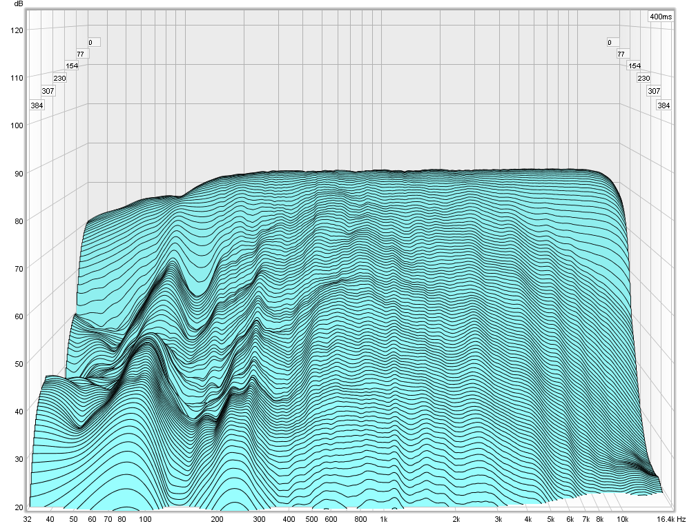

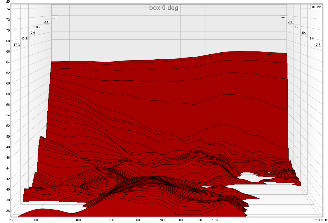

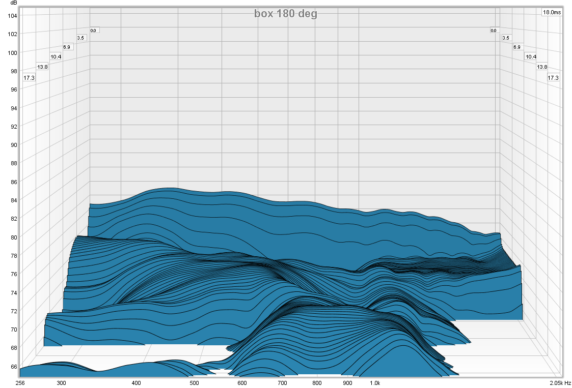

Correction
I noticed while browsing through my speaker measurement files that there was a problem with the rear (180 deg) hypercube measurement file used in post 302. REW was not displaying the files properly because there was too long of a "silence" period before the spike (I didn't use REW for the measurement). I used the silence truncation effect in Audacity to remove the excess, but for whatever reason the hypercube file got cut too short after the spike leading to a gating type effect. The hypercube enclosure allows a faster decay than the box but the difference at the rear of the enclosures is not as extreme as the previous measurement implied.
I have attached new waterfall plots here. I attached 0 degree plots as well even though similar ones have already been shown. These are all using the original raw files; they are not made from new measurements.
The box is made from 1/2" thick plywood and has 3/4" adhesive foam attached to the interior surfaces. The dimensions progress 1, 1.272, 1.618. The hypercube is made from 1/4" acrylic and has some loose-fitting open cell foam inside. I tried to give the advantage to the box.
edit: note that the freq range of these plots is only 3 octaves...

My hats off to you. DRC Magic being witnessed here. Never have I seen a waterfall plot that looks like a glistening laminar flow waterfall down a straight wall! Wow!!!
:cheers:
Well, these are not using DRC, just smoothing. However, with the help of DRC, the resulting waterfall does match your description 😉. I don't think I have shown that before though....
