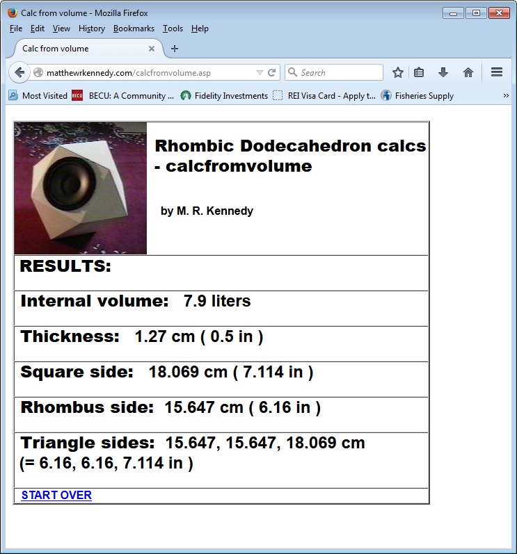

Determining the hypercube enclosure measurements based on volume can be done here:
Calc from volume

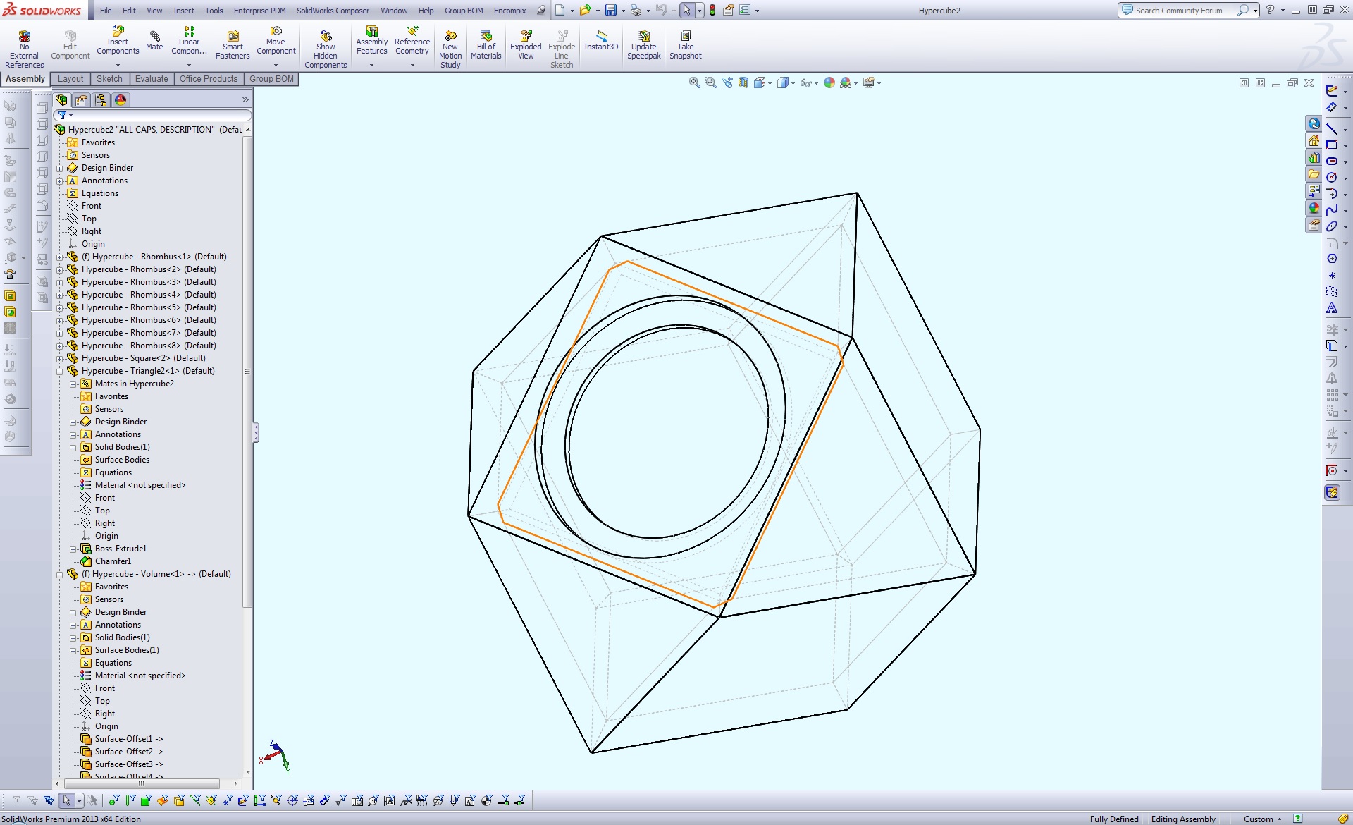

It looks like with your 4" drivers, correct internal volume with a hypercube enclosure (assuming 12mm thickness) would be realized with a square baffle side length of 7.19". I have heard you can go smaller with this shape with less ill effects, but I have no personal experience with testing that claim.
mattsmith,
A square baffle length of about 6 - 6.25" with 9mm material is probably good. You would be able to flush mount the driver and if stuffing were used, the smaller volume would be appropriate anyway.

I used the program GMAD linked to, but I wasn't sure how to get Qtc. I read that
.707 was "optimal" but changing it around slightly had quite an effect on the volume. So I'm not sure I'm doing that part right. With Qtc=.707 I got 7.9 liters for sealed volume. Which seems reasonable. And using Matthew Kennedy's calculator and using 1/2" MDF I got the dimensions in the second attachment.
I'm just going to build a set with these dimensions. Thanks everybody

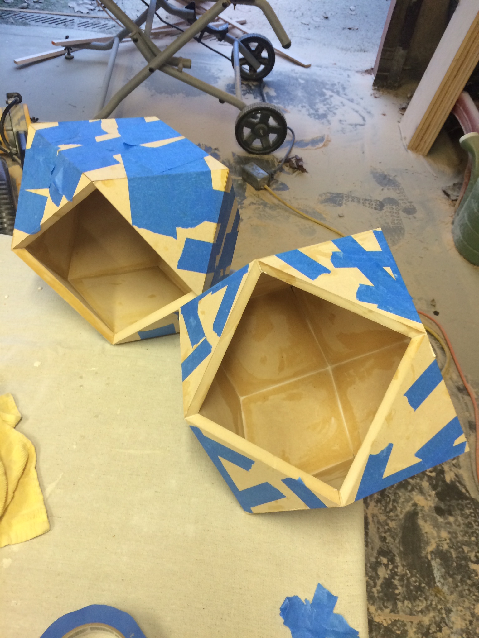

Here they are. Haven't glued the faces on yet so I can double glue the insides so they are surely air tight. The joints aren't perfect. But pretty close. A little more glue and sanding and paint and only I will know though.
Nice! Thanks for sharing. I take it you did the cutting yourself? Looks good so far. Keep us posted...
Yes, all cuts by me. Driver hole was a 4" hole saw cut. The rest of the angles aren't too bad. But I did make a lot of backwards and wrong way cuts. In the end there are only 3 different shaped pieces.
They echo pleasingly if I put my face in the open hole and hum. 🙂 Can't tell you much else yet.
The drivers are burning in as I type. I'll glue the rest up this evening and be able to mount and listen tomorrow night. Final finish to come later. I'm thinking something subtle, like orange.
