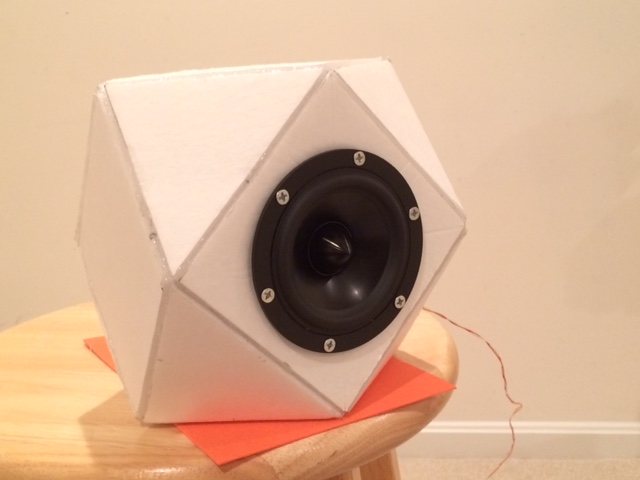

Xrk: Aaaaargh!!!
Those tubes are insulting !
( foam core either, but that's another matter ...)

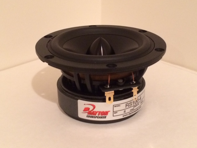

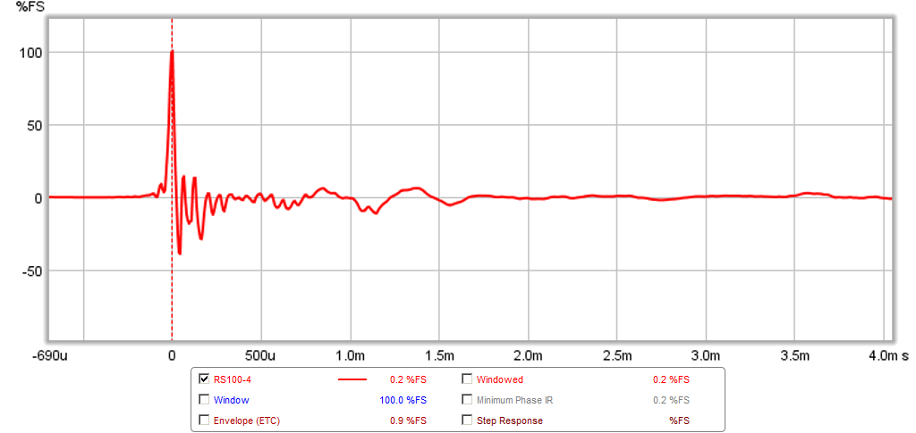

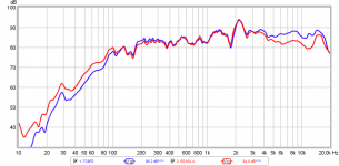

RS100-4's arrived
The Dayton RS100-4's that Byrtt was kind enough to provide arrived today. They are really nice: super high quality build - very pretty with alloy frame and anodized aluminum cone and phase plug. Thank you Byrtt! 🙂
Very nice looking and feels like quality:

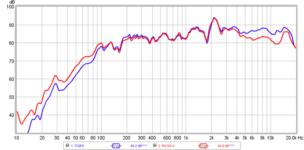

Before installing them in the Hypercube I took another spectrum with the TC9FD. Without touching the mic, I swapped out the drivers (drop in replacement - cutout was a tad tight since magnet is much bigger) without moving anything. I then retook the spectrum at the same settings. The results show that both of these drivers are remarkably similar in behavior with a few differences: the TC9FD has more of a rising response and is smoother in the upper registers above 10kHz. This plot also says that most of the dips and peaks are caused by the room, or cabinet diffraction.
Installed in Hypercube:
Freq response of TC9FD (blue) and RS100-4 (red) - these were both driven at the same level and mic distance (0.50 meter) yet they appear to have same sensitivity even though the RS100-4 (4ohms) should be higher at same voltage as an 8ohm driver. I am very surprised how similar these drivers are. You can see that the RS100 has a larger breakup mode near 15kHz - that will show up as ringing in the impulse response. RS100-4 has improved bass response and seems to be flatter in the mid bass region:

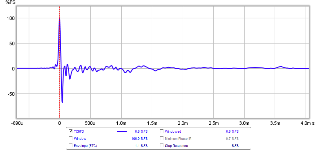

Here is the measured impulse response from the TC9FD:
Here is the measured impulse response of the RS100-4:

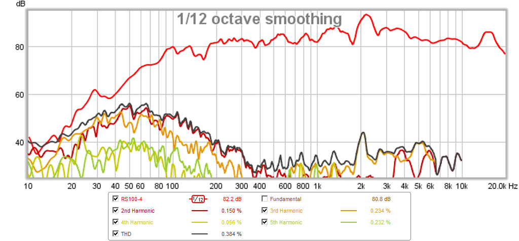

Here is the HD of the RS100-4:

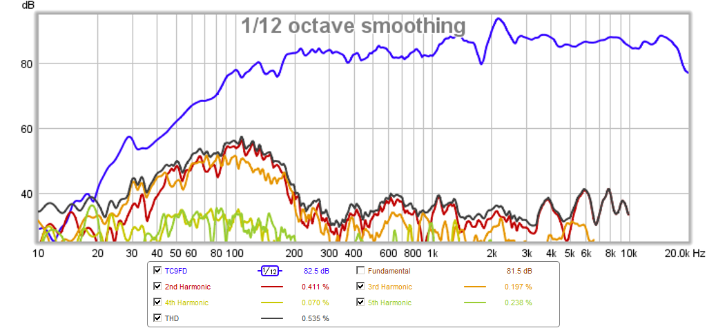

Here is the HD of the TC9FD:
