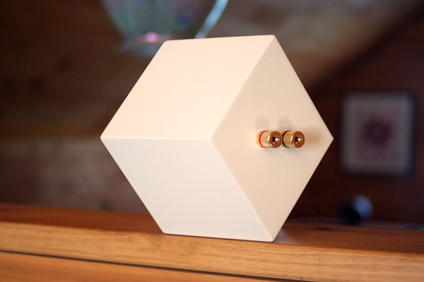

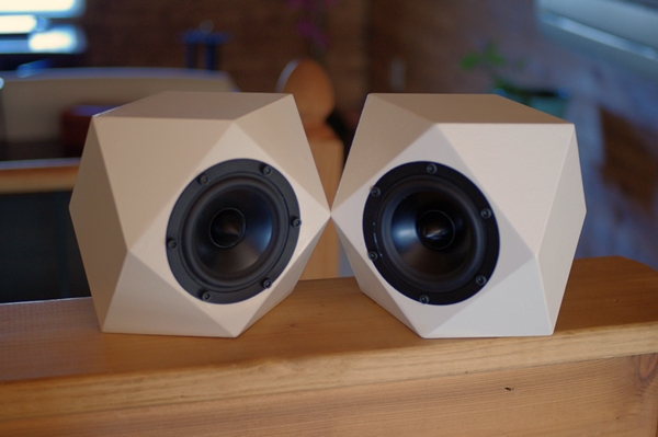

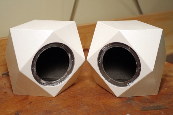

I finally did some painting. Apparently, I should now wait about 2 weeks before doing a clear coat...
Beautiful finish those new pair of Hypercubes.

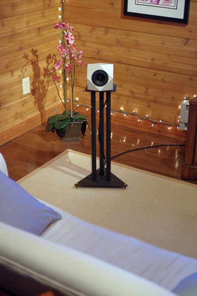

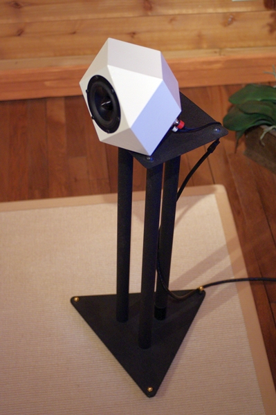

Ok, it's all good. I have both speakers playing in the finished enclosures and it sounds good. I'm really not sure what I was hearing (if anything at all) last night with one enclosure swapped. Maybe filter tasting and wine tasting on the same night was too much. Attached a couple of views of the left speaker...
