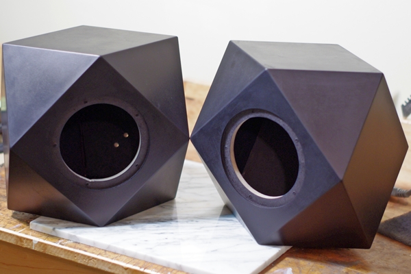

My Pluvia Seven set is on hold right now while I experiment with different paints. I had a problem with the tape marring the surface (leaving it on for 24 hrs. probably didn't help things). Not an issue if sandable primer and a coat or two of paint is to be used, but I suppose I could hold each piece in place (one at a time) and use super glue. As for painting, I like hanging the enclosures by the baffle and painting down towards the bottom (rear) point to help control drips. However, I haven't gotten satisfactory results yet from the low voc paints. There is one more I may possibly try before switching to oil based.

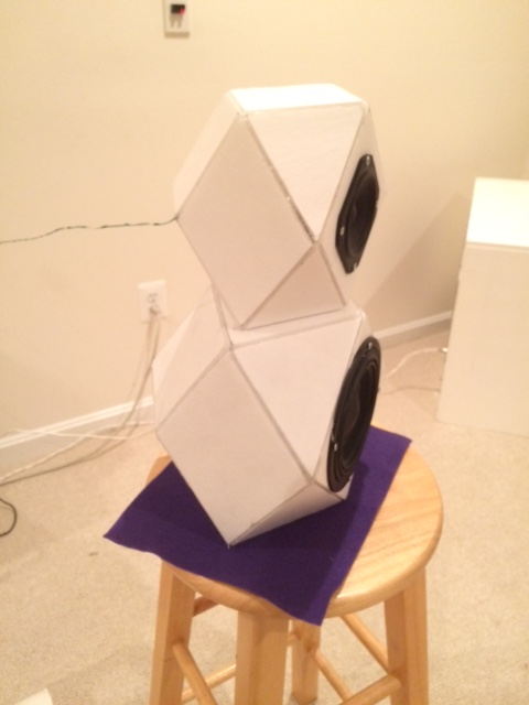

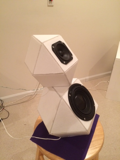

Sound is good. Still listening to them after a year. Have a sub to fill in lows. Building a new pair with Tang Band W8-1808 8" speakers. Should be about twice as big (duh) and do better lows. If that is not enough I'll probably just build a pair of powered subs to go under the new speakers. End up with a hypercube snowman
That's good news; I look forward to hearing more about the new project. xrk971 built a 2-way :snowman: and I think was pleased with the performance. The 1808s should provide plenty of output without a sub but you may need a bit of eq to get the balance right. Also, note that the W8-2145 is now available and may give similar performance for half the price. Good luck.

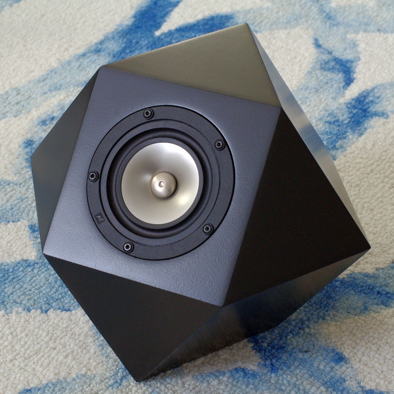

Pluvia Seven Hypercubes w/stands

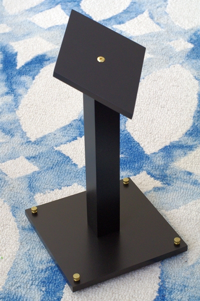

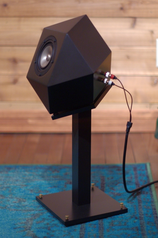

I've been listening to these for a couple of days and I'm impressed. The stands are angled at 22.5 degrees. I was worried at first that the speakers would want to slide off, but with urethane bumpers they are very stable. The stands can also be configured to hold the speakers in their alternate orientation, but I think the way I show it here is more stable. The brass thumbscrews make it easy to get the bases level (especially important when your house is over 130 years old).

Thanks, BYRTT!

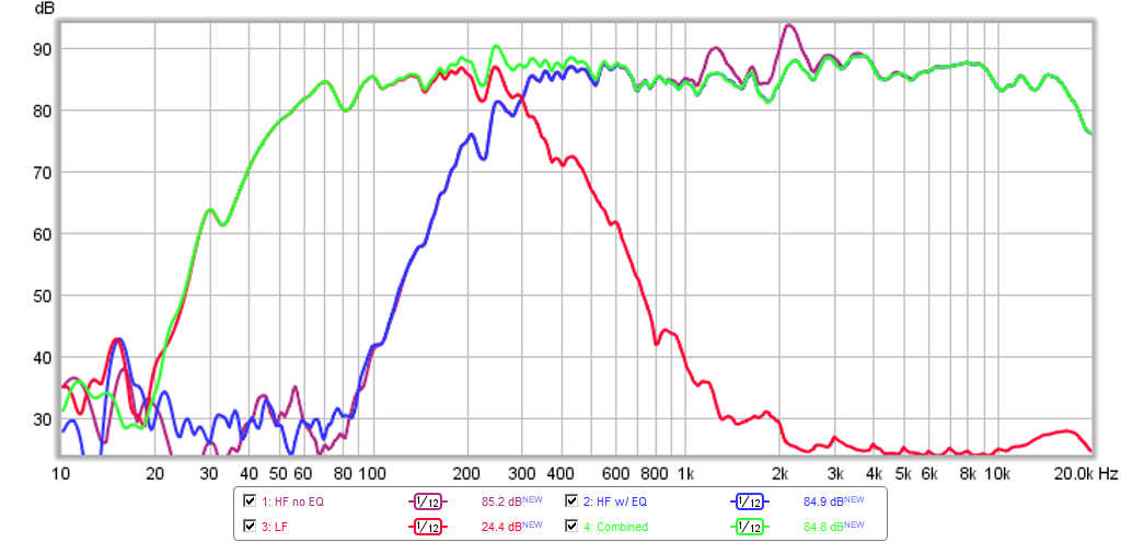

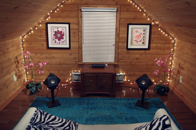

Good eyes. The drivers are just 20" (508mm) from the floor which is a bit lower than what I was used to, and you're correct, there is noticeably more low freq output than with my previous setup. However, the close floor proximity doesn't seem to work as well when EQing from the listening position (I'll have to work more on that in the future). For now, I'm using nearfield measurements as the basis for EQ, which is something I've wanted to try for a while anyway. The speakers are tuned for flat response with a Qtc of .5 (-6dB at 65Hz) which is plenty of bass for me with room gain. I do plan to post some graphs. I would like to try to have my mic professionally calibrated first, but that might be a little while...
Have you ever considered taking multiple measurements at the listening spot (in a tight square) and averaging them (with (A+B)/2 in pairs) to use as a base for FIR/EQ? This way getting most of the room anomalies like reflections filtered out while dealing with the tonal differences?
Friction mount at 22.5deg? Yowza. An small earth quake will roll them off please bolt them down. 🙂
Nice looking speakers and stands.
:cheers:
I know, I know...😱 but they really are stable. I promise.🙂 Thanks for the compliment. 😉
I could try that. I decided to use this as an opportunity to learn a bit. Still never tried the MMM....
