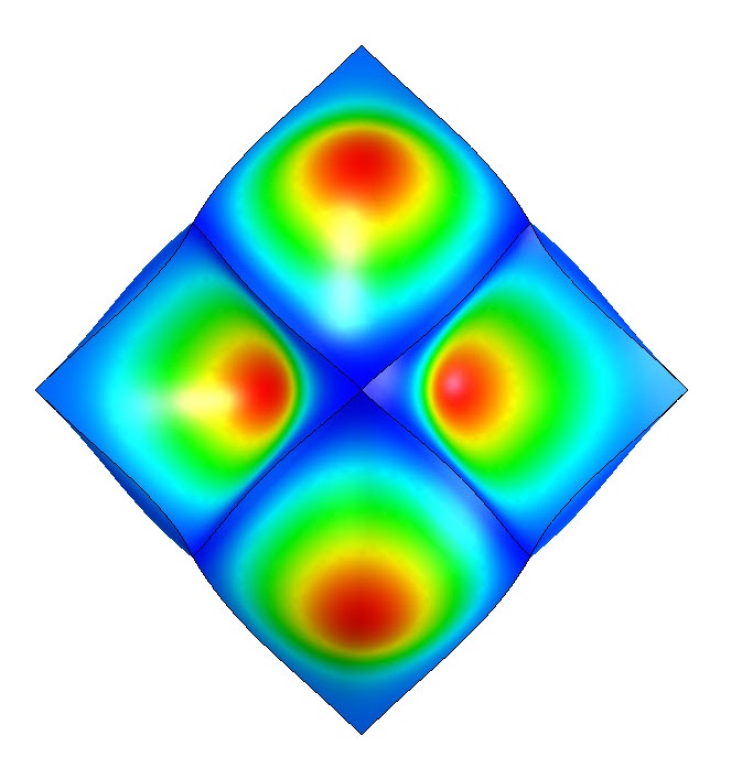

That's a really pretty image in its own right. I wonder if those are the peaks I am seeing on the FC at 2.2kHz? If I wanted to get rid of the peaks, adding CLD with latex caulking and second layer of foam core would get rid of those right away. Also, stick bracing internally - like bamboo BBQ skewers poked through strategically at the peak drum modes and hot-melt glued in place could do wonders...
What software are you using to do the modal analysis? I have Solidworks but never tried this.
I re-ran the modal analysis with the new panel size of 4.124". I think I made a mistake on the thickness in my first scaling of the model because I got some pretty different numbers. I double checked, I'm much more confident in the new numbers (plus I re-ran the 4.25 and they are more in alignment with the new results now that I'm sure the model is correct). The first mode (back panels resonating) is 1476 Hz. Then 1529, 1541, and 1605. Sorry guys, but that peak appears to be a function of the modes of the box. If the box is radiating, analysis seems to indicate it's not broadband. Polar plots would be really great to see if this is what's happening.
I've attached the image of the first mode, looking straight at the back of the box (speaker panel is parallel to the screen, facing away), Colors indicate displacement of the model at the peak of movement. The rest of the box is blue.
Fascinating. I think it's safe to say that my 1.55khz observation is really 1.54khz - but why is that one so much more prominent than the others in my measurement? Also, at the risk of sounding naive, if something truly special is going on here, is it possible that there could be wide band panel resonance in real life that is not showing on the modesl?

... is it possible that there could be wide band panel resonance in real life that is not showing on the modesl?
YES! Always keep in mind that models are simply ideal representations. Especially modal analysis (it's really easy to be off in weight, stiffness, or configuration which would throw results way off). For instance, what if the glue holding the box together was flexing, allowing the enclosure to expand a little? That's why I suggested the polar measurements. They would help show us if what I'm predicting is true. Analysis should always be backed up with experimental results. If I had the resources, I'd build one of these and then stick an accelerometer on one of those back panels (and maybe a few other places) to get an idea of mode shapes. BTW, I can change materials if anyone wants some data on that. Not sure how to model wood...
XRK971, I'm using Solidworks and those are from the frequency analysis of Solidworks Simulation. I'm a mechanical engineer (and a bit of a jack-of-all-trades engineer). And yes, I can calculate internal volumes. I can either model the internal volume, or take a virtual mold of the inside and then ask Solidworks for volume of the part.
gpapag, I'll take a look and see if I can contribute.
I can get relative amplitudes of the modes from my analysis. At the 1529 and 1541 modes the amplitude is about 1.5 times what comes after. There's a good chance it's just larger because it's the first mode and it's overlapping with a different mode of similarly large relative size. These results make sense to me.Fascinating. I think it's safe to say that my 1.55khz observation is really 1.54khz - but why is that one so much more prominent than the others in my measurement?
