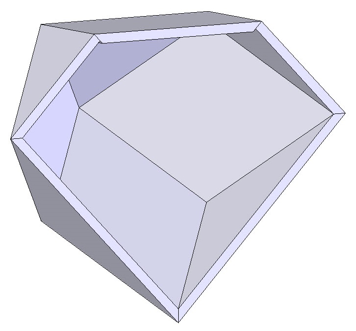

Here's a cross sectional view of the enclosure (cut right down the middle) showing what Matt is talking about in regards to the recommended construction method resulting in an edge at speaker baffle. Panels are all the same thickness. Drawings for each of the parts soon.

Can you model tell us what the internal volume is given an edge (the square baffle) of length S?
Either way, if anyone wants a 3D model part file, let me know. Should be a piece of cake to customize and export.

XRK971, I'm using Solidworks and those are from the frequency analysis of Solidworks Simulation. I'm a mechanical engineer (and a bit of a jack-of-all-trades engineer). And yes, I can calculate internal volumes. I can either model the internal volume, or take a virtual mold of the inside and then ask Solidworks for volume of the part.

Ok, here's a quicky drawing of the panels with a unit length of the square face. just scale to the right size.
How would one hold these panels together during glue curing? Looks like it might need a lot of tooling to get it right. I can imagine some 120° angle clamps, with some very careful alignment, but I'm not sure how well that would work.
Now, I better get to work.
That is why I use hot melt glue. Your hands are the clamps for 40 seconds until it sets. The joint is semi flexible so the geometry of the edges forces the final shape. It builds itself. You just need to attach the rhomboids and triangles in the correct order and orientation. Start with the square and glue the triangles to it like a flower petal. Then add the rhomboids between the petals one by one. The add the rhomboids that form the "tailcone". I glued the 4 rhomboids that form the tailcone by itself first then glued that to the front assembly.

Cal, are you suggesting to first apply wood glue, align the parts, then put a dot of hot glue (probably at the corners) to hold it together? Hot glue should come right off after the wood glue has cured. That's an interesting idea.
That will be a mess as the wood glue will smear and drip all over the place as you fumble to hold it together. I think you tack with dots of hot melt and then use a hypo needle to inject wood glue into crevice between panels at the edges.
