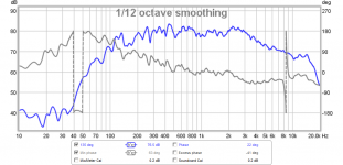

Driver is a Dayton RS100-4. It's quite good but notice that the freq is only plotted to 16.4khz. Also I used a little more smoothing this time (1/12 oct) because I saw that that's what you were using and I figured that's what all the cool kids were doing. The bump at ~16k is where things get a little ugly, but for my personal hi-fi listening, dsp makes short work of it.
The speaker was located just over 41" from the nearest surface (floor/wall/ceiling) which was the farthest away I could get it. That's why my original waterfalls don't extend into the lowest couple of octaves.
Mic was located about 3" from the driver and as I rotated the enclosure around I kept it centered in the same spot allowing the pyramid tops to get a little closer to the mic than the driver was...
Ok it's because you are only 3in away which is why it is smooth. 1/12oct smoothing is good, make your plots go from 40dB to 100dB so that the features are not so flattened. Also you should go back at least to 0.5m away - this gives room needed for response from driver as a whole to integrate.
I understand, Slothrop. (Nice Pinchon handle, by the way). I'm going to stop explaining and let the data speak for themselves. It is always possible someone will publish a technical disquisition that will be more scientifically palatable. I have been working on something less metaphysical involving exterior calculus, but I will be just as happy if someone more specialized in audio engineering than me comes up with an acceptable explanation first.
Thanks for that. I have noticed the response gets smoother at close range. Right now I'm working on an 18" measurement (greater than 2x biggest dimension of the enclosure) to see how much of the hypercubes extra "efficiency" makes it into the room.

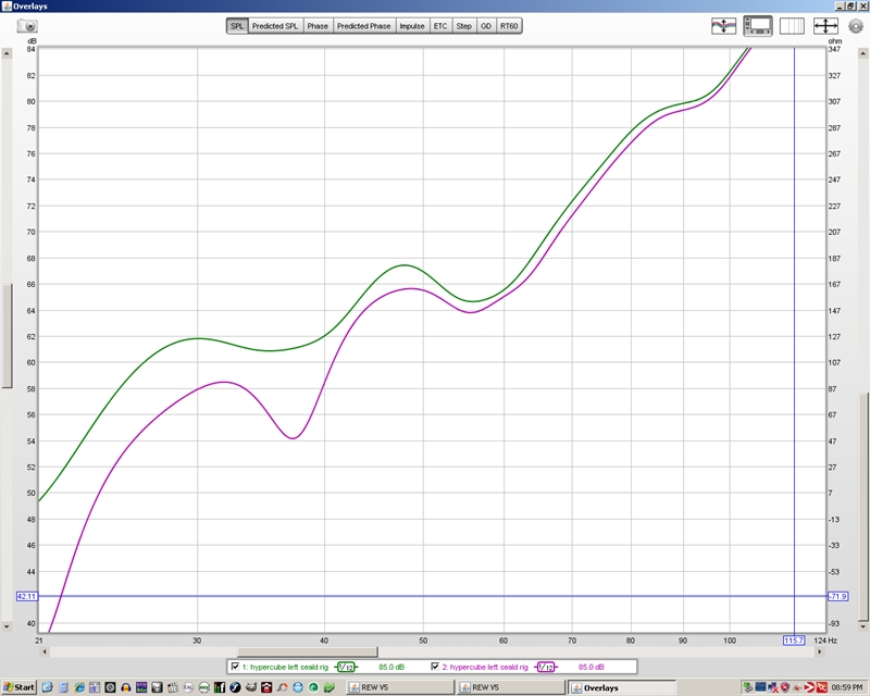

I ran a measurement at 18" for the sealed and hypercube enclosed driver to see how much of an effect the wide band resonance of the hypercube panels contribute to "increased efficiency" farther out in the room. At this distance, the efficiency of the hypercubes only seems to better the sealed box below about 120hz. I have to admit, I was hoping to see a little boost from the bass range up to about 3khz but that doesn't seem to be the case (above 120hz or so the panel resonance just seems to be helping to decrease directivity while adding some low level ambience).
However, at around 55 hz the output of the hypercube starts pulling away from the sealed box. From here down to 30hz, the output of the hypercube is more like a 2 to 7 db increase. Below 30hz the hypercube seems to be putting out 4 to 10db (or more) more than the sealed box. I ran the sweeps a couple of times each to make sure I was getting consistent results.

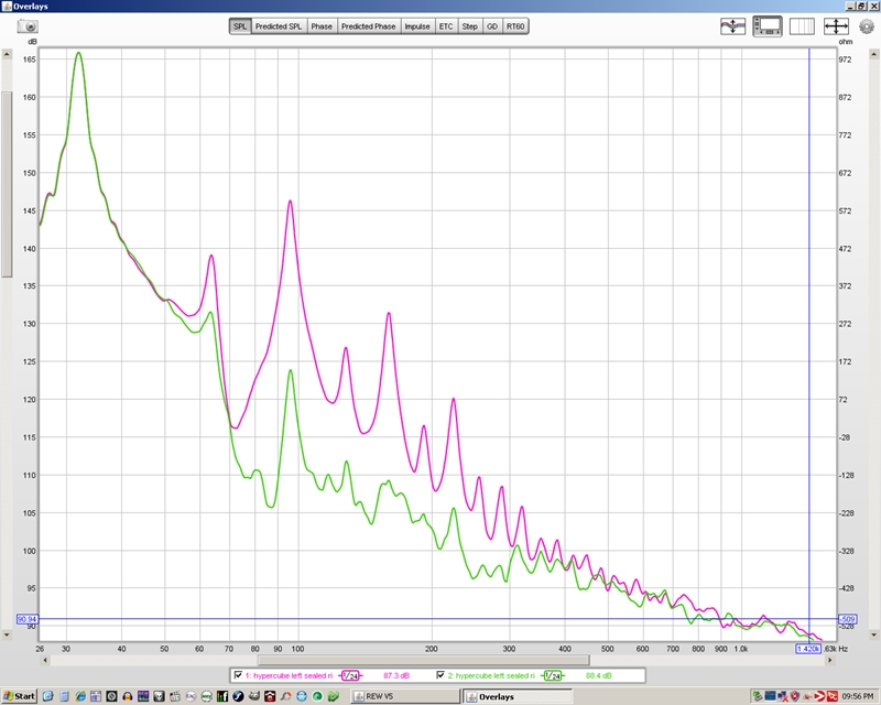

I originally provided a harmonic distortion comparison measurement for the sealed vs. hypercube speaker at 64 hz. I have now decided to make a similar measurement a 32 hz. It seems that (with the 32hz sine wave) the first overtone from the hypercube is 8db softer than the sealed box while the second and third overtones are something like 22db softer. This (along with the improved decay) would certainly help to explain the incredible improvement in bass quality I have observed with the hypercubes relative to the sealed boxes. Now, if I could only get outside to get some full-range waterfall plots....

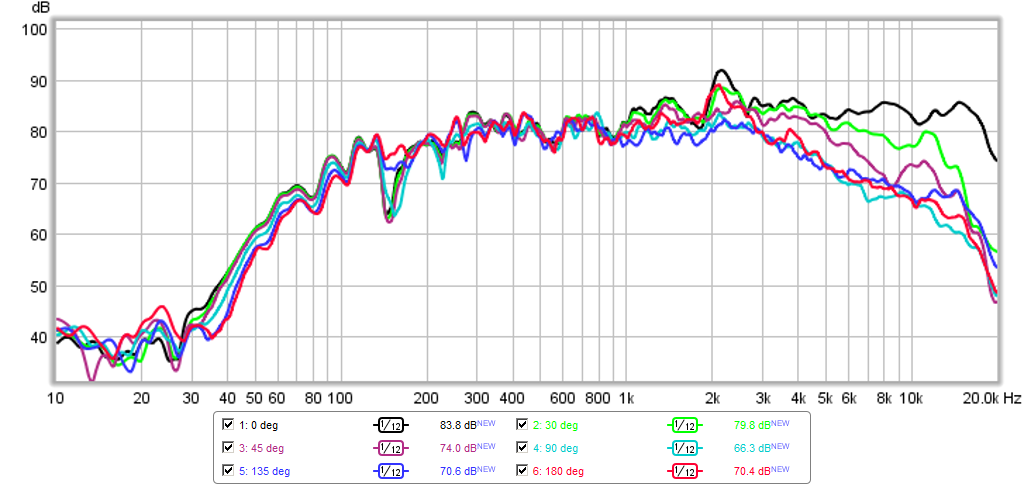

180 deg Polar data
I set up the Hypercube on the stand without anything blocking the direct radiator facing horizontal and took some polar data at 1 meter and 2.83v. The TC9FD is rated at 85dB at 1m and 2.83v - which is what I measure above the baffle step at 1kHz. So I don't see a 3dB gain overall. However, there is a pretty uniform sound field up to about 3kHz 360 deg around the Hypercube. This is probably the combination of re-radiated emission from the speaker walls.
Polar data up to 180 deg (360 would be the same as it is symmetric):

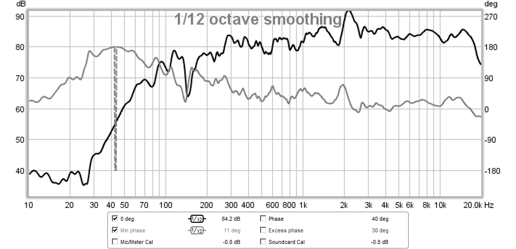

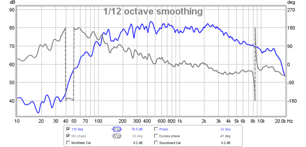

Here is the frequency response and minimum phase at 0 deg - the deep dip at 150Hz is floor bounce because it goes away when there is no direct radiation from the driver face:
Here is the frequency response and minimum phase at 135 deg:

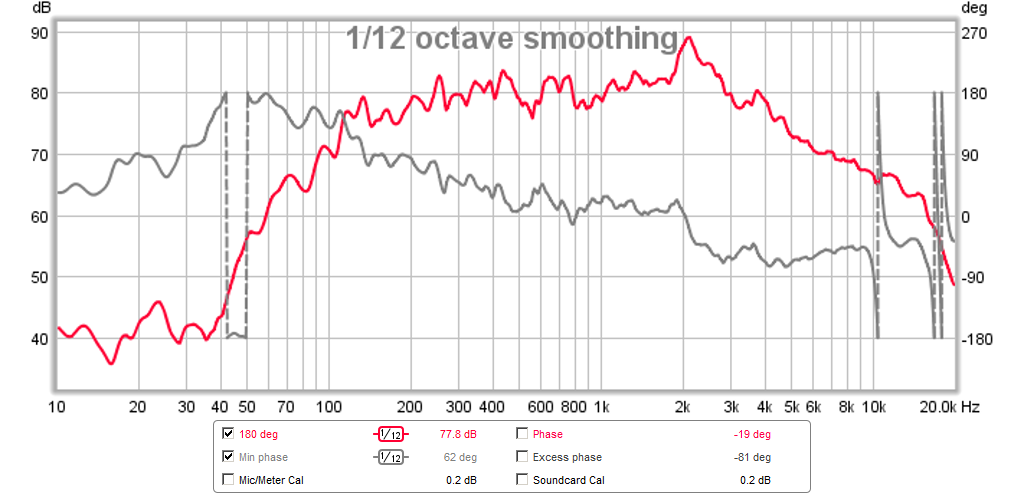

Here is the frequency response and minimum phase at 180 deg:

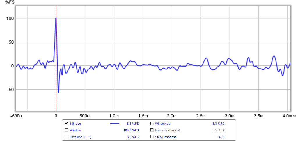

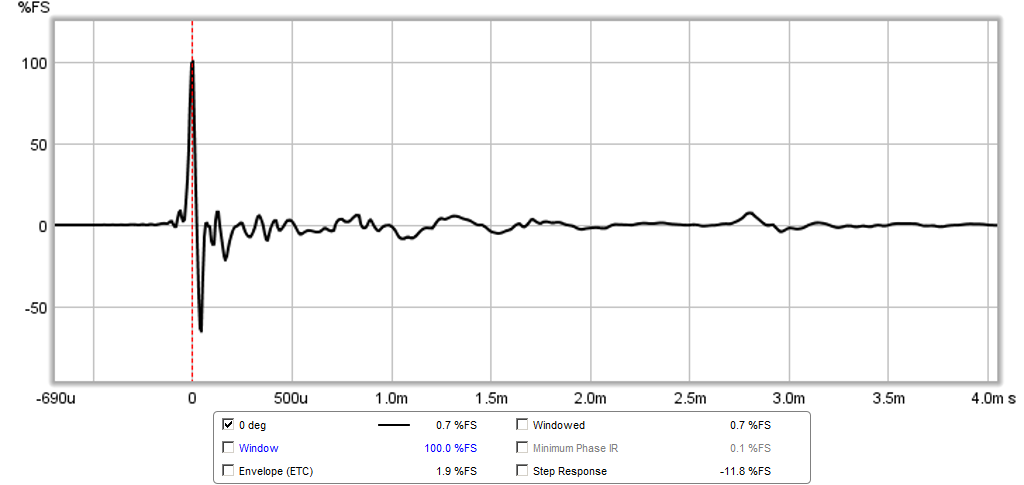

Here is the impulse response at 0 deg - pretty clean - this is an excellent impulse response indicating that percussion will sound sharp and distinct, and that most sounds will not have sibilance (and indeed listening to female vocals, there is no sibilance from the speaker):

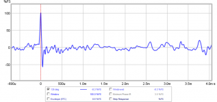

Here is the impulse response at 135 deg - still clean:

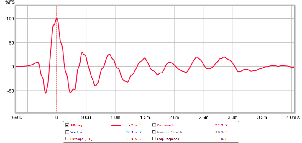

Here is the impulse response at 180 deg - very different from the other ones, and I believe the ringing is cause be the resonance drum head mode of the four rear panels like Mudjester's simulation shows. This ringing frequency corresponds to the huge 2.2kHz peak visible at 180 deg response:

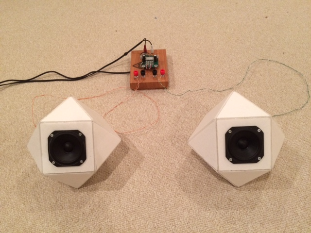

Foam Core Hypercube in Stereo

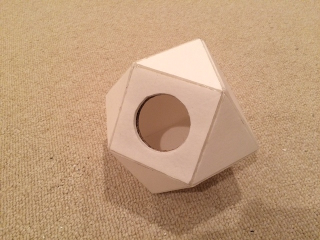

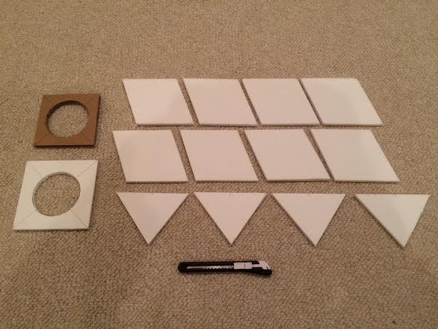

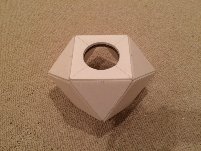

I had some time to throw the second one together and documented the build process in detail below. Sounds really nice in stereo, I may have to take this to the office.

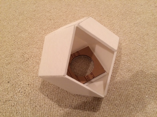

Pieces all cut out:

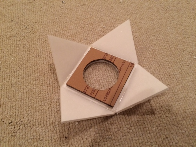

Glue the triangles to the square like a flower petal:
Glue the rhomboids to the triangles:
Glue the remaining rear 4 rhomboids to form the 'tailcone' - only one left tht needs to be capped off:
Done:
In stereo with TPA3116D2 amp:
Pieces all cut out:
