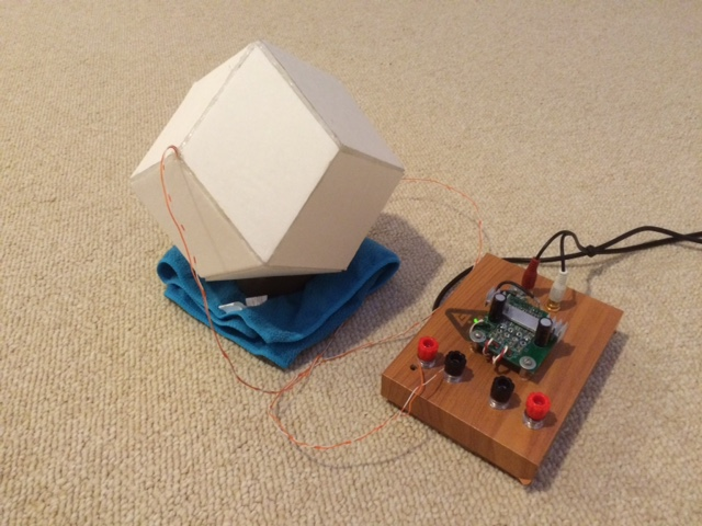

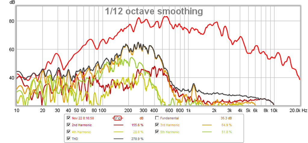

Backside Radiated Emission
I aimed the front of the driver into a 3in dia paper tube sitting on microfiber cloth to limit output only to rear re-radiated emission. The driver face is pointing down and the mic is horizontal at 0.5m away. There is quite a bit of emission and it sounds pretty good playing saxaphone jazz (Paul Desmond). It sounds uniform like a sphere emission - uniform everywhere in 2pi space. I was listening to it on the floor and it sounds good. For the measurement I elevated onto a stool at about 30 in high.
Here is a photo of it as spherical radiator on the floor:
Here is the measured response (with stuffing):
This is probably the ambiance that this speaker adds that may explain why it sounds pleasing. It is broadband with some resonance peaks.

VERY cool and interesting, xrk971. Your tests are confirming what witnesses have been telling me for decades. We obtained this sort of effect (anecdotally, alas) even with heli-arc welded 1/8 inch aluminum. On occasion, we have constructed the shape out of much thicker materials sic as 1 inch particle board. When we did that. what we tended to notice was much the the same quality of sound in the frontwave as before, but a reduction of the passive radiation. In other words, same fidelity and transient response, but less omnidirectional sound.
Gmad and xrk971, I cannot overstate how grateful I am for your work and testing on this design that has lain mostly neglected and ridiculed for 34 years. If a picture is worth a thousand words, a well-executed graphical rendering of objective test data is probably worth a million words of my own ramblings. The fact that your results appear to be validating decades of observation and are visible to the global community now is a badly needed shot-in-the-arm for the aged "mad scientist" I have become.

Freq and minimum phase response at 0, 90 and 180 degrees with and without stuffing.
Those measurements look very nice - the 0deg is very flat - what driver is this and how far away are you measuring? I know of no full range driver that is this flat and reaches 20kHz without breakup modes.
The 180deg starts dropping off at 3kHz like mine.
How far away are the walls in your room?
A tip for getting images in REW: click in the camera icon on top left corner of plot to save as png file. That way you don't need to do screen shot.
