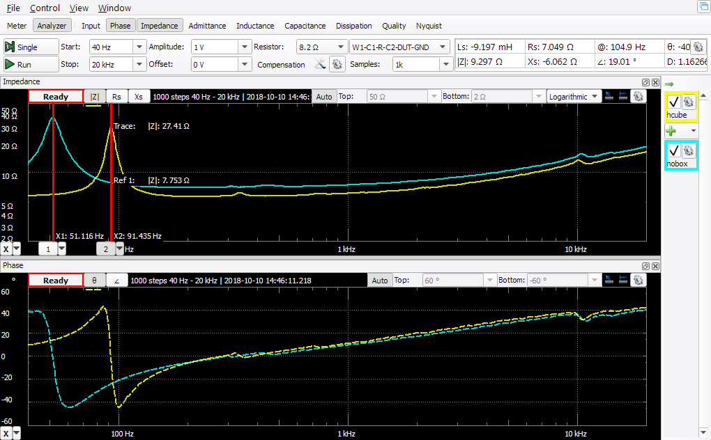

Here is the impedance plot for the Visaton B200 in blue as measured lying on the floor in nobox; and in yellow in the 5mm plywood hypercube with 17.7 liters internal volume.
Does it tell us anything special?
it raised resonance and introduced 3rd harmonic distortion.
Yes to the resonance raised (which is normal for a sealed box) and no to the 3rd harmonic, IMO. It's not easy to see in the graph, but the glitch is already in the driver and is only accentuated in the box (and also raised a bit in frequency).
What is to be said of the lower impedance in the box? I did not add any offset.
...What is to be said of the lower impedance in the box? I did not add any offset.
Probably it indicate a tighter spring now, try add dampening material and it probably raise up a bit above the free air reference.
Theoretical Q should be relative high for B200/17,7 liters combination but not shure at those frq it will show up other than in few milimeters nearfield measurement.
As to be expected in a way too small sealed box. Given B200 Q it needs to be in a biggish (100 litre +) leaky box (ie aperiodic-like)

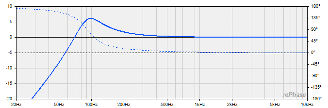

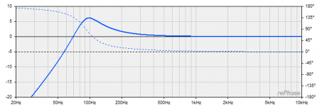

FWIW, the impedance peak in the hypercube at 91Hz is fully in line with the simulation of a 17,7liters sealed box in the Visaton Boxsim software. So here we have no difference in behaviour.
Sonce's shot at the lower impedance in the box makes no sense to me. I compared with simulation software and did not find that impedance in a box is modeled to be lower. Also, flexing walls would mean higher impedance like without enclosure, IMO. I may be wrong.
So lower impedance would indicate special behaviour of the hypercube. As far as I remember, Tesserax had some measurements done, maybe he can chime in.
My opinion is, though, that the smallest volume approach is correct and I have very good behaviour of the B200 in it.
