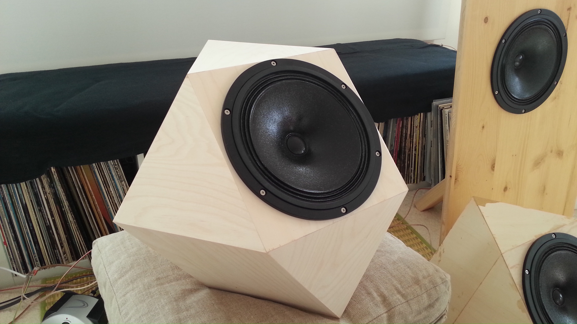

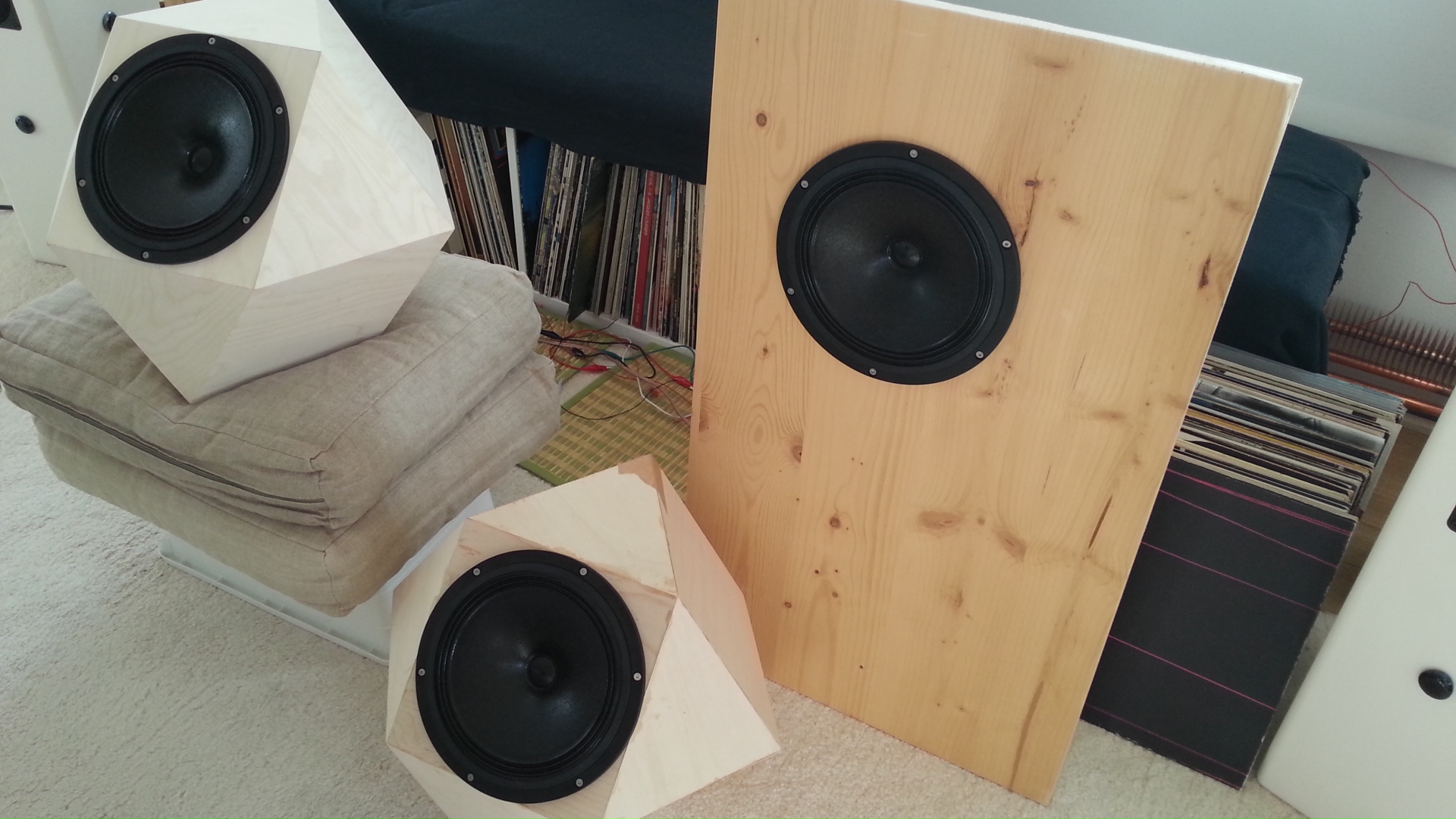

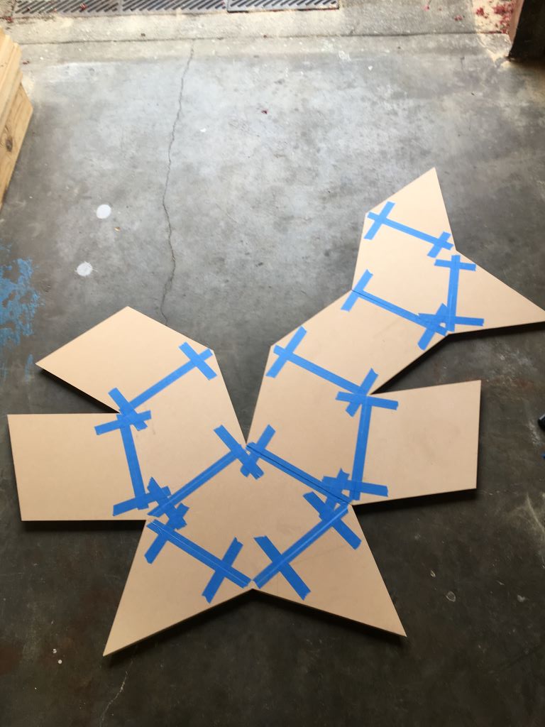

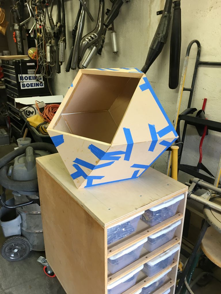

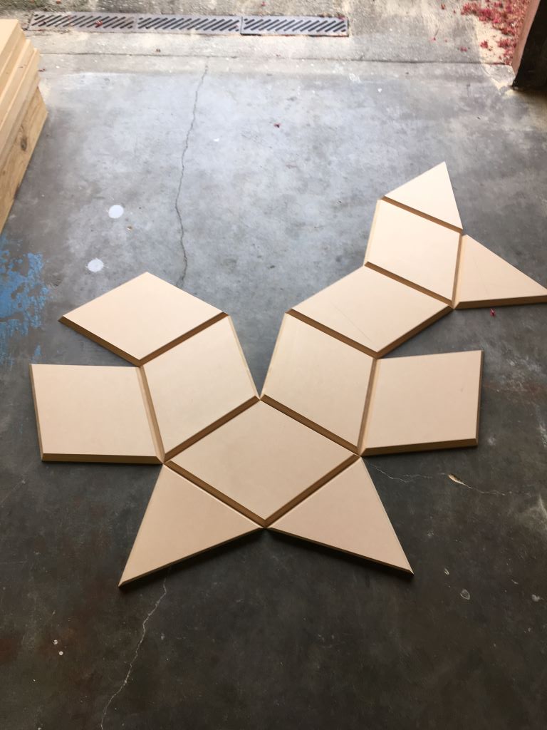

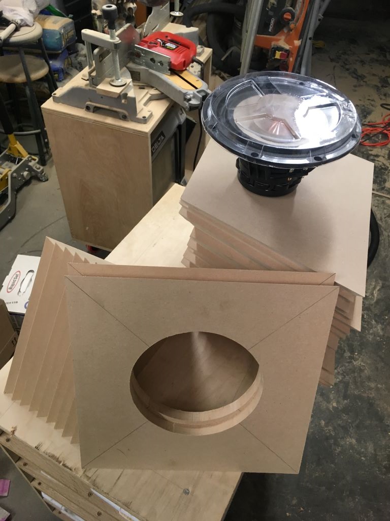

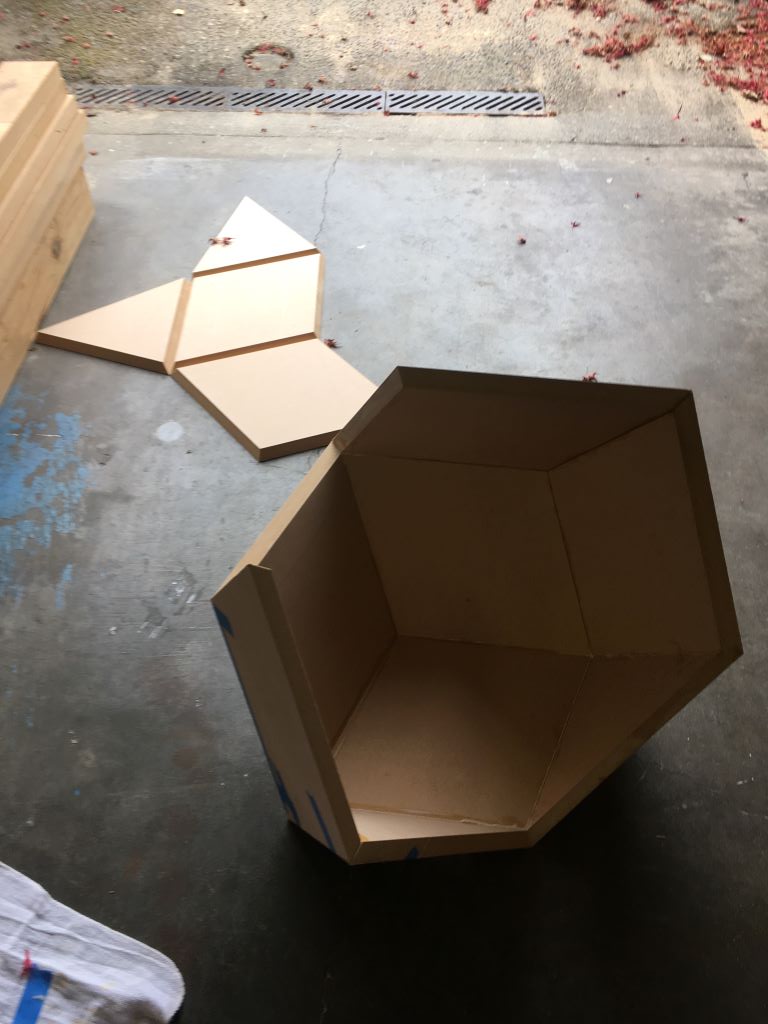

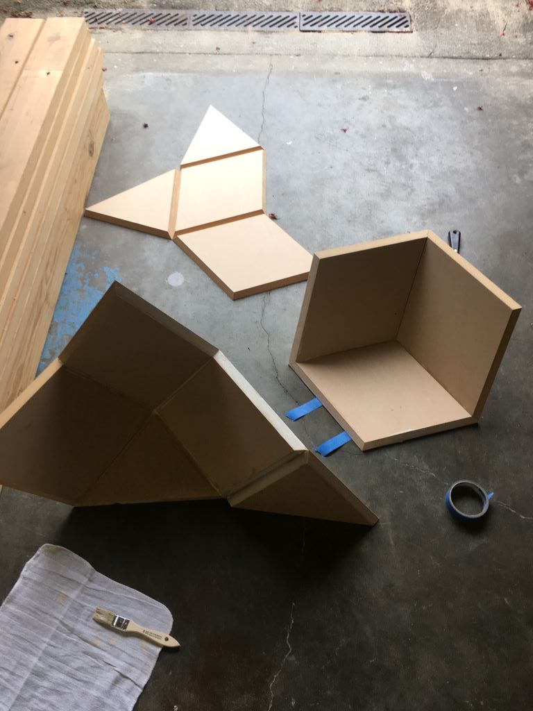

OK, I just finished pre-cutting 3 hypercube kits.
The hardest part is to make a really nice and precise pattern or jig, that I have done in maple, one for the rhombi and triangles, plus another for the square.
Then I roughly cut 3 sets of the 13 pieces needed, the 8 rhombi, 4 triangles, and 1 square.
The plan is to make 2 enclosures and a marimbula out of that. For the marimbula, the square face instead of being the baffle will be the 'soundboard'.
I will be sending some pictures. I am leaving for the other place, where I don't have a table saw, but I will finish the assembly with a router, and some hand-tools. I am hoping that the rest is easier, I figure once you get the pattern right, it will be fast to trace it with a router. I have the three kind of bits, the only problem is that they are not long enough (the wood i bought is too thick), but I will try to arrange that by thinning down the boards near the edges.
If the thing sounds convincing, next time I will upgrade the driver and the wood quality.

That's nice diyAchim, I am also eager to test my three hypers, particularly the one that will function as a musical instrument.
I used quite cheapo wood, not-quarter sawn, and with many knots and imperfections, but it's a start. Also, it is quite soft pine, so my guess is that it is somewhat absorbent for sound.
In any case, I like the ring of porous softer woods much more than hardwoods for musical instruments. I have a Japanese 1980 Ibanez P-Bass, with a thick maple neck, and a body of ash, it sounds really wonderful, I am in love with it.
I don't understand why the Tesserax guy stated it was too difficult to build them, with a proper setup, the right tools and patterns, you can build them at a cost very similar to a typical cubical enclosure. If you are even more serious you can even envision some kind of mounting block that ensures the pieces are all glued at the right angles. It is not that hard to make, not now and not back then.
You could produce the enclosures up to quite a big size with only two planks of 200 by 40 cm, which can be bought quite cheap (total 28 euros per enclosure). Even if you were to make them with the best tonewood money can buy, it would be at around 120-150 euros a piece, for thick ones, and half of that for really thin ones. Frankly, if they sound so good as everyone here is saying, you could mount some setups to produce them for quite a reasonable fee as kits, or already assembled.
I think that the key is the quality of the wood (highest quality, quarter sawn wood shrinks and expands quite uniformally, and doesn't twist) if you want to make then really thin. My guess is that your unit cracked precisely because you had to force it in place, if the fit is perfect, and the wood is fine, there is no reason why it should happen.
Take a violin, for instance, the gluing surface is quite minimal, and it works really good (of course the shape contributes to the structural strength, but nonetheless, those instruments are quite sturdy).
I have quite thick wood, so I can use hide glue, there is a lot of contact surface.
I am glad you liked the prototype. In any case, I think this is the right shape of enclosure for me, since I like the idea that the case gives some color or ring to the sound, and it's not a dead thing.

Hi diyAchim, sorry about my unfortunate wording, I don't mean to be disrespectful, so no offense, please! I know how many things don't go right even when they should, in the 'invention' business. As a matter of fact I witnessed very closely how some people developed a cure for a STD for which there was no specific treatment, and the whole thing will follow the same road, the patent will expire, since they didn't have enough founding to do a systemic test, and the topical version did not reach the targeted virus.
I agree that we owe to them a lot, I am just saying that I do not fully understand why the commercial production of those enclosures was not viable, since as you rightly say, it is not particularly hard to do if you have the proper tools and patterns (by the way, the gravity issue you mention could be easily dealt with by doing partial assemblies, maybe in 3 parts, on top of your mold, and then one final go when instead of dealing with 13 pieces, you only glue together 2 or 3).
Anyway, I am also very curious to try them, but as you might have gathered from my posts, I am not from a hi-fi background, so I don't have a clue of how many-thousand-dollars speakers sound like. But if you give me a hand, and explain me how to do it, I would gladly supply some experimental data once they are assembled.
I will also try to document how it is done, since I have the feeling it might help some other builders, as it was my case when gmad explained me the right angles to construct the truncated rhombic dodecaedron.
By the way, regarding the volume formula, once you realize that this is in fact a cube that has it's volume divided in 6 pyramids, and turned around and added to its volume, it's easy to calculate the enclosure volume, you take the square of the truncated side, you calculate the volume of a cube with it, and you multiply it by 7/4, and that's all.

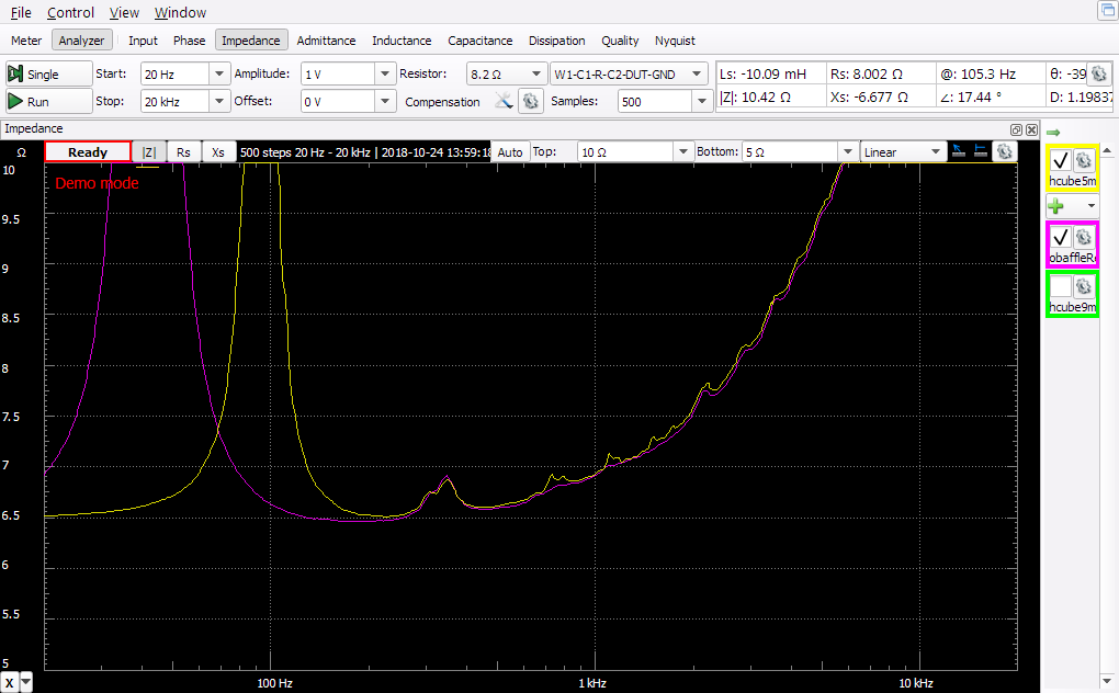

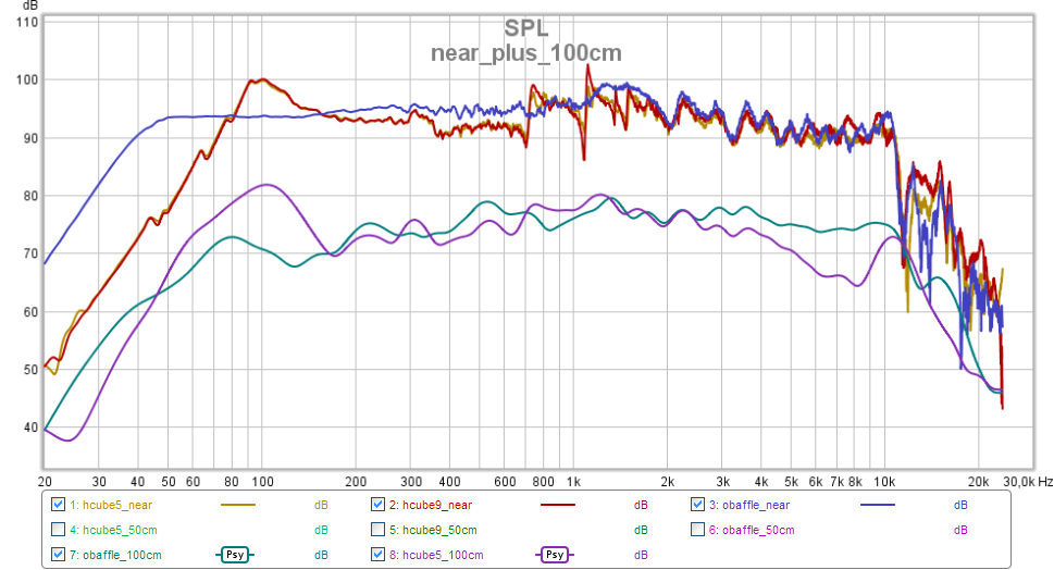

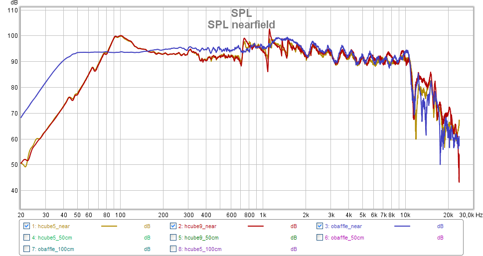

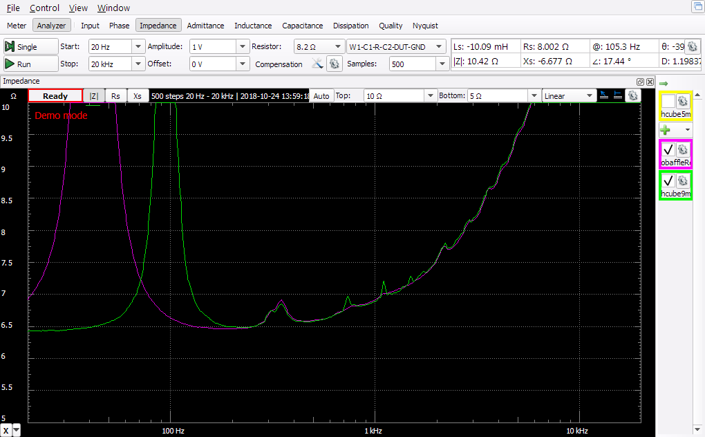

New measurements
So with the new 9mm hypercubes in the house, and everything now sealed airtight, I made new measurements.
I have to apologize for spreading false wisdom with my first measurements, which seem partly false now.
What stands is that the impedance peak is in fact more akin to a box volume larger than the actual hypercube volume.
What proved false was the thought that the impedance is actually lowered by the HC.
I measured open baffle, HC 5mm and HC 9mm. I also measured frequency response. It shows that HC5 and HC9 do not differ much, except for small resonance peak differences which are also indicated in the impedance plots.
The 5mm HC has more peaks but they are smoother.
In practice the thinner wood HC is more to my liking. It does not show more coloration, but still sounds a tad livelier. Both are without any stuffing.
Compared to open baffle (both equalised for similar response) the hypercube provides more energy and presence. It's 100 Hz peak needs some ironing or proper placement in the room. The open baffle is too laid back for my liking.
With the Visaton B200 the hypercubes need a 6dB cut at 1024 Hz with a Q of 0.5 - so roughly equalling the application of a 1mH or 1.5mH coil with appropriate bypass resistor to ones taste. I currently eq in the digital domain.
The hypercubes will need a proper stand and tilt angle needs to be determined as well as placement in the room.
The way the hypercubes energize the room is indeed special.

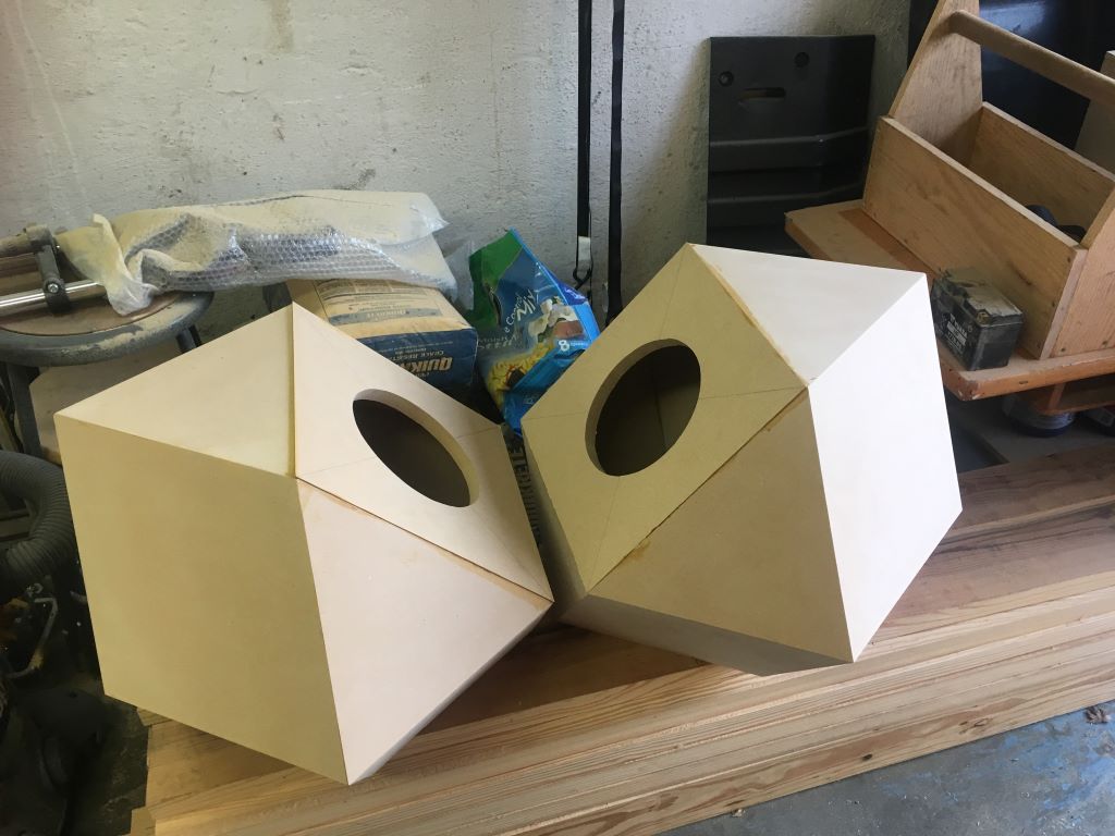

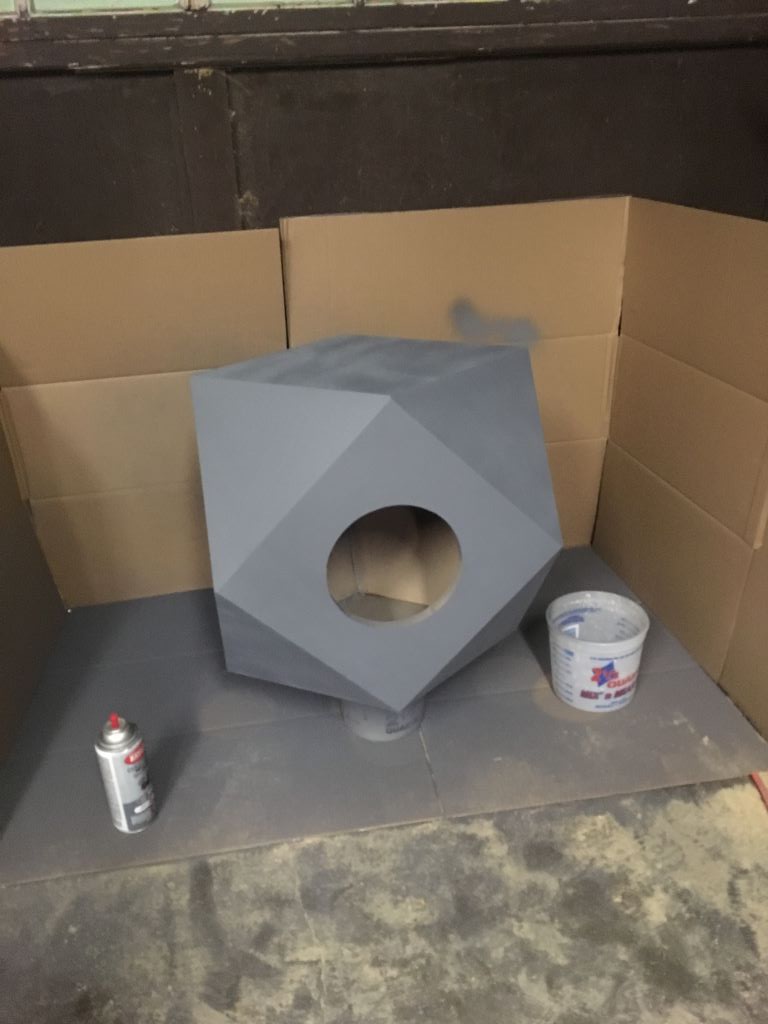

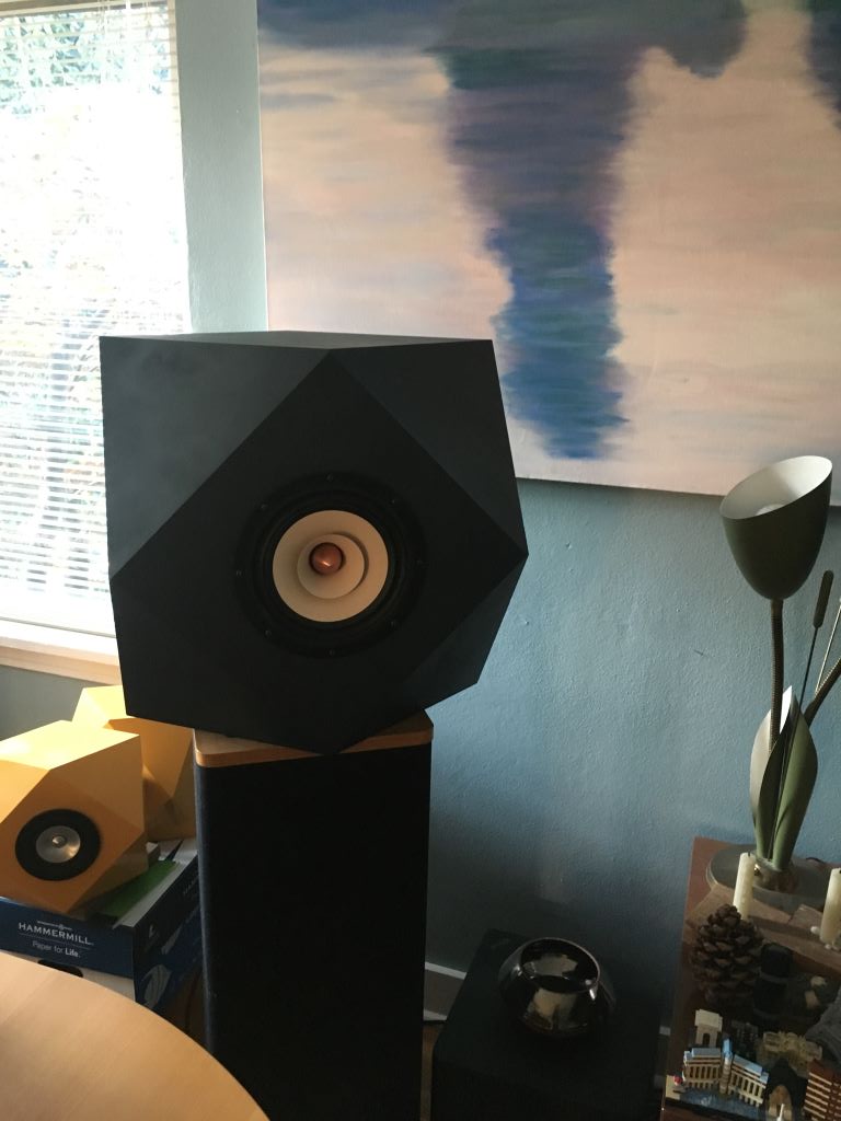

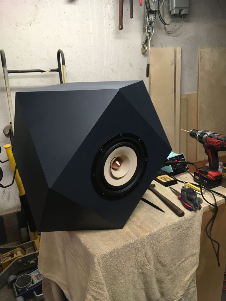

Made another pair of these. This pair uses Tang Band W8-1808 8" neodymium full range drivers. These came out about twice as big as my first pair. They are about 19" tall/wide. My first set needed a sub to fill in the lows. The goal was to reduce that need. They still need some sub but not as much. Theoretically the f3 should be at 72 Hz vs. 84 Hz for the smaller pair that used Mark Audio CHR-70A 4". These are 3/4 MDF. Next set if I make any will be plywood. Since starting these I've concluded that plywood is stiffer for the thickness/weight and doesn't produce as harmful dust as MDF. You can see my first set behind the new one in the last picture.
Thanks.
